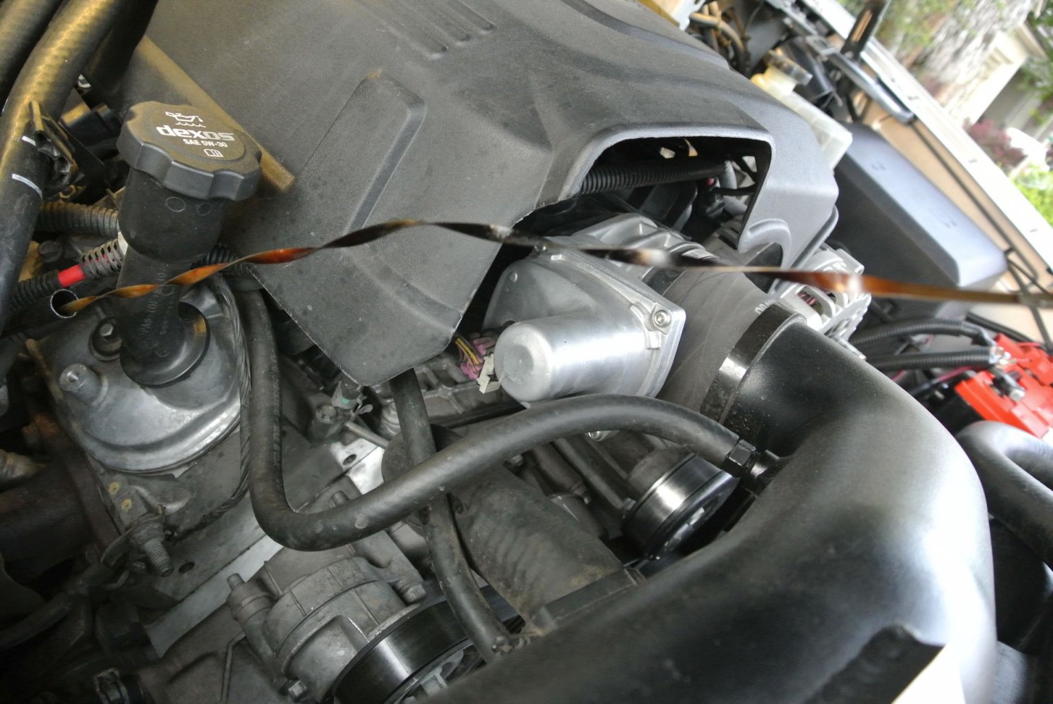

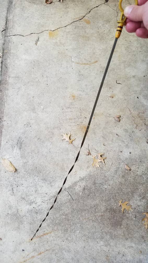

does anybody else's dipstick do this? you can see in my photos where it is a darker black color and now it is warped in that section apparently this part is near the exhaust manifold, I'm just curious if anyone else has seen this or if it is unusual, I notice when I pull it out and the engine is warmed up the oil will smoke off the stick right there as well. just trying to figure out if I need to address this in some manner.

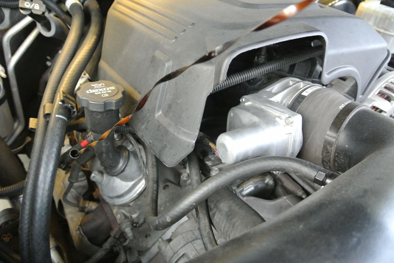

I wouldn't worry about it. I know mine's a discolored around the bend where it's near the manifold but I can't say it's warped. Also, mine's flat and not twisted like yours. Is the twisted stick a 6.2 or newer year model thing?

it must be, I ordered a new dipstick and it looks like the tube just gets a hair to close to the manifold right there, I may try to bend the tube a little bit farther away from the manifold, dipstick is only $16 so I guess if the first one lasted this long no biggie I just noticed it warping out of shape recently from the heat. Otherwise maybe I can fashion some type of heat shield to slip on the tube

I also took a better look at the coloration and it's really not discolored at all. Mine's made up of two pieces riveted together. The top half coming from the handle is thicker, the bottom half is almost half as thick. The bottom half is darker amber than the top, but it's pretty consistent throughout.

Mine is twisted on the lower section (after the rivets) also, and measures the same 29 1/8"

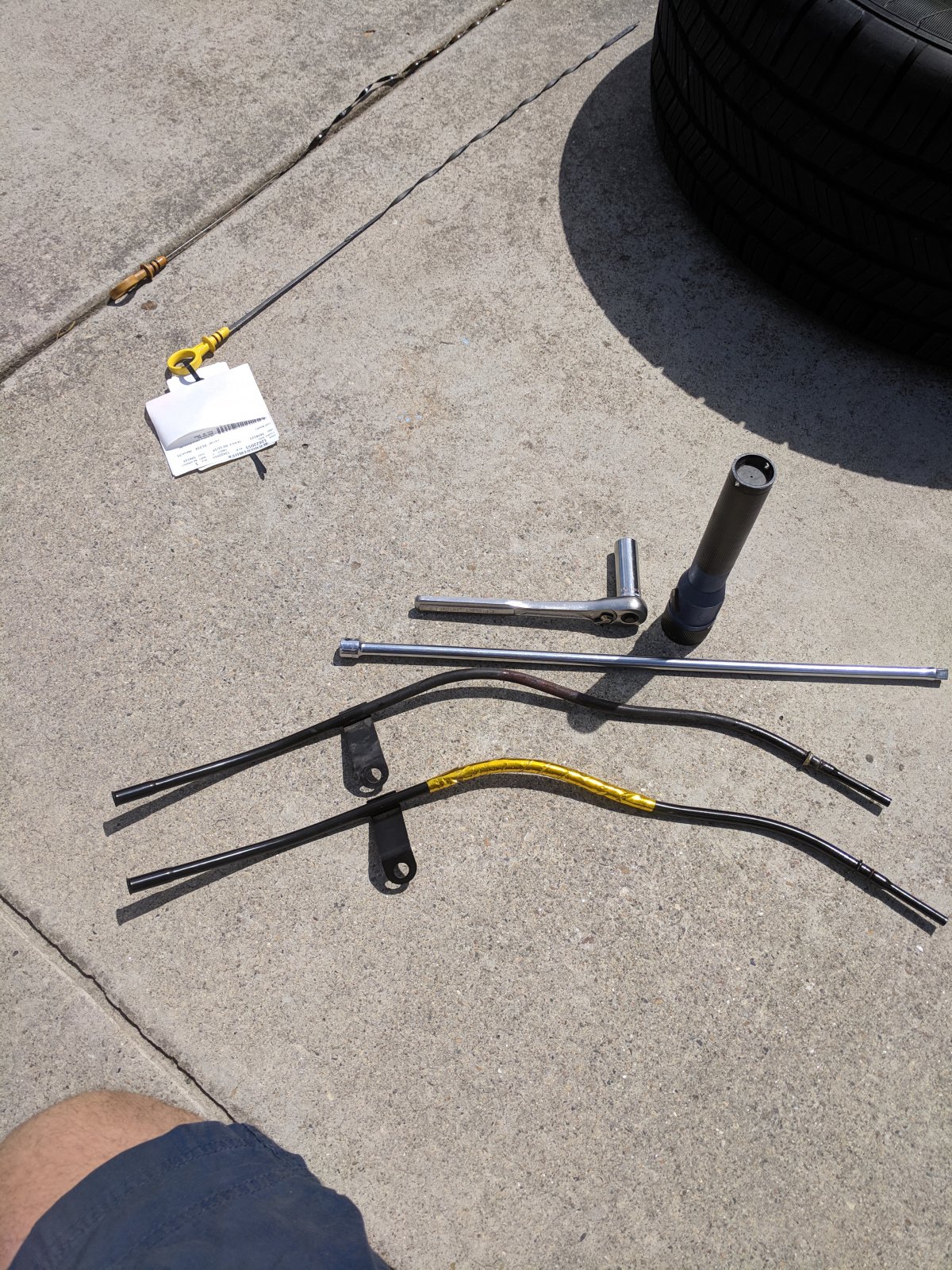

thanks, that's what mine is also I went and looked at the dipstick again it does have a straight portion at the top, my tube must be bent wrong I looked down in there while it was cool and the tube looks pretty fried but I don't have any other tube to reference for the bend I guess I will ordering a new tube as well.

Got a new tube and stick $30, heat wrapped the new tube, installed and got it up to normal temp and it didn't smoke when pulled the stick like it used to so hopefully that's that, the old tube seemed to have a slightly different bend making it pass closer to the exhaust manifold. Like maybe 1/8"
