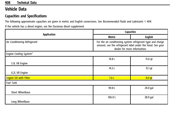

Right there with you: I just did an oil change yesterday and again found the same results. 8 qts with full oil filter gets the oil halfway on cross hatch area of dipstick. I added another half quart and it was right at or maybe a tad over the top of the cross hatch.
I checked oil level the night I drove home with new Suburban. It set for about 2 hours on flat ground. (I was looking everything over on the SUV. )
The level was over the top of the cross hatch area.
blanchard7684,
Thanks for your feedback, this is what I was trying to find out all along, has anyone seen these engines requiring close to 9 quarts at oil change. I matched the oil level in my engine with what the factory oil fill was. While it was back around 2015 as I recall, GM actually released a technical bulletin reducing the oil fill on the gasoline V8 engines from 8.5 quarts to 8 quarts for the oil fill. I did check the oil pan part number on the eariler engines and it is different than the current generation, I would guess there may have been minimal differences. I think the issue was that having to deal with 1/2 quart of oil was a bit of an issue as dealers and service facilties as they would charge out 9 quarts for an oil change and some people would then get fussy about the engine only needing less than 9 quarts??
Anyway, my plan is to run with the 9 quarts at oil change, EVEN if it may be slightly above the hash marks on the dipstick, which it did not appear to be, but maybe with the ultra clean oil it was hard to see slightly above the hash marks until I get more miles on the vehicle and the dirty oil caught in the engine oil cooler and in the engine darkens even new oil a bit more.
Even if the engine was running 1 quart high on oil it will not cause any signfigant problem, and at most I would think with 9 quarts it is either at the correct level or not more than 1/2 quart or 16 oz above full. Looking at how large the oil pan/lower engine block area is, this would be around 1/4" difference in fluid height which is measured with the engine off at least a few hours after operation. Who knows how much oil is trapped in the top end of the engine and not draining back while the engine is in operation, so a slighty higher level is most likely a non issue.
I will keep an eye on my levels, but will likely continue to run 9 quarts in the engine after oil changes. Really do not think this is going to be a problem. I am sure a few folks may have different opinions!

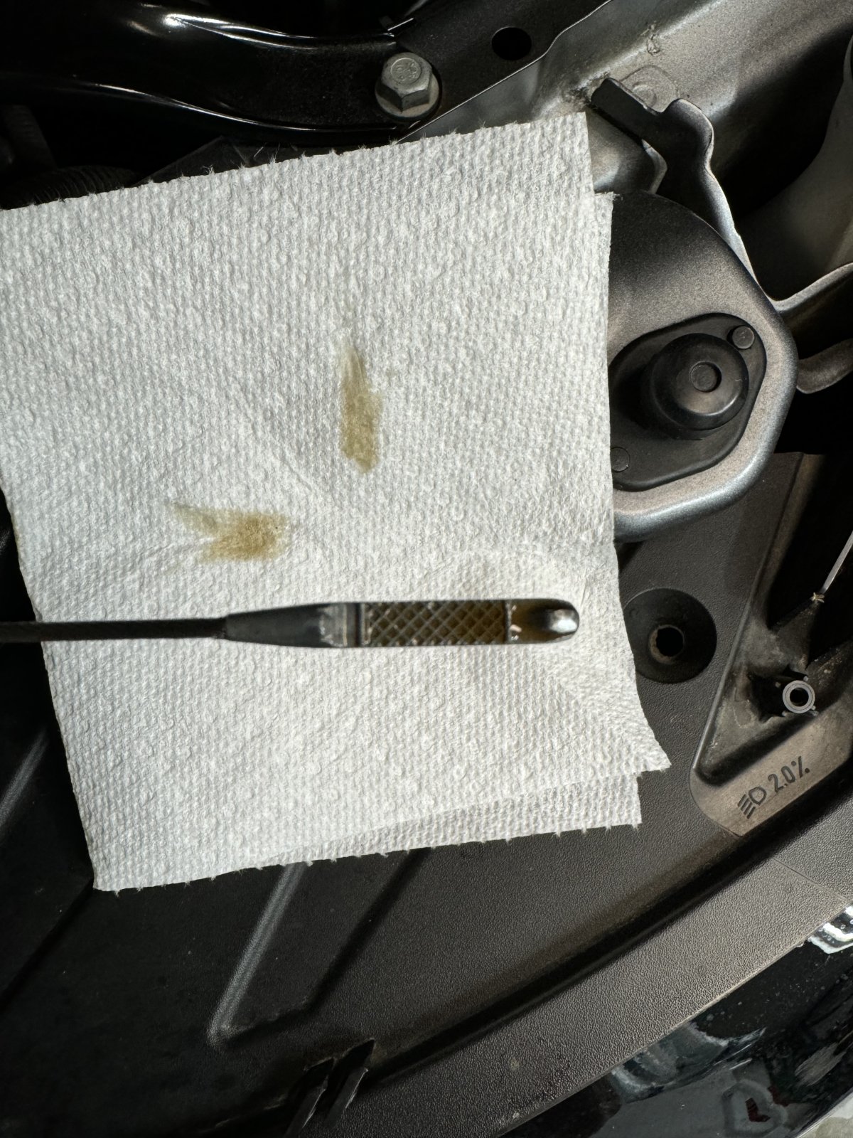

This has been done, only the few that cannot wrap their head around what is going on are still drinking the 8 quart punch!
The photo shows the dipstick level of a 2021 Tahoe 5.3l with EXACTLY 8qts, 2 gals. of oil. This photo was taken the morning after a 250mi trip which was the day after using EXACTLY 2gals of AMSOil 0w-20 motor oil and a new EaO-17 filter during an oil change. No additional oil was added.
8-quart punch or not, if additional oil is added it would be overfilled.

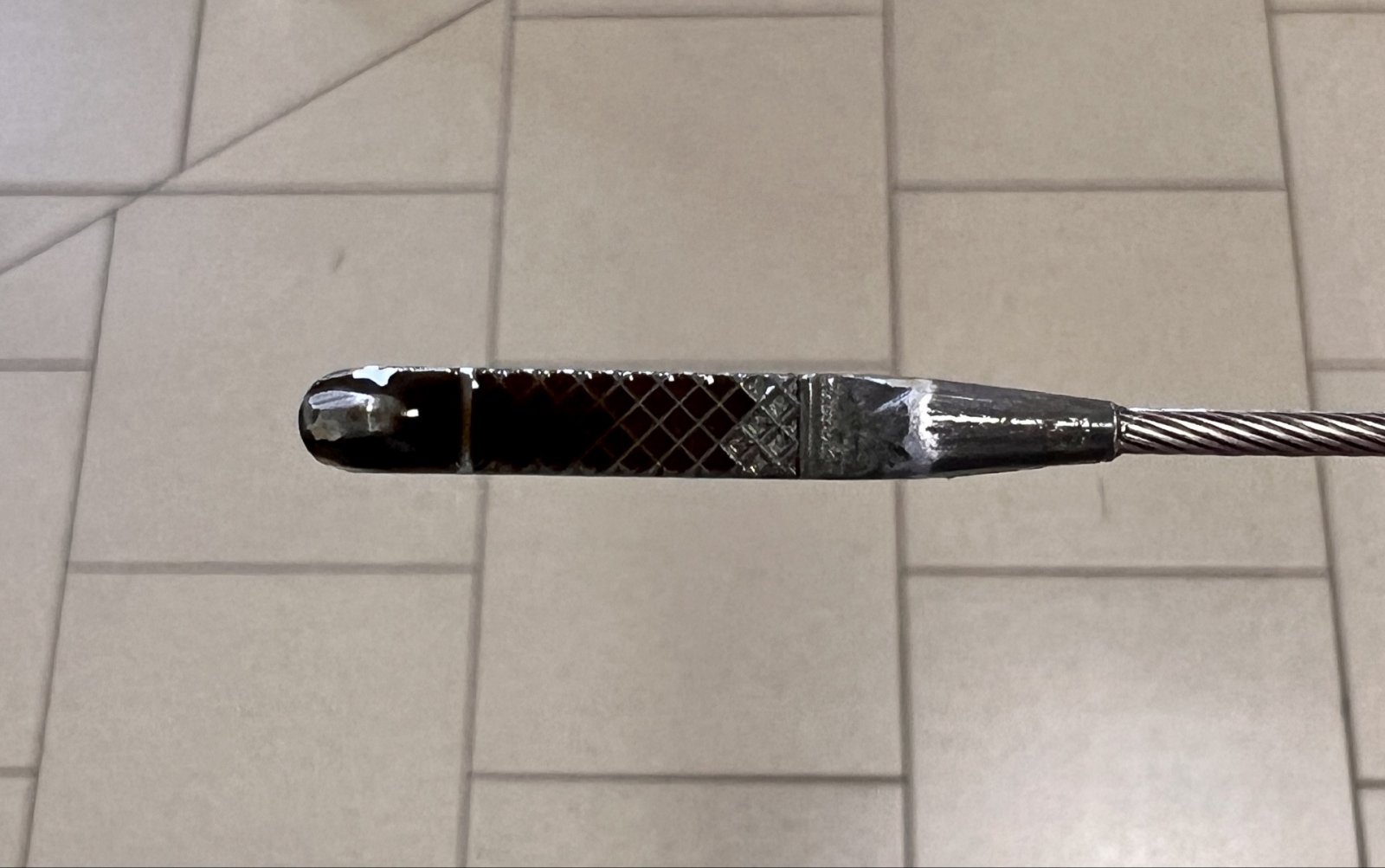

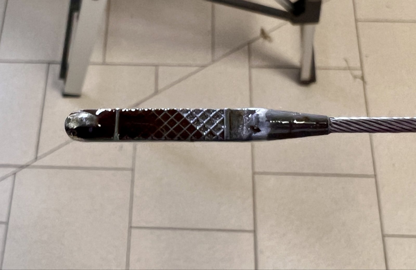

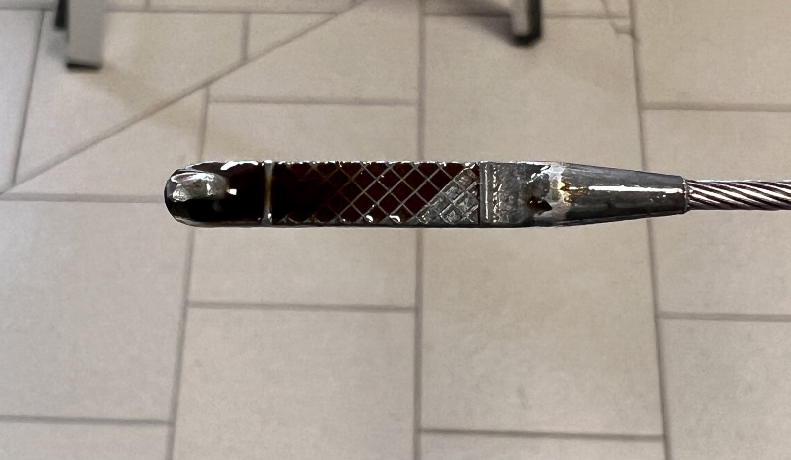

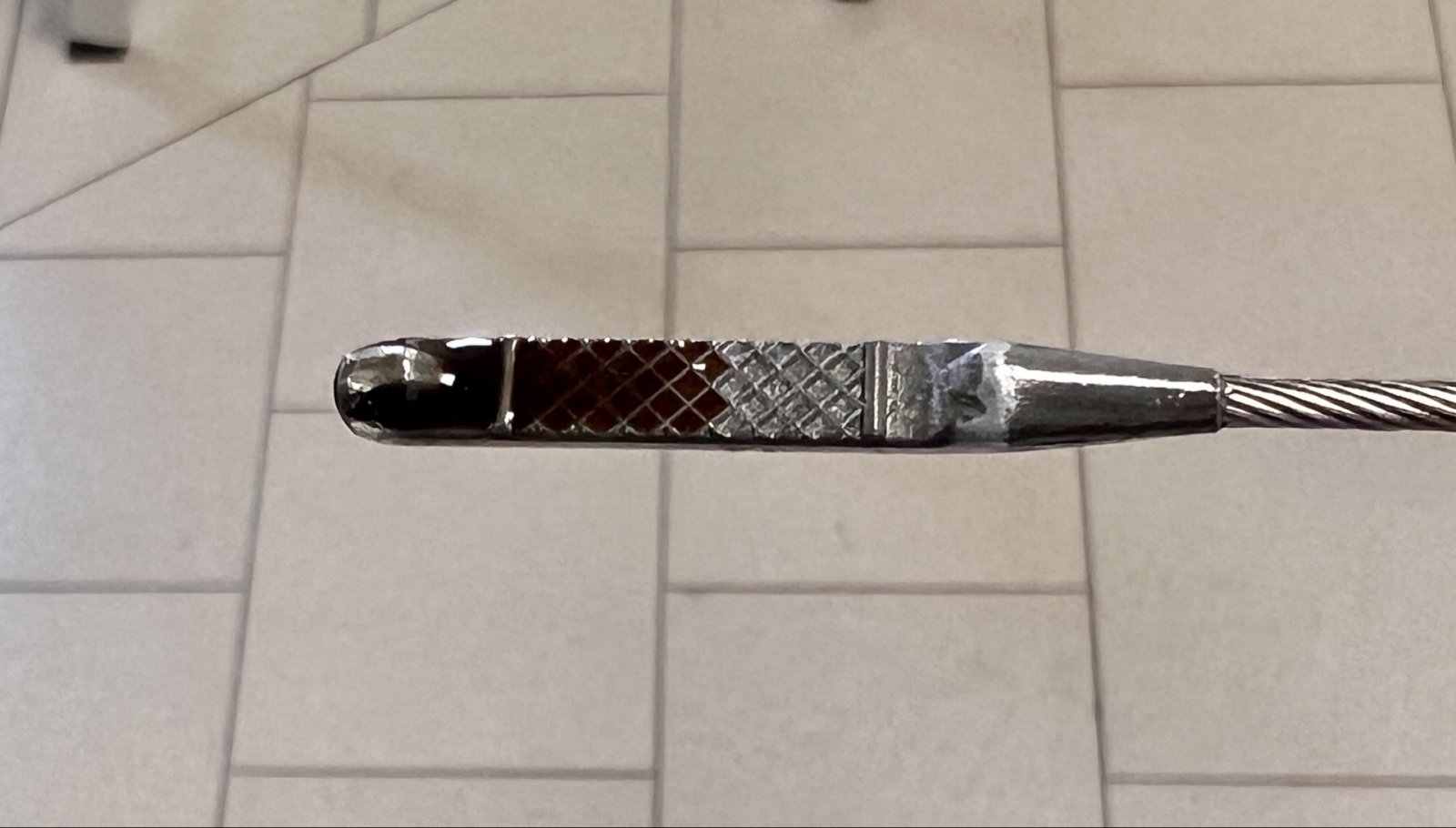

About the length of the dipstick, I will tell you a funny observation of my friend on Yukon 6,2. 23 production. He also likes to observe and experiment, just like me. And so, we have a GMC Yukon, with a mileage of 5,000 miles after an oil change, oil 0-20. The person drives calmly, so the oil consumption is low. And so, there are four photos with four different positions of the oil dipstick. The owner stands at the right front fender. Accordingly, the positioning will be relative to it.
Position 1. The oil dipstick is inserted with the ribbed side facing the wearer, i.e. it is directed towards the right front wing. As you can see in the photo, the oil level is just below the maximum.
Position 2. Next, turning the dipstick 90 degrees clockwise, I found the following pattern.The oil dipstick "looks" at the back of the car: As you can see, the level is lower than in Position 1.
Position 3. Next, the oil dipstick is pointed with the ribbed side to the left: The level is the lowest.
Position 4. The oil dipstick is directed with the ribbed side forward of the carIt turns out that the maximum level shows at Position 1, when the ribbed side is directed at the person standing at the right wing, probably most of us insert the oil dipstick and check it that way. but I suspect that the maximum oil level in this position does not mean the maximum oil level in the engine.

Where are you guys getting that it takes 8 liters vice 8 quarts,,, because GM specifically says 8 quarts or 7.6 liters
And really, holy crap, a five page thread because someone can't read a dipstick (or can't count) and thinks that their truck must be special and is different from the literally hundreds of thousands of other identical trucks out there.
LOL I was reading forever to see if I was the only one catching all this fake news and crazy logic. Manufacturing Engineers measured two hundred times and cut once to ensure 8 quarts not liters was the optimal amount of oil for all of these motors not some or most but all. They all take 8 quarts and if your dip stick says otherwise then the dip stick is either being used wrong or it is the wrong length. No amount of ridiculousness will change the fact that 8 quarts is the right amount unless you make changes to your engine like a bigger or smaller pan. Thanks for this reply because I thought I was the only one scratching my head wondering how much nonsense could be posted on one thread! ✌️

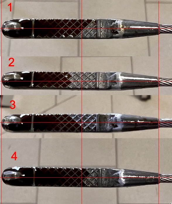

To the degree Possible, I calibrated and aligned your dipstick photos. I would say at the center of the dipstick, positions 1, 3, and 4 are virtually identical oil levels, given capillary action and spread of oil adhering to the crosshatched area. You might argue position 2 is just slightly lower than the others (by one square on the cross hatch area). Position 2 is the outlier, but still by only one cross hatch. Even then, if the scale from the bottom bar to the top is 1qt (32 oz), and there appear to be 8 cross hatches on that scale, then each small square is 4oz (118 ml) of oil. I would say close enough.
But, indeed, it is interesting, must have to do with the angle of the dipstick entering the pan (clearly, since the two measurements taken with the dipstick gauge facing the side of the vehicle are angled on the level).
OR, your friend didn't have the vehicle parked on a level surface (but I believe anyone astute enough to make this observation would be aware that parking on a flat surface matters).
One other note, if you have the air suspension, GM says they do lower the front by 1" vs the back to improve the "aggressive look" while parked.
This is indeed interesting!

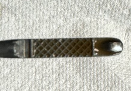

@Kpwweb and anyone else reading this thread.
Below is a picture of my dipstick with the oil level at 9 quarts. Notice the oil level is just above the top line above the hash marks, maybe 1/8" tops. Matches the same level I found my oil level in the engine when I received the vehicle with 8 miles on it and the same as 2 - 2025 6.2l Yukon that had 7 and 40 miles on them. Other members have seen the same situation.
I had to wait until the oil had some color so you can see the oil easier. Have about 2000 miles since the last oil change and the color is still very light.
Notice how heavy the oil is in the hash marks, it needs to be this way, as I mentioned in the picture that Kpwweb posted above, his oil level is about 2/3 low on the has marks. It is not that oil has flowed to the bottom of the dipstick. The oil must have a thickness as seen in the picture below, This is why there is plenty of confusion of the oil level in these engines.
Take your dipstick and dip it in some used oil 1/2 way up the hash marks and look at it, then do the same at the top of above the hash marks and see what it looks like.
You guys do what you think you want to do, I am running 9 quarts with filter change as are my 2 neighbors with their 2025 as they saw the same oil level in their engines at time of delivery. I am sure I will have PLENTY of "you overfilled your crankcase, the crank will aerate the oil and you will have a crankcase full of foam". Well not the case, I have run 9 quarts of oil for the past 7500 miles and never have I had any problems with foam, oil leaks, oil consumption or any other negative effects. If 1/8" above the top full mark has the crankshaft frothing the engine oil below the windage tray we have bigger problems. I could probably put 1-2 more quarts in the engine before the level would be anywhere near the crankshaft.
For everyone else, enjoy running your engine chronically low on oil.
