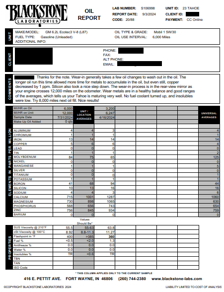

The attached PDF of a recent used oil analysis,,,so far my 6.2 is doing pretty good.

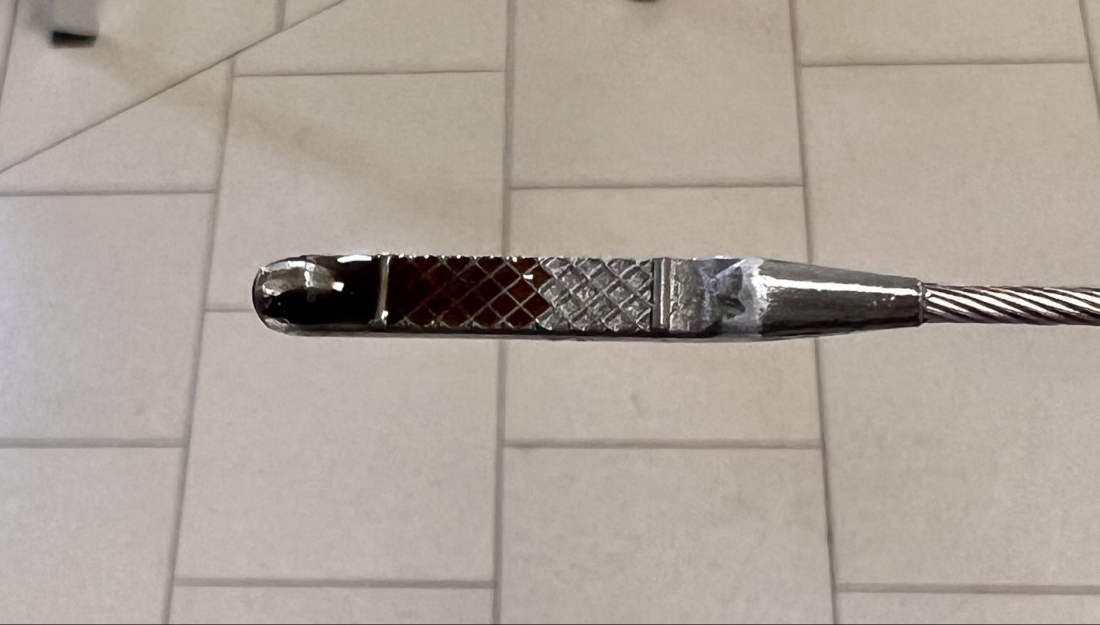

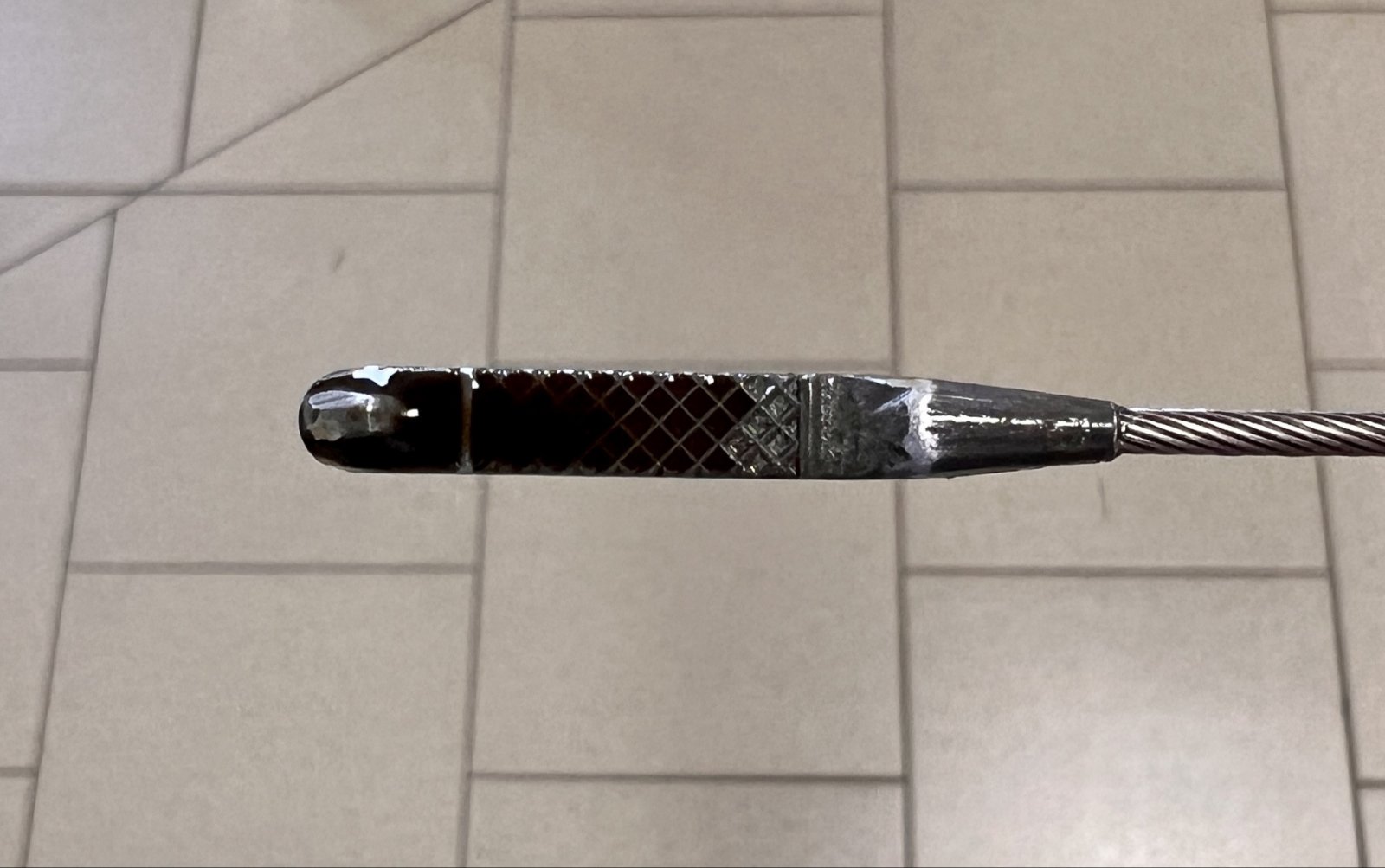

When the oil is completely poured out, not 8 quarts, but 8 liters of oil fit into our engine, this is absolutely accurate))) and 8 liters is already 8.45 quarts. Next, we have a nuance in how to insert the dipstick))) you can do it like in the photo and there will be a maximum level, or you can turn it 90 degrees to the side and we will get only half the level. So most likely 8 quarts, shows half the level in one position, or the dipstick is empty when turned 90 degrees)
