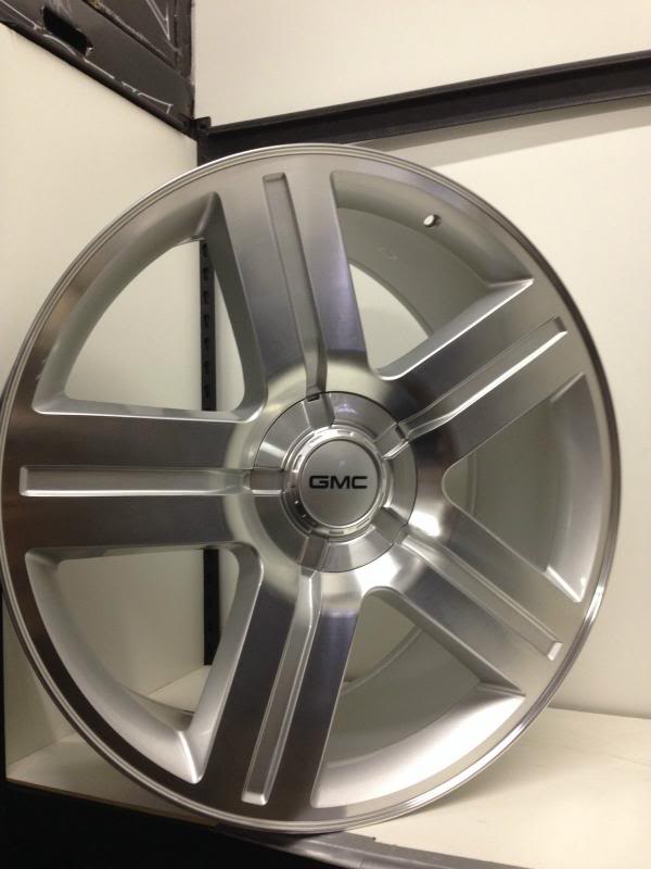

thinking these now

Those would look good!!!

Thats what im thinking. Had my heart set on the TBSS reps, but im not waiting half of the summer to have wheels. They are super clean. I hope that GMC is available in black (like the picture looks)
Thinking of going Hankook RH06s in 275/45/20.

Ya the more i look at them, the more I like them. I had always liked them, but never really thought of them again. I think the black GMC caught my eye lol. Nice and clean

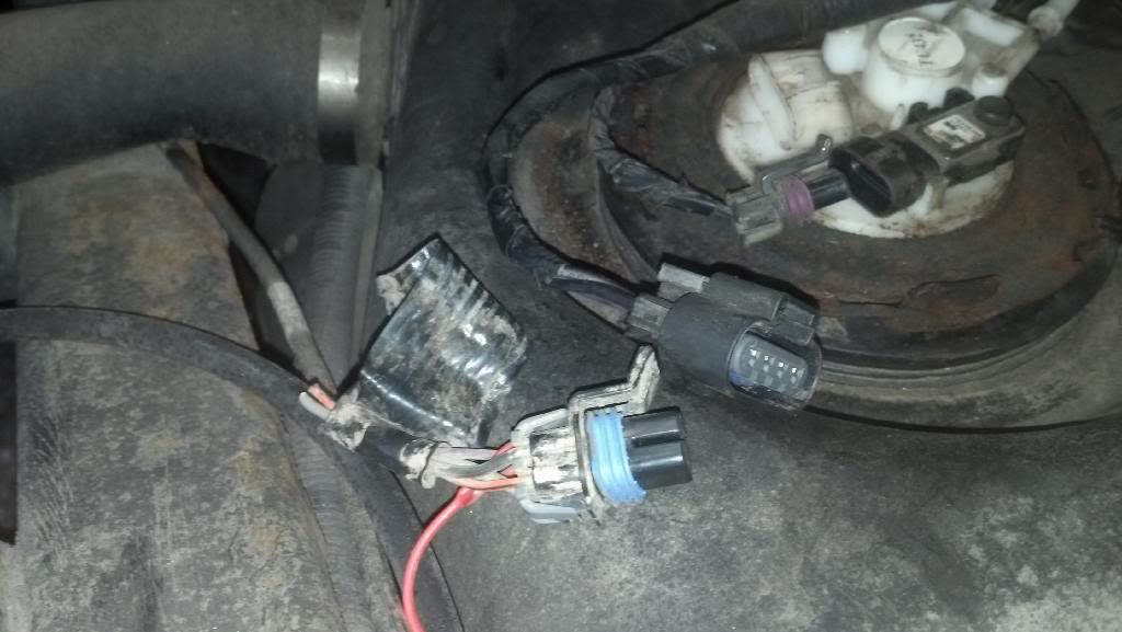

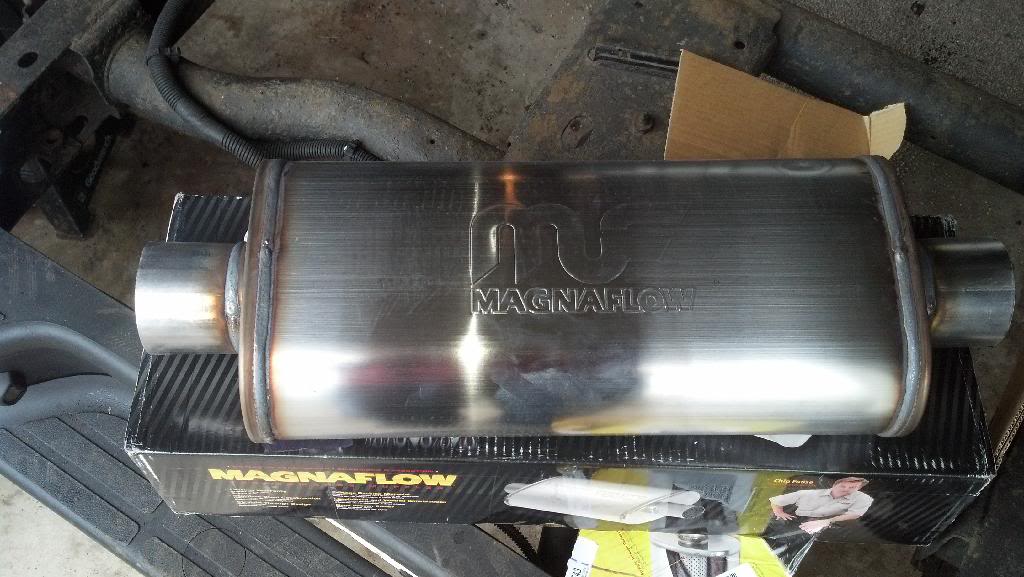

Well wiring swap for the 4l80e is done, fan harness in, fuel pump in and wired with the hotwire kit. Tomorow night it all goes back in and starts getting hooked up. Front driveshaft and Magnaflow 18" 4"x9" 3" in/out is ordered. That should be the last of it. Just waiting on injectors and hopefully start it up next week. Also got the new leaf spring bushings in and shes sitting level.
O ya, I ordered those Texas edition 20s with Hankook RH06s in 275/45/20. Should be here next week. **** I hope im done ordering stuff....until the interior swap

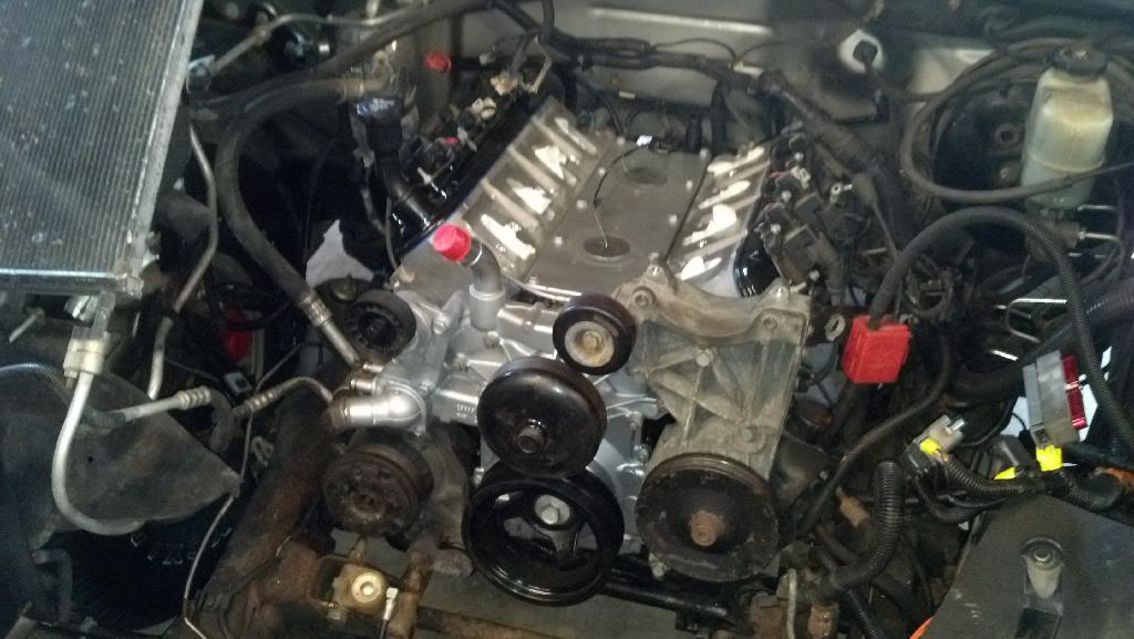

Got the motor in on Friday night. Thats about where it sits now. Injectors should show up on Thursday, so ill spend the next few days getting everything hooked up.
Had to change the oil pressure sensor as my truck is wired for a 1 wire sensor and the motor had a newer style. No biggie once I found a socket big enough to get it out.

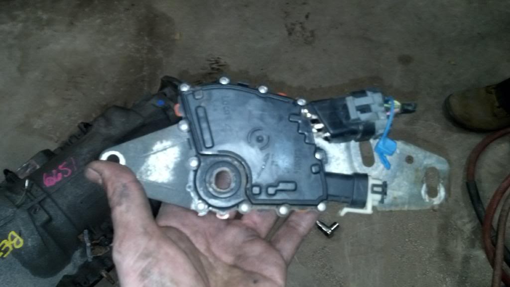

Also had to get a new neutral saftey switch. Realized it was broken as I was about to put it in. The little shit is killing me!
Muffler shower up, along with leaf spring bushings. Front shaft should be here tomorrow. New 02s are in as well. I think Thats everything. Wheels should be here by the end of the week I would think. Hope to be driving it by the weekend and get started on some tuning with Justin.
Pain in my ass. A new style plug was added at some point with a new fuel pump. My hotwire kit needed the old stock plug to work. Luckily I kept my pigtail from a pump swap 4 years ago.

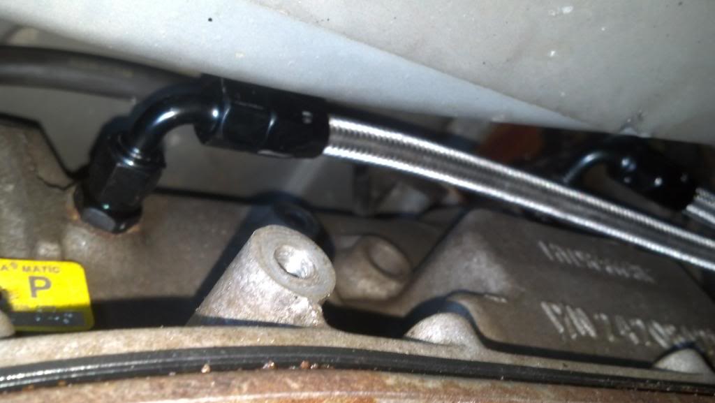

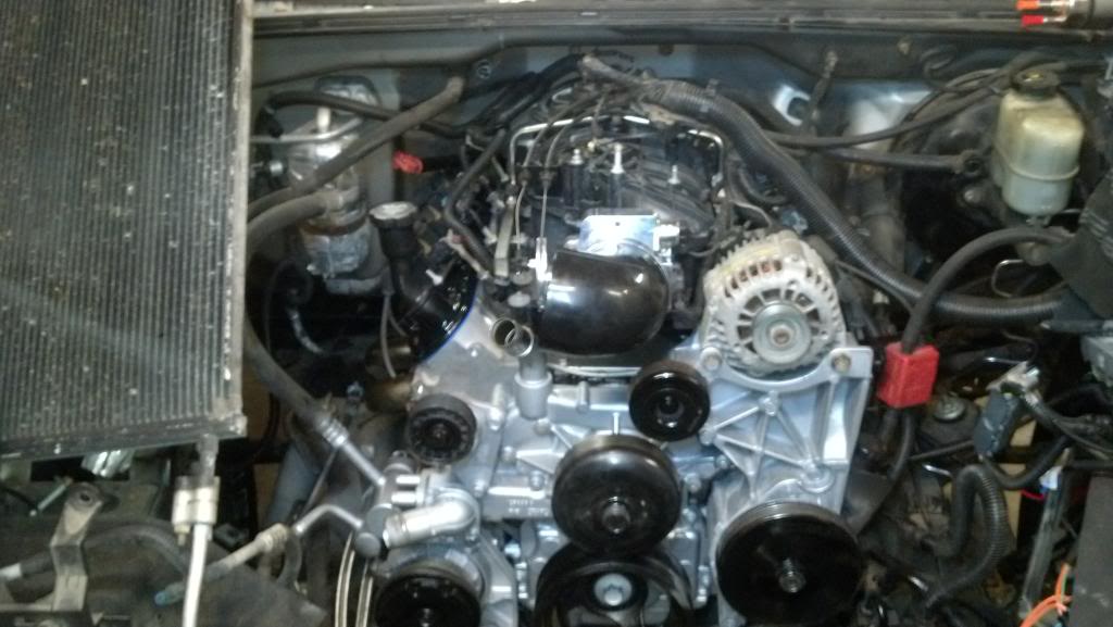

Got everything hooked up underneath last night. Tonight finish the headers and exhaust, trans cooler lines, and get my intake put on.

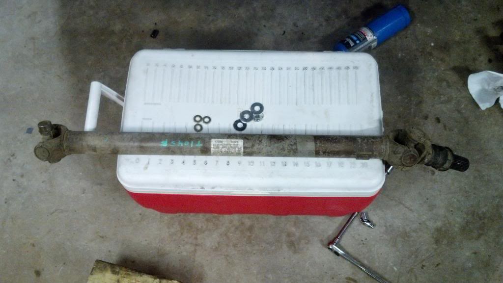

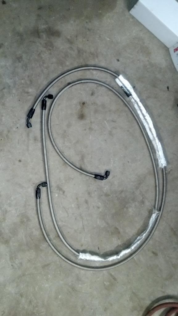

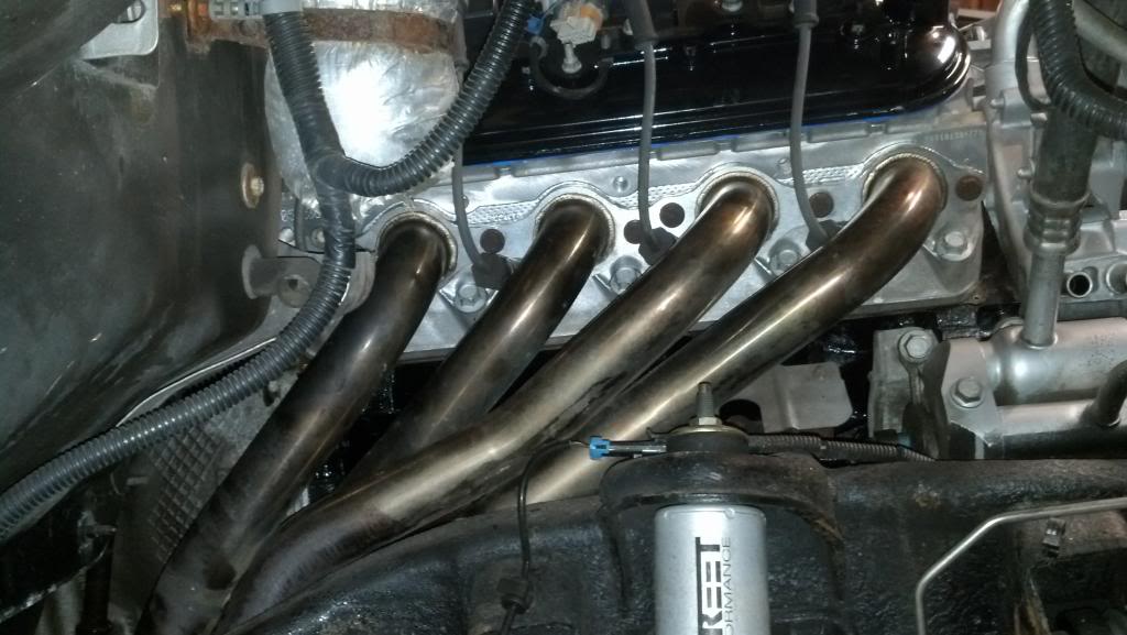

Getting closer. Got the exhaust all in, trans cooler lines made and run, intake on, everything hooked up wire wise. Front driveshaft fit perfectly (from a 2008 Dmax). Had to dent in the headers just slightly to clear the Ujoint cap bolts.

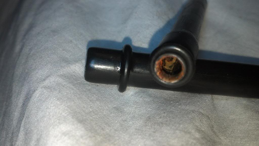

Got my tune from Justin yesterday, so hopefully starting it up today! My new dipstick tube that I bought broke in my hands. It was rusted from the inside so idk what was up with that. Once I have that, should be able to fill it with fluids
