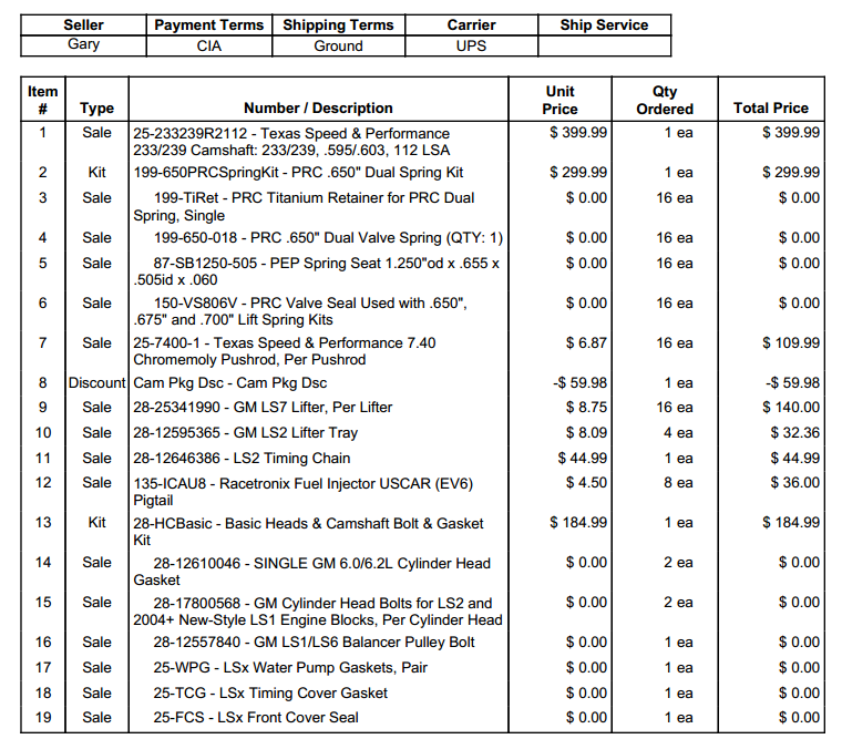

Put my order in with TSP.

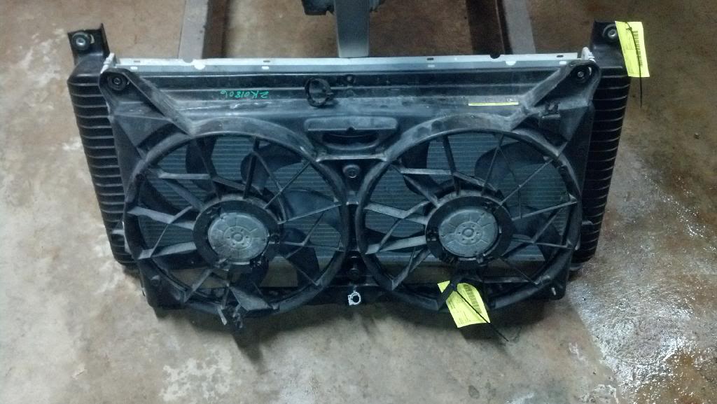

got the lq9 for 1000. Has a bad head so they gave me a deal. only has 45k on it. 4l80e has 50 k i think and that was 800. radiator and fans were $150 combined. I think I came out pretty good. Have a lot of work to do in the next month and a half lol.

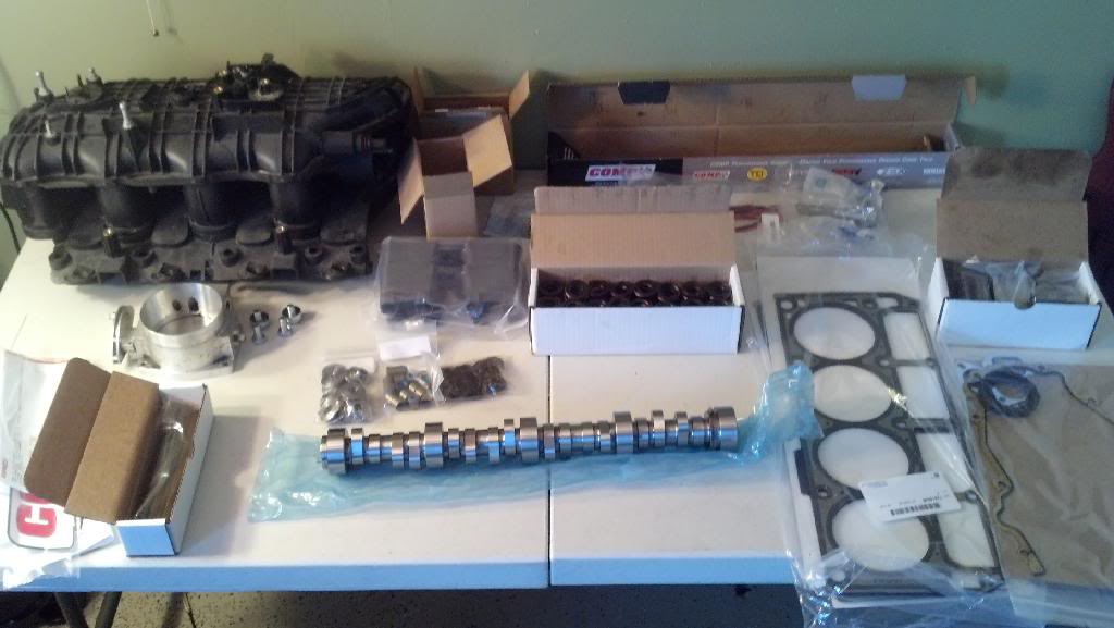

got some goodies today from Texas Speed. Going to begin tear down on the motor this weekend. Should have it all together and painted by next week.

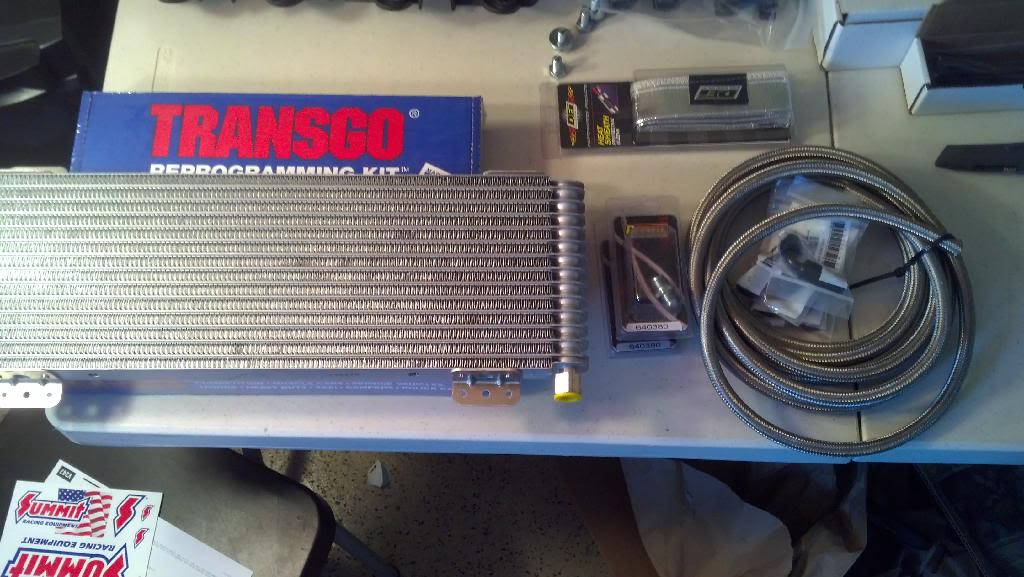

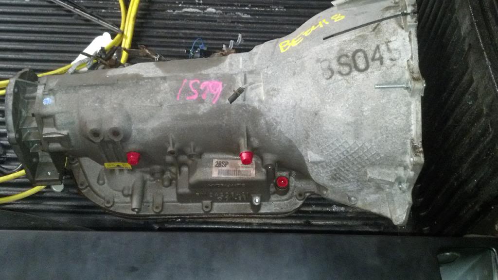

Moar goodies. Think I have almost everything for the trans swap now. Input shaft, bearing and seal should be in the next few days, dropped the driveshaft off last night. Just need to order the new front shaft (from a 8.1 and allison truck) and converter

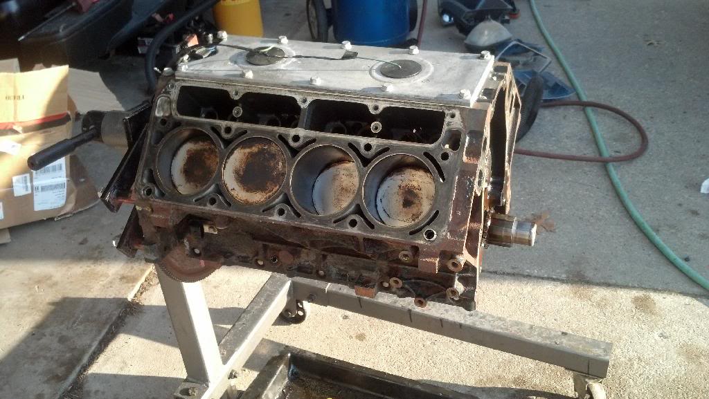

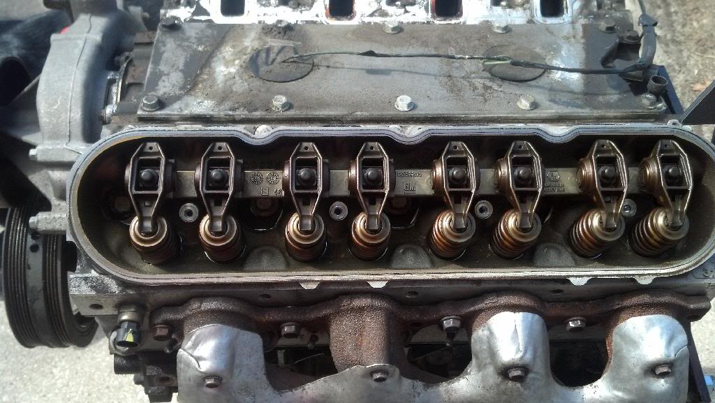

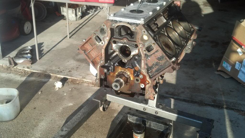

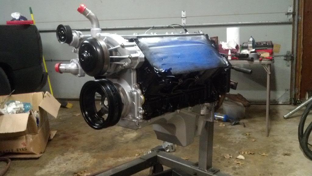

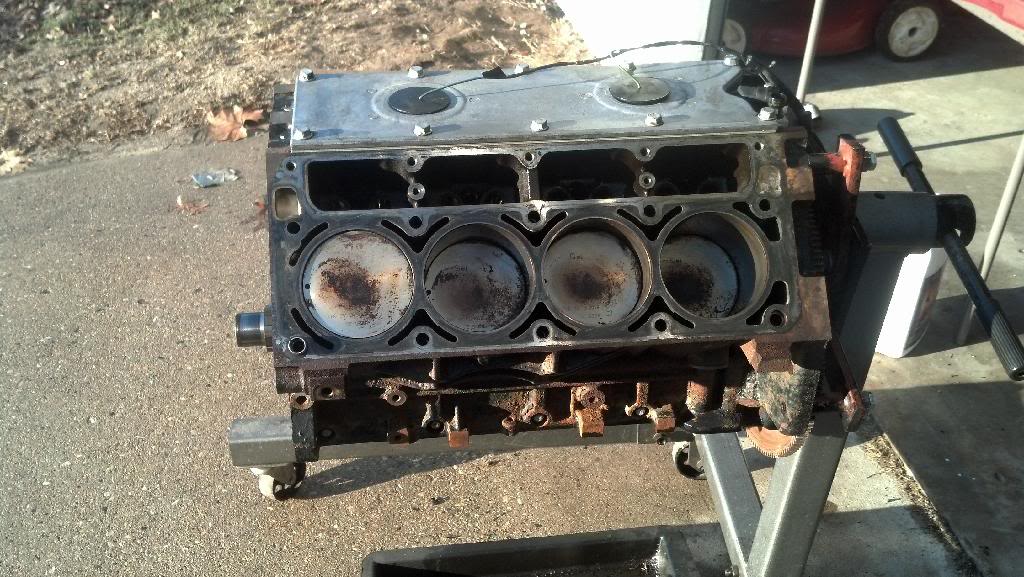

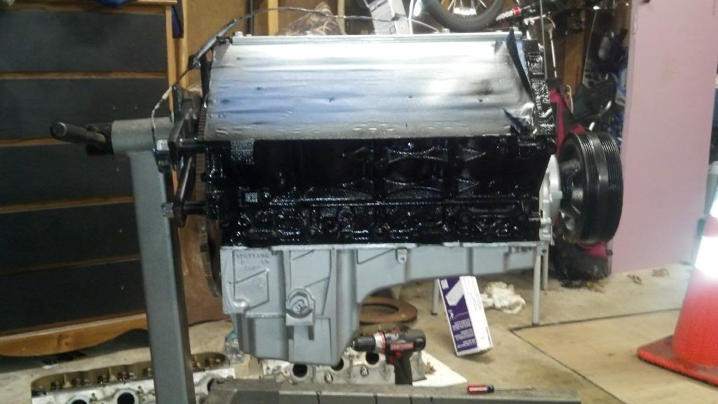

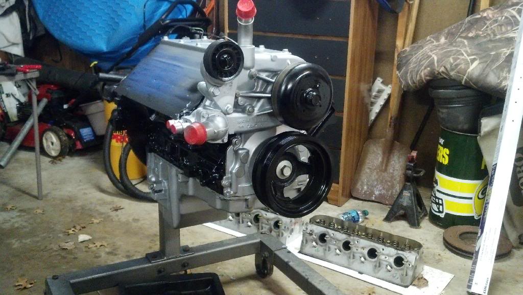

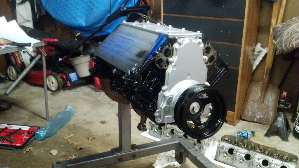

Got the motor tore down yesterday. Got it all painted up today and should have it back together tomorrow. Just waiting on the heads to get back and the motor will be done.
The thing was spotless. I forgot how easy they are to tear down. Had it stripped in about an hour.

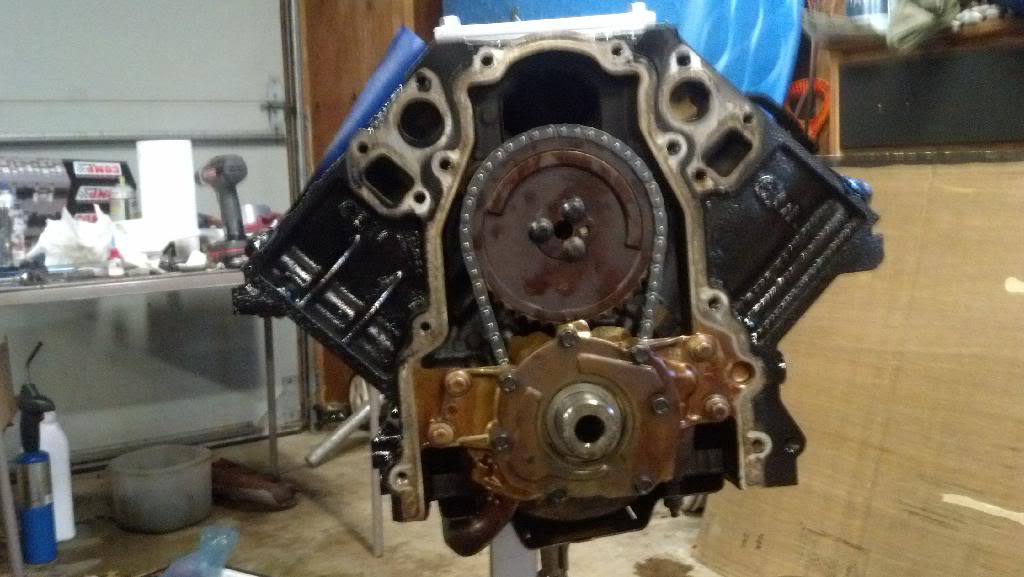

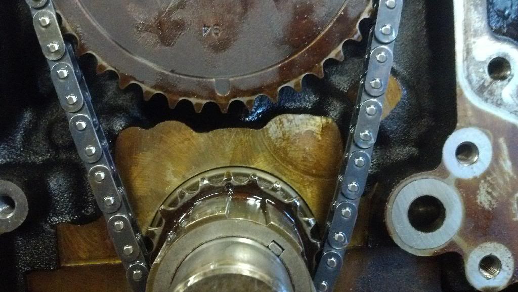

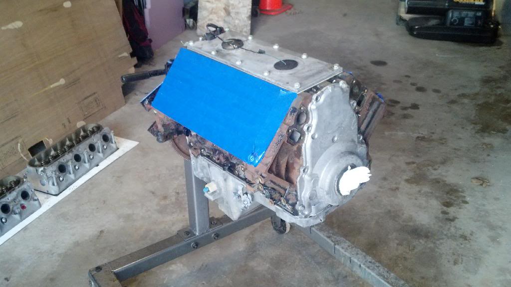

Getting the motor back together. Just waiting on the heads to get done and I should be all set on the motor. Hopefully get the shift kit put in the trans and get the input swapped in the tcase this weekend. Shit might get the motor pulled next week.
Hopefully got this right lol
