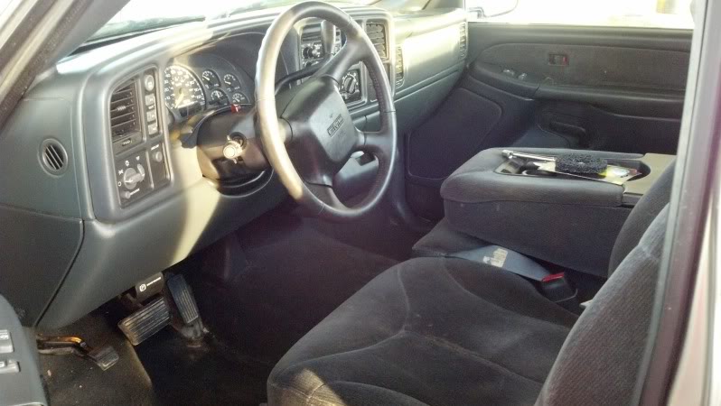

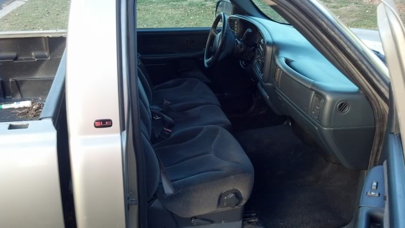

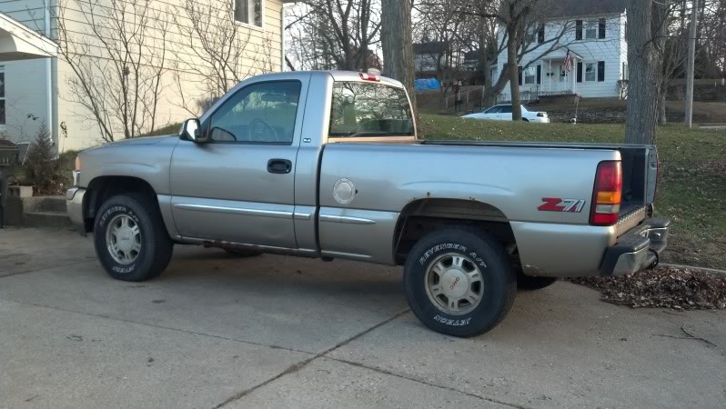

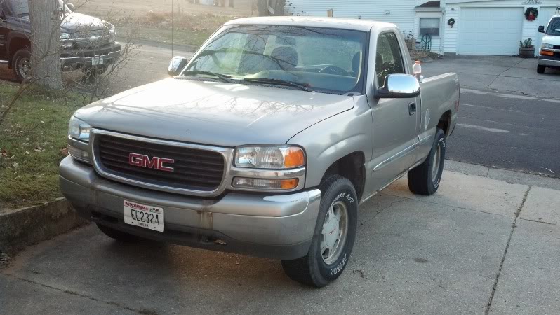

Well picked this up yesterday. 4.8, auto trans, 4x4. Interior is mint after cleaning it up. Body needs rockers but the rest is solid. Picked it up for $800. Has new brakes all around, new u joints as well. Going to be a fairly slow build depending on funds..

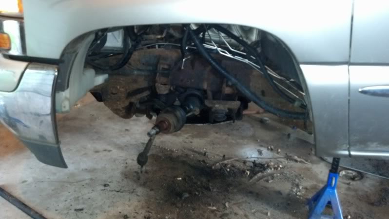

Wow its rotted the **** out bro. If i were u i wouldnt touch and bolts or atleast put penetrating oil days before yoy want to mess with them...

lol its actually solid as ****..needs rockers, cab corners are solid, doors have no rust, surface rust over the wheels on the box but its solid underneath, that will be taken care of with a wire brush this weekend. Other then that, there is no rust on the body..guy in town is gonna do the rockers for 250 and im doing the rest.. bed is like new as it had a topper on it, engine bay is super clean as well
ya it was a hell of a deal..was gonna buy it last year, but the kid wanted too much..came up to me in the bar and said 900, got it for 800..couldnt pass it up

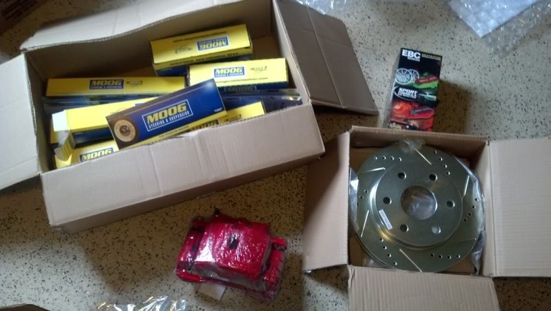

Little update. Final plans are a 4/6 with completely new suspension, built 6.0 and 4l80e. Truck should be a fun cruiser, high 12s in the quarter for now. Not sure what im doing for wheels, either some stock 20s or some TBSS 20s. Need to decide on color before i choose a rim if not going stock
Parts showed up today
Moog front end parts -tie rods, pitman, idler, idler bracket, camber kit, sway bar links
Powerstop calipers and d/s rotors,EBC 6000 series Green Stuff pads.. still need to order for the rear, wasnt sure if I was keeping the 10 bolt or not
Drop kit on the way- 4/6 from Tony- DJM upper and lower arms, Belltech SP shocks all around, flip kit and notch
Motor plans- LQ4 with 243 heads, 23x/23x cam, injectors, lifters etc..headers into a magnaflow with a 3" cutout
4l80e swap with a 3600+ converter
Keeping the 10 bolt with a tru-trac..should hold up just fine since most launche will be in 4x4

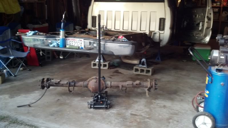

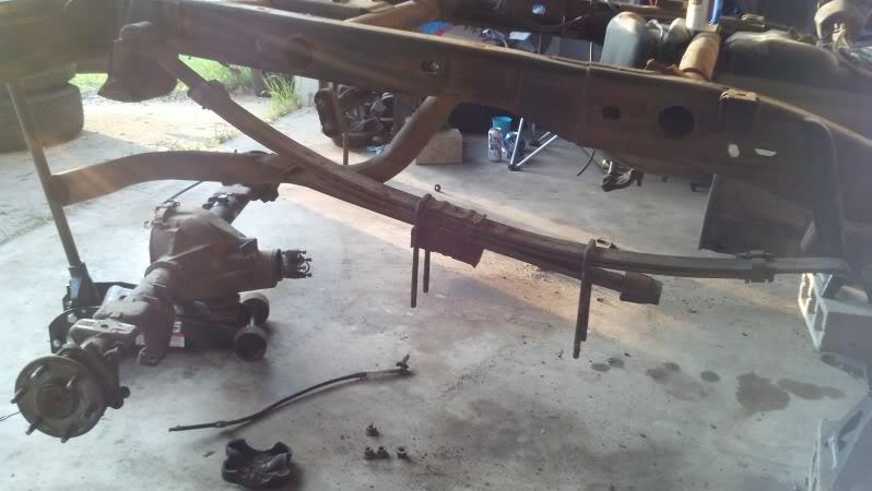

Got the bed off yesterday. Tore all the brake lines off, spare tire, hitch, calipers, rotors and basically everything off the frame. Going to get it cleaned up and some paint on it. Got the t bars unloaded and the keys out, pulling the front end apart tonight. Ordered rotors and calipers for the rear as well, I didn't know if i was keeping this rear end to start, so that stuff is on the way.
Depending when everything comes in, im hoping to have it on the road within 2 weeks. I should have everything painted and cleaned, just waiting on parts to show up and install them. I think i saved about 100 lbs just from rust and dirt falling off the truck lol

Suprisngly only broke one bolt and that was the one that holds the brake line junction on to the rear end..everything else came off pretty decent. Think i saved 100 lbs from dirt and rust falling off lol..
