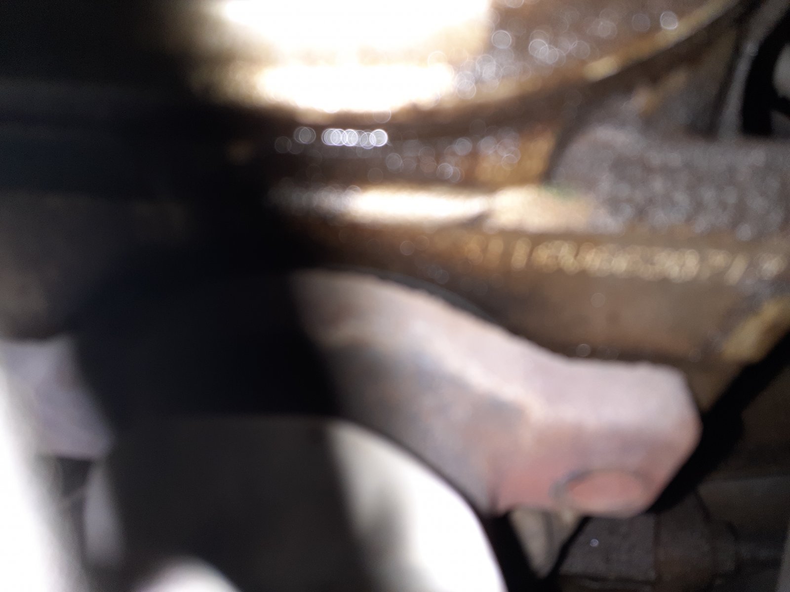

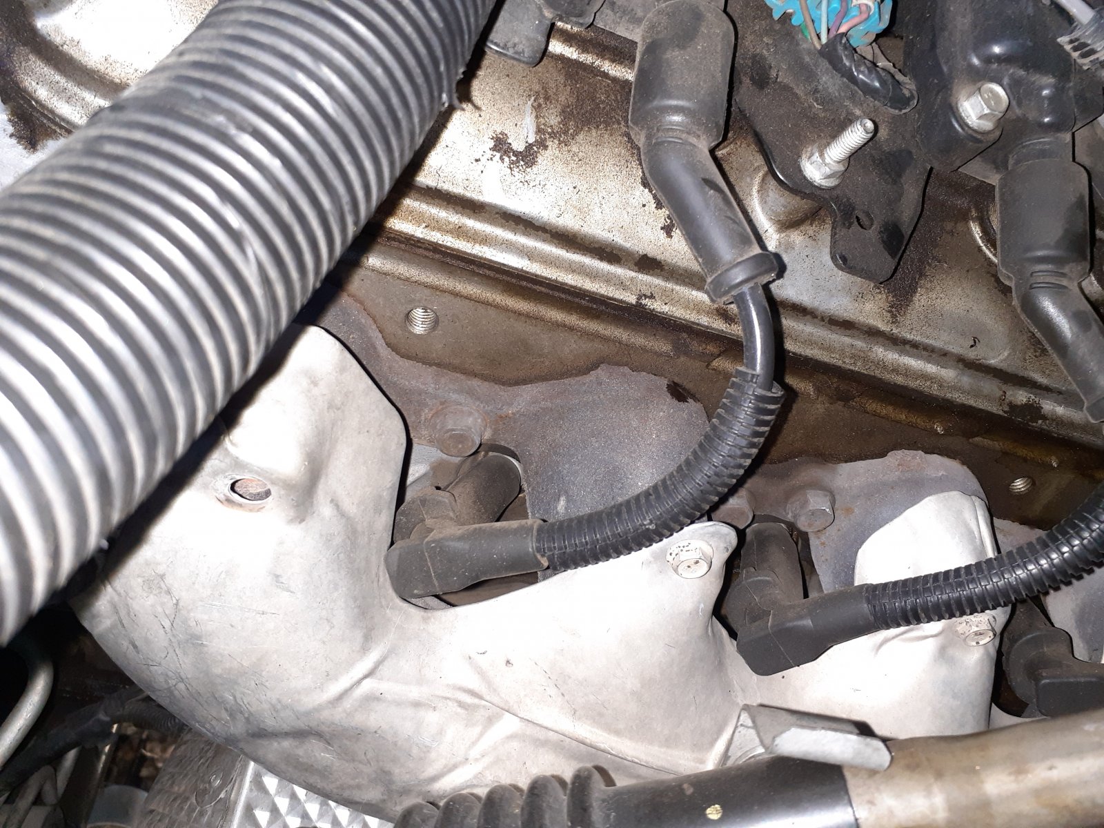

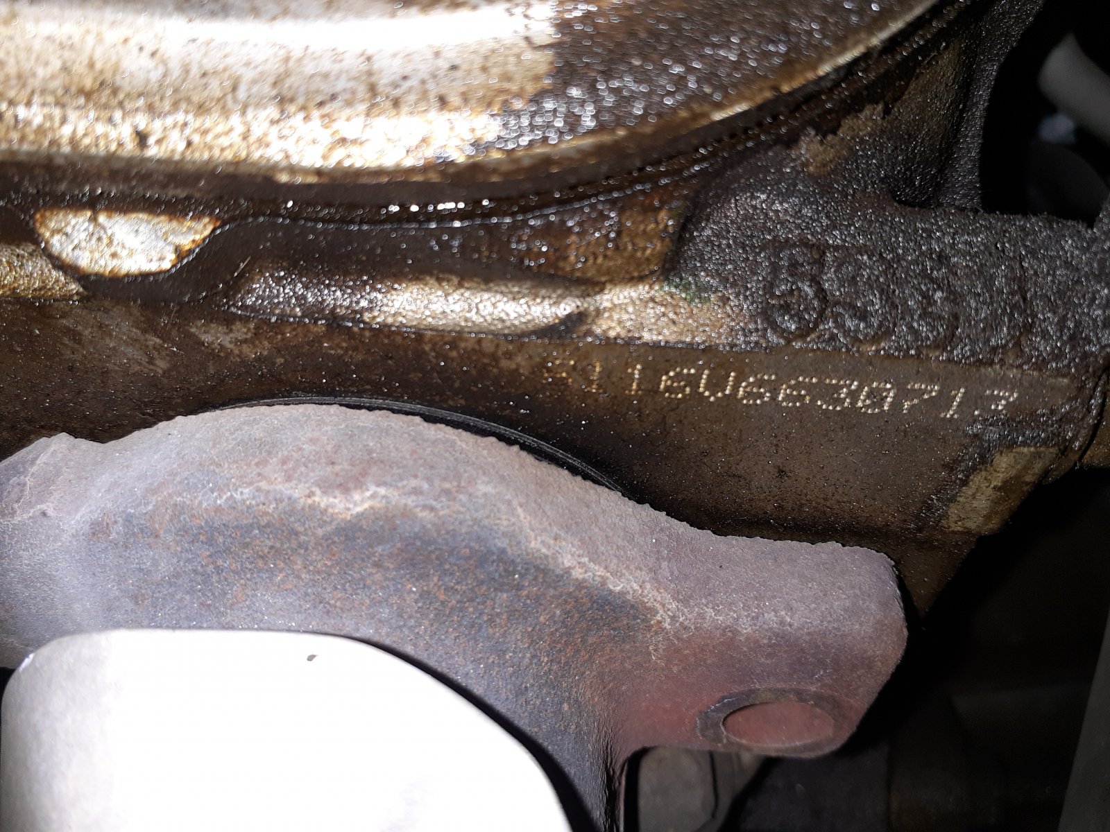

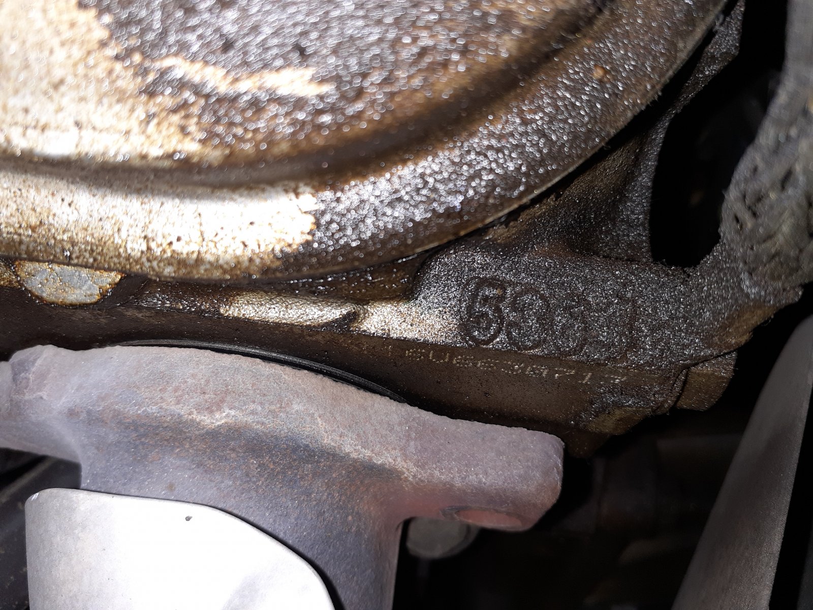

So i believe i found what is the broken exhaust bolts that might be related to the ticking im talking about I've read that this might be the cause

That will do it.. but usually its on cold starts, and then as the metal expands from heat, the ticking noise goes away..

It is a very common issue, I agree you likely have found the source of the ticking noise.
