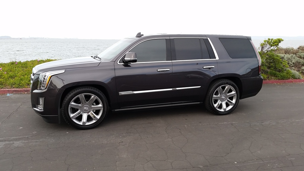

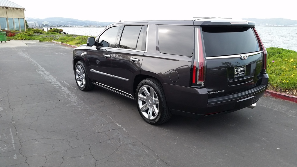

KIT NOW FITS BOTH 2WD/4WD/AWD 15 UP GM SUVS!!!
Been doing this set up for a few months now and since I got my 2016 Escalade I did the same on it and very happy with results. I've tried other rear set ups but as always the 5305 coils do ride the best which has been proven on this forum for years and rear will not be way high like you see on the other kits out there.
My kit consists of
Belltech front drop spindles (2wd or 4wd/awd)
Rear Belltech 5305 Coils
Rear Belltech Shock Extenders
Rear 1" Spacer
My Rear Autoride Links
Rear Shorter Swaybar Endlinks
Rear Bumpstops for Free travel mod (manditory for 4.5 drop) these bumpstops attach thru existing holes on axle pad
5/8 heater hose tubing (more on that below)
$635 shipped to the lower 48 states
LINK TO PURCHASE
http://tbssowners.com/store/index.php?act=viewProd&productId=609
So i know I am late to the show but hey im here now!!!
