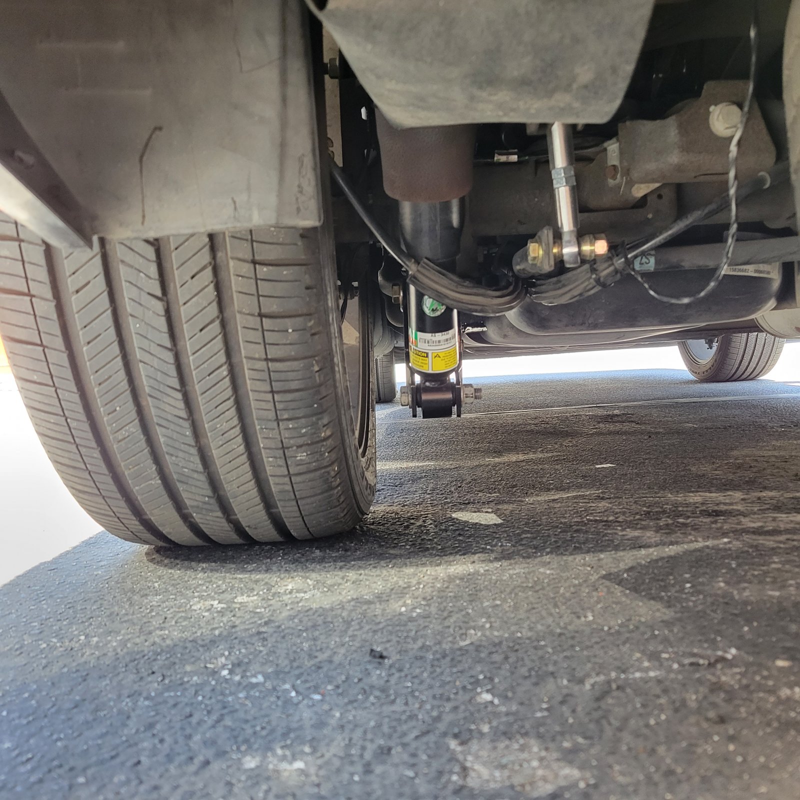

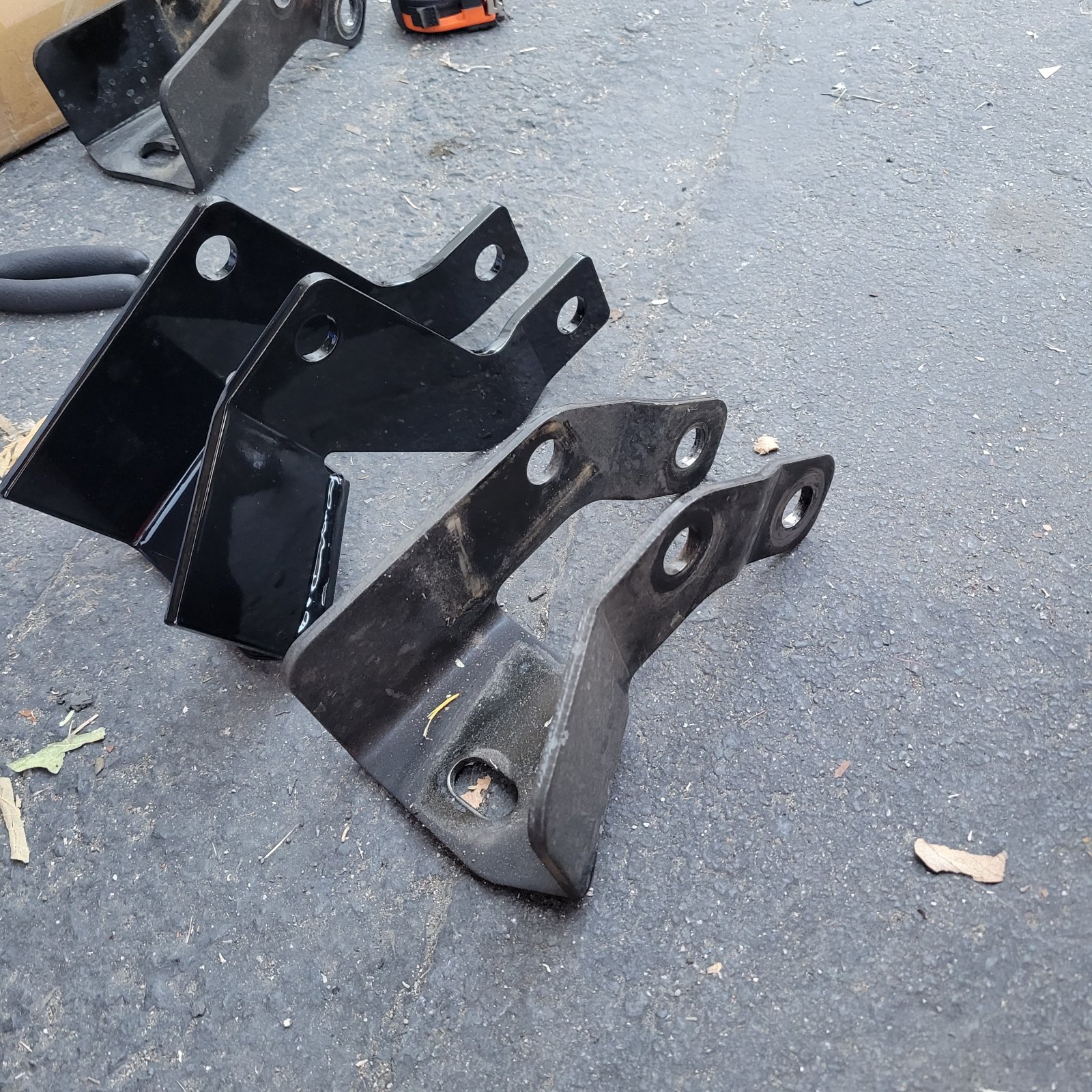

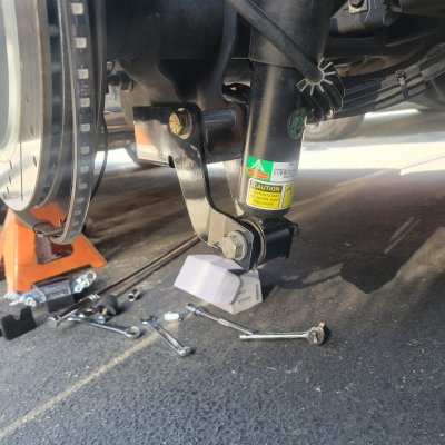

The rear of my truck rides really rough. I searched and found some good suggestions/information on these forums but none fit my exact issue/question. I installed the Belltech 2-3/4 kit on my 2007 Escalade AWD with stock 22's on 285/45/22 Michelin tires. I didn't install the spacer in the rear so I have the 4" drop in the rear. I also did the free travel mod and used the shorted bump stops (https://www.amazon.com/dp/B000CN9DFS?psc=1&ref=ppx_yo2ov_dt_b_product_details) on the axle pads. I recently bought these bump stops (https://www.amazon.com/dp/B00FMX69TQ?psc=1&ref=ppx_yo2ov_dt_b_product_details) since they are a little shorter and softer material but haven't installed them yet. I also installed new Arnott struts (AS3430) in the front and air shocks (SK2954) in the rear from Rock Auto. From post's I found here, it seems my Arnott rear shocks might be bottoming out due to the 2" shorter amount of travel. I read that the Belltech Street Performance 2410FF's would be the replacement shorter shock for my 4" drop in the rear. I have the shock extenders installed in the rear.
My ultimate question would be, can I just buy these 4" shock extenders to get all my stock travel back in the rear (https://www.ebay.com/itm/155411881611) so I can continue using my new Arnott shocks? Thanks in advance for any advice/help.
Solved. I ended up buying the 4" shock extenders and they brought back the factory ride. If you don't plan on buying "drop shocks" or need to retain the stock air shocks for towing, these 4" extenders keep your factory ride after lowering.

The issue you describe sounds exactly like the problem I was having. The 4" shock extenders I listed above are only $40 on ebay and can be returned within 30 days if they don't work out. I would highly recommend trying them. I'm guessing you already have 2" shock extenders on your Denali. Make sure these look like the ones you already have since they are listed as being for 2000-2006 model years (even though they fit on my 2007).
Maxtrac also sells a 4" shock extender: https://www.amazon.com/MaxTrac-401004-Shock-Extender-Coils/dp/B08CHZ34L1/ref=sr_1_5?crid=2FH3CMWY8B0J4&dib=eyJ2IjoiMSJ9.Cyd8z-pD_aqEBKHs1Da6FOUUm-LVPKi_m9rKFBjiGDgr7F-uCRfpNPvS5V1fFWHynKmekzZTsfgGsbxgIyNapsokAIvUT-ma3wewYGf6R3AKbkcK0UH2KGJ6NByw8y4FD_ilEnPZ6Z0s7CP7ZTEccnk-M-7m76BIlaRI__G4LIGmlzUOY7yPbZZkAzAhqBBdpdI7xRczmdMxzu0f6qKLzNqg4bwXxWFCksJKXbvVkck.IOVnptz8FEQkkmE14P_zYx7T4EDG7uWOHOzHNp691GM&dib_tag=se&keywords=4"+shock+extender&qid=1724429900&sprefix=4+shock+extender,aps,137&sr=8-5
You could also buy a 1" spacer to bring your rear up: https://www.amazon.com/Takeo-Leveli...-2676-104-&vehicleName=2007+Cadillac+Escalade

No, 4" extenders to give you back lost shock travel. In my instance, when I lowered with the Belltech 4" lowering springs in the rear, I lost 4" of shock travel. The included shock extenders in my kit dropped the shock mounting point 2", giving me back 2" of the 4" of lost shock travel. I was still short 2" of travel. By installling these 4" shock extenders, I gain all my shock travel back after 4" lowering.

I wanted to thank you for your help! I put the 4” rear shock relocation brackets that you recommended and the truck rides much better. It’s almost a stock ride near perfect
Thanks again
