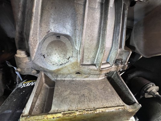

Something else, I don’t think my Tahoe has an oil level sensor. I can see where one would go on the oil pan but there is just a metal plug in it instead. That sound right?

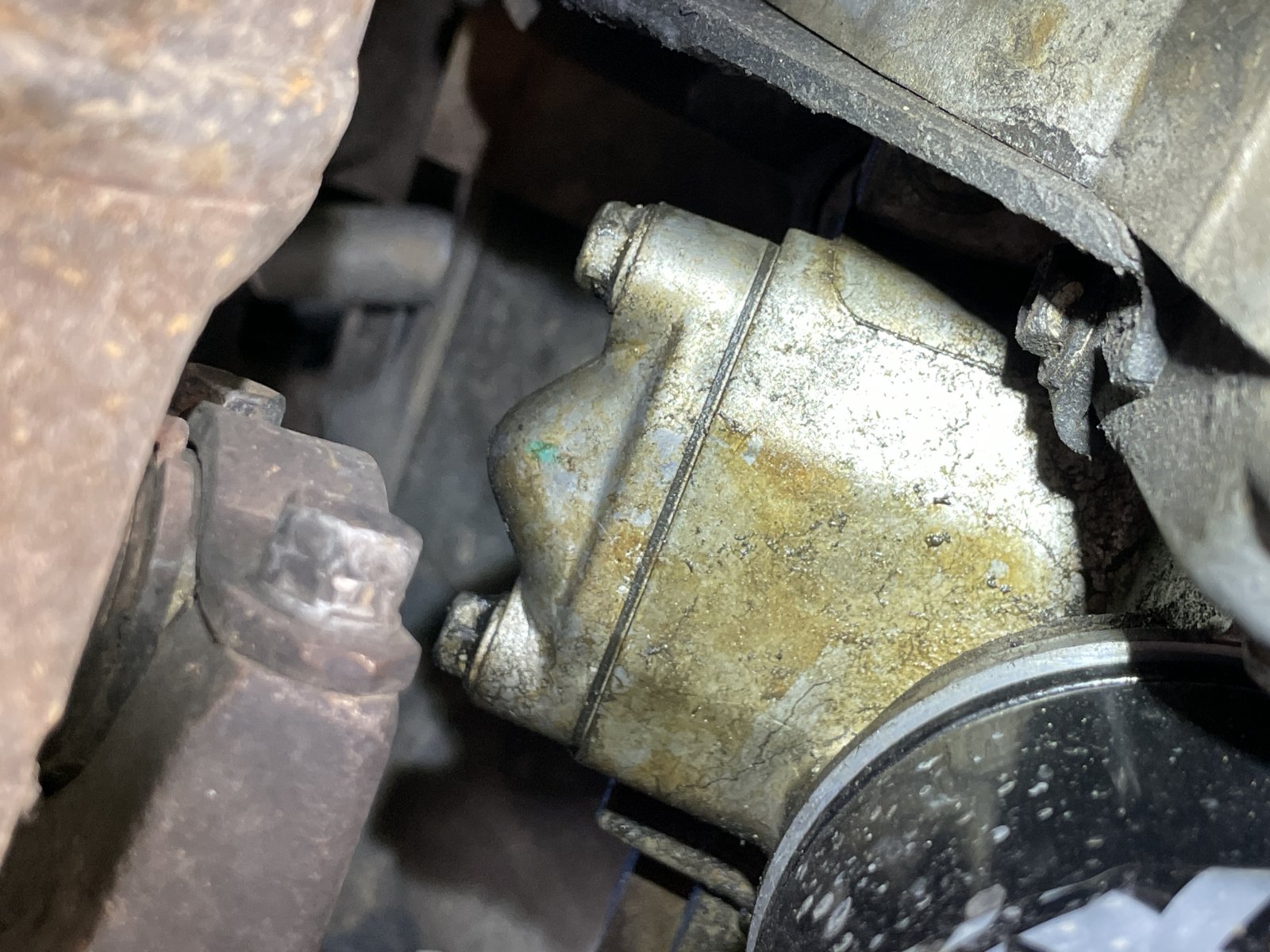

Just crawled under the Tahoe and I do have some sort of oil leak. Thinking either oil pan gasket or front main seal. Oil filter is dry, oil cooler plate is dry, rear main seal area is dry.
Thoughts?

that's not enough of a leak to loose 2qt's.
