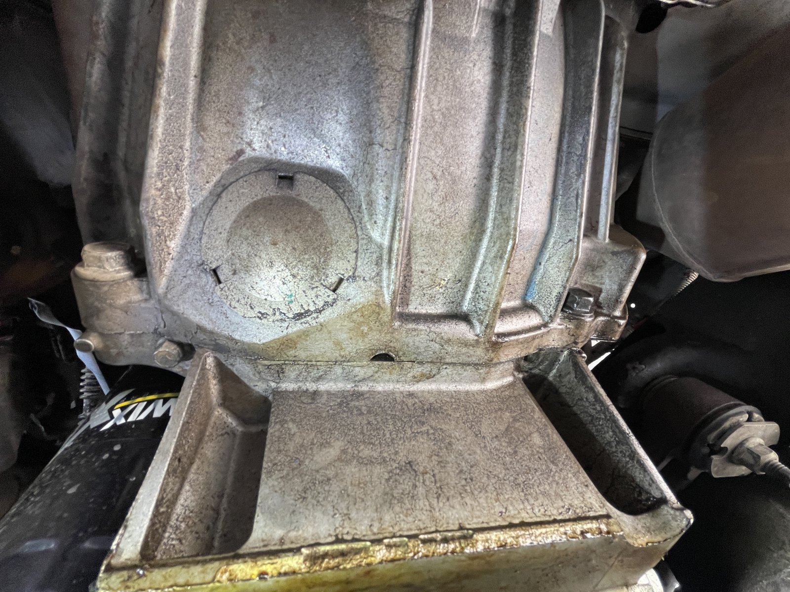

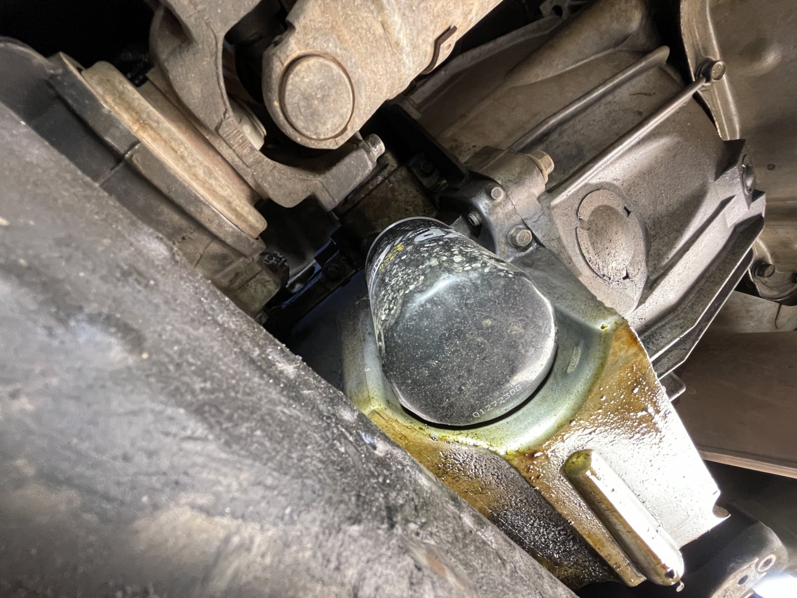

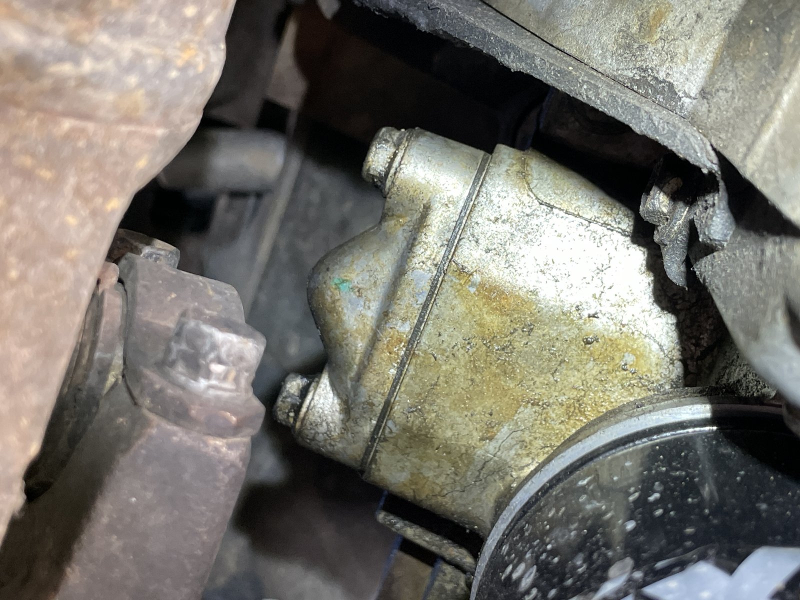

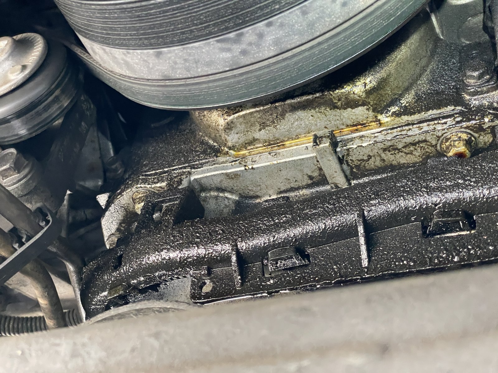

Just crawled under the Tahoe and I do have some sort of oil leak. Thinking either oil pan gasket or front main seal. Oil filter is dry, oil cooler plate is dry, rear main seal area is dry.
Thoughts?
