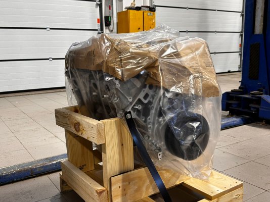

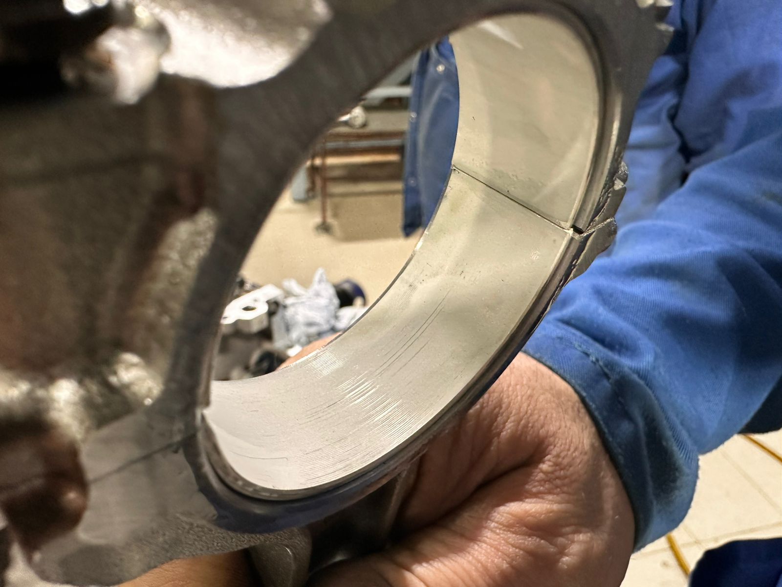

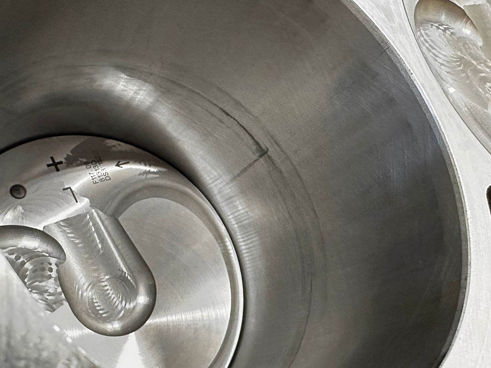

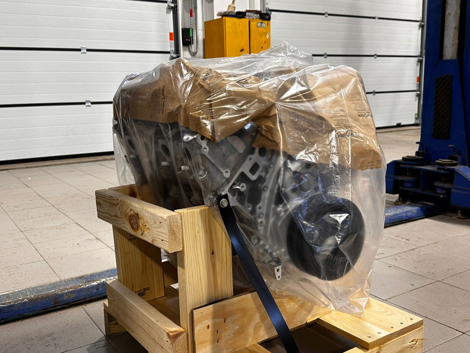

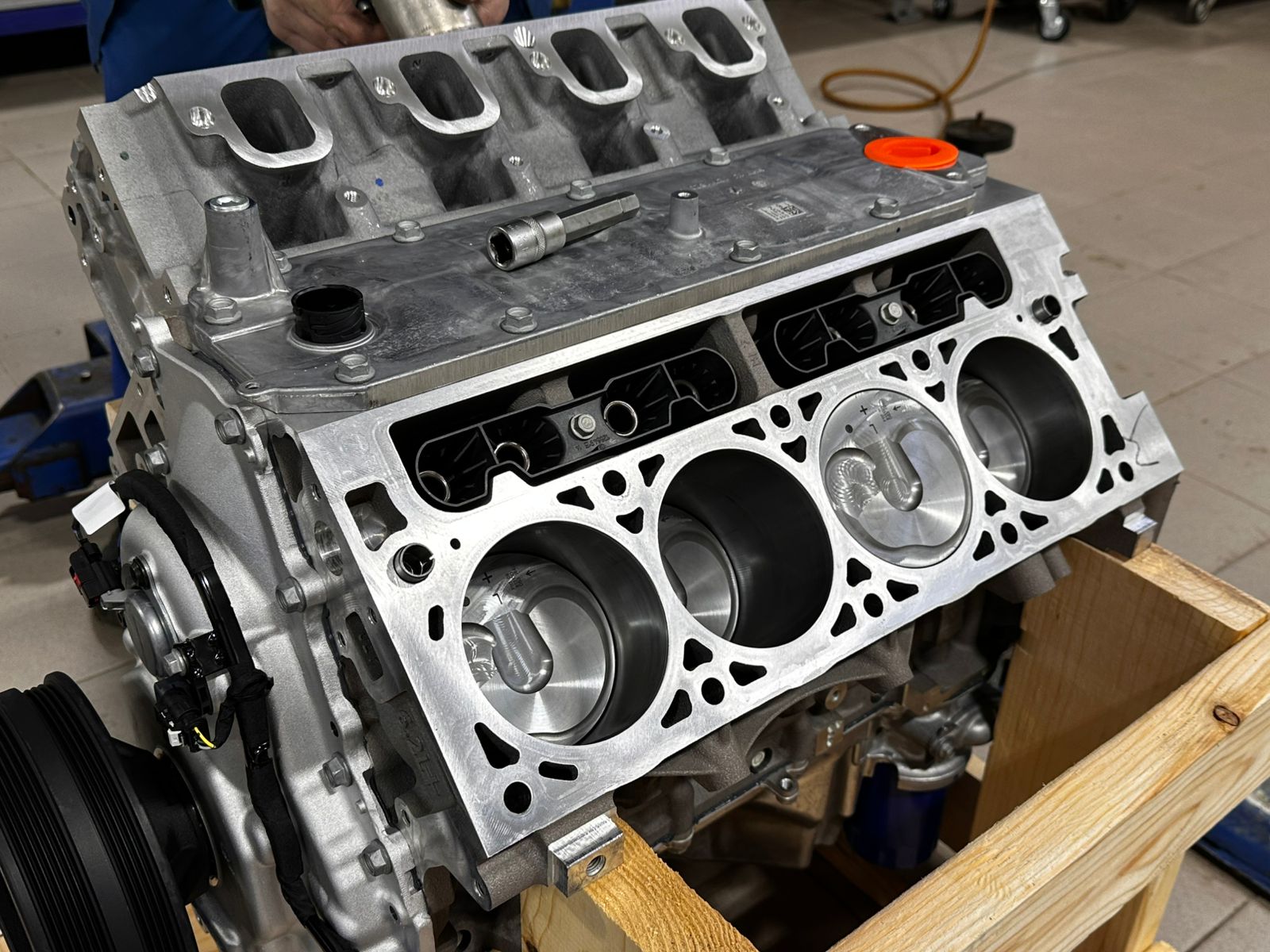

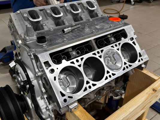

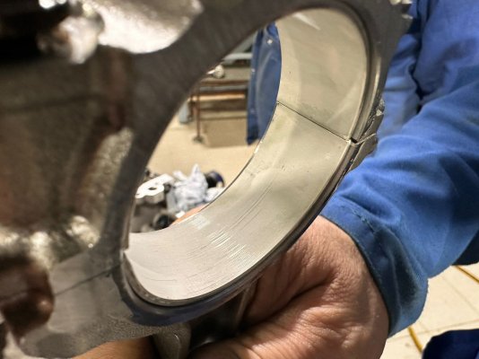

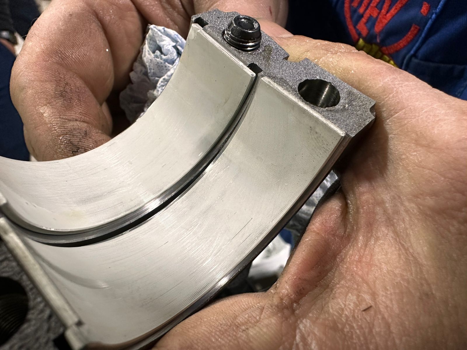

Look, this is a photo of a new engine that just arrived for service the other day. Engine out of the box, mileage 0 km. There are already scratches on the cylinder mirror and marks on the liners.

You clearly have pictures of a new engine. While I am not there to personally inspect and "feel" the finish, what I am seeing is not significantly concerning. Could things look better, sure they could.
So understand at the engine assembly plant they "Cold Test" newly build engines by spinning them with a large electric motor and they measure intake and exhaust airflow as well as the torque required to turn the engine with the electric motor to determine if the build is within the spec range they expect.
I assume this "Cold Test" is performed with oil in the crankcase, but it is unclear if the oil system is pre-primed or if the "Cold Test" starts at a slower RMP to build oil pressure then to increase RPM after a specific number of engine revolutions. No idea if the oil is pre-warmed before the engine is filled with oil, I hope is would be.
Seems that there is something either with the initial build on these engines or something with parts that may be causing problems. I would be interested to know if your shop actually checks the original build bearing clearances with Plastigauge to figure out if the engines bearings are too tight or too loose.
The fact of the matter is that our service disassembles a completely new engine from the box, grinds out the gaps, checks all the tightness and reassembles the engine)))

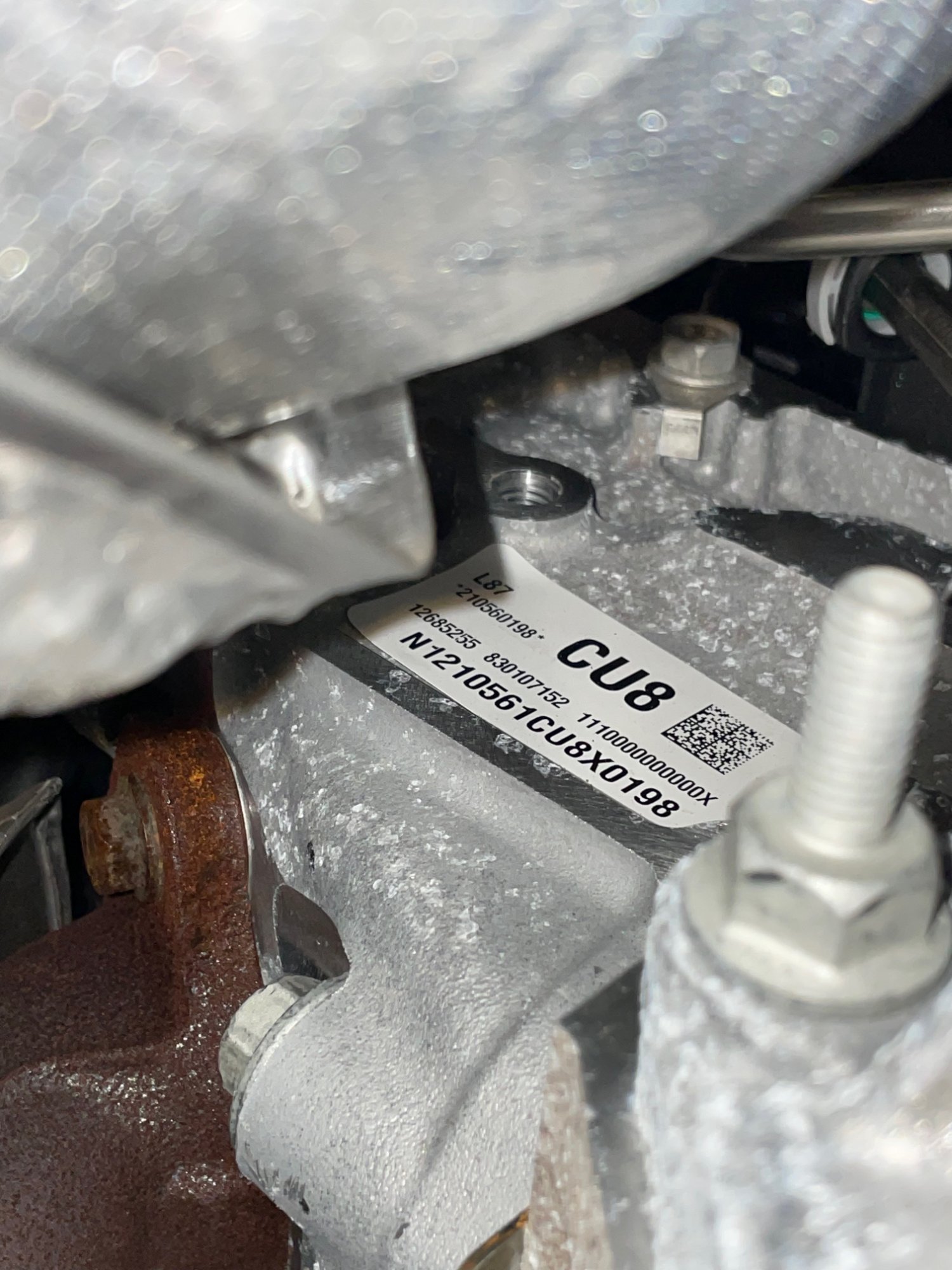

You should have your guys track the build dates on the engines to see if they find changes and improvements.
The build date is a Julian date on a paper tag on the rear of the drivers side cylinder head as least for engines installed in vehicles. Not 100% the replacement engines have these same or similar tags?
See this attached picture, the build date is after the N1 on the bottom row. The tag on this motor indicates is as build in on the 56th day of 2021. 21=2021, 056=56th day of the year.

That is a gnarly looking bearing. Doesn’t look like debris or oil starvation. That actually looks like a defect bearing delaminating
