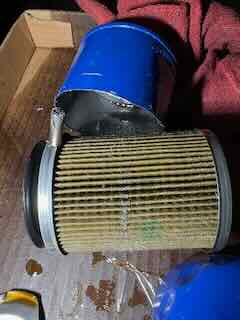

PPK_
Jan 15, 2024
147
137
Oklahoma City
Well the AFM/DFM is likely a good part of these failures. Not sure what really changed as of 2021 other than moving from AFM to DFM. But understand the overall oiling system path of these engines SUX. What did the boys from the 60's learn in racing, oil the main bearings FIRST and the valvetrain LAST. The oiling path of these 6.2l engines send oil to the AFM manifold, camshaft and lifters first, then the main bearings are feed oil after the valvetrain. So the problem is the front main bearing and the #1 and #2 rod bearings are LAST in the oiling path. Add the 2 stage oil pump, 0W20 engine oil, Auto Stop/Start, high oil consumption and fuel contamination due to Direct Injection to an already compromised engine design, what do you expect. Add to this that the oil pressure sensor is located in the AFM manifold on the REAR of the engine, almost at the beginning of the oil flow path, how does the engine management system really know when the best time to switch the 2nd stage of the oil pump in?
The real issue is what, if anything is GM going to do to completely resolve the problem? I suspect GM will issue a recall at some point with the flash update to the engine management system that will enable the 2nd state oil pump at a much earlier time, if not full time unless for some reason the DFM system would have a hard time with operating at a higher oil pressure.
At some point GM needs to understand almost all of these problems are oil system related.
Remember "It's the economy stupid", well for the later model GM V8 engines "It's the oiling system stupid!"
I don't know.. i think at least move to a 5w30 oil.. instead of the current spec. On top of this.. i think craftsmanship of the build is weaker.. somehow there is a more debris in engine earlier on. it is more than my 2018 engine.. i have a 2024 5.3 which i did first oil change at 1100 miles. i wish i did the first cycle at 100 miles.. at lot of debris in the change. i think... the smart thing is to 5w30, do 4k changes and get a warranty.
Anyway... you can see the magnet shows lot of metal in the filter. is this debris from the rockers needles? is from the lifters? is from other areas where clearances are not right? Not happy with motor.. though it not noisy with 1200 miles on it. i am going to warranty it 72/72. you don't have a choice.

jfoj
Aug 9, 2012
1,206
1,064
I did my first oil change at 500 miles, I still have the filter, have not cut it open yet. Will check and see what it looks like compared to your filter. I also am sending oil samples for analysis at each oil change to track possible future problems if I can detect anything unusual. I am also running magnets on the filter and a magnetic oil drain plug. My 2005 Yukon 6.0l came from the factory with a magnetic drain plug.
Fully agree with the 5W30 engine oil and 4000k oil change interval as well, more for oil staying in the bearing journals when the engine is shut down so you have a reduction of dry start up, but there clearly will be other benefits to include less problems with fuel dilution. HIGHLY recommend that you fill the sump to top of dipstick, 8.0 qts for an oil change is NOT enough. I am running 9 qts in my engine (flame suit on!) This put the oil level on the dipstick just slightly over the top hash mark. Check when engine is just turned off and you will see there is still oil in the top of the engine.
Almost wondering if it be worth a hack to command 2nd stage of oil pump on permanently for the 6.2l. It appears the 5.3l just has a variable displacement single stage oil pump, maybe this is why there are less 5.3l failures?? Assume this may cause a CEL and unclear if there would be other issues with the DFM system at the higher oil pressure? This L87 is brand new to me, so I have no real history or a full understanding yet of the oiling system and AFM craziness.

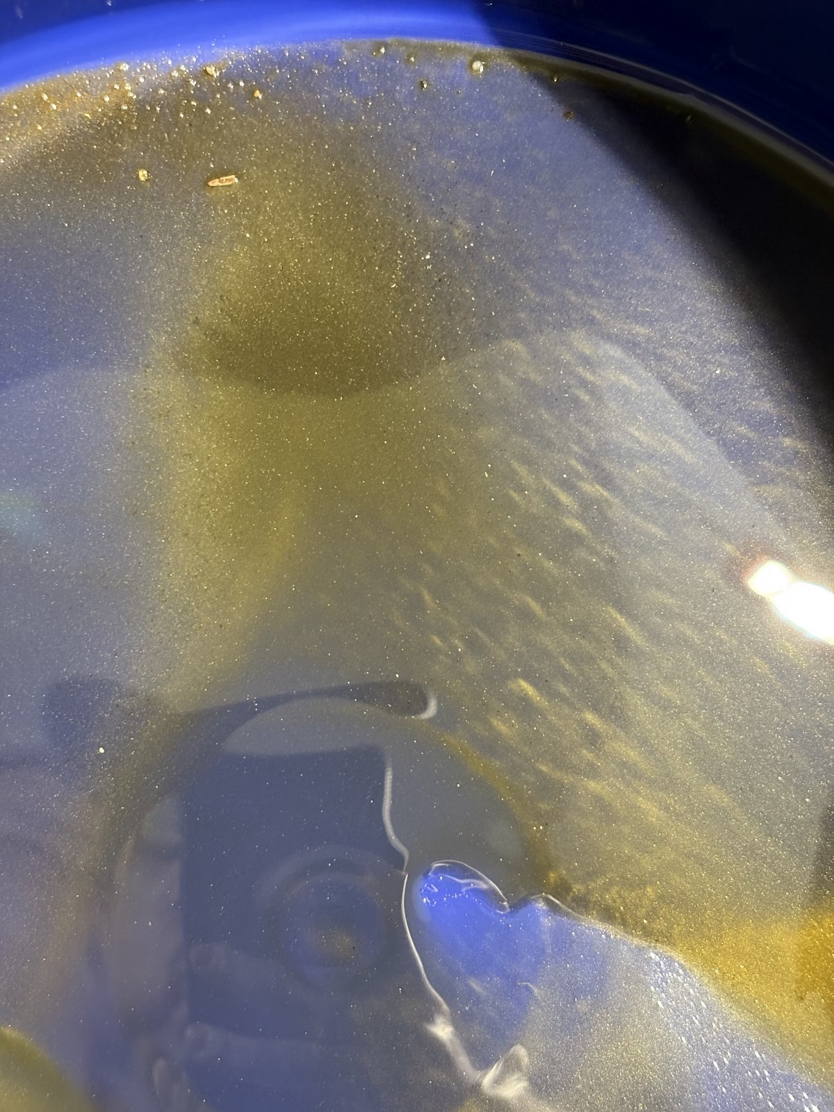

PPK_
Jan 15, 2024
147
137
Oklahoma City
Below is first oil change from ‘24 5.3… iron and aluminum in the bottom of my drain bucket… if you at it you can see it.. i think drain - a couple anyway before 1500 miles.
I still am thinking a drop in cleaning or suppliers.. of the rocker or lifters.. there is just no way you want to run that oil for 7500 miles.. yikes!! There is a lot of boring and tapping going on.. to build the block. It might be cleaning is less..
