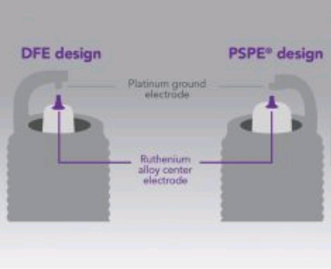

Thought I would resurrect my old thread here VS starting a new one...
So NGK has two versions of this plug.
They have a DFE plug, which is on the left in this pic, which they recommend for naturally aspirated engines.
And they have a PSPE plug, which is on the right in this pic, which they recommend for boosted applications.
My questions are...
What do you suppose would happen if you ran the PSPE version in a N/A engine?
Their website says...
DFE (double fine electrode) maximizes ignitability, while reducing emissions for low-heat engines. This NGK-patented design is recommended for non-turbo applications.
PSPE® (projected square platinum electrode) provides the best ignitability and service life for high-heat engines. This NGK-patented design is recommended for turbo and supercharged engines.
So do you think it would give any drivability issues or idling issues or cold starting issues?

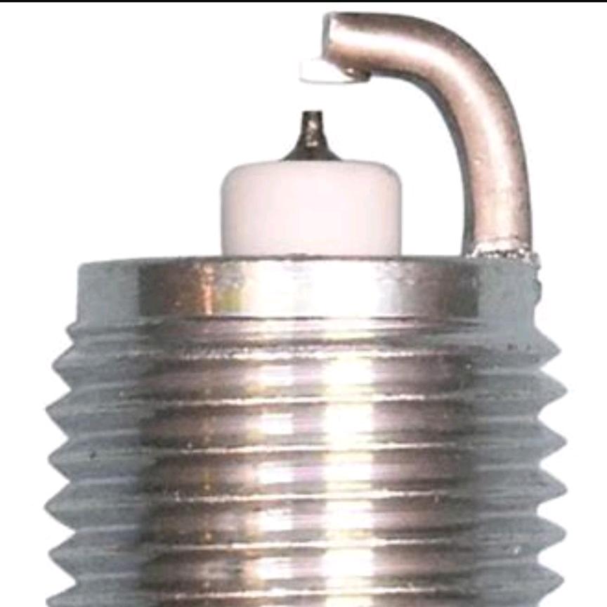

To me the plug on the right looks like it would create a better flame kernel because the tip of the plug is not shrouded.
Here is a better pic...
Kind of like the old racers trick of side gapping plugs.
I sent NGK a message to see what they can tell me but figured I would ask here as well.
Anyway... what say you all?
45,013
IMO, if the "boosted" plug has the same heat range as the NA, then I'd bet it'd make no discernible difference. Aside from that, I'd still stick with iridium for the cost and established longevity. But, I welcome real-world proof of superiority of the rutheniums.

Got a response back from NGK.
They do NOT make a Ruthenium PSPE style plug for an LS engine. Not even for the ZR-1 Corvette.
So if I try these, and I probably will, it will be the DFE style I guess.
