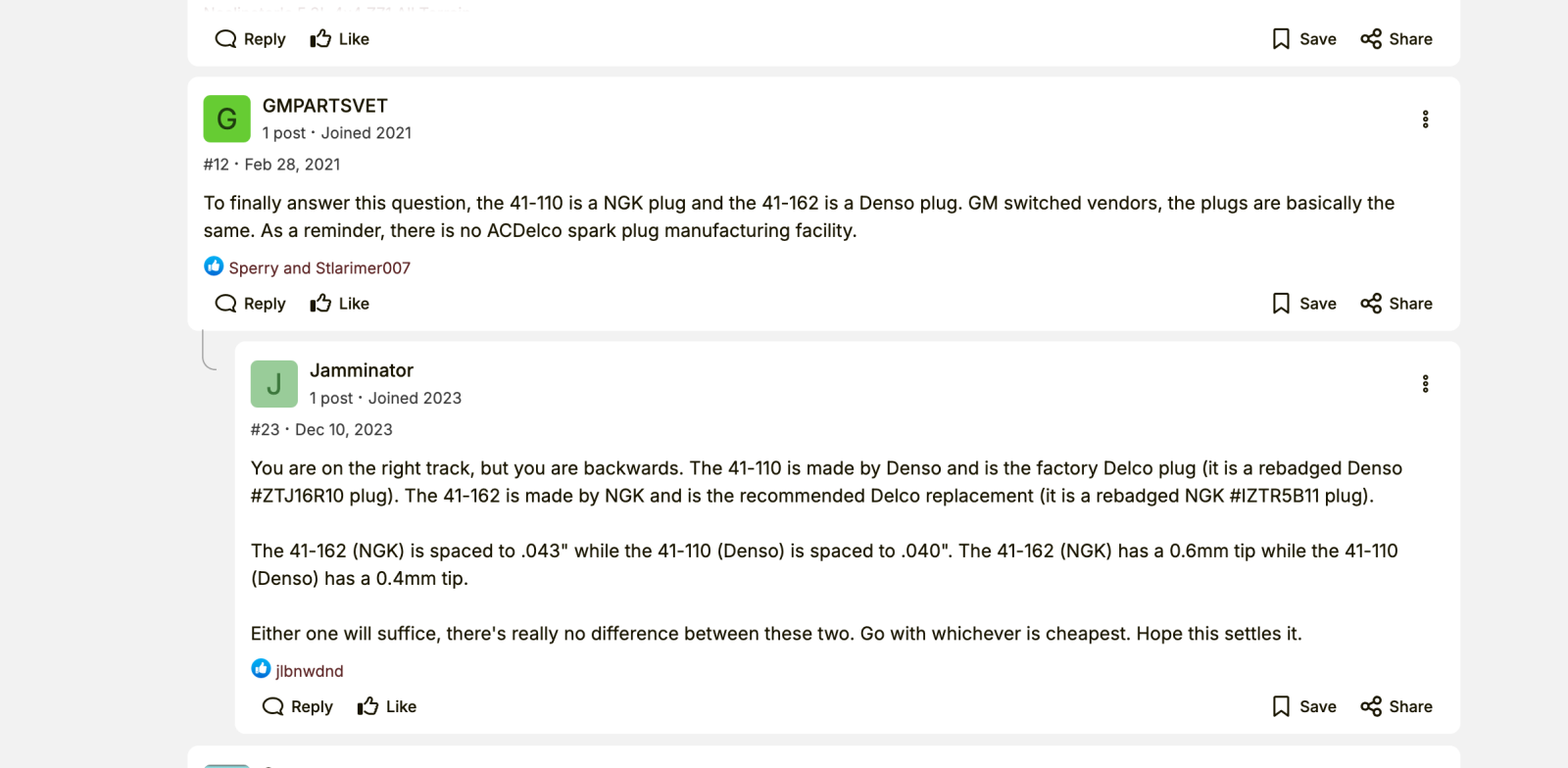

NM, I ran across this thread a second ago: https://www.silveradosierra.com/threads/ac-delco-41-110-to-41-162.722289/
There's a 50% price difference on Amazon (AC Delco official store), hence my curiosity.

Would the cheaper AC Delco 41-110 plugs work fine as well?
I would not run the 41-110s as they were counterfeited wildly and destroy engines within a mile.
I have a stash of 41-985s and still use the 41-162s. They're all the same, just different vendors I believe.
Have watched several videos on spark plugs with Richard Holdener, different brands and gaps and they all made the same power on the engine dyno.
Many moons ago we ran an NGK plug in our turbocharged Buicks that was a little cooler and we picked up 5 horses but lost 3 miles per gallon.

-192 are the updated oem.
I guess -110 is ngk and the -162 is denso.
Have heard both are good?
