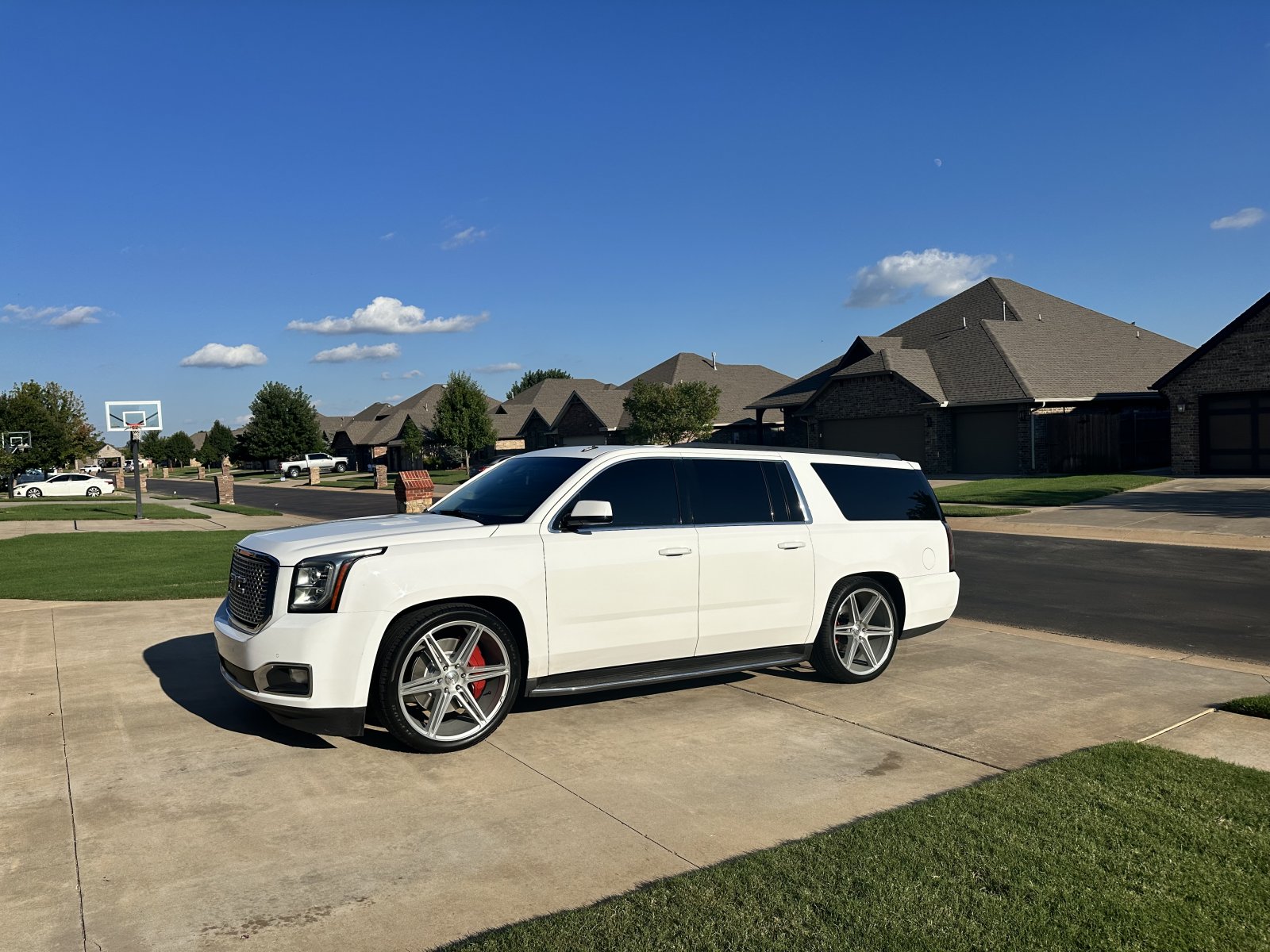

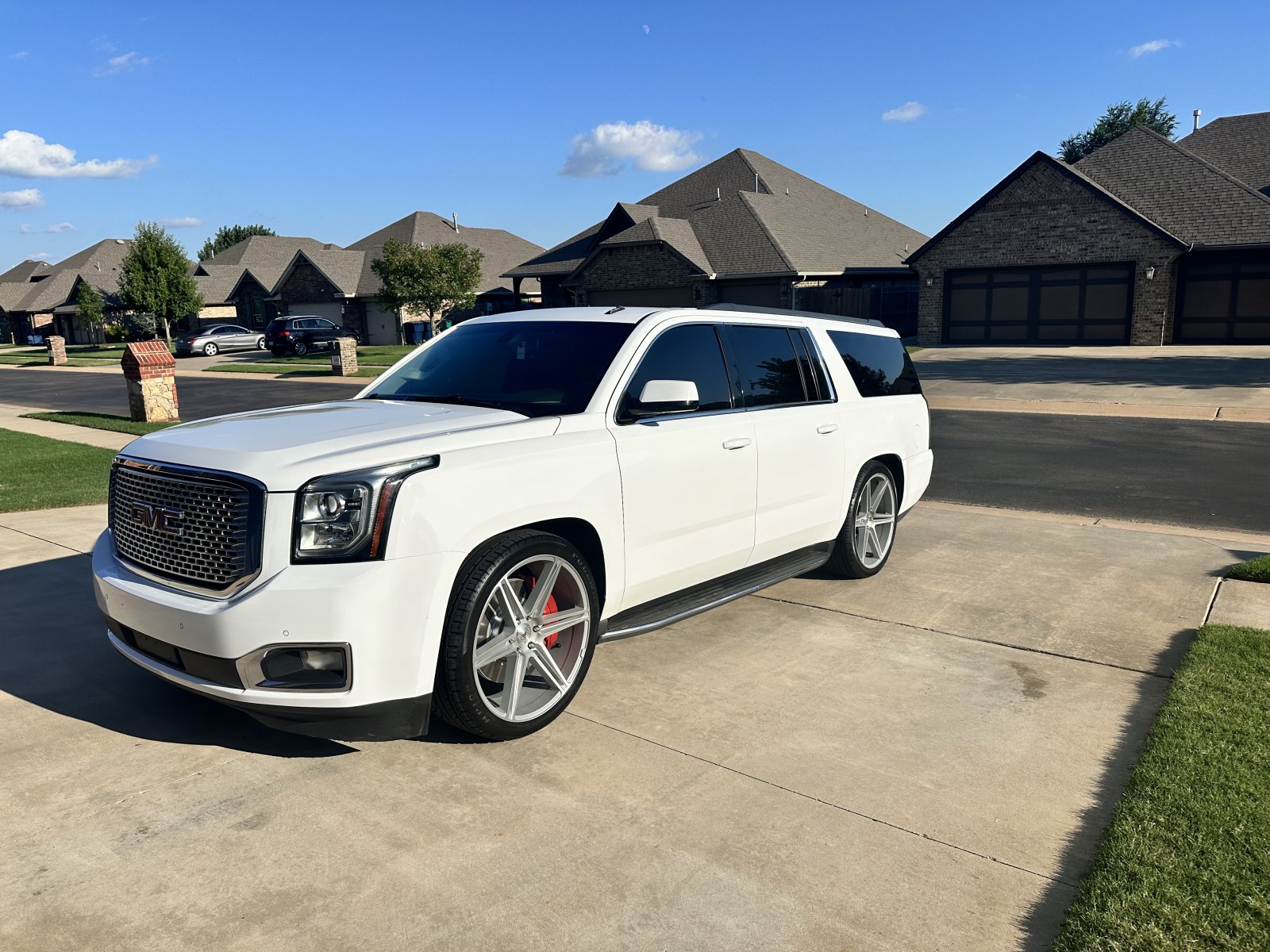

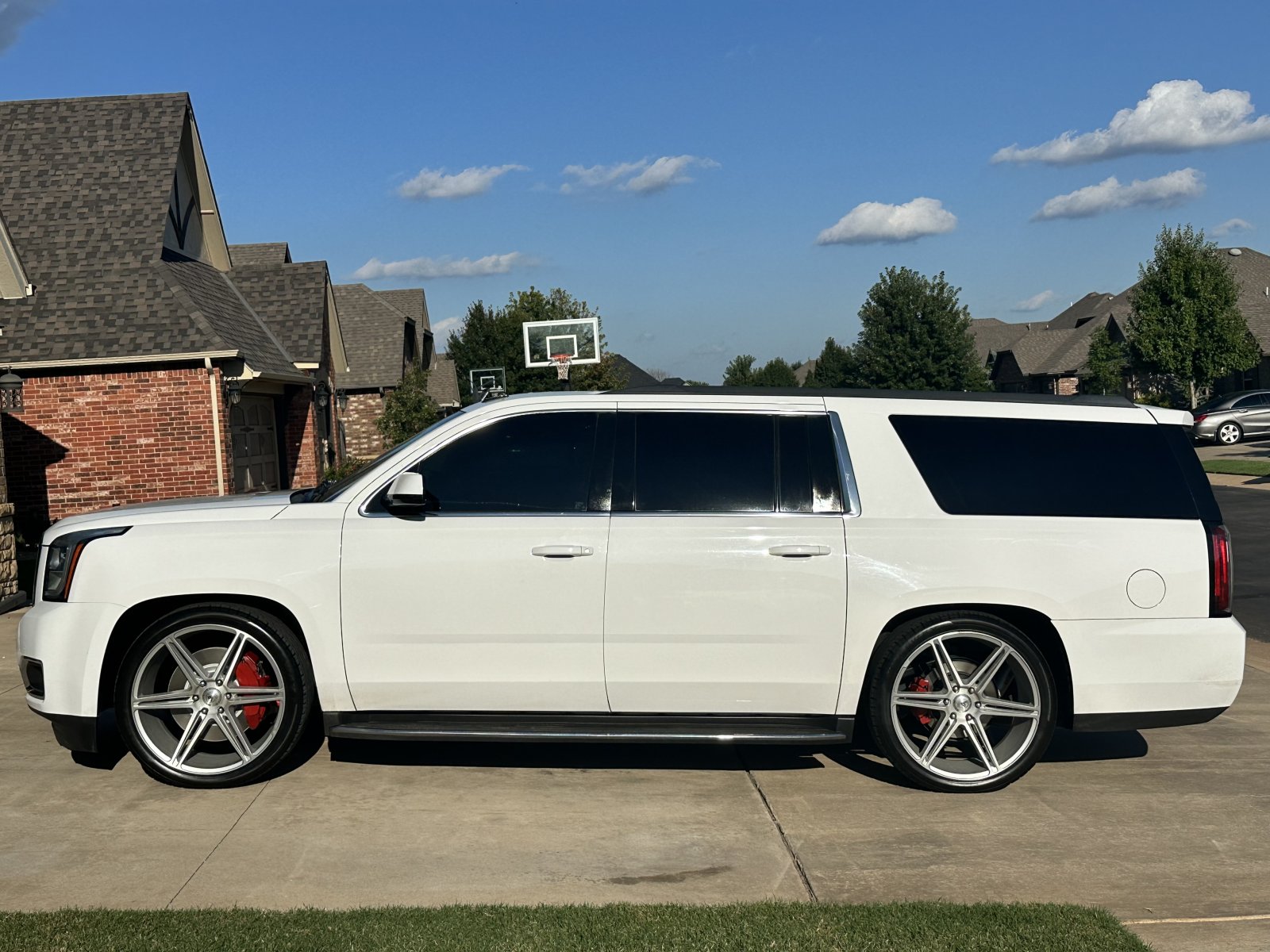

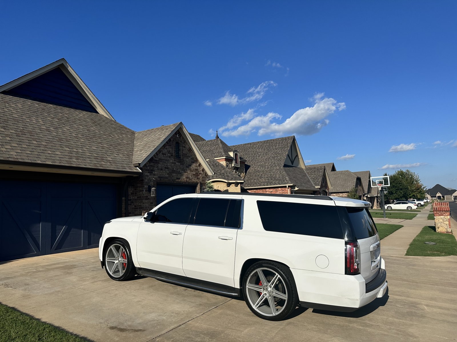

I was finally able to get all of my parts installed. Below is a list of parts that I installed or had installed along with pricing and links to order.
DescriptionPart NoCostQtyTotalPurchasedLink
Husky Floor Mats (Front and 2nd Row99211$ 139.99
1​
$ 139.99$ 139.99https://www.huskyliners.com/WeatherBeater-Floor-Mats/2015/gmc/yukon-xl/2nd-row-config/2nd-bench
Husky Floor Mats (3rd Row Liners)19291$ 79.99
1​
$ 79.99https://www.huskyliners.com/WeatherBeater-Floor-Mats/2015/gmc/yukon-xl/2nd-row-config/2nd-bench
Husky Floor Mats (Cargo Liner)28221$ 199.99
1​
$ 199.99https://www.huskyliners.com/WeatherBeater-Floor-Mats/2015/gmc/yukon-xl/2nd-row-config/2nd-bench
BellTech Front and Rear Complete Kit1020SP$ 1,014.00
0​
$ -https://www.belltech.com/catalogsearch/result/?q=1020sp
Kryptonite Death Grip Tie Rod EndsKR800948-2$ 109.99
1​
$ 109.99https://kryptoniteproducts.com/coll...e-rod-ends-pair-1-2-ton-truck-6-lug-2014-2017
BBK Calipers (GM 84793057) DriverGM 84793057$ 397.76
1​
$ 397.76https://www.rockauto.com/en/parts/gm+genuine,84793057,caliper,1704
BBK Calipers (GM 84793058) PassengerGM 84793058$ 397.79
1​
$ 397.79https://www.rockauto.com/en/parts/gm+genuine,84793058,caliper,1704
BBK Pads (Power Stop 172407)Power Stop 172407$ 73.79
1​
$ 73.79https://www.rockauto.com/en/moreinfo.php?pk=13973641
BBK Rotor (Dynamic Friction 604-47079 (2))Dynamic Friction 604-47079$ 119.00
2​
$ 238.00https://www.buybrakes.com/dynamic-friction-604-47079-geostop-coated-premium-brake-rotor
BBK (Mounting Bolts (GM 11612265)GM 11612265$ 4.01
4​
$ 16.04https://www.rockauto.com/en/parts/gm+genuine,11612265,caliper+bracket+bolt,13055
BBK Banjo Bolts (GM 11569590)GM 11569590$ 12.21
2​
$ 24.42https://www.rockauto.com/en/parts/gm+genuine,11569590,banjo+bolt+/+washer,10620
BBK Crush WashersGM 21012386$ 0.48
4​
$ 1.92https://www.rockauto.com/en/parts/gm+genuine,21012386,banjo+bolt+/+washer,10620
Control Arm with Ball Joint (Front Right UpperMEVOTECH CTXMS501233$ 218.79
1​
$ 218.79
Control Arm with Ball Joint (Front Leftt UpperMEVOTECH CTXMS501234$ 218.79
1​
$ 218.79
Control Arm with Ball Joint (Front Leftt LowerMEVOTECH CTXMS501184$ 250.79
1​
$ 250.79
Control Arm with Ball Joint (Front Right LowerMEVOTECH CTXMS501185$ 250.79
1​
$ 250.79
Fullway HP108 All-Season Truck/SUV Performance Radial Tires-295/35R24295/35/24$ 628.93
1​
$ 628.93
HubRings, (Selection)Outside Diameter: 100.00; Inside Diameter: 78.03$ 55.99
1​
$ 55.99https://www.motorsport-tech.com/4DCGI/hub_rings2Purch.html
Front and Rear Sway Bar Kit - EIBACH38106.32$ 625.00
1​
$ 625.00
MevoTech - Sway Bar LinkTXMS50820$ 23.79
2​
$ 47.58https://www.rockauto.com/en/moreinfo.php?pk=8016028&cc=0&pt=7580&jsn=330
