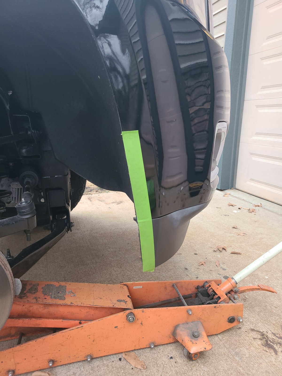

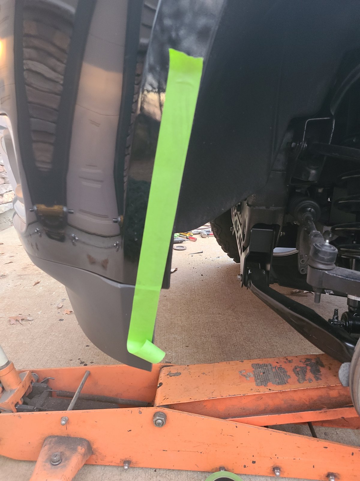

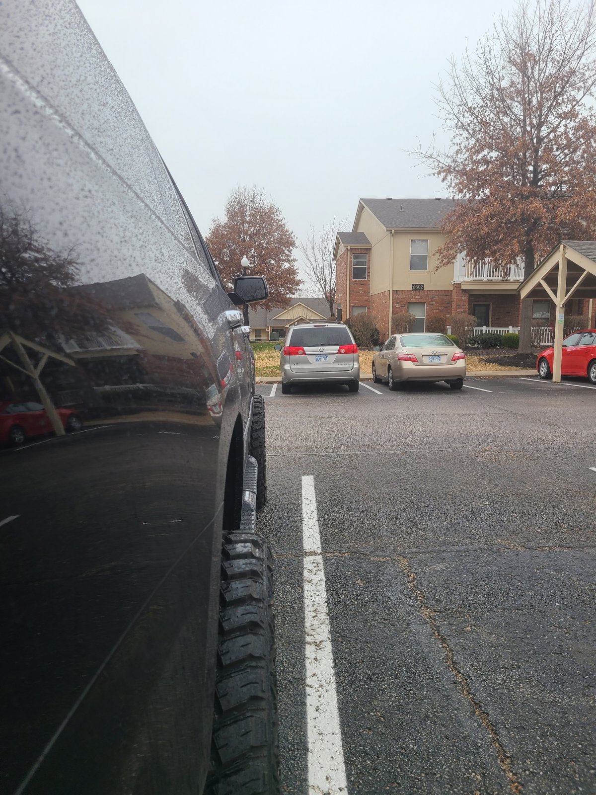

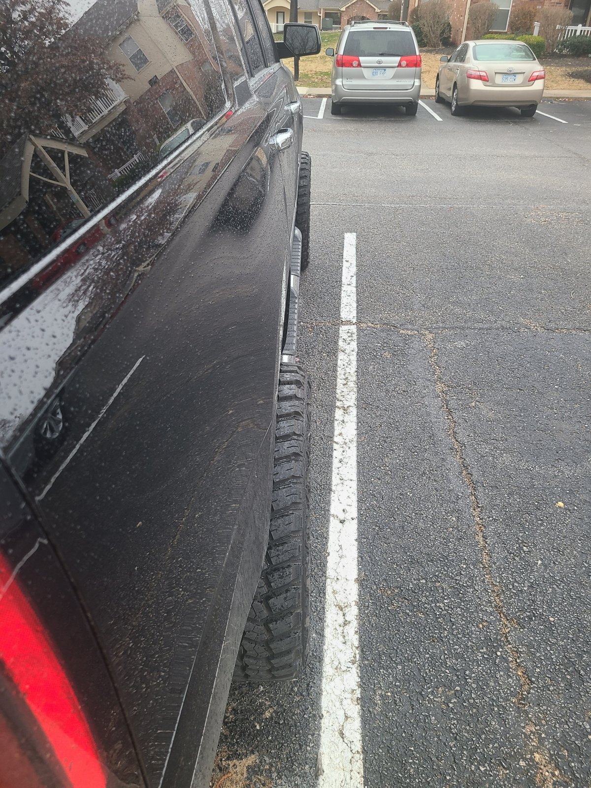

Hm. So the rc lift adds to the track width up front then somehow. Let us know what size spacers are out back sometime.
2" spacers in rear, just put a tape to them. Front and back look very close in stance.

yet the front has no spacers at all? Looks like the rc lift comes with new knuckles...those must push out the mounting face quite a ways or something.
Correct zero spacers on front, and yes, thats what I've been reading too, that quite a few of the lifts widen the front with the new knuckles.

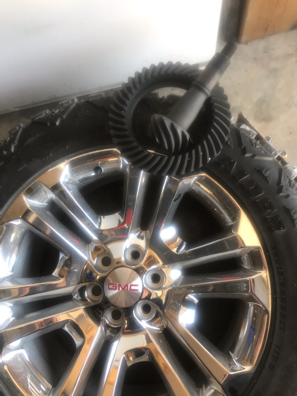

Parts ordered to regear both diffs to 4.10. My buddy in my local Landcruiser club is a Nitro dealer and really does a great job at differential installs. The 5.3 is so capable of towing, but GM has really limited these trucks down in the last generation with the stock 3.08 gearing. Even the max trailer package only boosted the "heavy duty" diffs to 3.42. The old 5.3s combined with 3.73 gearing were work horses.
I'm actually thankful to have the 4L60 6 speed...don't think I would have messed with gearing if I had the 6.2 and "newer" 10 speed experiment.
With the 35" tires, 3.50 would correct the speedo, but we didn't feel the slight jump to 3.73 would really bring the gearing down enough to haul. Nitro was really pushing 4.56, but it gets plenty of highway miles with no load, and we felt those would be a bit of a dog on Hwy driving. 4.10 feels like a good compromise for my goals.
I dont want to flash or tune the computer...and GM is so gunshy these days of helping out with that. Speedo will go from showing slower currently, to about the same in the other direction. I can live with it.

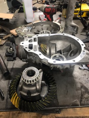

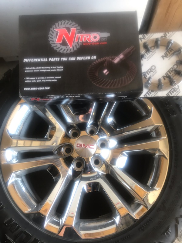

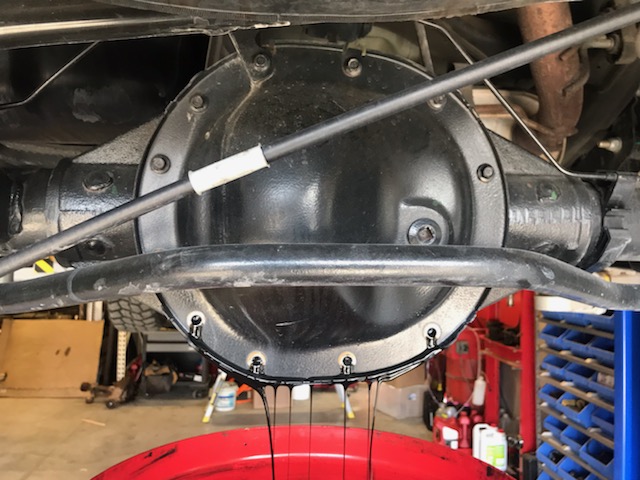

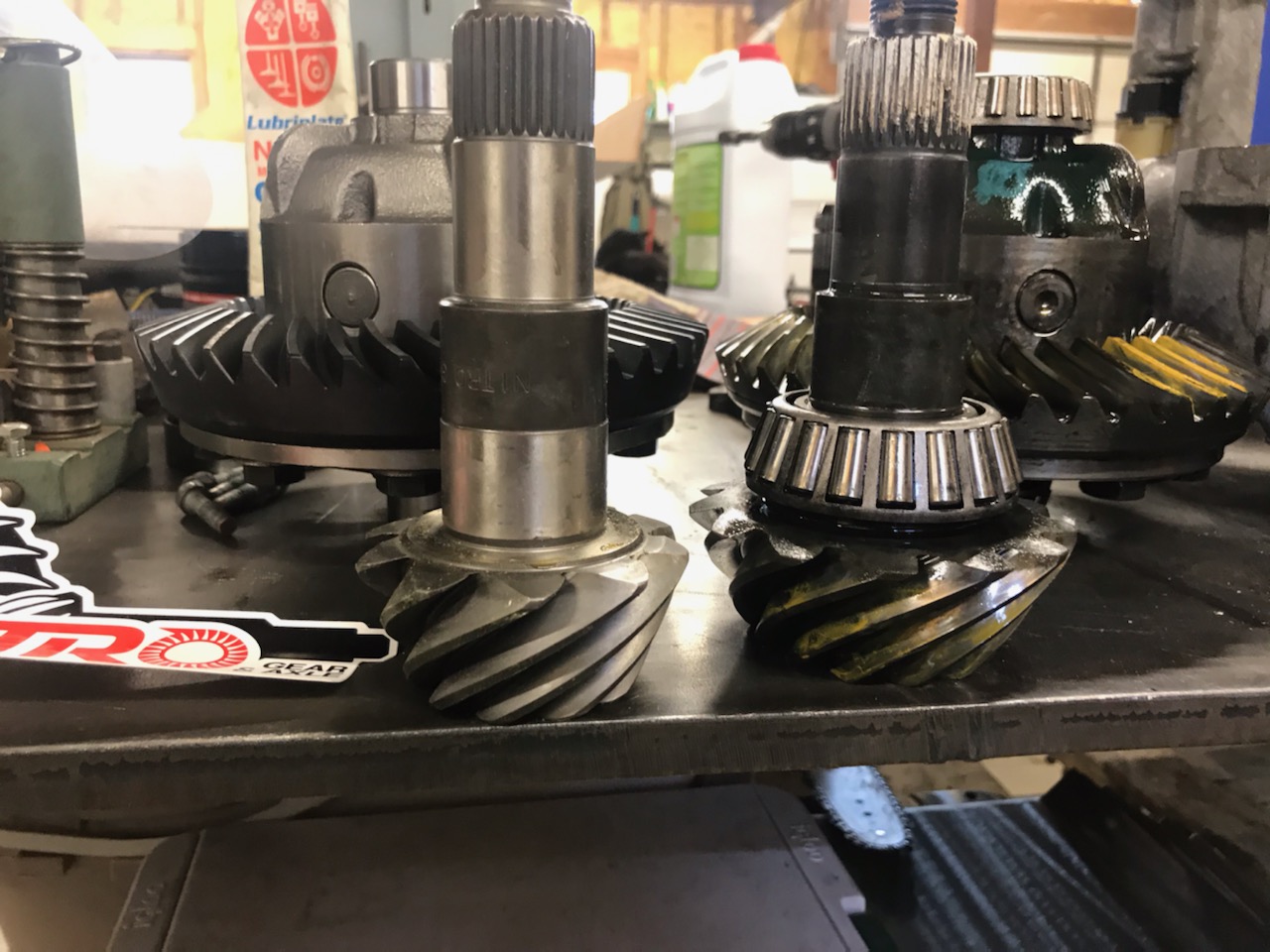

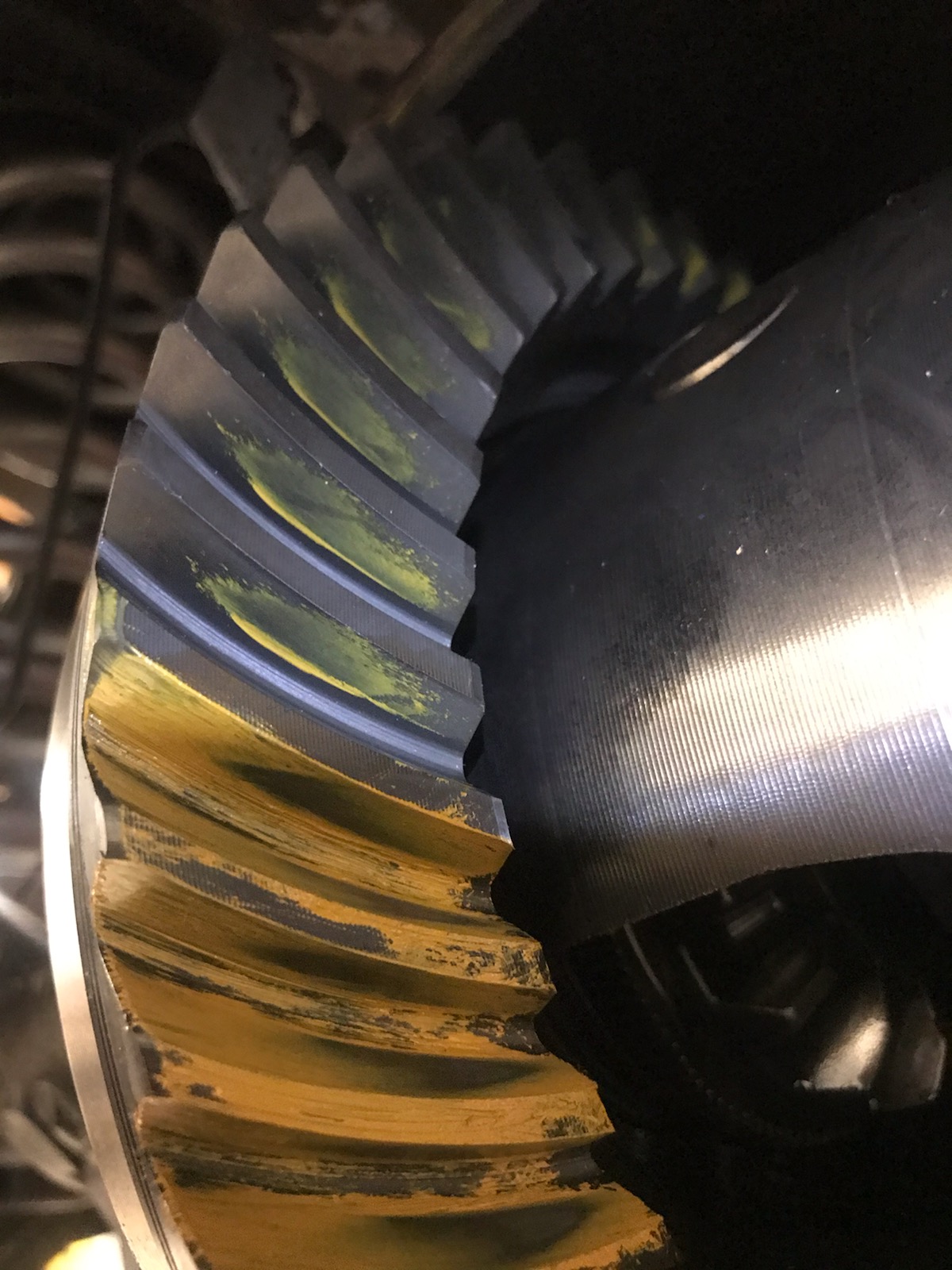

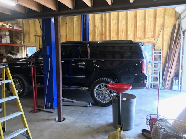

4.10 Nitro gears going in today and tomorrow.
Factory set had a surprising amount of wear!I Like more wear than we typically see when regearing our 200k mileage 80 series Land Cruisers, which was a little alarming. My hunch is the lift and tires over the last 6,000 miles coupled with using "auto" 4x4 frequently on wet or slick pavement through the winter. One of the local 4x4 shops told my buddy to stay away from the "auto" setting on his Tahoe Premier with 6" inch lift, and to just use 4hi as needed in snow or dirt. And I will say, it did growl a bit in the auto selection on the freeway. I just figured it was more the drive shaft and planned on going double cardan. My hunch is that it was ******* the rear gears. So I will probably stay away from the dummy switch and dedicate 2 or 4 wheel based on conditions.
Rear needed one adjustment at install.

I dont think there is any possible way using the 4 auto (instead of full 4wd) would have anything to do with what the gears look like.
Thanks! And I get it...just can't figure what else could cause them to be so chewed up at 43,000 miles.

Regear complete. VERY noticeable difference, mainly in off the line power. No hesitation or lag for power when starting from full stop. Took a little getting used to easing into the gas because it's much quicker to launch from stop. Should do better towing.
