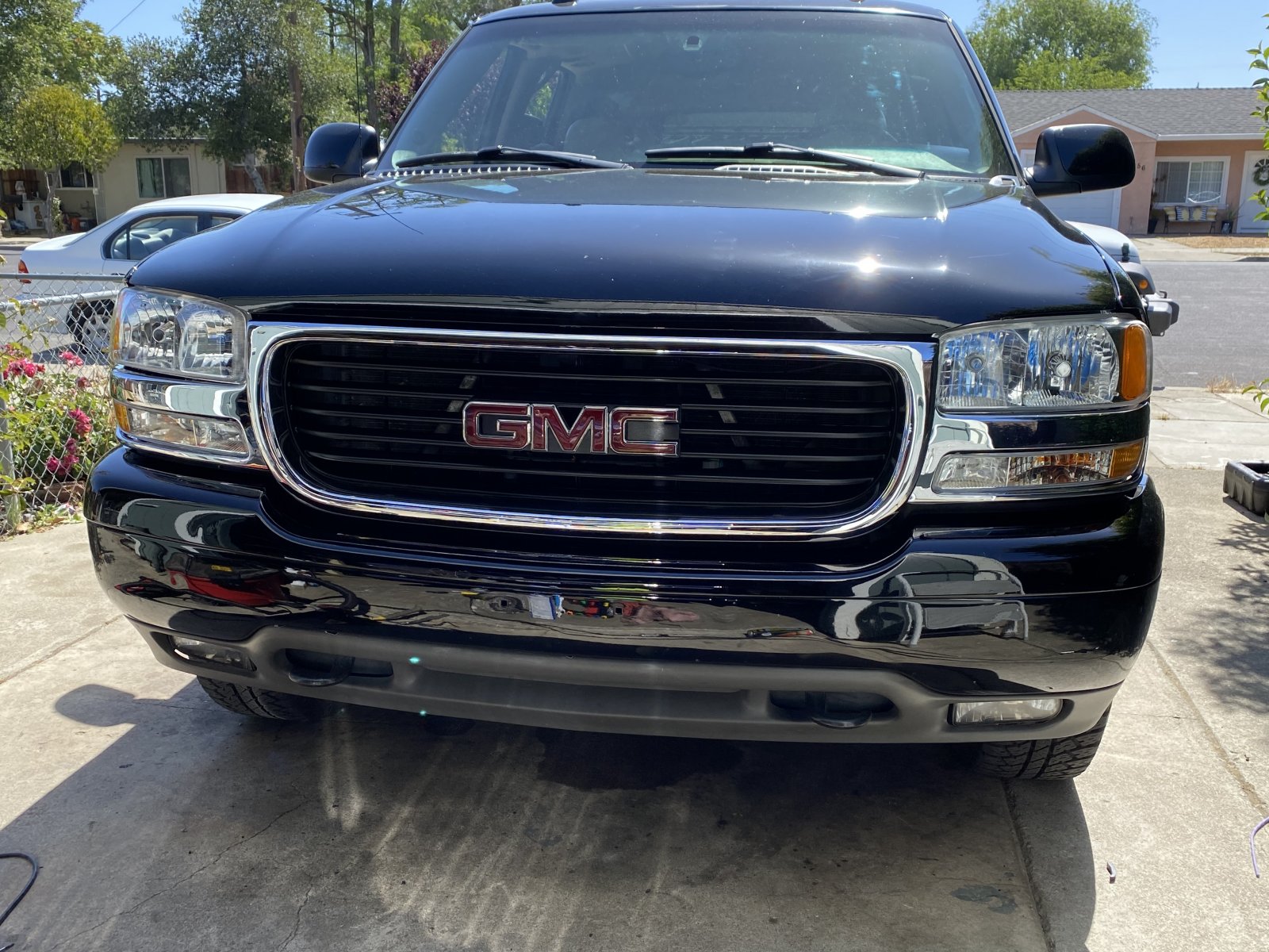

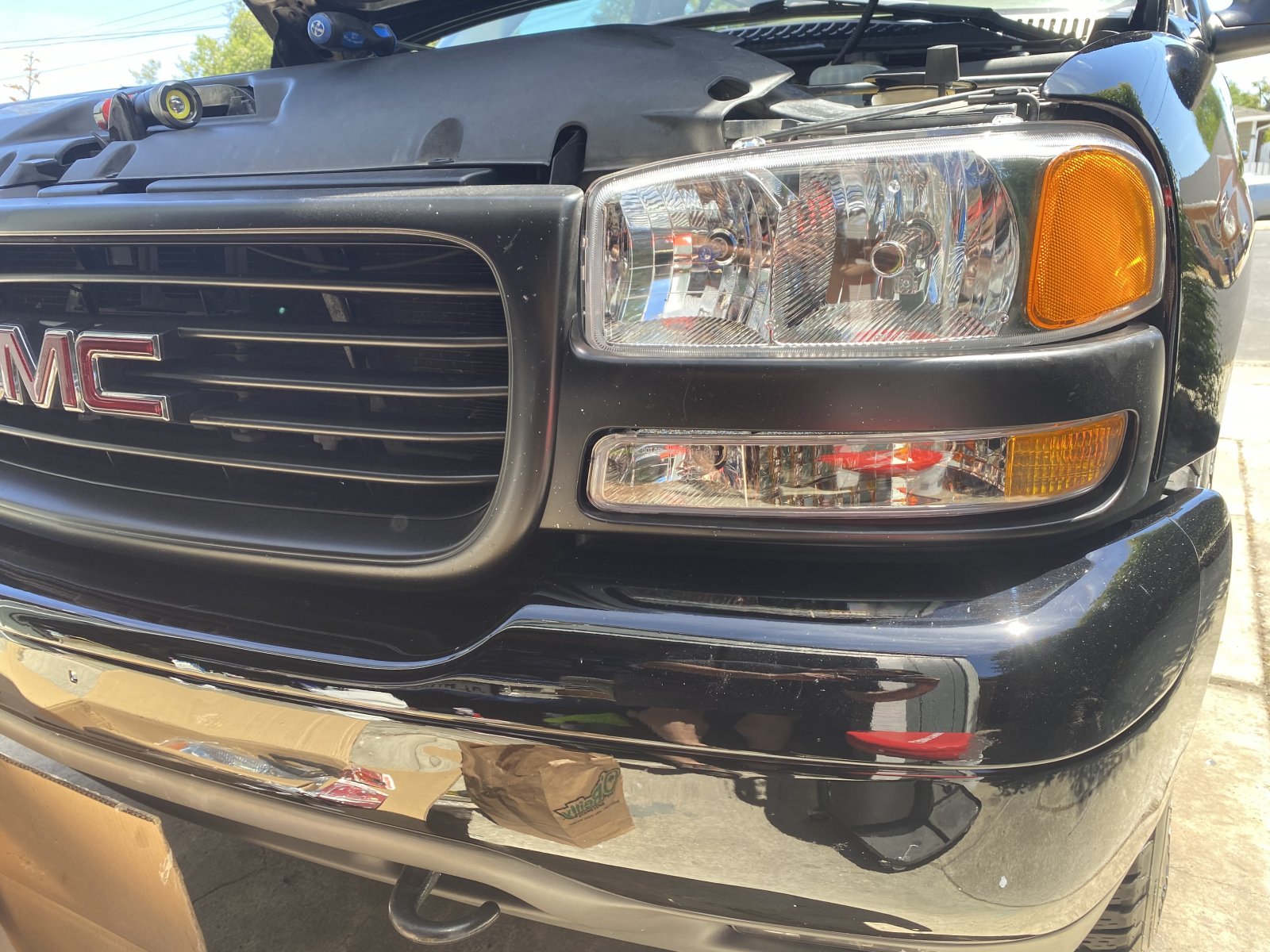

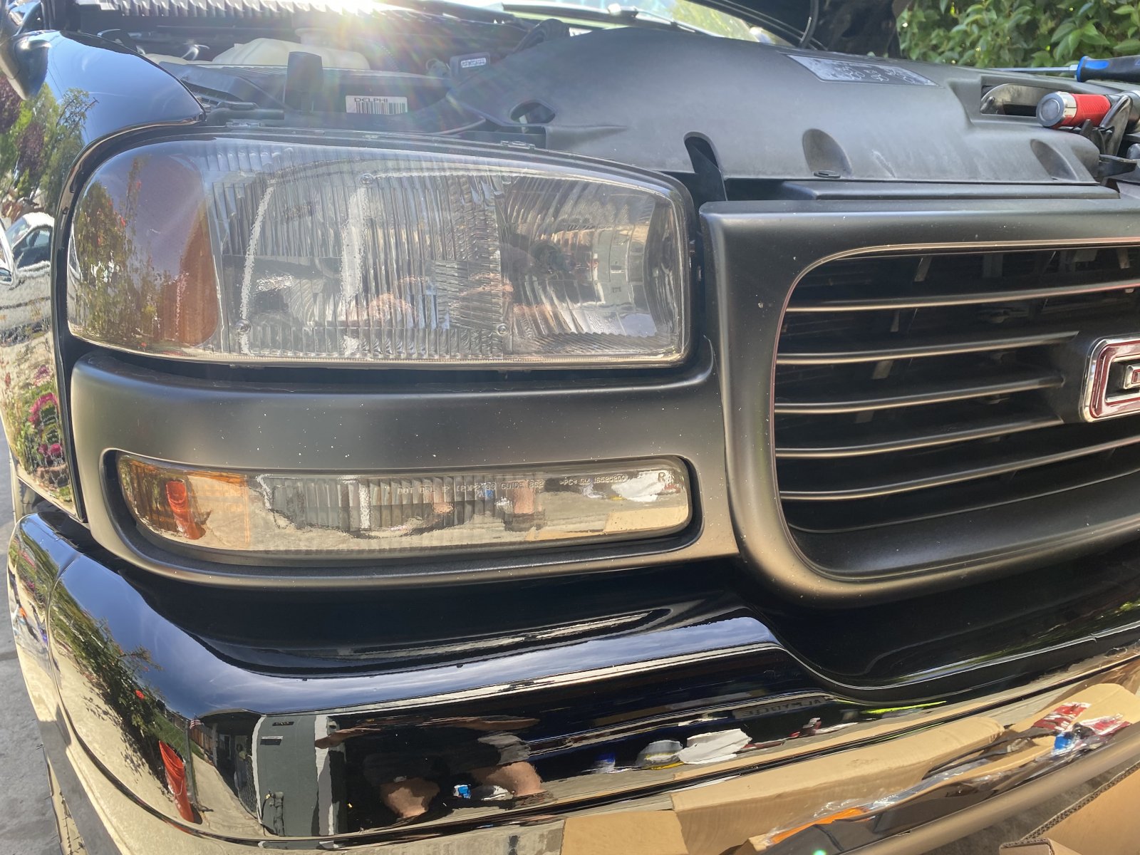

I brought the old girl home and immediately went to work. I have a habit of going through my new to me cars/trucks and performing all the maintenance upfront. This was no different, with the mileage on it I did everything. The plug wires were super brittle and disintegrated when removing them pretty sure they were original. All the fluids have been changed to syntehtic, new plugs, new trans filter, new rear diff cover gasket. Like I said the works. Next was to go and get rid of the "smoked/blacked out" look. Personally I can't stand it, I ordered new headlight housings, turn signals, tail lights, CHMSL and grille.
BEFORE:
AFTER:
AFTER with Grille, and new Fogs:

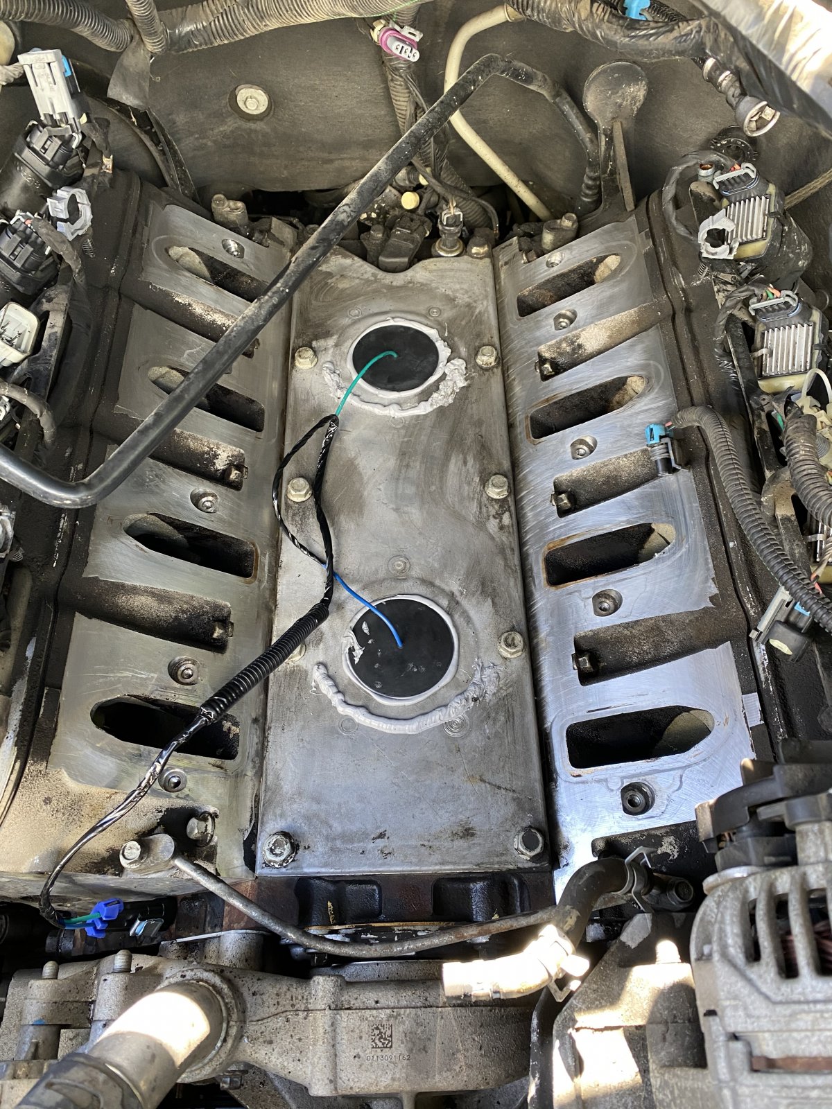

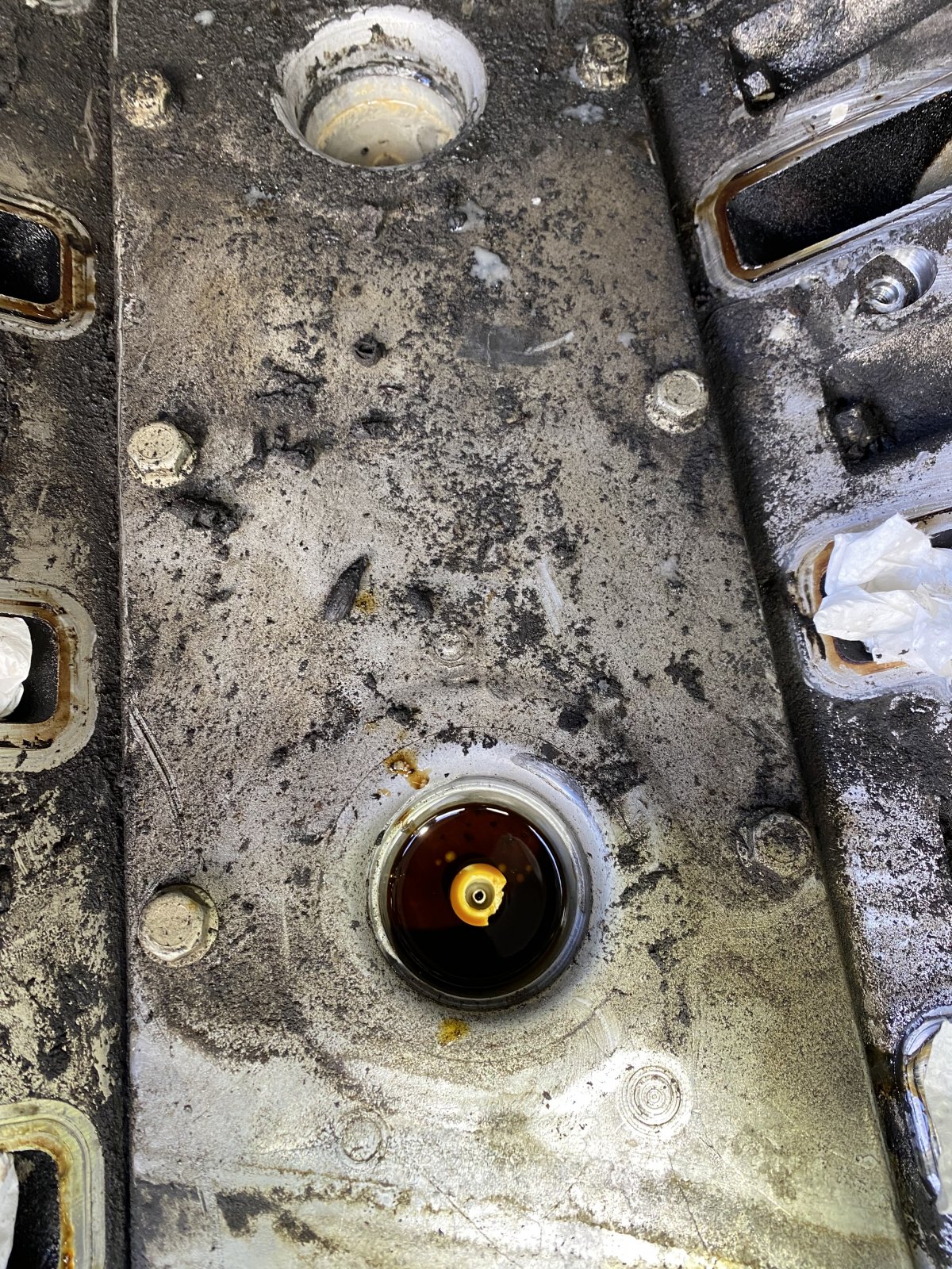

After the lights and grille I got a CEL for a P0327. So i swapped in some new Knock sensors and harness and some intake gaskets. Found some shells up under the intake which makes me think this thing sat for a while at some point in its life.

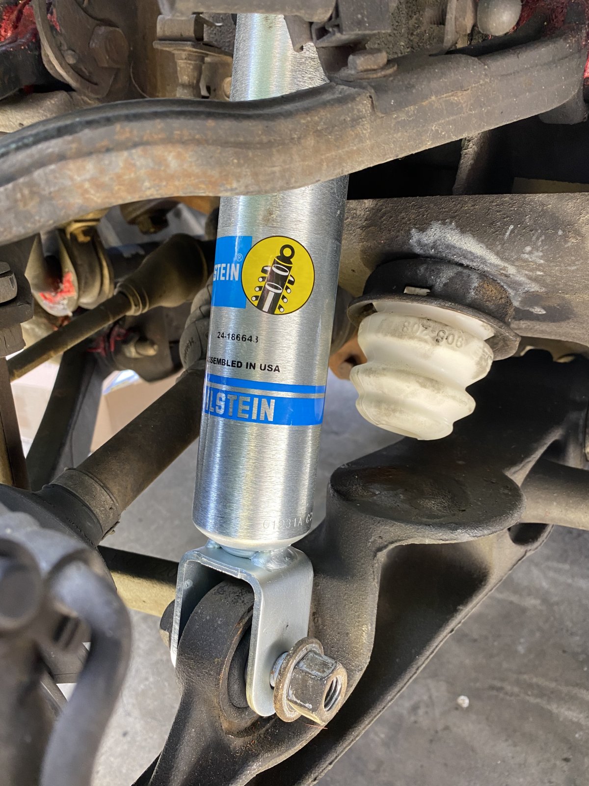

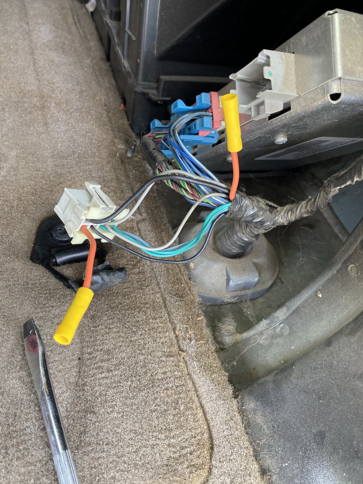

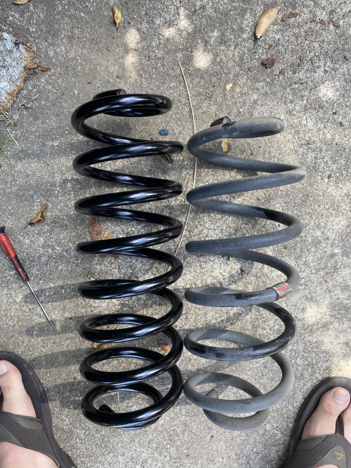

Runs like a top now. I also swapped in some new Bilstein 5100s, jounce stops, and Z71 springs to help out the ride a bit. To disable the Autoride I simply cut the 12VDC feed to the controller and capped it off. That way I have a 30a source for future expansion.

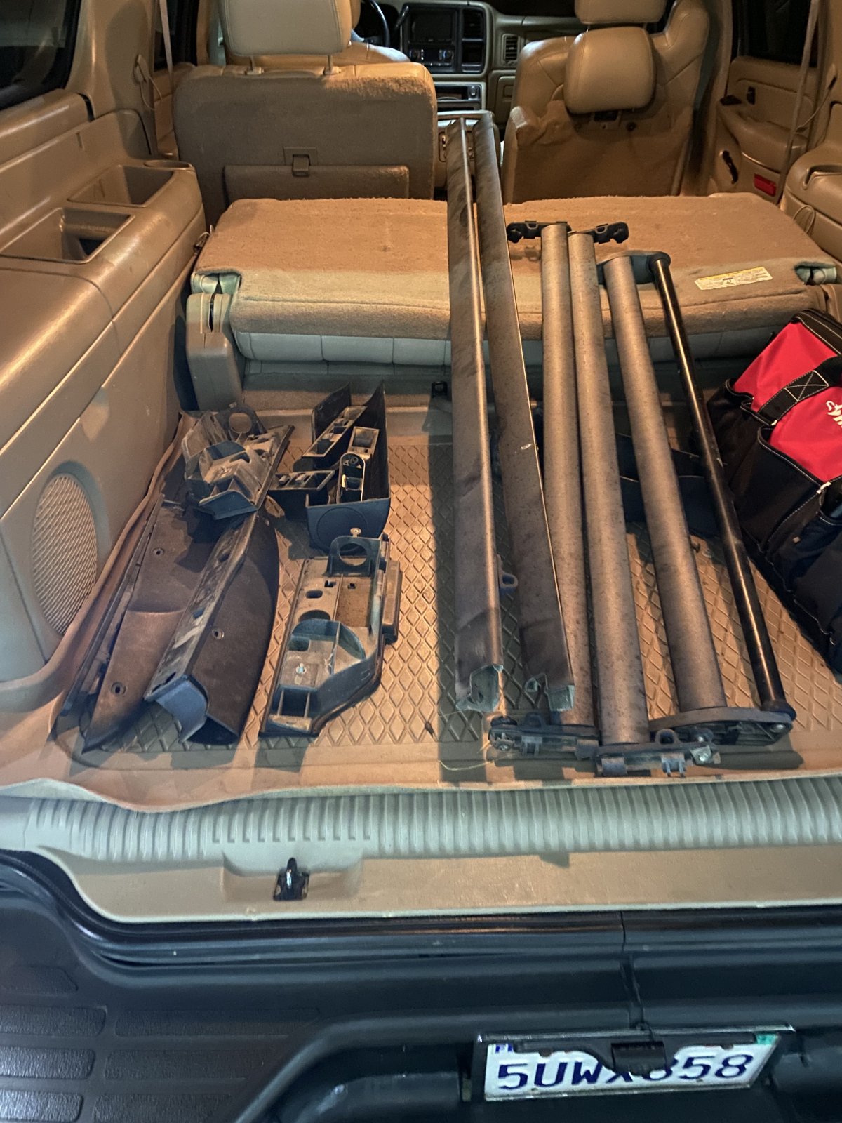

Ride quality is so much better now! I tested it out with a 3 hour one way trip to Fresno to pick up a Z71 rack. I have always loved the way the Z71 rack looks and for $50 i couldn't pass it up, After a fresh coat of paint it looks brand new!

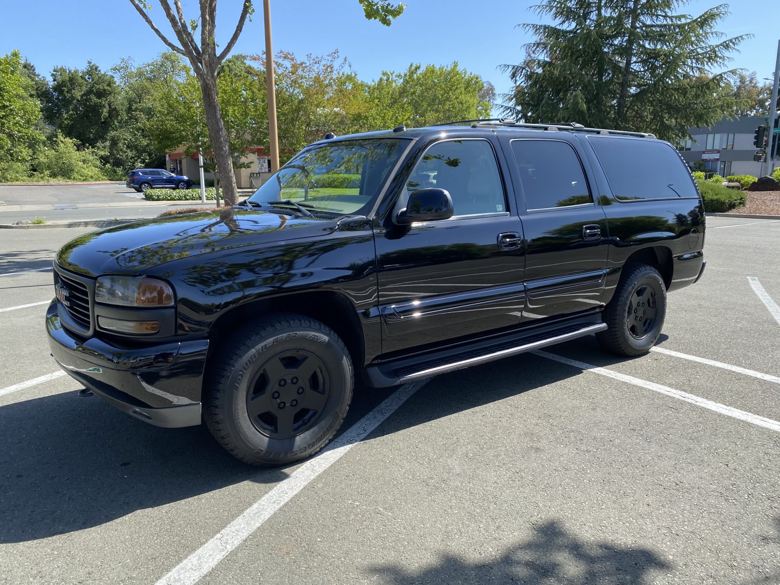

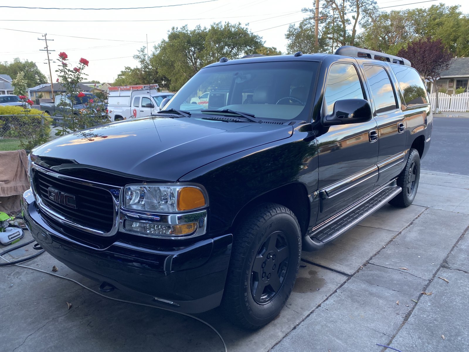

This is how she sits now. I'm so happy with how it looks right now, And I have some big plans for it in the future. I still have somethings I need to install but am waiting on some brackets and a few other odds and ends to show up. I picked up a Tru-Cool 47391 trans cooler and mount from EAD performance, I picked up a spare seat control module from Pick n Pull and had it flashed by GMFlash.com. The seat controls are backwards and one of the lumbar supports is further forward than the other one. Working on a full LED conversion for all interior lights. Have some NNBS style Yukon XL badges coming for the doors and tailgate. And soon to order some new seat covers for the front seats from lseat.com.
Long term plans include a BDS 6.5" lift, some Fox Shocks, and some 35s. I am super stoked on this truck and can't wait to see how it evolves.

Nice start. So you don’t have the “service suspension” message in the DIC with the method you used to disable the autoride?

Nope, just disconnected the battery and removed the rear cargo area trim to find the controller. I metered out the wire to confirm it was 12VDC and then snipped it. I am planning on going back and removing the autride compressor an replacing it with a Viair one for onboard air.

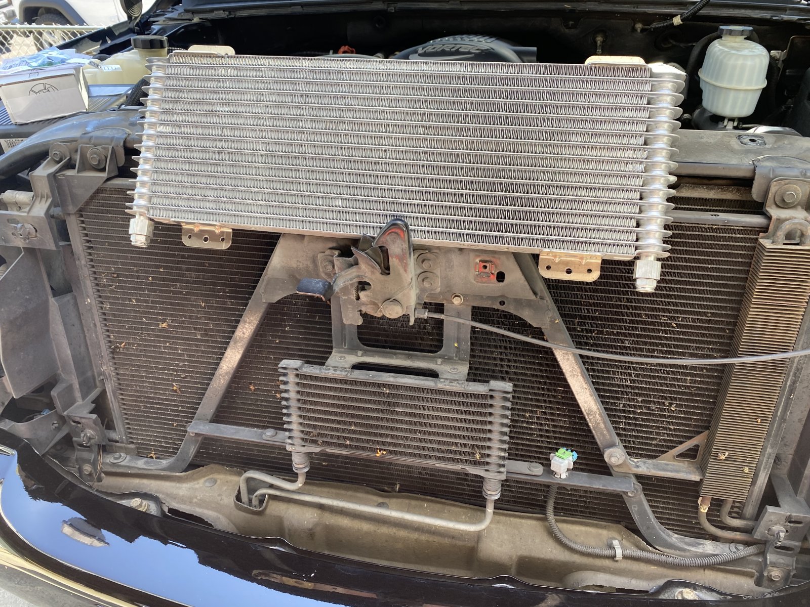

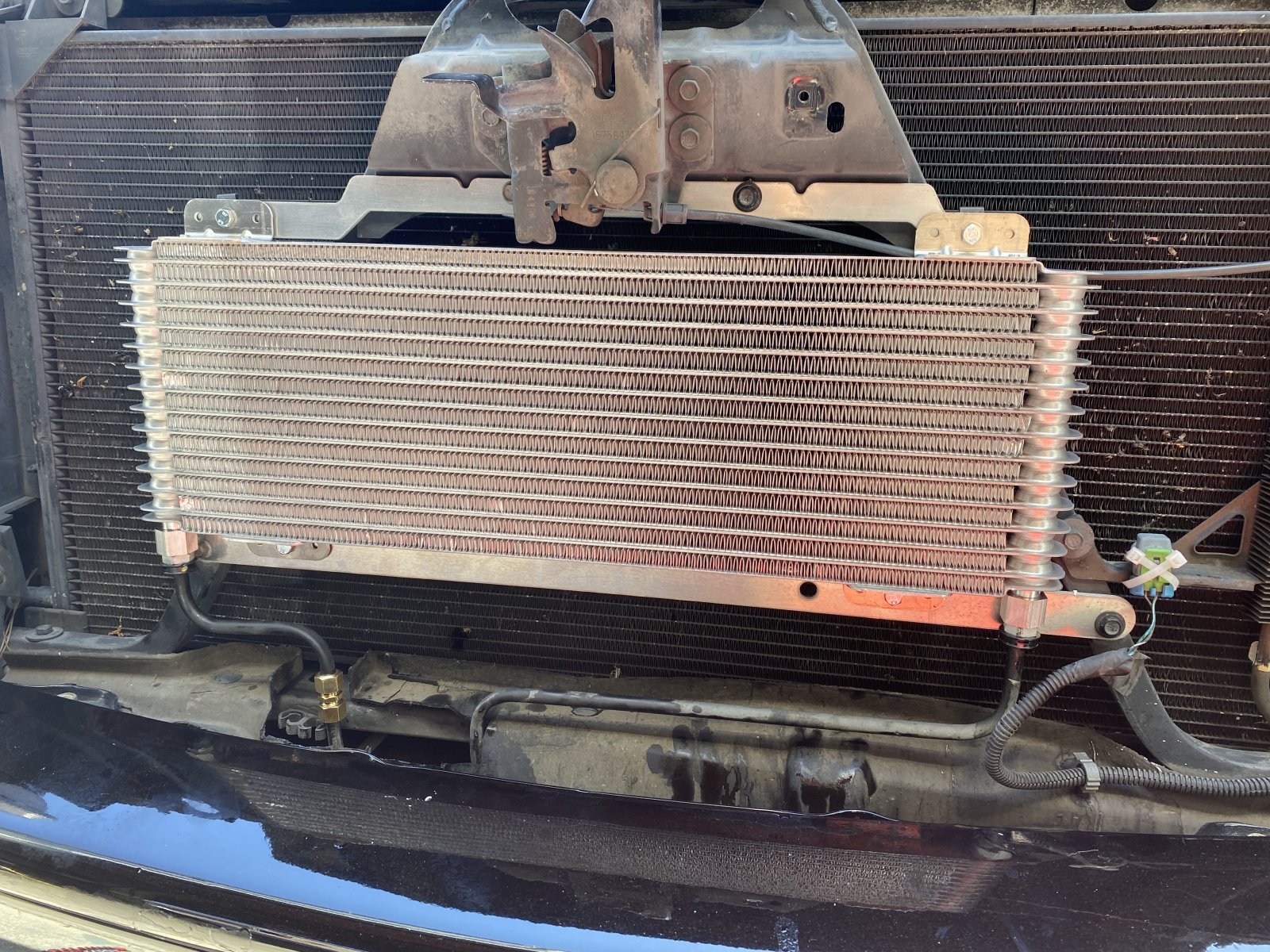

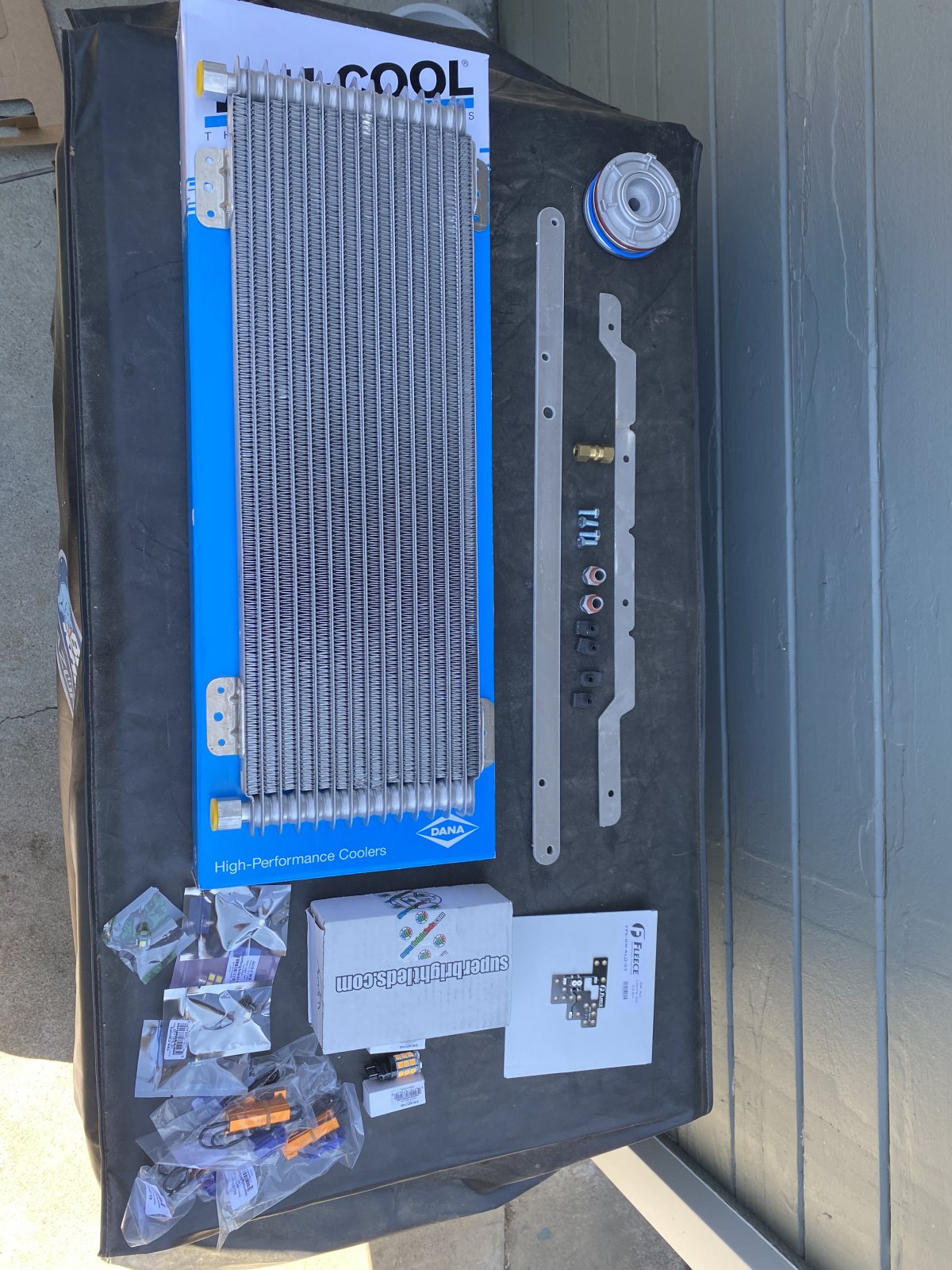

Mail call! Got some goodies for the Pearl. I picked up a Tru-Cool 47931 Trans Cooler and Vette servo from Oregon Performance Tranmission, brackets from EADPerformance, some LEDs from Superbrightleds, and All On board from Fleece Performance, and I picked up a spare Driver Position module from Pick n Pull and had it flash by the guys at GMFlash.com/Spartan Autowerx. Got everything but the Vette Servo installed today. The Tru-Cool trans cooler looks massive behind the grille, and I am so happy that my seat controls are no longer inverted.
A little before and after. The bracket kit came with all the hardware and fittings to adapt to the OEM trans lines. I did have to cut the splash pan a bit to account for the right hand line being further away from the factory location.

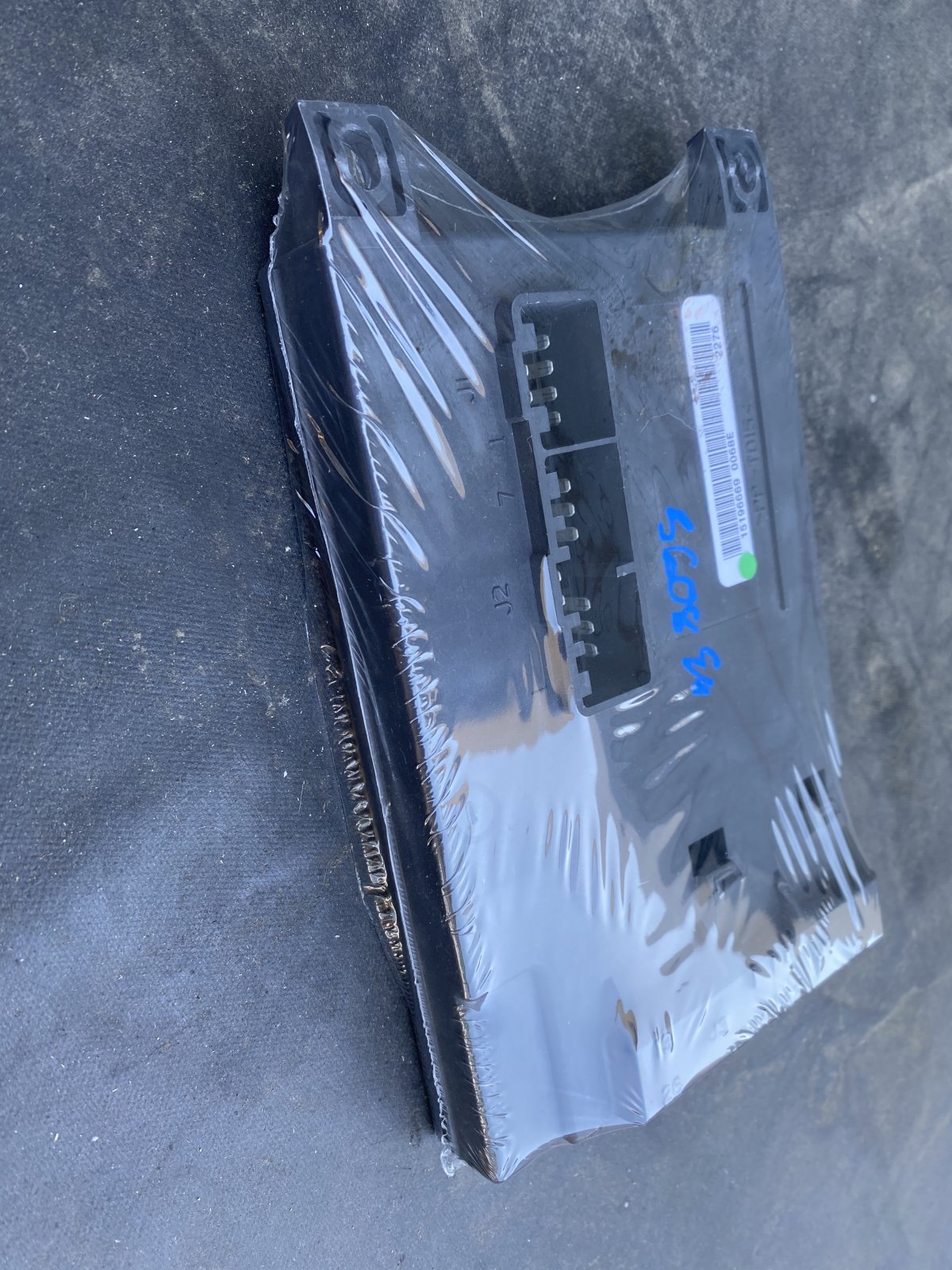

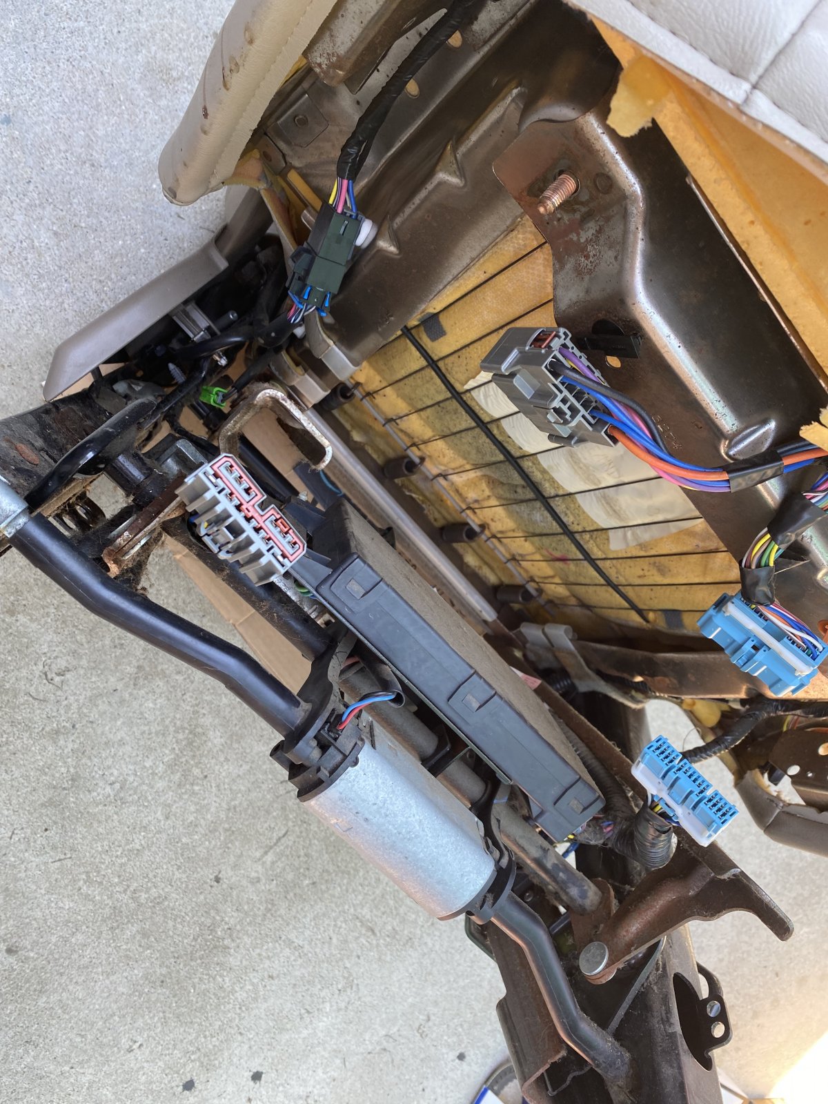

Disassembling the drivers seat went pretty quickly to swap the module out. Took about 40ish min from start to finish. They charged me $17 at PicknPull and $110 from GMFlash. It was a 3day turnaround time to have the module flashed and returned. Now I know the process for when my Lseat.com seat covers show up. The drivers front seat cover is smoked and really needs to be replaced.
