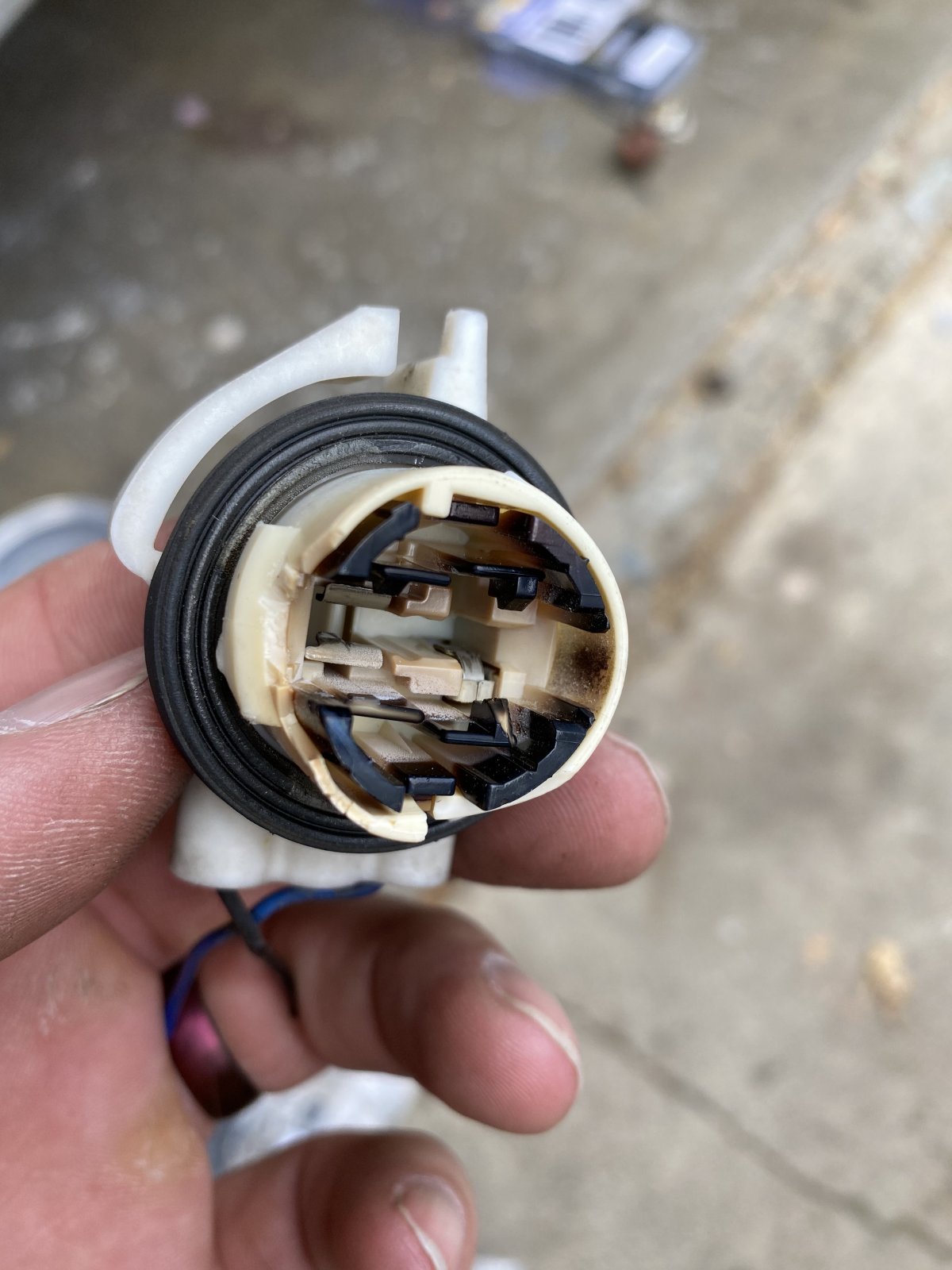

I have been meaning to replace the light sockets for the DRLs since they were pretty crispy. I picked some up on Amazon, along with the turn signal sockets since I noticed my Pass bulb wasn’t flashing when locking/unlocking and was only intermittently flashing when activated by the turn signal stalk. I also swapped in a pair of Sylvania 4114 LED bulbs into the DRLs. Now I think all of the bulbs have been converted to LED. The white LEDs for the door switches, Climate control, steering wheel etc showed up along with sockets. I might run down to Pick N Pull and pick up a couple spare switches to play with and get to work. Last time I soldered was last summer when I built my mechanical keyboard.

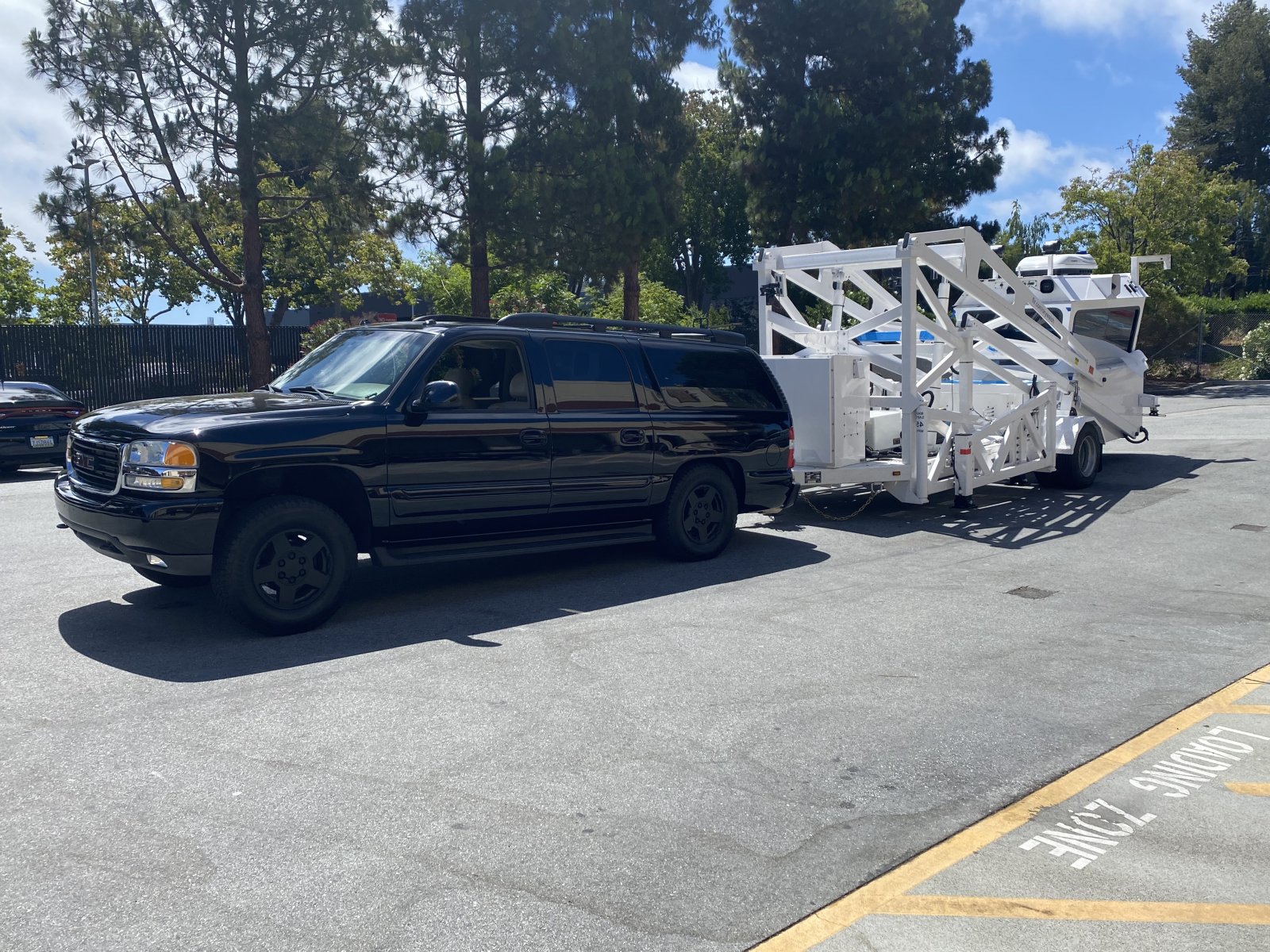

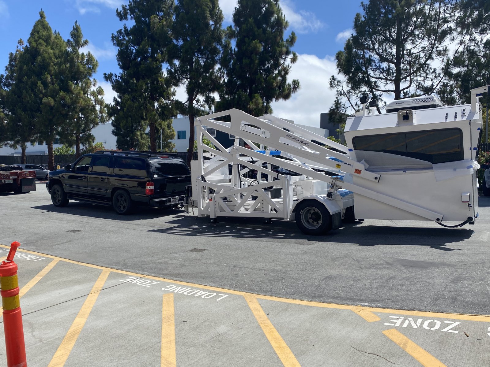

The Pearl was putting in some serious heavy lifting today at work. The freight guys showed up two days early to drop off a Flir Skywatch for a project we are working on. My work truck is a little Toyota Tacoma and doesn’t have a hitch. So I went home and pick the ol girl up. The Skywatch unit weighs a little over 16k lbs. Hitched it up an yanked it off the Low-Boy. So glad for those 4.10s in the axles now. Luckily I didn’t have to far just move it around in the parking lot.

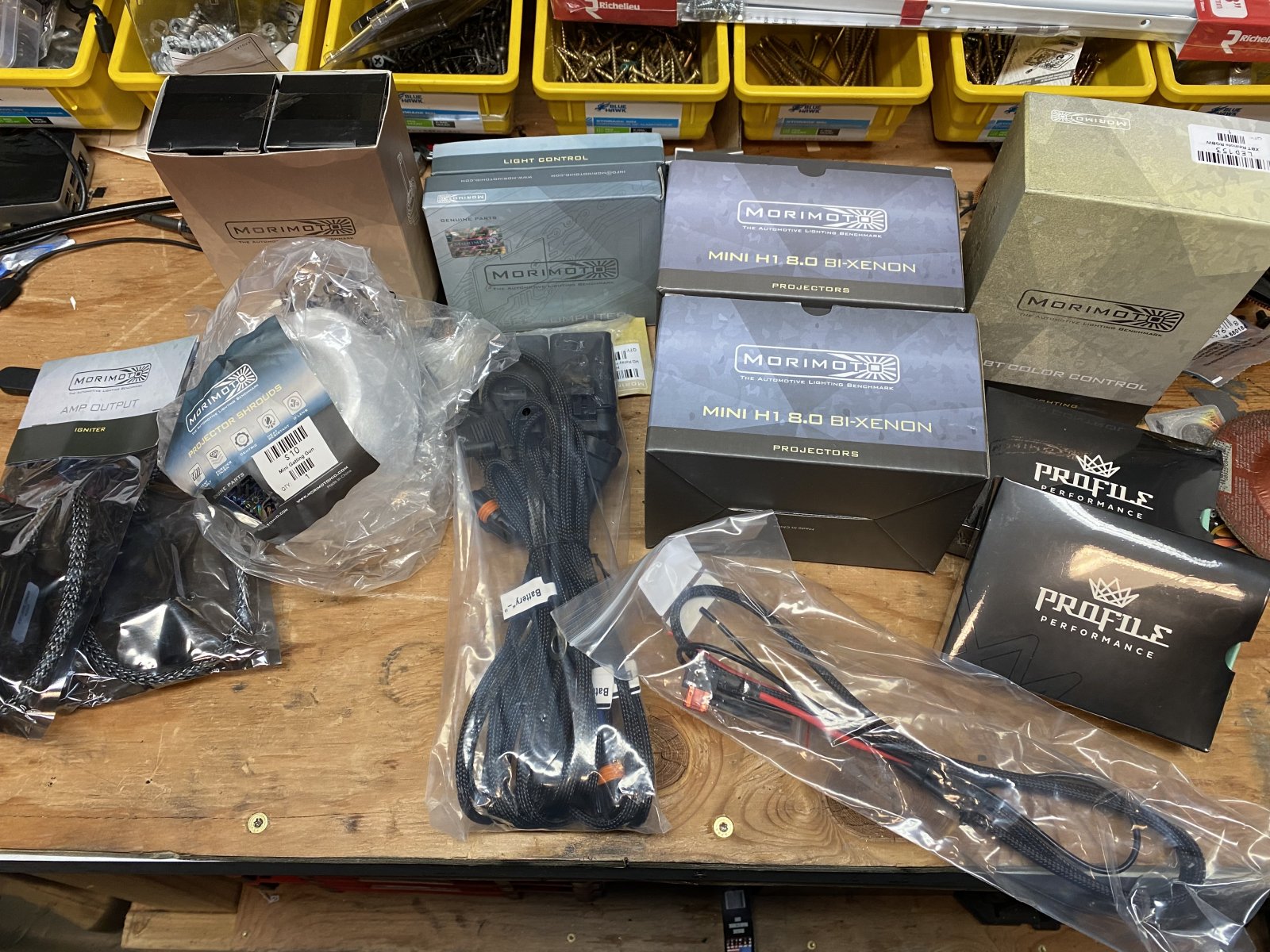

Mail call! My order from The Retrofit Source showed up! Got some Mini H1s, some 6000K bulbs, mini Gatling gun shrouds, 35w ballasts, Profile Demon eyes, the XBT Bluetooth controller, and the HD relay. I’m super excited to try these out.

The Pearl was putting in some serious heavy lifting today at work. The freight guys showed up two days early to drop off a Flir Skywatch for a project we are working on. My work truck is a little Toyota Tacoma and doesn’t have a hitch. So I went home and pick the ol girl up. The Skywatch unit weighs a little over 16k lbs. Hitched it up an yanked it off the Low-Boy. So glad for those 4.10s in the axles now. Luckily I didn’t have to far just move it around in the parking lot.View attachment 344228
What is that?

Big brother is watching.
Pretty much, you can’t get away with a whole lot on our campus. It doesn’t really help that the campus is so open and accessible though. We get protests that come through pretty frequently.

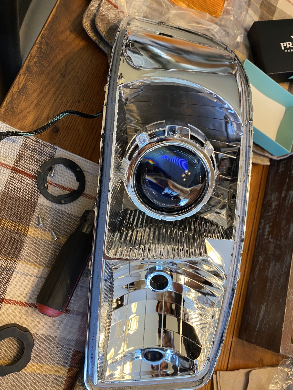

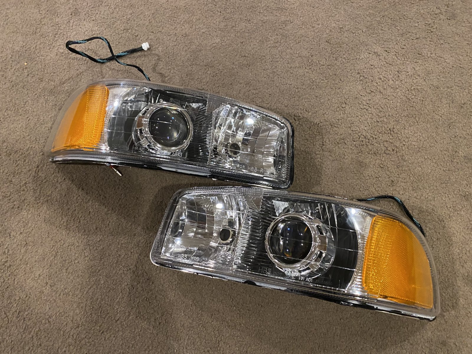

Off of work for a few days leading up to a vacation, so I thought I’d try my hand at my Retrofit. Threw some housings in the oven at 170* for 15 min and split the housings. I trimmed out the standoffs, and made some adjustments with a dremel. I was able to get the Mini H1s installed with the demon eyes, and the Mini Gatling gun shrouds. They look so awesome. But when I went to test fit the lens it doesn’t sit flush and hits the projector. *sigh* So much for that, I really didn’t want to buy new Denali housings but what can you do. Also don’t tell my wife I put headlights in the oven and was working on them at the kitchen table…
View attachment 345481View attachment 345482
I'm sure she wouldn't mind :anitoof:

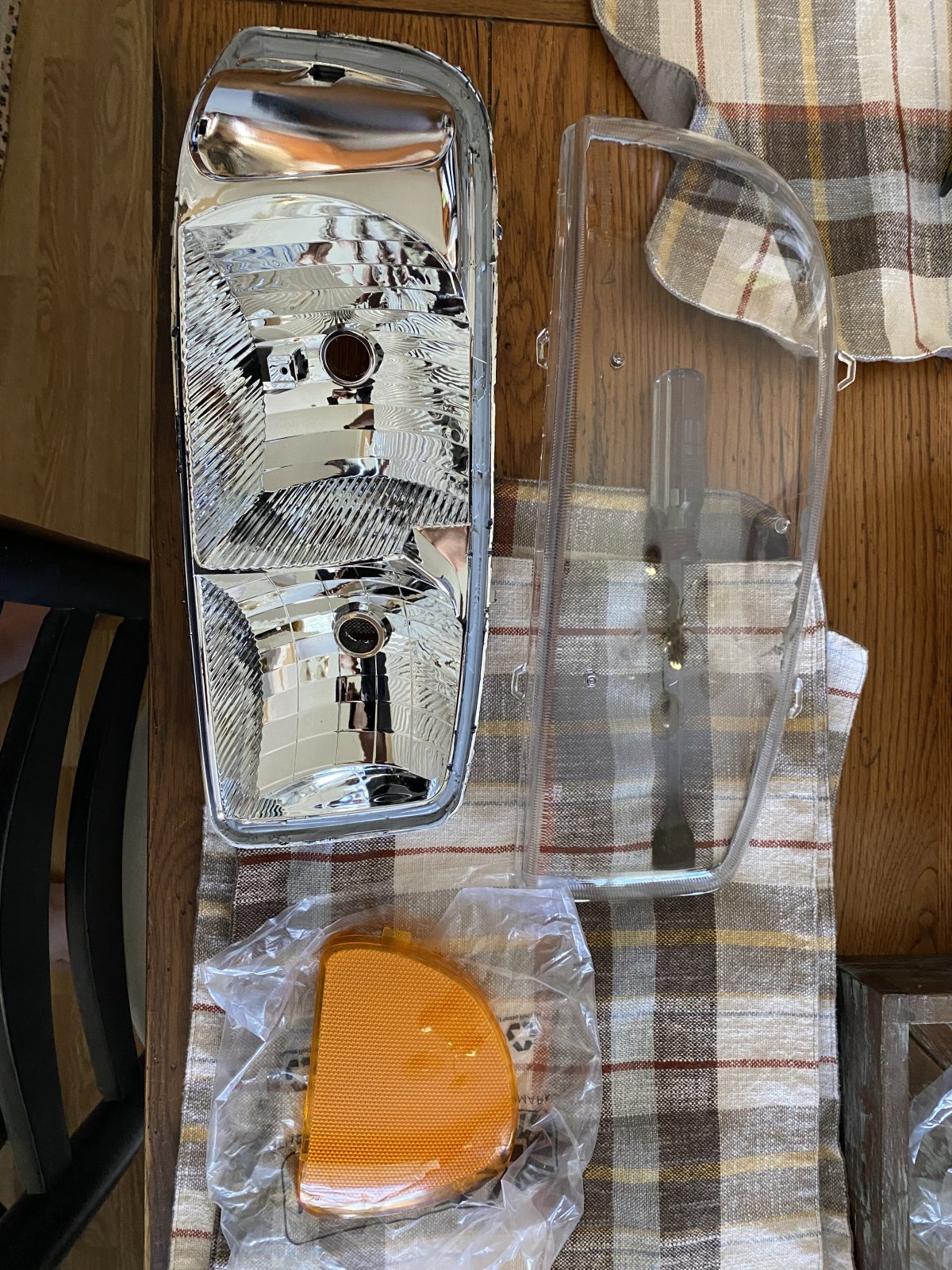

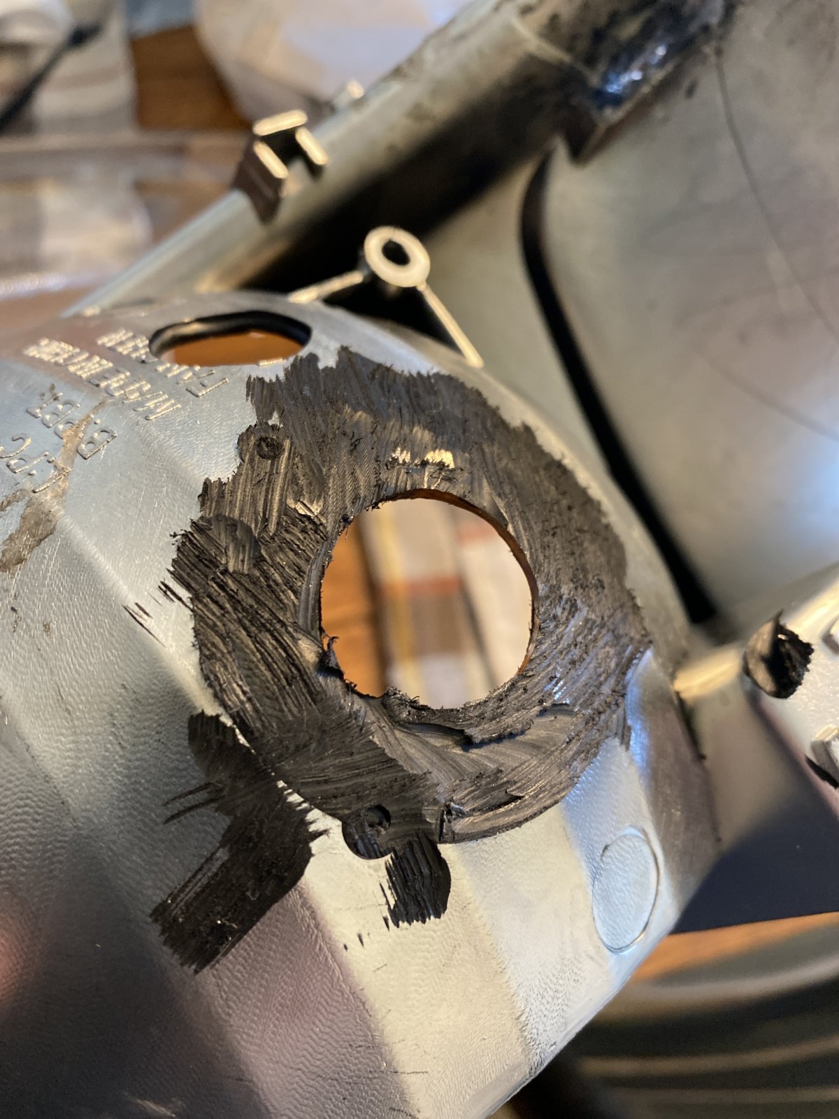

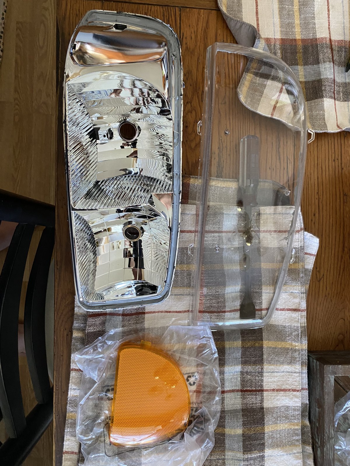

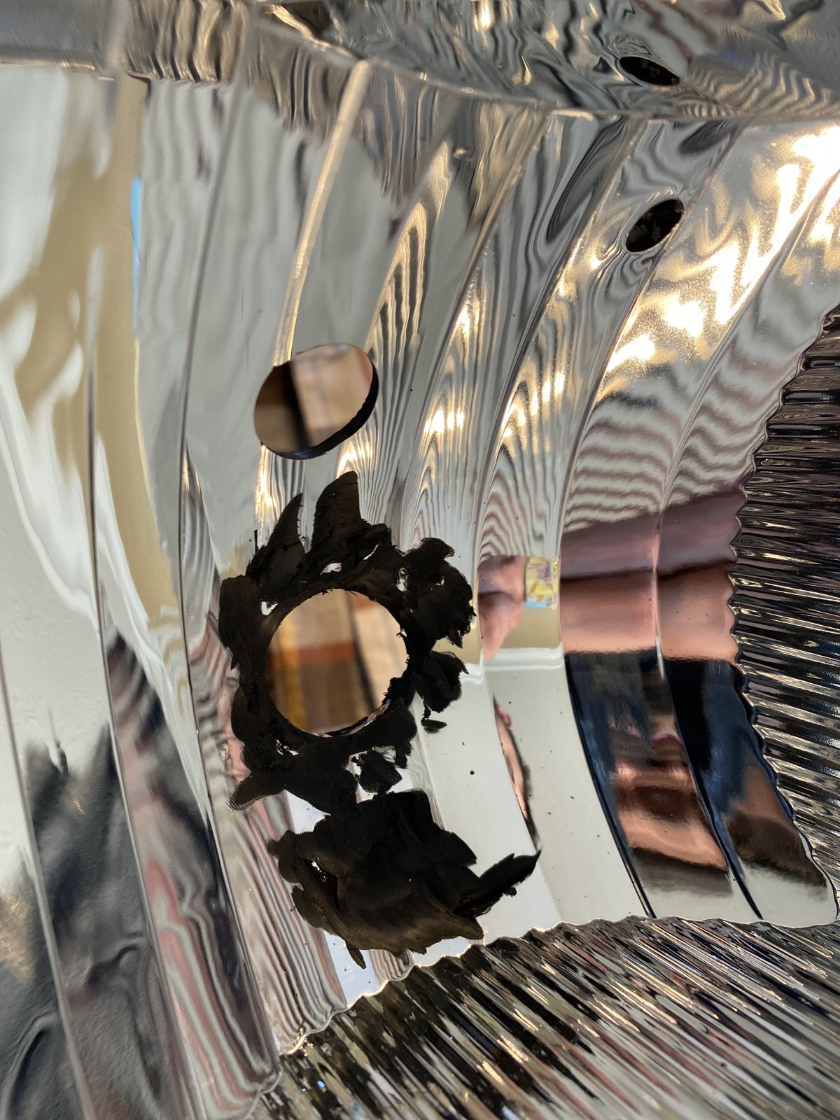

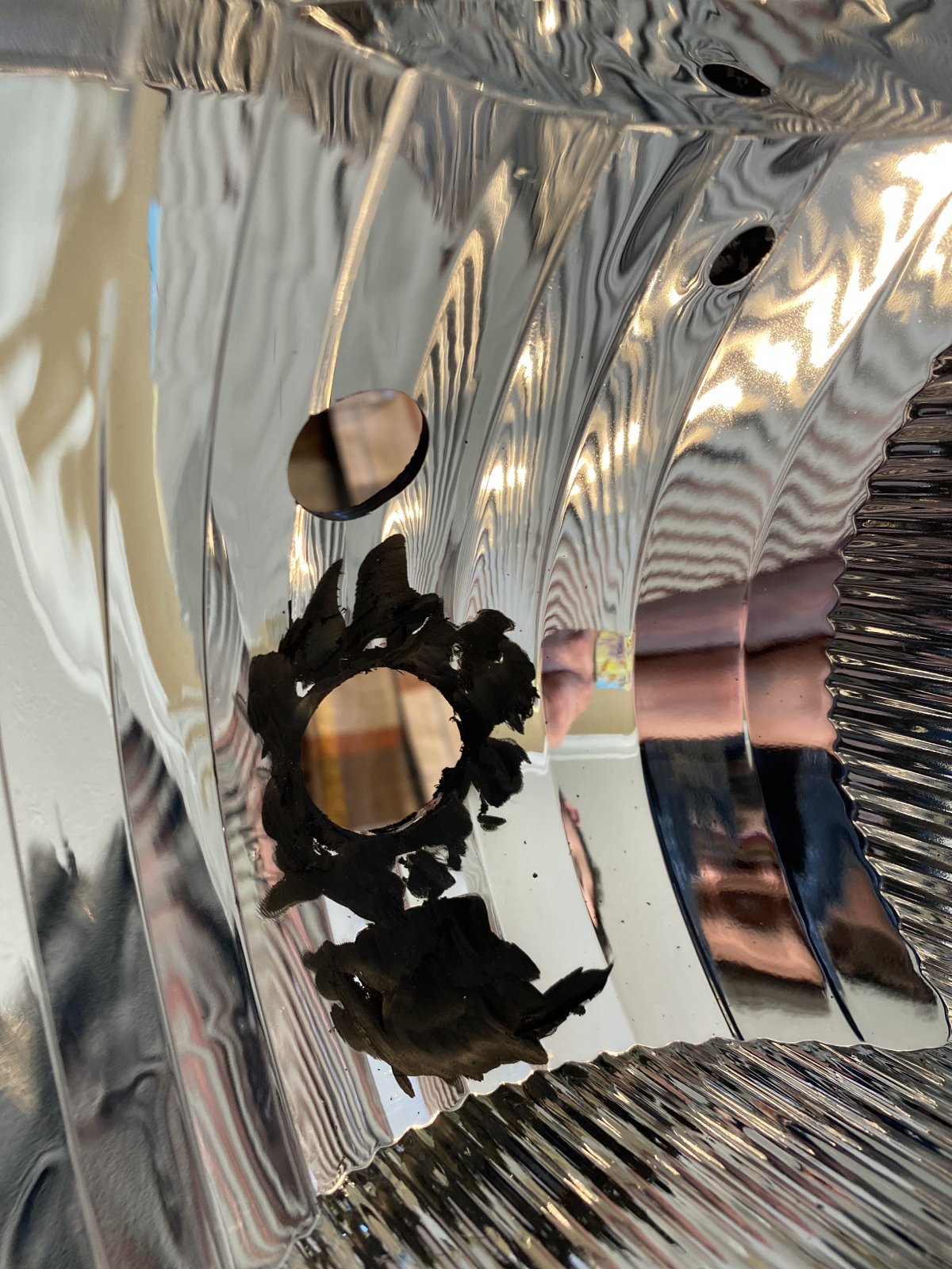

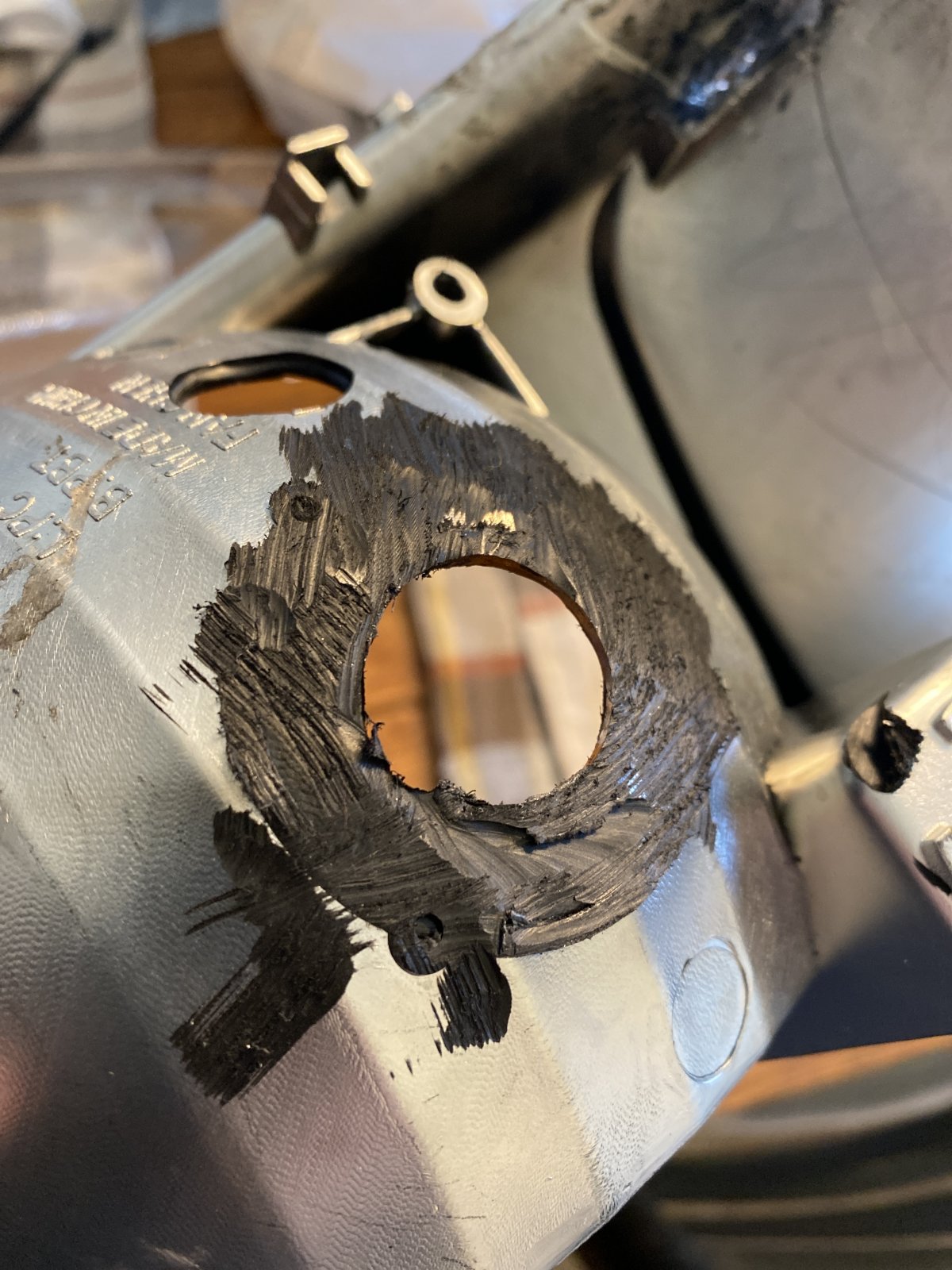

Ok, got the new OE style Denali housings and started breaking them down for the swap. I’m having trouble getting the adhesive they used on the projector body itself to come apart. @adventurenali92 and/or @Rocket Man how much heat and how long did you hit them with to swap the Morimotos in? I started with 15min at 170* and then went to 250* for 10 min and still won’t budge. I’m tempted to try 350* for 10-15 and see what happens.
For some reason the aftermarket companies use super strong adhesive to hold those projector bowls in to the headlight itself. I mean I guess it keeps them from leaking. Lol
anyways I ended up very carefully using a heat gun to heat up the adhesive that held the projector bowls into my anzo u bars, and I had to work the heat gun and a pry tool at the same time to get the adhesive to give way and let the projector bowls separate. It was really trick and in the process I actually chipped off one of the screw mounts. I had to JB weld that back in place before I could reassemble. Lol. So I messed mine up a bit. Maybe @Rocket Man has a better solution for getting those bowls separated?!?!

Welp, so much for that. I attempted again this morning first with my heat gun and got nothing. Then I tried 350* for 12min. Two things happened - 1) the clear lens separated very very easily and 2) the Headlight itself crumbled in my hand as I tried to separate the projector bowl from the back. That sealant is no joke and now I‘m out a passenger side headlight. Not gonna lie a little more than frustrated but c’est la vie. Going to try something with the older housing I have and started modifying.
On the upside if anyone needs a Driver side OE style Denali headlight from Eagle Eyes I have one for sale.

well after lots of frustration and a lot more money than I wanted to spend Projector Retrofit V1.0 is completed. I’m going to start the install hopefully later today after work.
As a reminder here is the parts list:
Morimoto Mini H1 projectors
Mini Gatling Gun shrouds
Morimoto 6k HID bulbs
Morimoto 35w ballasts
Profile LED Demon Eyes
Profile LED XBT Bluetooth controller
Morimoto Retrorubber sealant
I also have a pair of Klearz Clear reflectors that I might install at a later date.

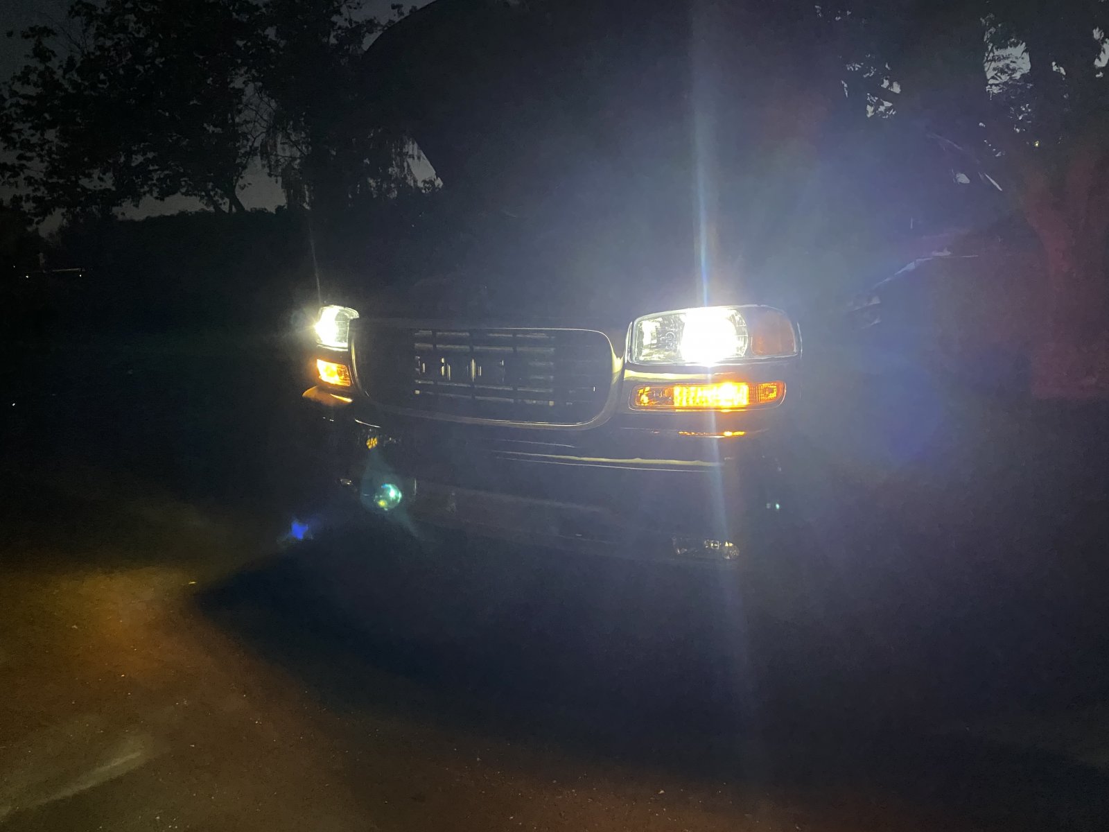

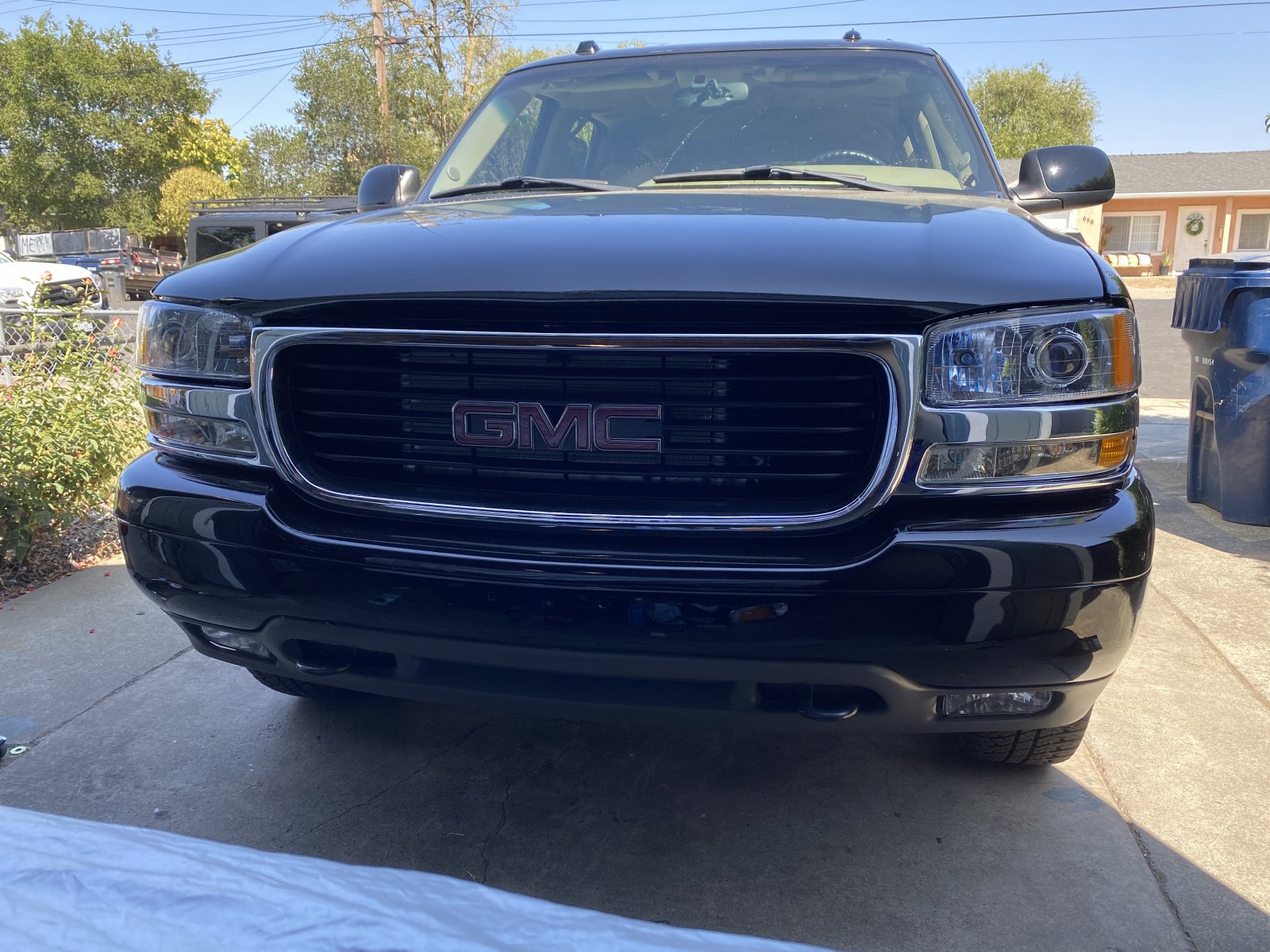

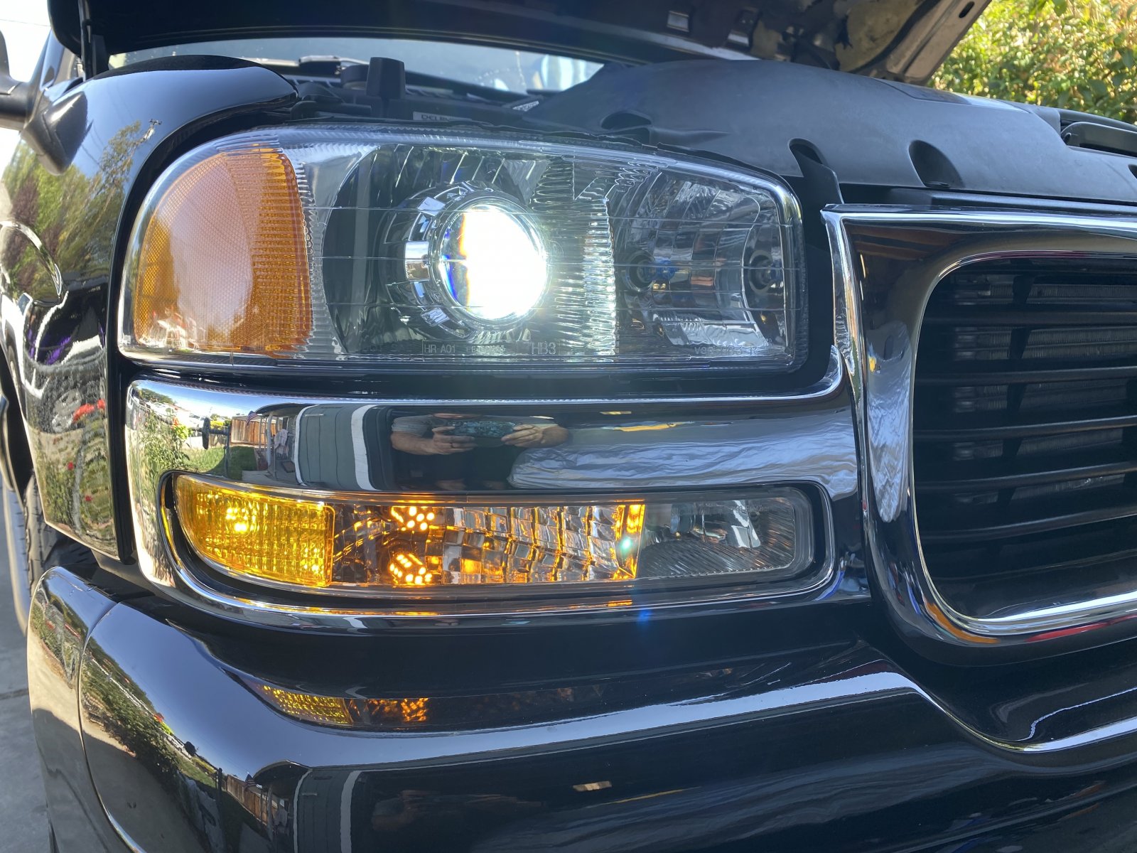

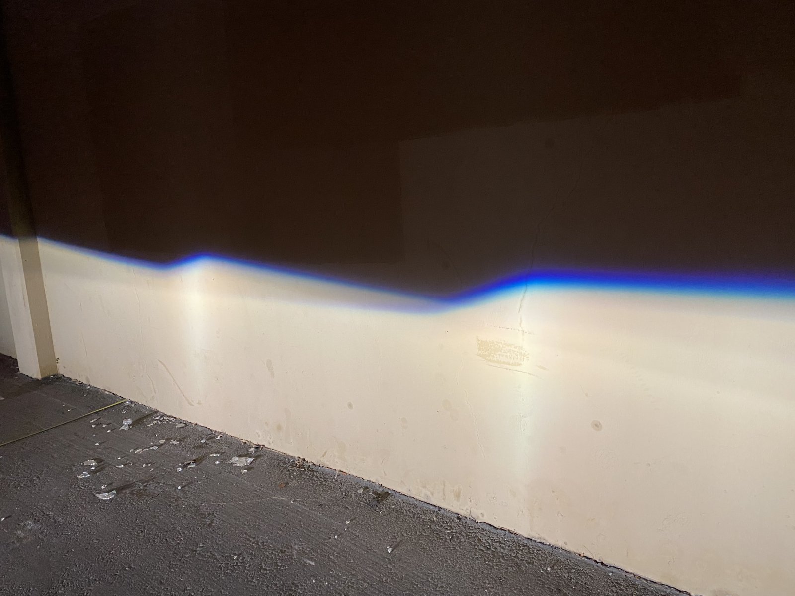

Projector Update! Got Everything installed last night and I'm so stoked on the results. The light output is insane compared to the old halogens. I need to do a little more adjustment to the driver side as I think the projector is rotated a bit in the housing as you can see in the output pic. Need to still wire up the XBT controller and the High beam on the Mini H1s and its all done. Hopefully going to have that done today or tomorrow.
