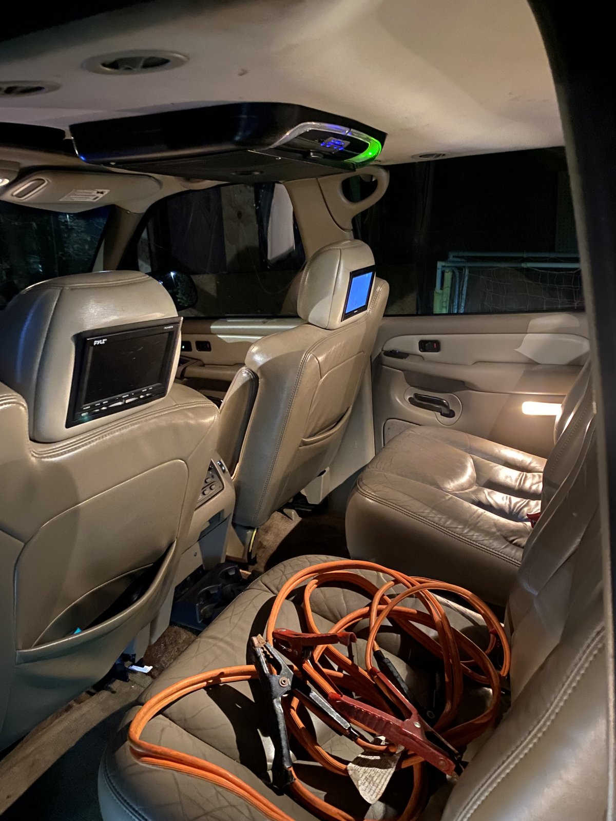

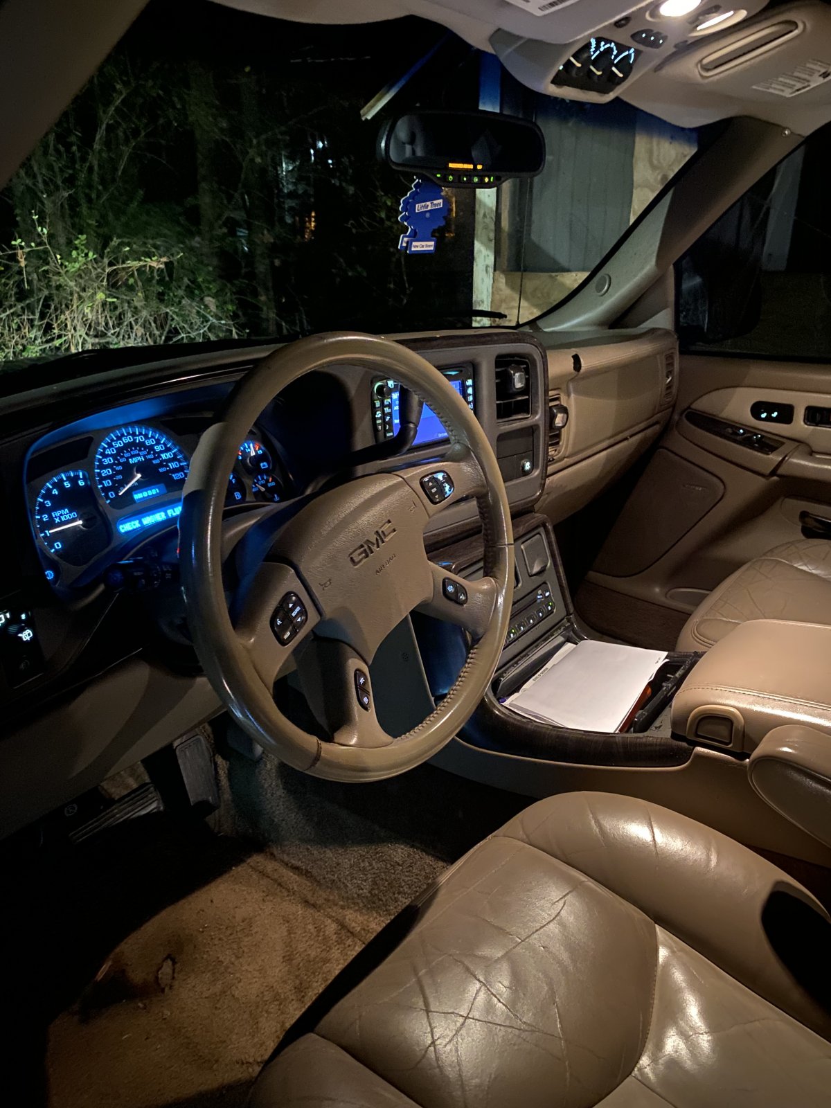

It's a Denali, so it's loaded. All of the windows, AC controls, and heated seats function properly, but as is common, a lot of the buttons stick and have excessive wear (thanks for the cheap paint GM). My plan is to just replace the driver door control panels as well as the steering wheel controls. Have any of you ran into issues swapping these out? It looks as simple as swapping out the old ones for new ones and it should be good to go.
Aftermarket DVD players/monitors:
The vehicle has 2 7" screens in the front headrests and a fold down 17" DVD player (Pyle brand... I know lol) which are all inoperable thanks to KIDS. All of the units have power they just don't turn on. I'm looking for recommendations for replacements. What do you have or what have you had experience with? The options are endless online so I figured I would consult the forums first to gauge what the community opinion is.

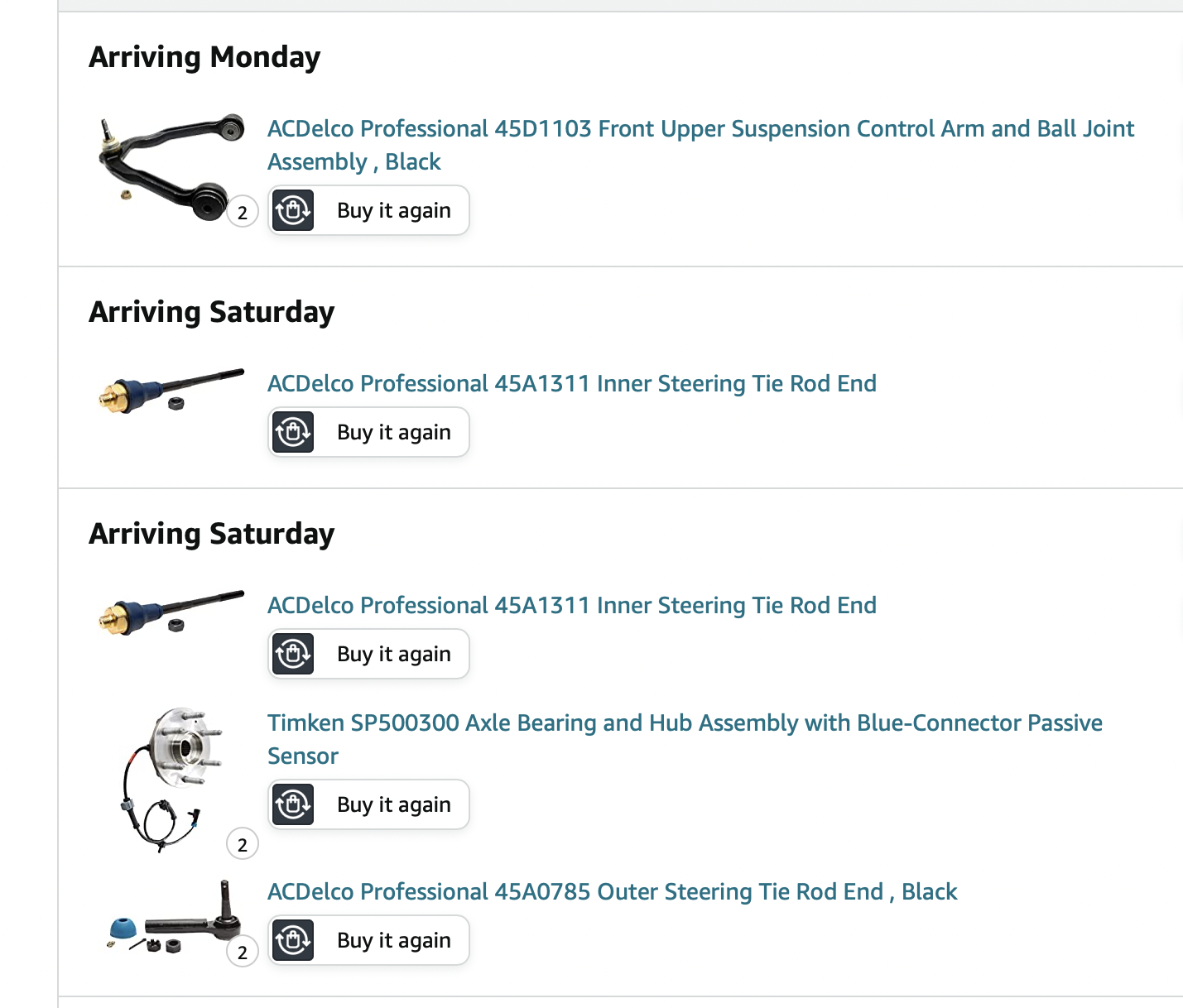

UPDATE: Both the AC Delco Gold/Advantage and MOOG control arms I found online are different than what are on my Yukon. I am having trouble finding control arms with the hole to mount the ride height sensors. Does anyone have the part number that's specific to models with autoride? Just about everything online states Tahoe/Yukon/Silverado/Sierra but most disclaim "excluding models with electronically adjustable suspension"
Thanks in advance
21,278
30,213
Thanks in advance
Plug your VIN in here and have a look:

That link was a lifesaver my friend! I was able to find all the correct part #s and ordered all AC Delco Professional suspension parts and the Timken hubs. Thank you

If you take these part numbers and cross to RA with those numbers, can likely get at RA.
I crossed the numbers and there are at least 2 of each at RA.
45D1103 $81.79 ea. at RA
45A1311 $33.79 ea. at RA
SP500300 $101.79 ea. at RA
45A0785 $36.79 ea. at RA
