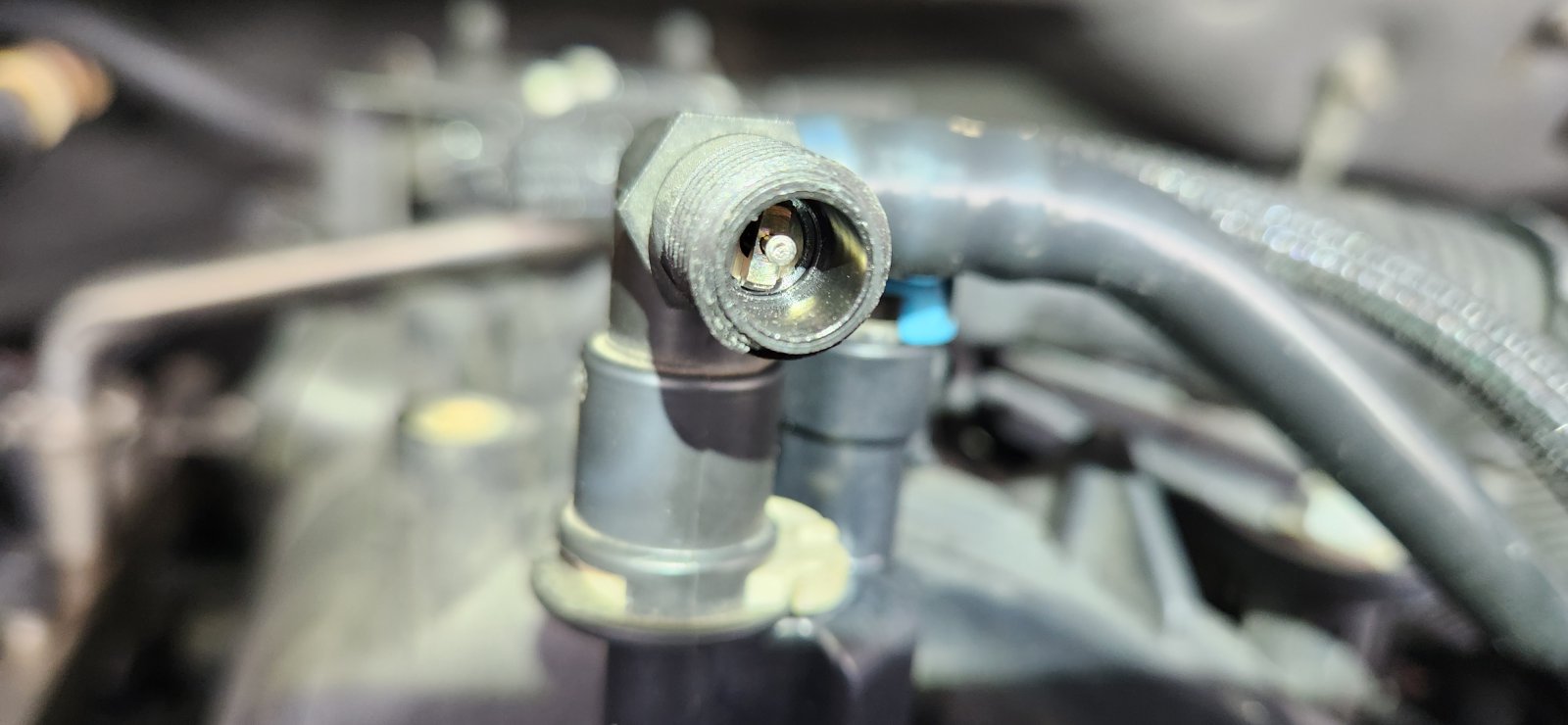

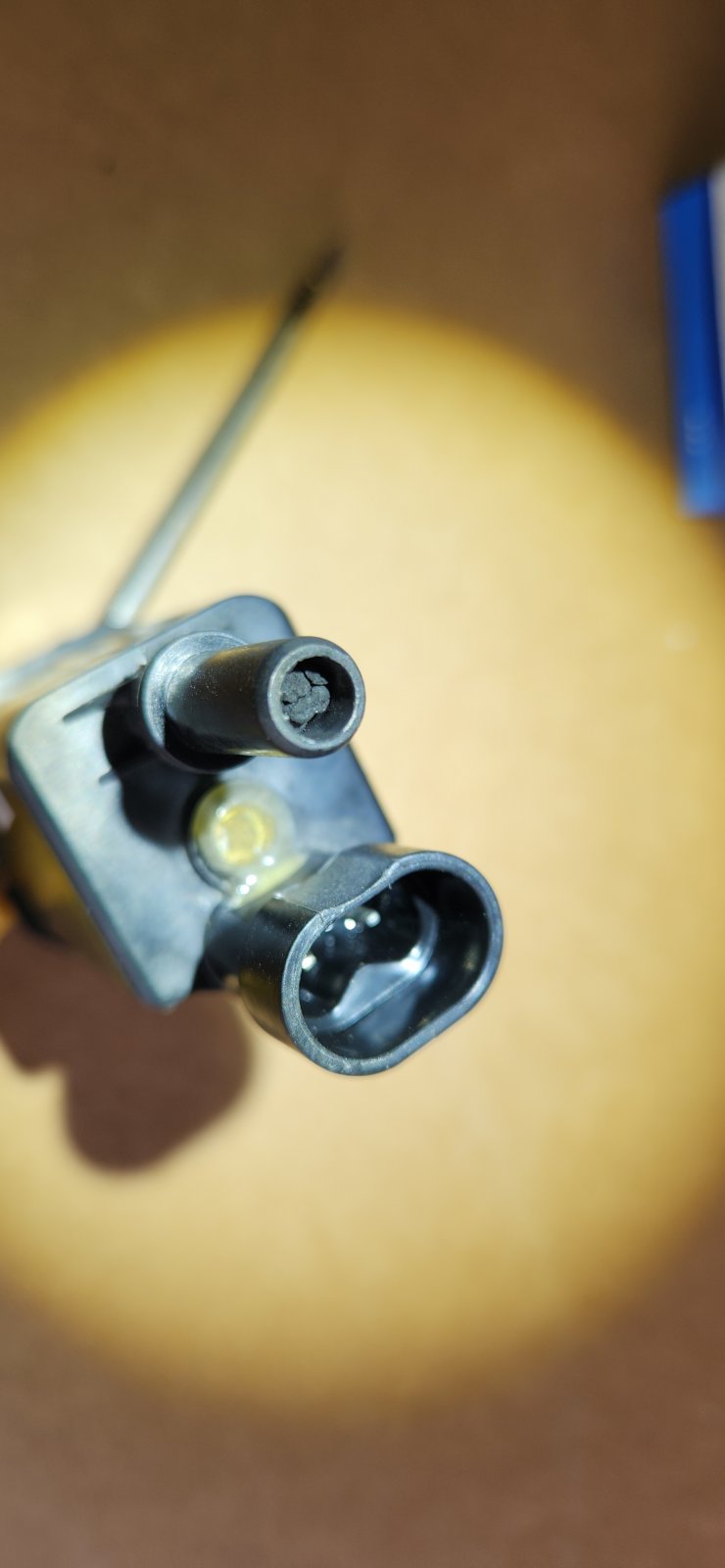

Just replaced the Purge Valve....
#1 Notice the charcoal bits stuck inside the OLD canister tube-intake..Should I blow out the tube, after disconnectthe other end, from the rear canister??

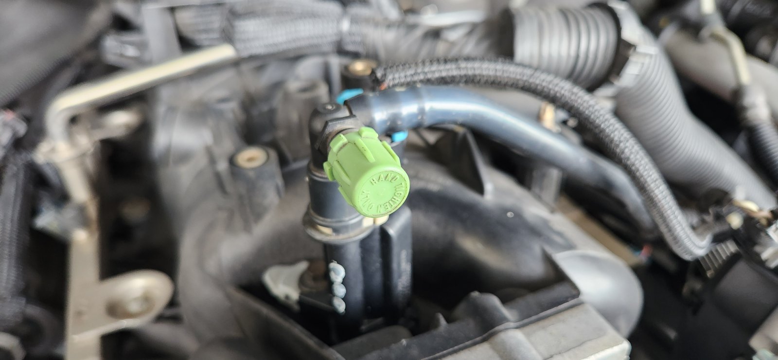

#2 The green cap covering the valve opening..
#3 The valve inside the green cap.... A "tire style valve" ? Huh? Anyone change that?? ( Leave it alone?? )
