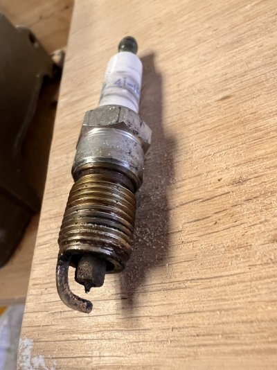

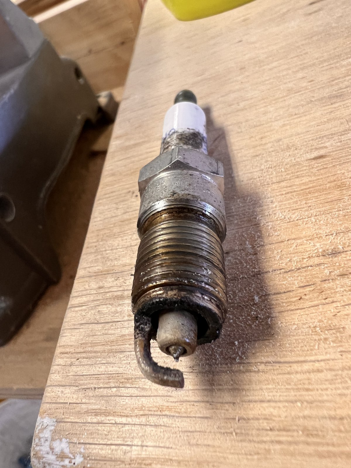

Worked on the truck again today.
- Changed spark plugs and spark plug wires
- MAF sensor cleaned
- Air filter replaced
That #8 plug was kind of a pain, but I decided early on I was going to attack it from the wheel well, removing the liner and everything made that easy.

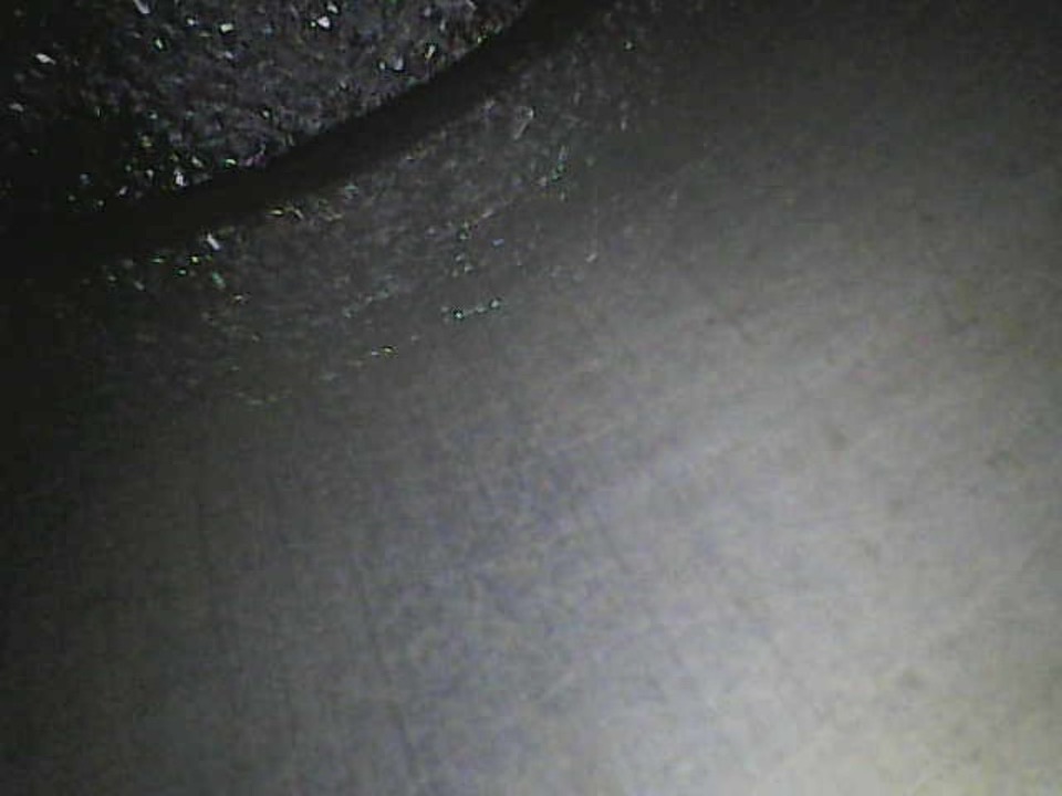

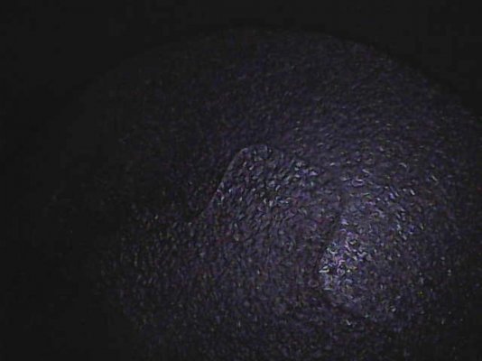

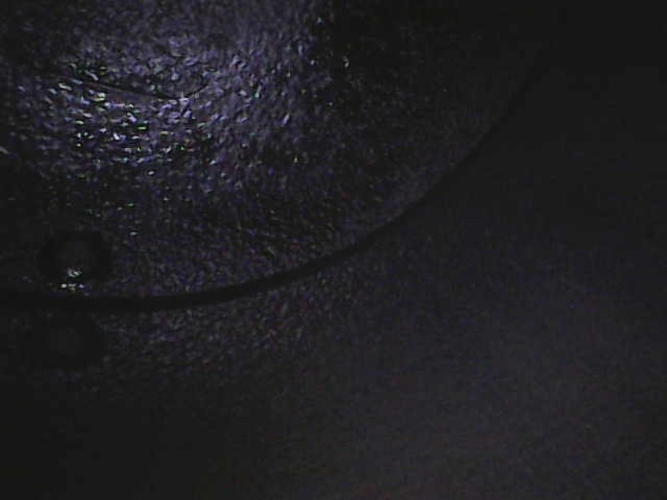

Old plugs were toast. I've attached some pictures of the plugs and I scoped the cylinders for y'alls enjoyment.
The engine seems to be idling much better, although still some work to be done.

Spark plugs 1,3,5,7

Spark plugs 2,4,6,8
