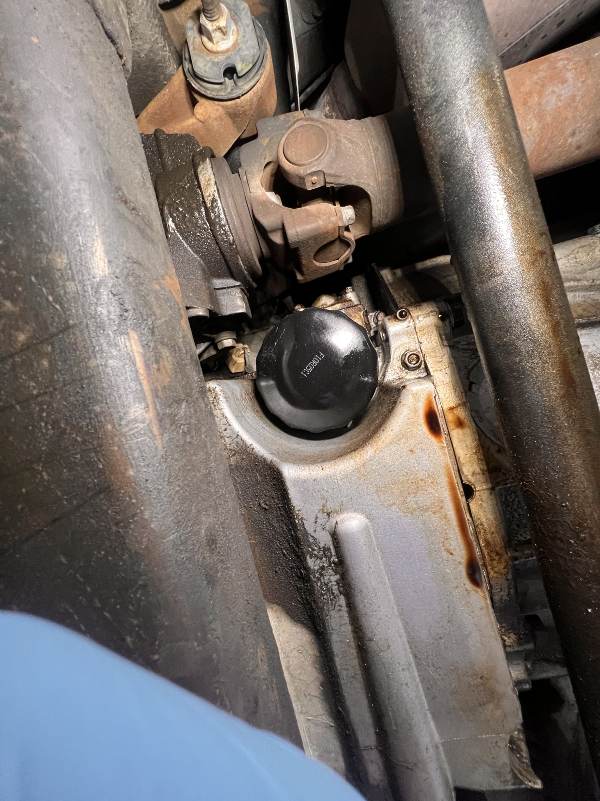

A new issue has popped up in the last few days, seemingly after I got it aligned. I posted about that here: https://www.tahoeyukonforum.com/threads/stabilitrak-and-traction-control-lights-issues.150828/

- Billet plate, @Geotrash hit it on the head, the new gasket started leaking like 300 miles after I installed it.
Update the sheet: https://docs.google.com/spreadsheet...bu72tmHjlNl6JfKaB8RhxUZqCZEiyovnIHoMO/pubhtml
As well as some pictures, from the looks of that strut.. I think this truck has a small 1.5"-2" lift?
