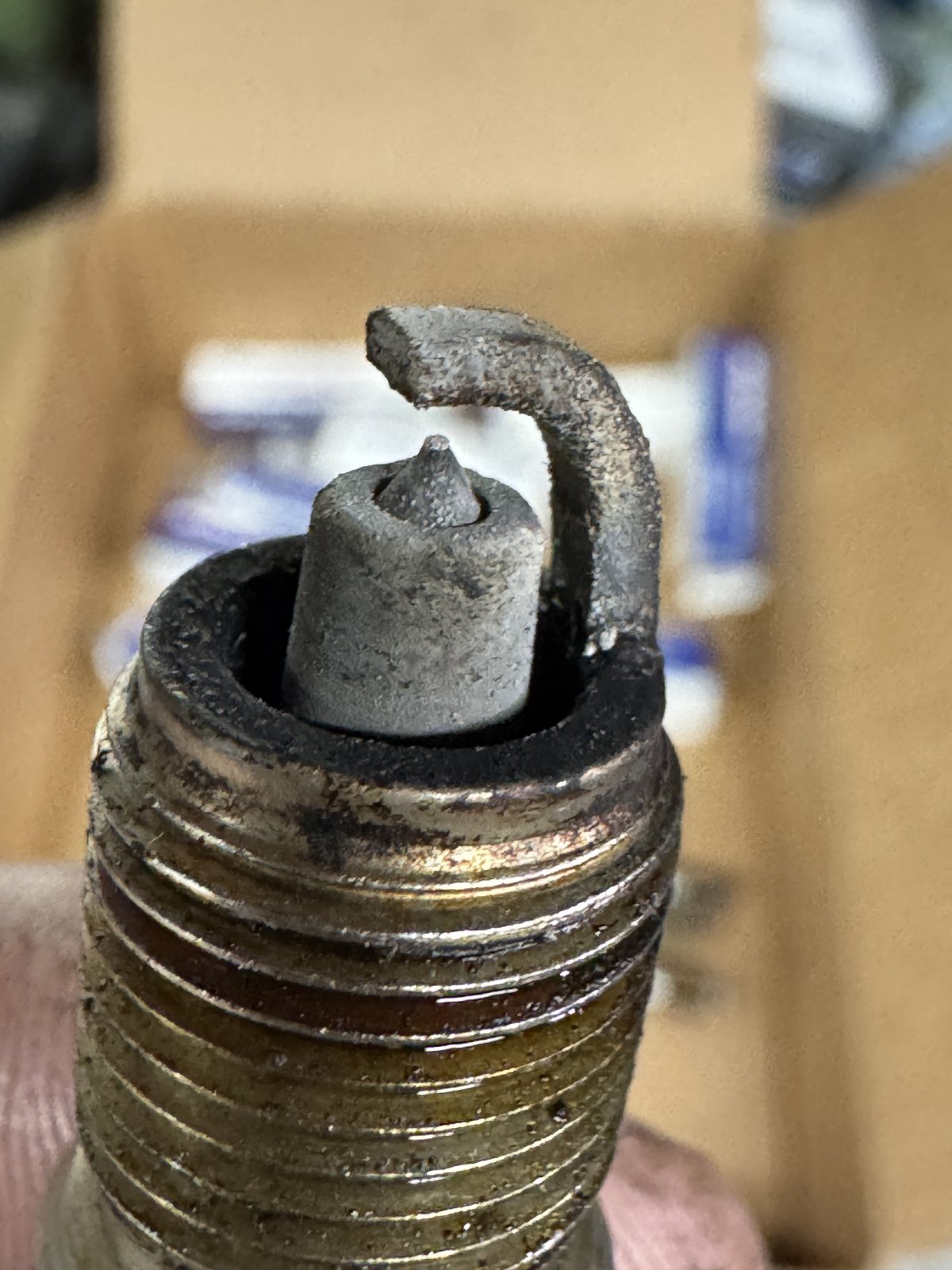

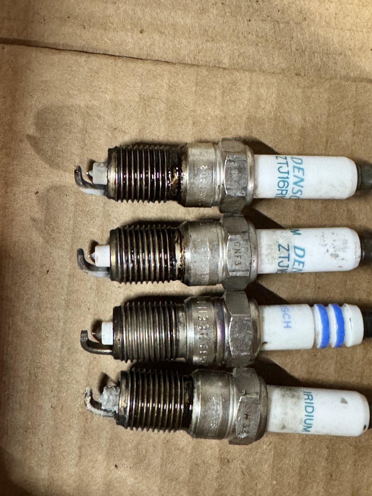

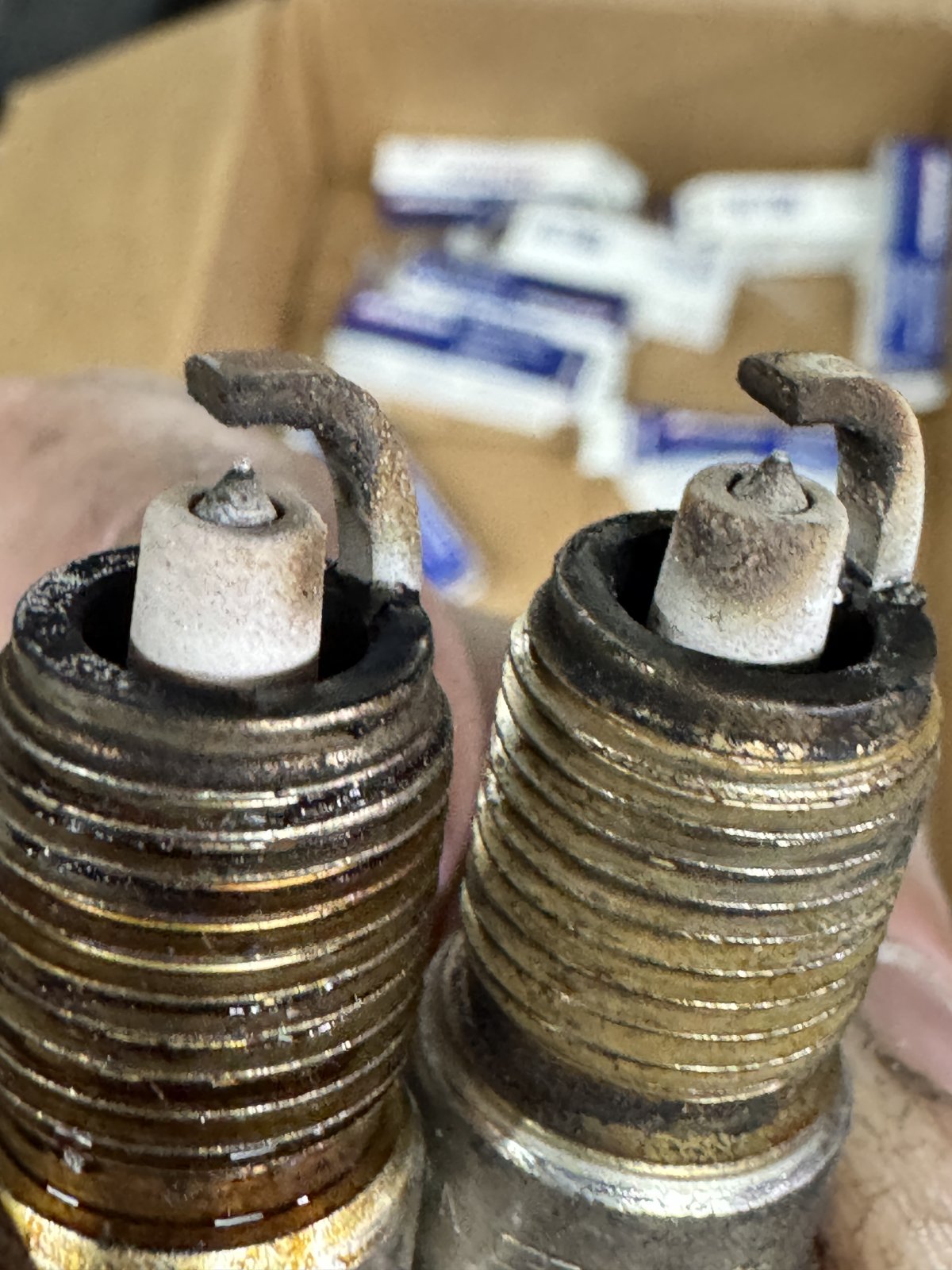

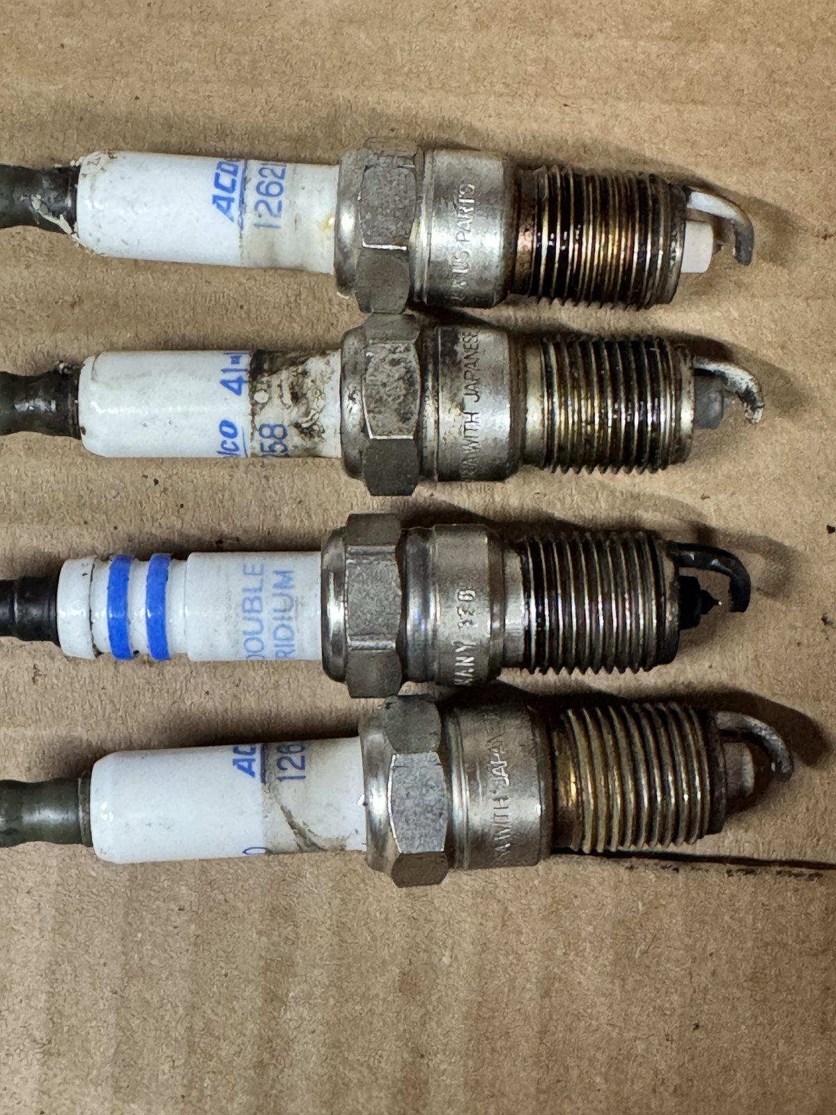

Nasty plugs. if it had different plugs, might be with it to replace the wires too. As far as the AFM disable. The easiest thing to do is just a module plugged into the OBD port. Then no worries, just unplug it before your test. No software. I bought this one on Amazon and it worked better than the Range brand unit I had before. At least your covered until you can get it deleted or whatever you do.

Unfortunately the way those AFM disablers work is to cause an interference with the monitoring tests and when a code appears in the computer it automatically clears it. So if thats the case I would need to still drive for a bit to pass the tests that were interrupted.
Or at least thats my understanding of it.
