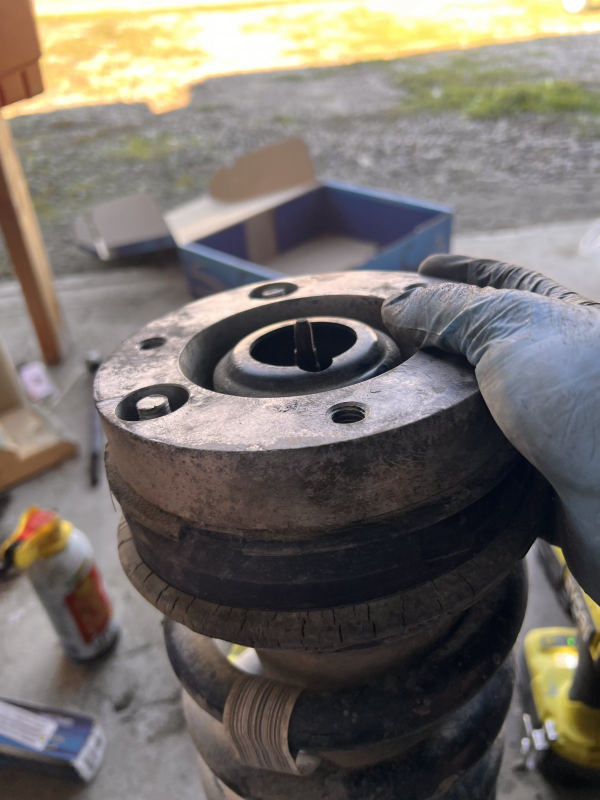

As well as some pictures, from the looks of that strut.. I think this truck has a small 1.5"-2" lift?
