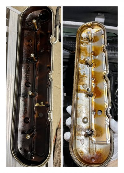

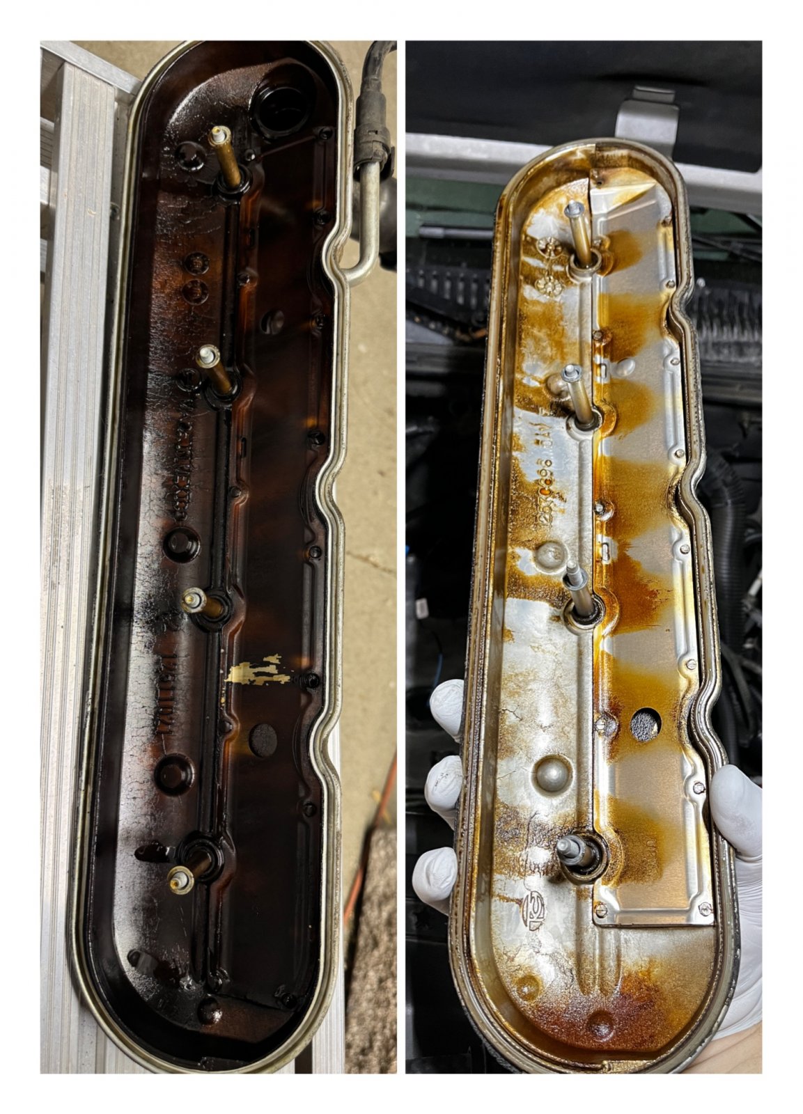

For a fun comparison.....
The Left image is the passenger valve cover from this 2013 5.3L AFM w/ 94k miles. Appears to be ~10k mi OCI (following the message on the cluster) with cheap synthetic oil and no name filters used.
The Right image is the driver valve cover from our 2004 5.3L NON-AFM w/ 198k miles. 3.5k mi OCI with conventional oil but purolator or mobil 1 filters used.
Clearly these AFM engines need to keep the oil change interval below 5k miles regardless if its synthetic or not.
For fun you can see where the rocker arm was smacking the underside of the valve cover in the left image :smh:.
