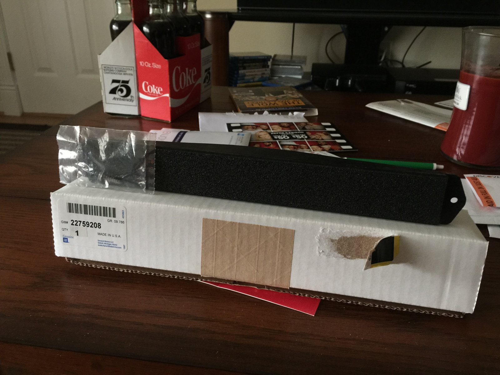

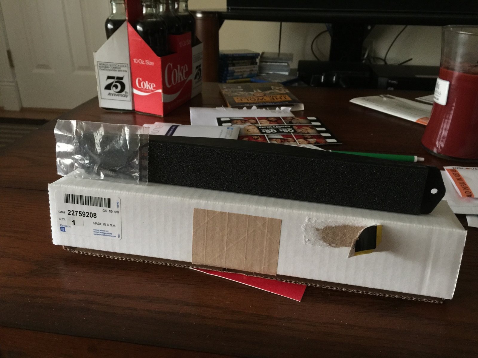

I saw you mentioned cabin air filter replaced by the dealer. GM never installed the CAF in any of the 07-14 Escalade. It’s a common upgrade option they offer though.
Either a previous owner installed a CAF on your truck or the dealer never changed it because the add on kit wasn’t there. They do work well. Once you clean all the dust off the diffuser vents, they’ll stay clean.

What all did you have to do?
Very simple. Order the "kit" and cut out a little material and put a filter in. The air box is perforated with the outline. Order filter for pre 02
30,751
48,442
the dorman filter fits best because it has a waffled edge and will slide right into the filter slot without being forced and bent up.

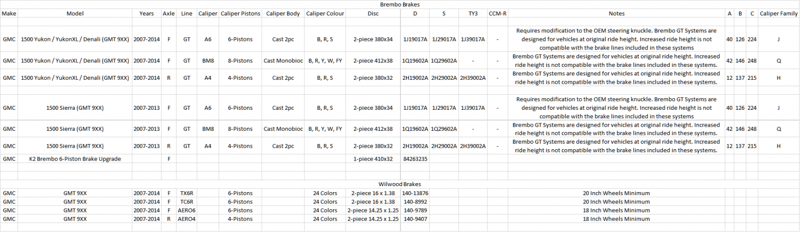

Very true. Which is why I just completed going through the brakes. Turned all four rotors, new pads, all new hardware, slider pins, drag reduction clips, flushed the brake fluid, etc...then bedded in the pads to the rotors.
In the future, I am considering upgrading to the 16" front rotors and 4-piston calipers from the 2021 trucks. We shall see...

I did this to the avalanche. I'm not sure how much of a difference it made, but it's got a filter and I feel better about myself. That's gotta be worth something
My daughter and I drive many of the same routes. Her interior is covered in dust, mine is not.
The Carbon ACDelco filter does as well. CF193C
Thanks!
The stock front brakes on the 2021 trucks are 13.5" rotors. The Brembo kit is what has the 16" rotors.
A-Ha! Thanks, I obviously misread the posts I saw. Thanks for the clarification!

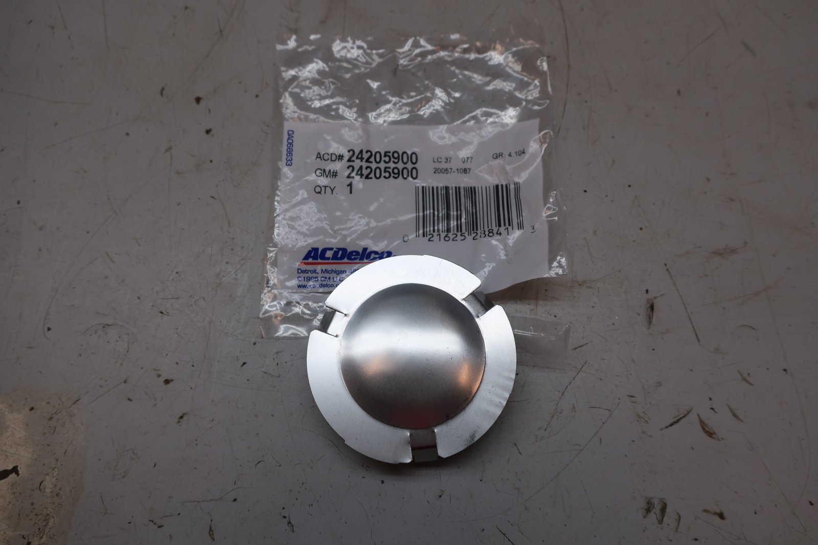

Finally got around to installing the little sheet metal plug in the bell housing. I know it is nothing, but I don't like having the open hole to the flexplate and ring gear.
ACDelco 24205900 bell housing plug.
Plug in its home.

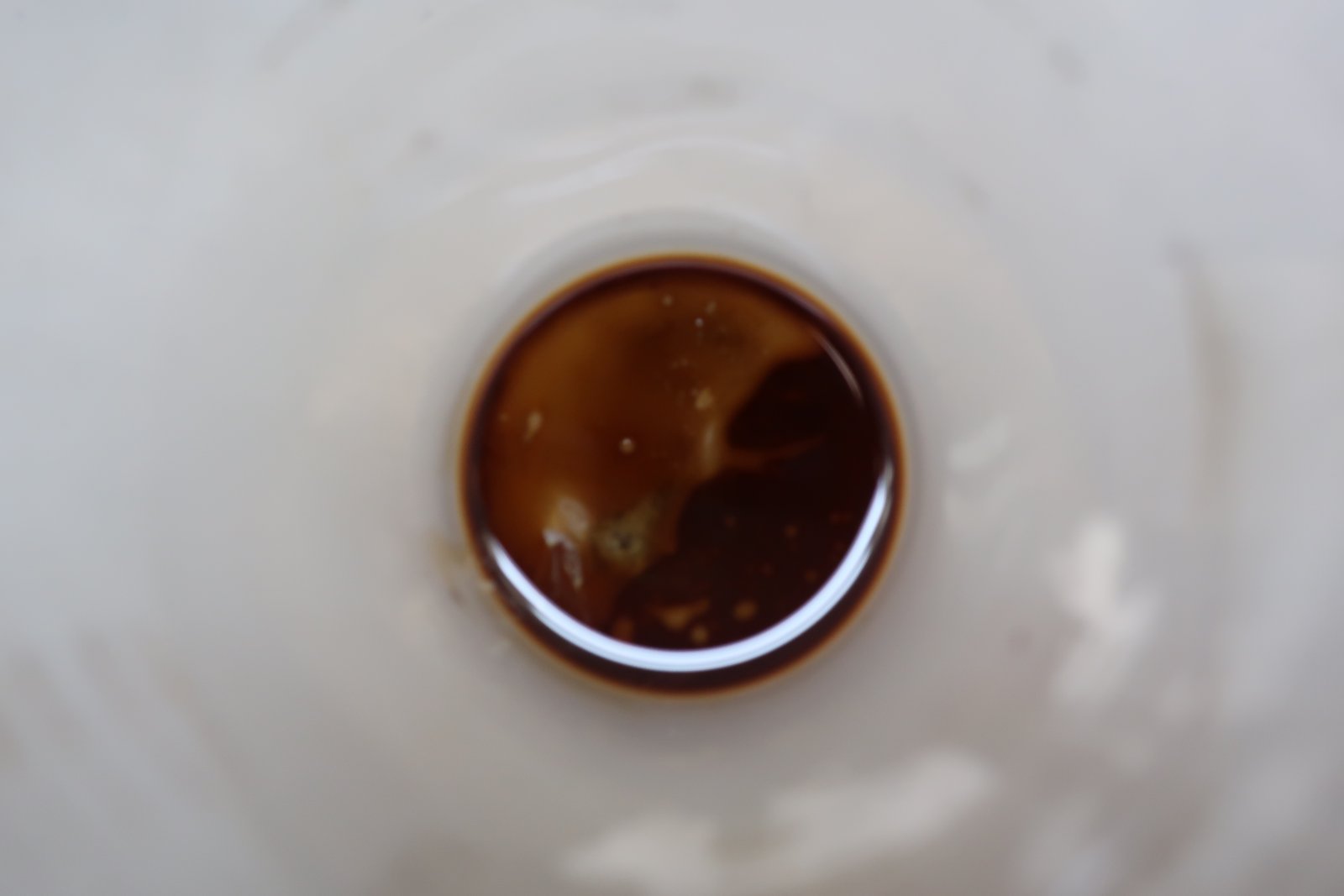

The catch can has only been installed for a little under 300 miles, but I figured I'd open the drain valve just because. And was shocked when something came out! I got some oily water out of the catch can. Less than an ounce, but it existed.
Hmmm...I will start checking this every 1000 miles until I get a feel for how much is generated. Definitely glad I installed the catch can!
Oily water drained from the catch can after 300 miles.
