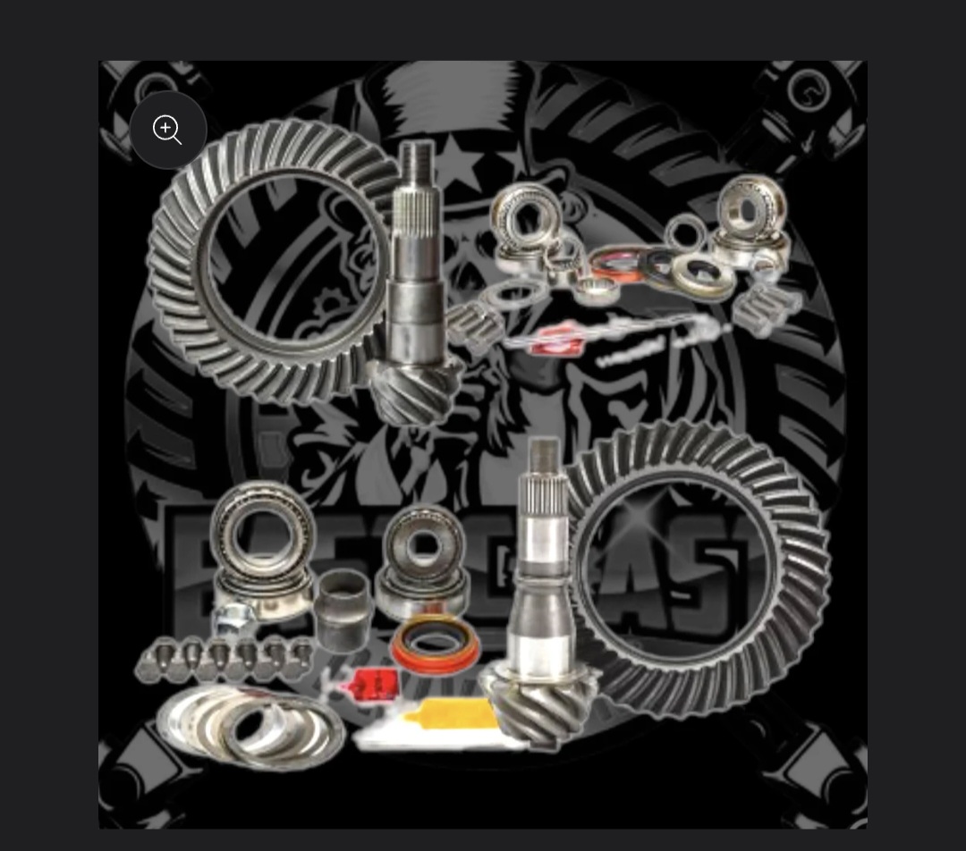

Local shop offers a nice 3.73 package bundle , would only be doing this for some faster acceleration but not sure how bad it'll hurt me mpg wise when I'm on the highway going about 70. Im already on e85 so I go thru gas pretty quick as it is ha. Thoughts?
