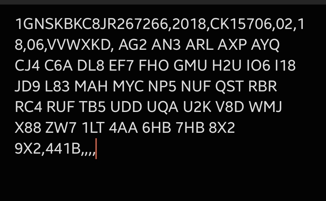

Had to research NYBRD's other posts to find that he originally has a 6L80 & 3.08.
6L80 & 3.08 was the most common, CAFE MpG-motivated powertrain package.
6L80s with a tow-pack got 3.42, which was still motivated by CAFE MpG.
6L90s - which were for 2500 & 3500 - got 3.73 or 4.10, because CAFE does not care about 2500 or 3500 vehicles.
