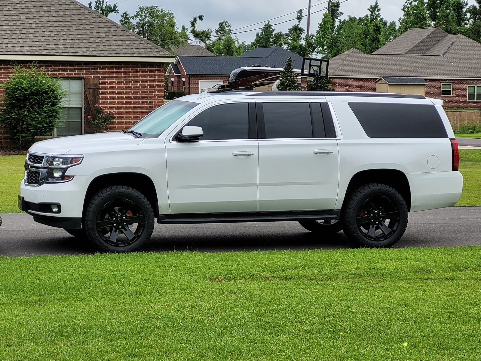

STORMIN08
Nov 21, 2011
974
464
Here is my non z71 suburban...
This is a 2.5 / 1.5 lift on a 33.
All in again, I would just do the readylift set 4".
I have done almost everything g that lift hasinus drop the front diff, and on these it is a simple 1/2" spacer for the mounting bolts.
It goes in this week for new front struts, and upper arms...I am going with a KYB ( my 2011 z71 hoe had those stock), and upper arms are ready lift. I will drop the difference, but I am currently on the road for work and the wife and burb are 900 miles away.
I do plan on z71 rear springs in hope to loose the rear spacer.
