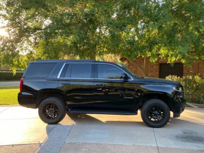

Hey guys, I know this is probably a beat to death topic so I apologize in advance.
I'm about to pull the trigger on some new tires for my Tahoe and I'd love some advice or personal experience input here.
Right now I have the factory 265/65/18 Michelins on the factory 18" wheels.
I'm wanting a beefier and taller tire for a few reasons.
1. Looks - duh
2. I spend summers in Idaho and rural dirt and gravel roads and occasionally some muddy fields.
3. I spend winters going to ski resorts
I'm going to buy some new BFG KM3's from costco and have them mounted up in the next week or so.
I have some Bilstein 5100's set to the highest setting up front to bring the truck to a perfectly level stance.
I'm unsure if I can fit a 285/75/18 tire or if 275/70/18 is as big as I can go without running into significant rubbing at full lock?
Anyone have any info they care to share or any personal experience with these tires on their Tahoe?
Pic for attention..

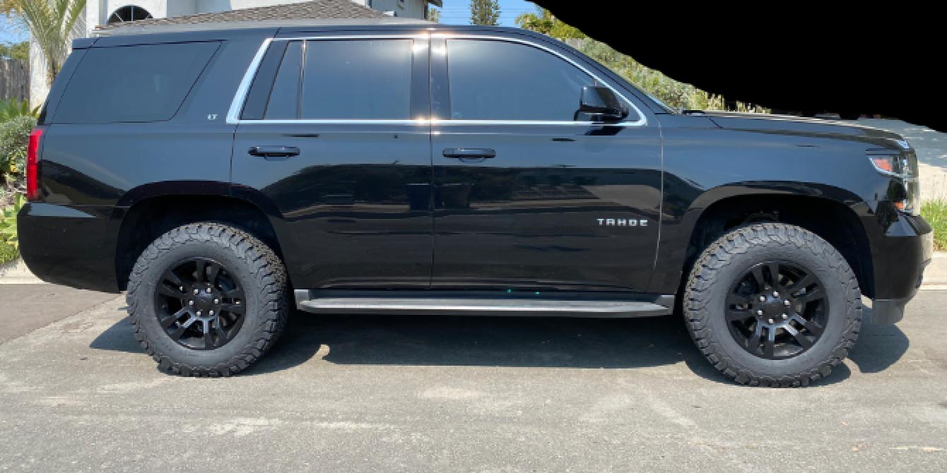

With stock wheels rubbing is a large concern due to the positive offset of the wheels. I went with 275/70R18 and can say that I’m quite happy with no rubbing. View attachment 280129
Yeah good to know. I remember you posting that pic for me before. Maybe I should just be happy with that. I think 275/70/18 still fills the wheel well nicely based on your pic.

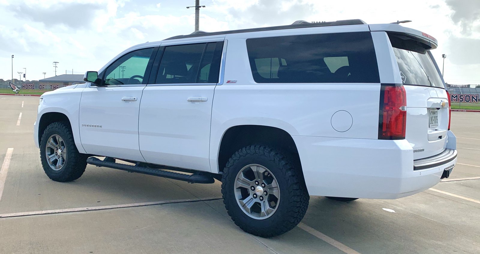

Well I finally got the tires mounted through Costco. I had tried lying to them that the wheels I was bringing them were off a 2500 silverado so that they'd not give me a hard time about the size difference. My hope was that they'd be so unaware of the 6-lug vs 8-lug difference that they would never know. I think the service manager at my local Costco Tire Center doesn't like me, so he went out of his way to look at the wheels and determine they weren't the right ones. They said they'd mount the tires and explicitly write on my "file" that they have no warranty through Costco. So good for them on protecting their giant corporation I guess, and at the end of the day it's whatever. I tried what I could, I can't be mad.
I think the 275/70/18's look great! Fills out the wheel wells much better than the factory tires, and no rubbing even at full lock.
