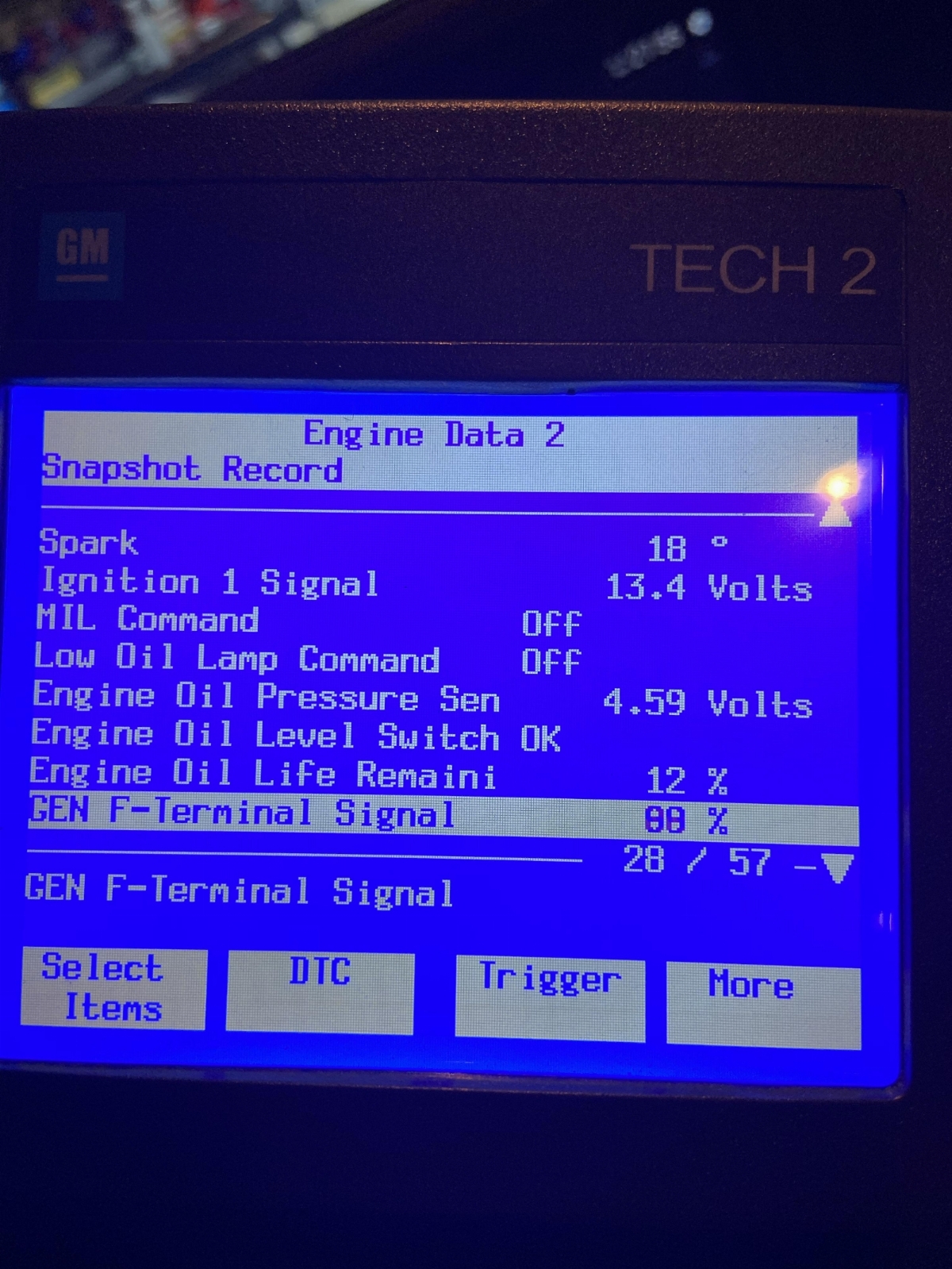

Hey guys, so when I bought the Yukon it had a bad pressure sensor. I replaced it with a standard, since I broke the top off the Delco one I had bought. Lol. The standard failed catastrophically in about 3 months, actually leaking oil out the top! So I replaced again with an “OEM” AC Delco part. This part also failed after about 6 months and was replaced under warranty. So I’ve had the current unit in for less than 6 months, and guess what? It’s pegged again. The Tech2 reads 4.59 volts back from it, which explains why it’s pegged at 80psi. Thanks to @Fless for checking his for me, it seems to read under 1v consistently.
So I want to replace it again, and ensure I’m getting the OE Delco part, not the pro line, or anything else. I know there are 3-4 Delco lines and after all these failures, I am tired of it breaking. If this doesn’t do it, I’m thinking the wire harness to it may be faulty, so a part number for that would be helpful as well. Any help from someone who has a good idea of the different AC Delco lines would be very welcome!

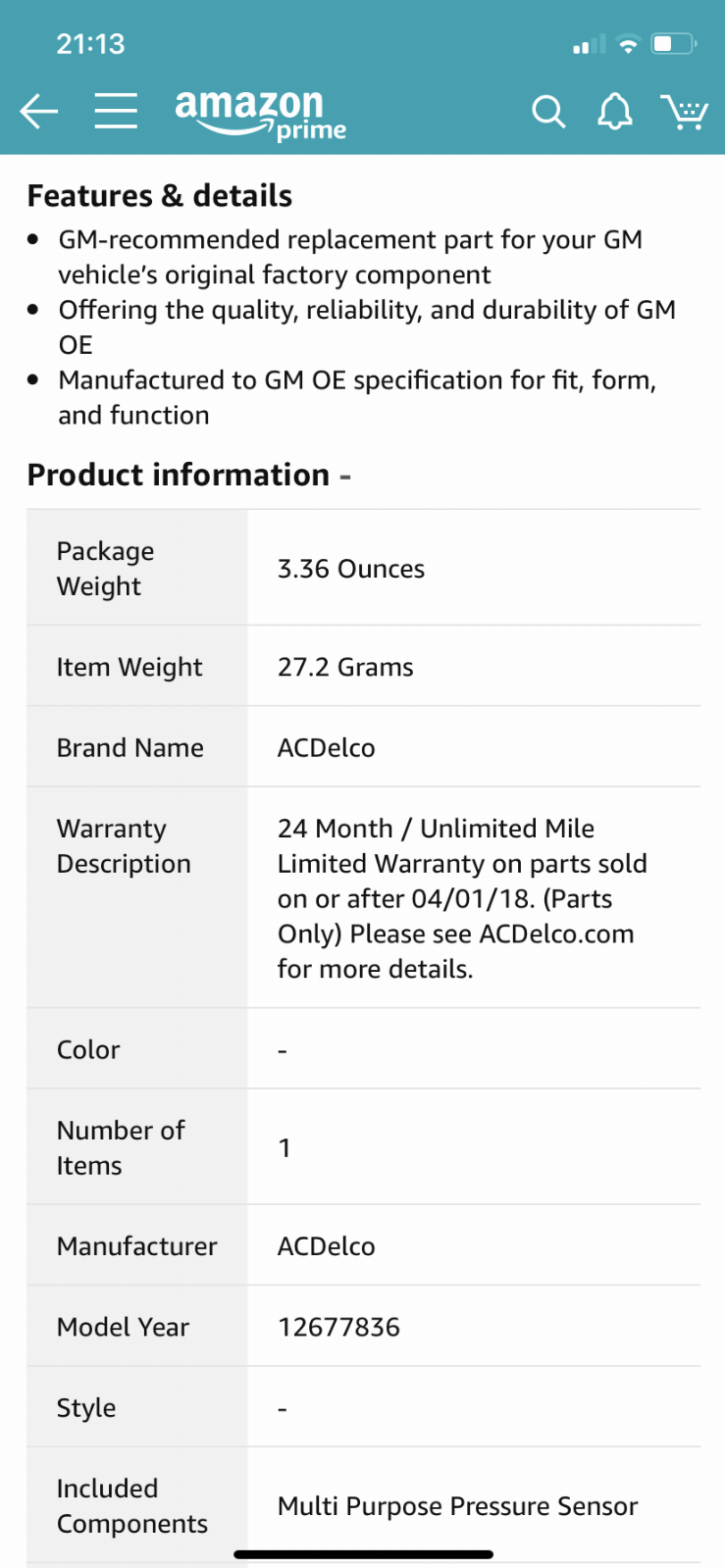

Thanks Fless. Yes, Amazon is where I got the first one. I just want to be sure it’s the real deal. I’ll look at gmpartsdirect as well[emoji106]

Yep, here’s the original one I was installing and managed to break off the plastic top piece. [emoji2957]
