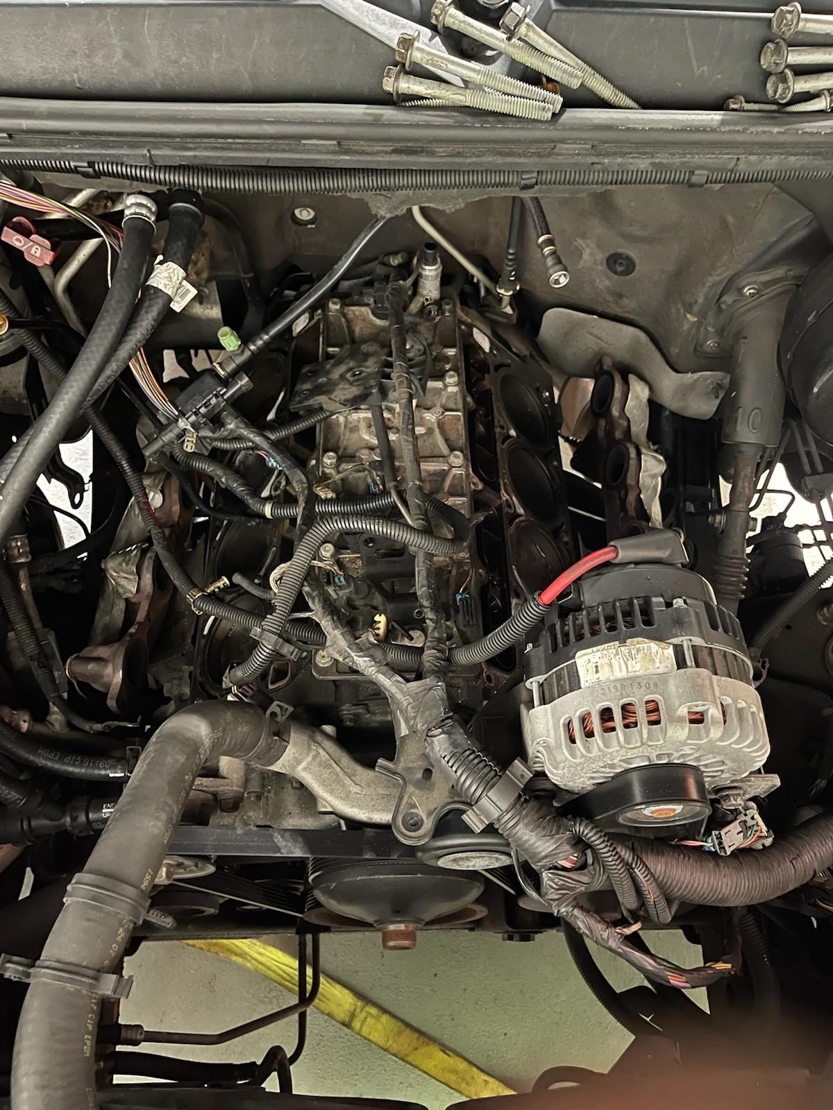

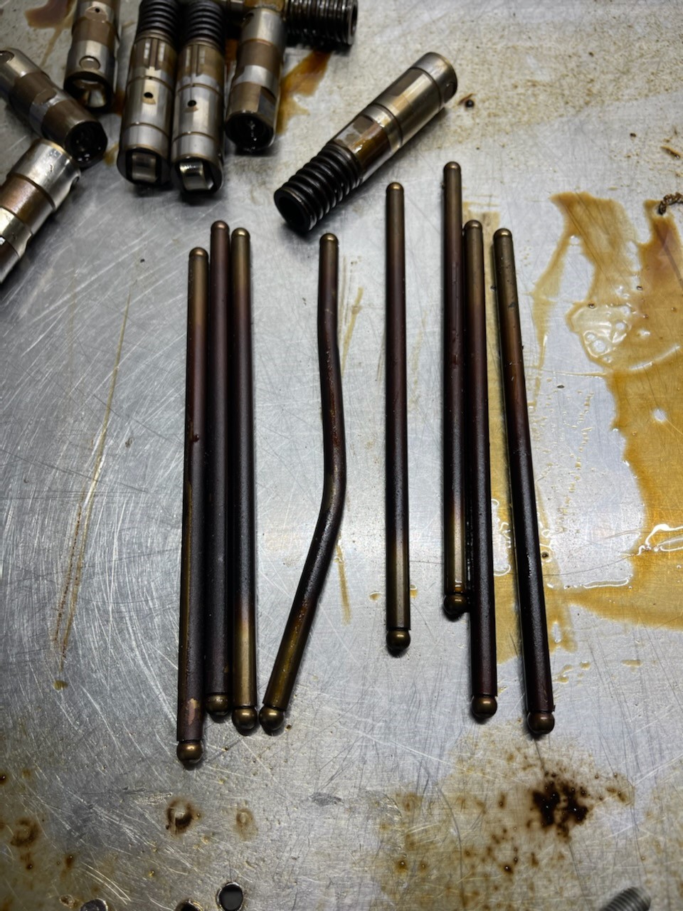

Well received truck back yesterday and its like brand new. He said there was no damage to the lower end, no metal shavings in the oil but does recommend replacing the oil pump. He also recommends changing the oil again in about 500 miles. One push rod was bent to sh@@. He did all new rockers, valves, lifters, plugs wires, head gasket kit exhaust manifold gaskets, new head bolts, new ex manifold bolts and all that was mentioned in thread. He also replaced starter that was giving me problems, replaced my stabilizer link bushings, stabilizer bar bushings, oil and coolant flush and recharged ac. $1,391 parts $1,900 labor. Grand total a wapping $3,291. Truck is for sale! LMAO! Thank you fellas for the guidance!!!!
Thanks for following up and I'm glad it's back in your hands and on the road. Did he replace the VLOM?

That pushrod looks like one I bent on a 3-2 miss-shift in my first LS1...back in 1998..lol. Those things were notorious for doing that with novice manual transmission drivers when under high rev conditions. Well, allowing the novice to do that.
FasterBass
Apr 3, 2022
110
159
Direct experience here. I totaled my dad’s 1979 BMW 528i with a LS1/t56 combo. Thought i was hot shit getting on the highway and moneyshifted straight into a guardrail. To be fair, that was already a hairy car but I was wayyy too confident.
