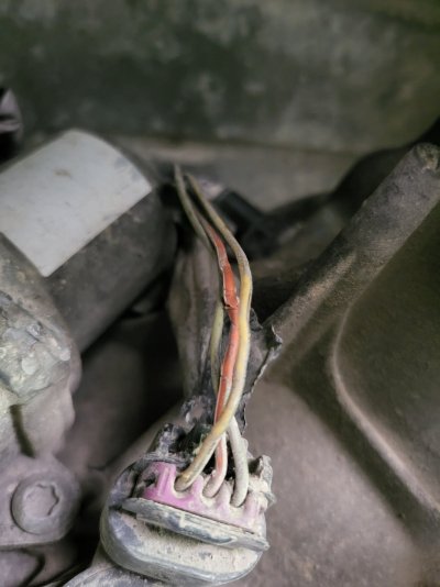

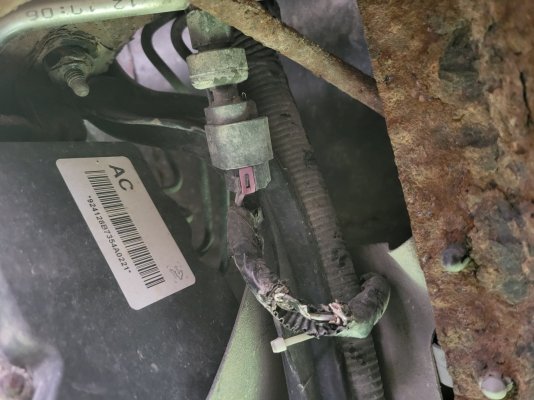

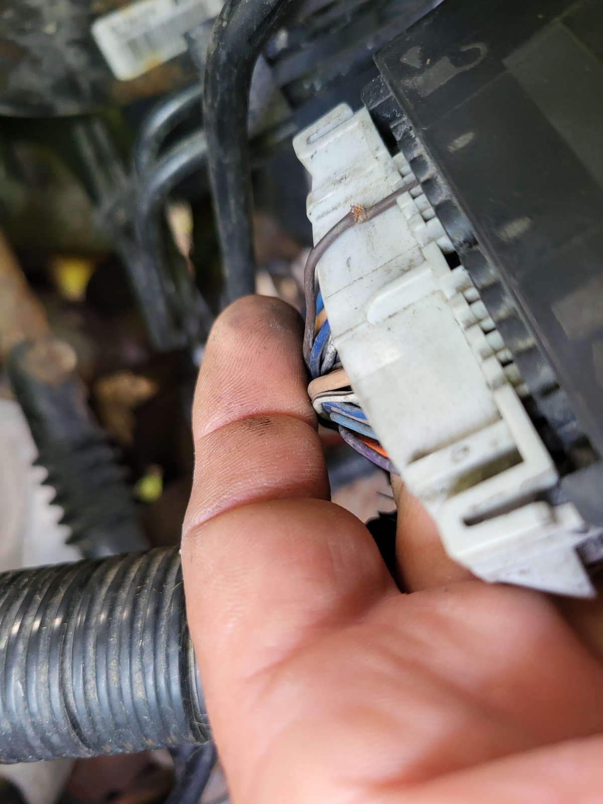

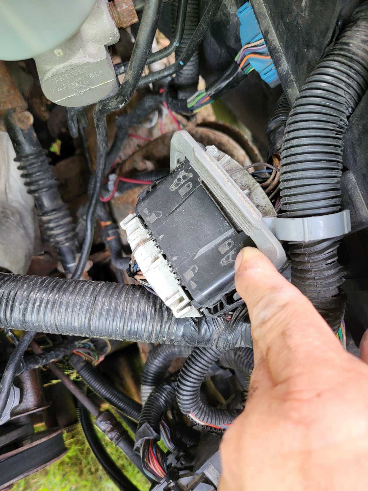

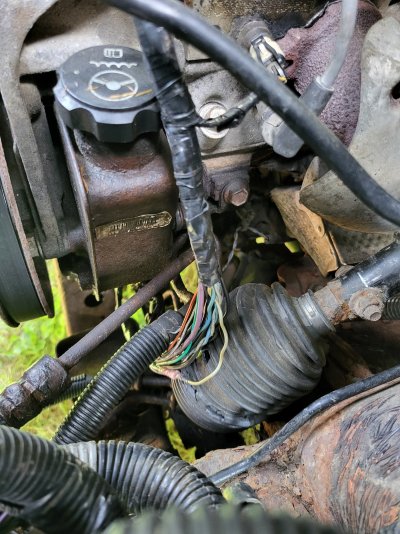

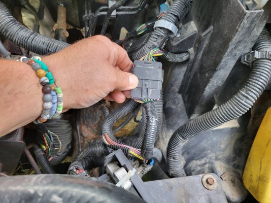

Pics as promised
mikez71
Mar 9, 2023
3,183
3,934
That first picture, on my truck those wires are between the two power steering lines.
It looks like yours could be rubbing on the steering boot.
Good luck with the rodent issue!
