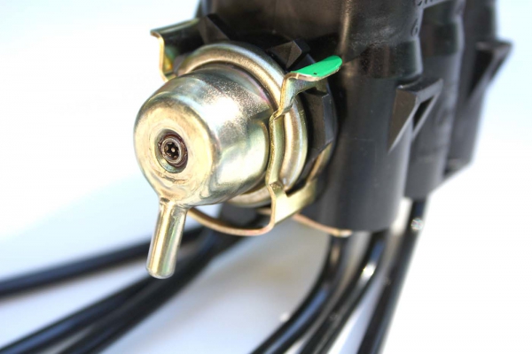

I've been digging around online and saw that some 04+ 2500HD's came with a FPR similar to ours, but had a little T10H torx screw on the body of the regulator to adjust fuel pressure. I've been wondering if I could just source one of those and mess with my fuel pressure to see if that alleviates my symptoms???
Here's a pic of what I'm talking about...
