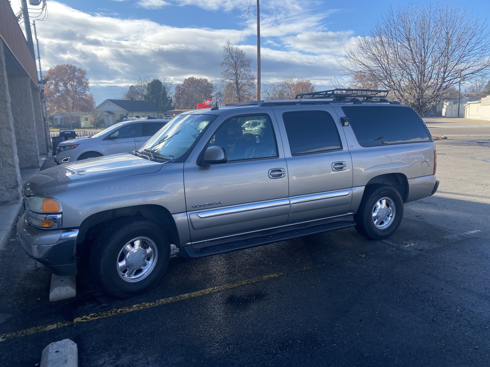

Welcome to the Forum from NH.
Pics of the truck, please.

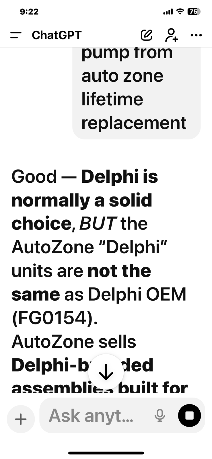

I will do that I have done so many things disconnecting the negative on the battery that maybe computer hasn’t setteled. How can you diagnose low fuel pressure pressure by the trims?

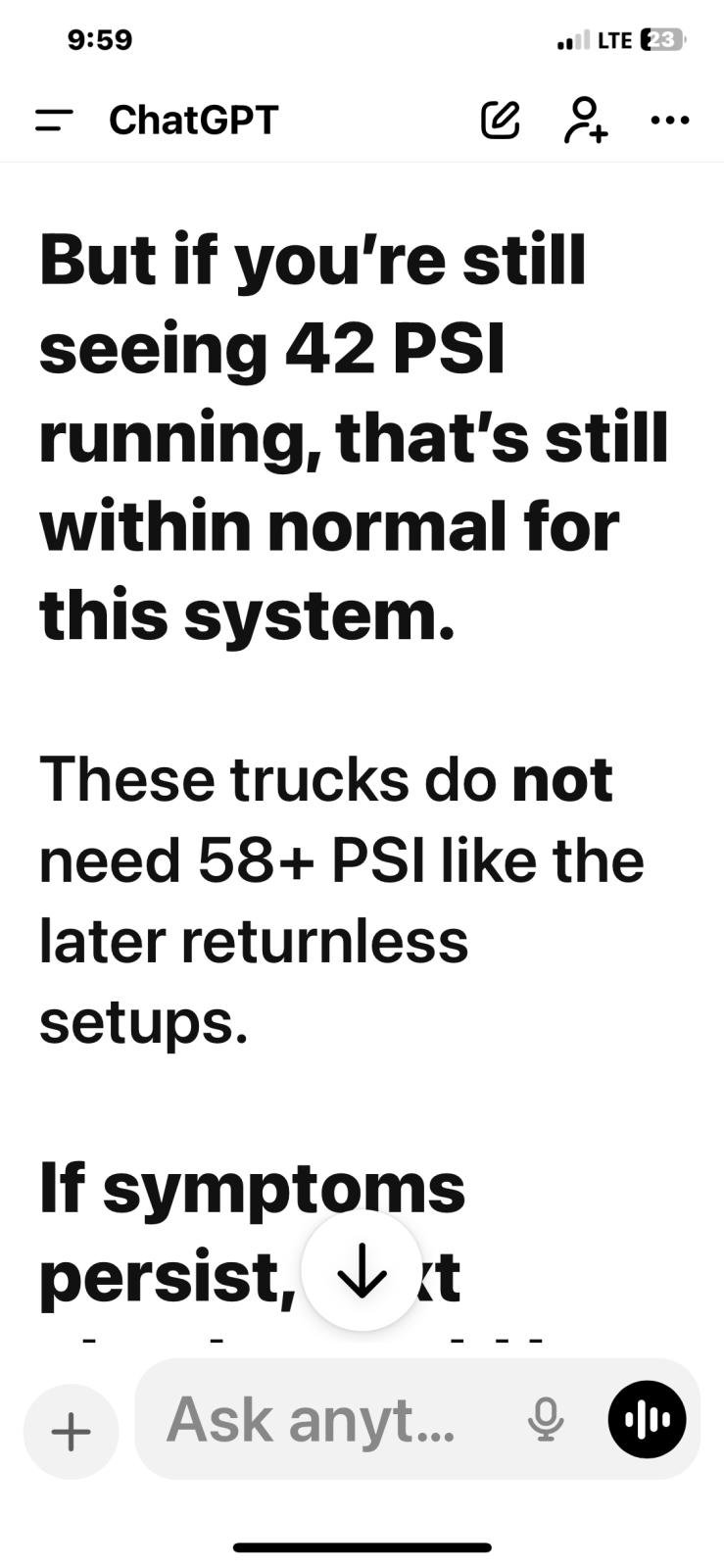

I completed 1,000 miles of my planned 2,000 mile trip from Idaho to San Diego. Lots of long grades to 6600 feet. Yukon and trailer were pretty loaded. She ran great the whole way. Dash fuel mileage average read 12 mpg in tow haul mode. I found some Ai information just today that my fuel pressure can be average for Yukons this year. I will try to attach a screenshot of Ai quote. Thanks!
