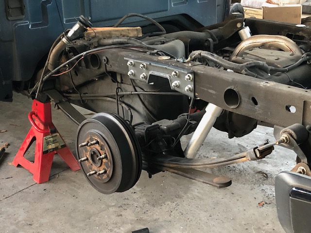

Finally getting some stuff done. Found a friend of a friend who can work on trucks. Had him do my C notch last night. He can install my rear 4 link, watts link and bags. Hoping he can do that within a week or two.

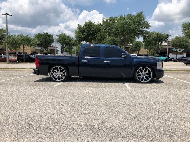

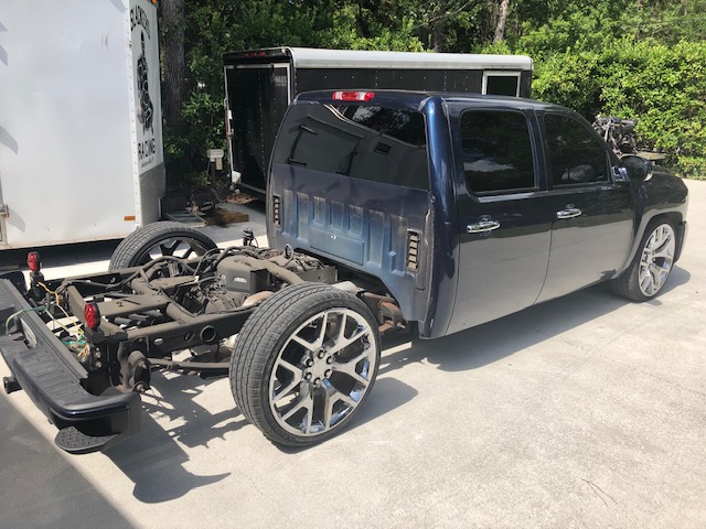

Newest pic... figured I'd share. Front inner fenders rest on the tires when laid out, so I'll need to cut them up to go any lower. only sits about 1.5" lower aired out in the front than when it was static lowered.
I drop it off next week to install the KP 4 link, watts kit, and cantilever system

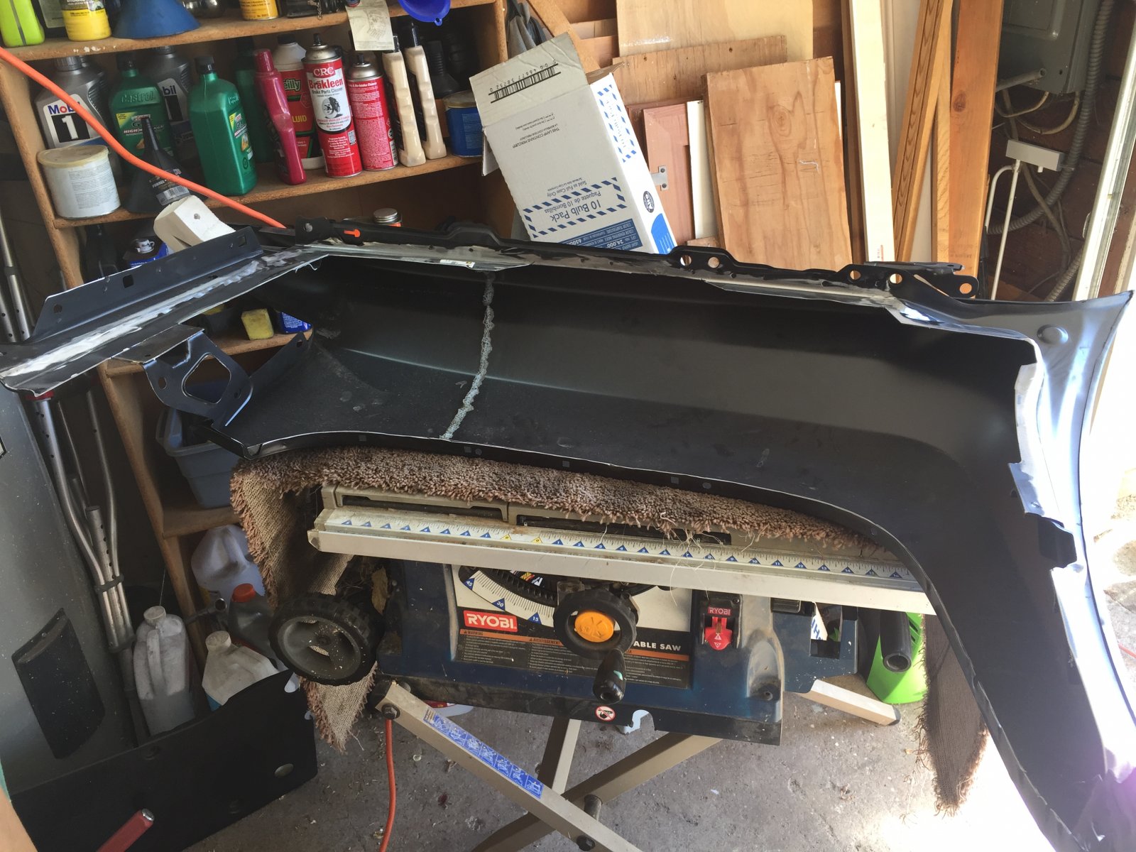

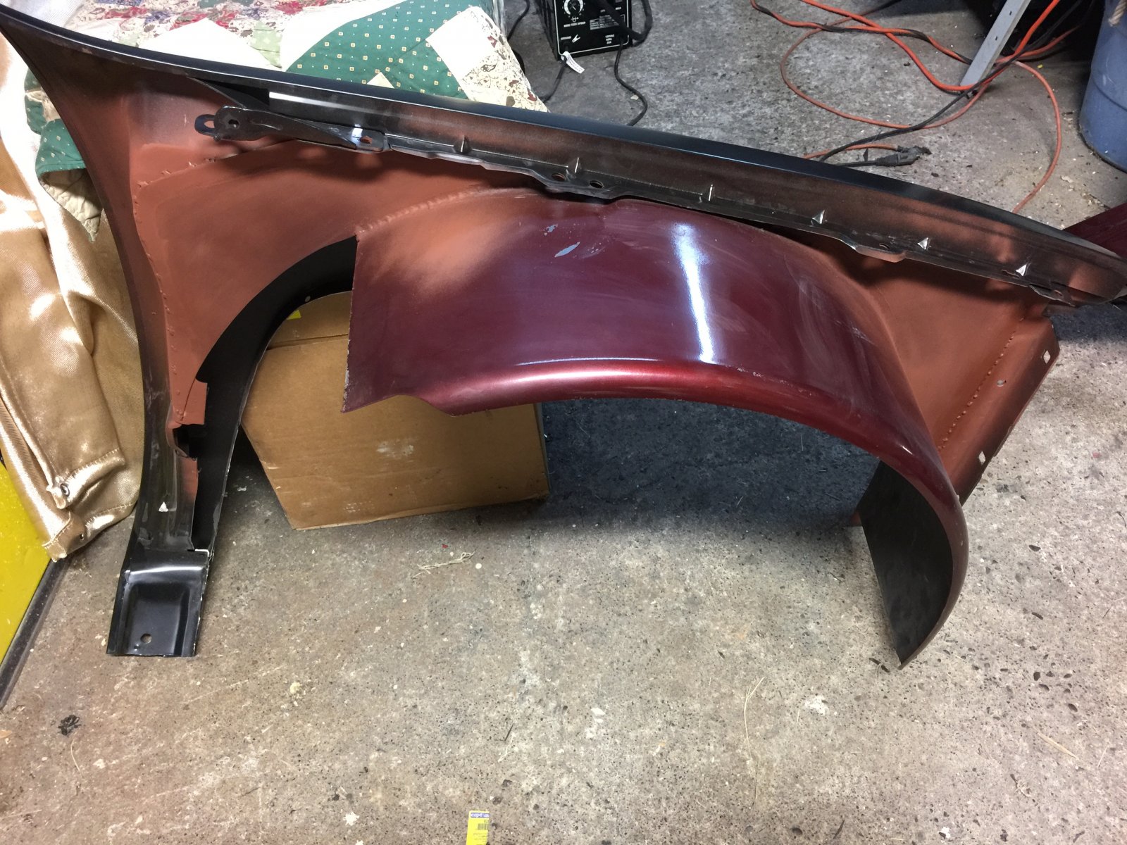

It’s not all that easy to install those. I replaced my fenders that were already tubbed and you have to cut out all the inner structure and then weld flat panels to the outside of those and then weld it all to your fenders. And be prepared, your fenders have now lost most of their strength due to the structure being removed so you gotta be careful. There’s pics in my Silvy build thread.
52,954

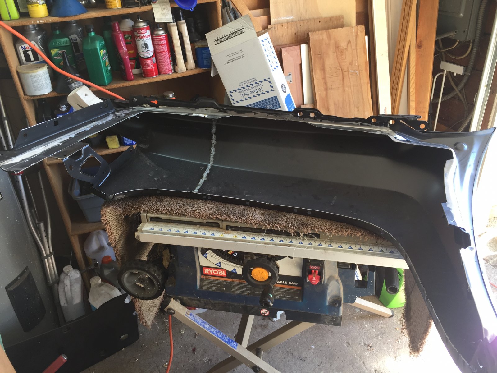

Here's a before and after of the new fender when I prepped it for the tub, structure removal.

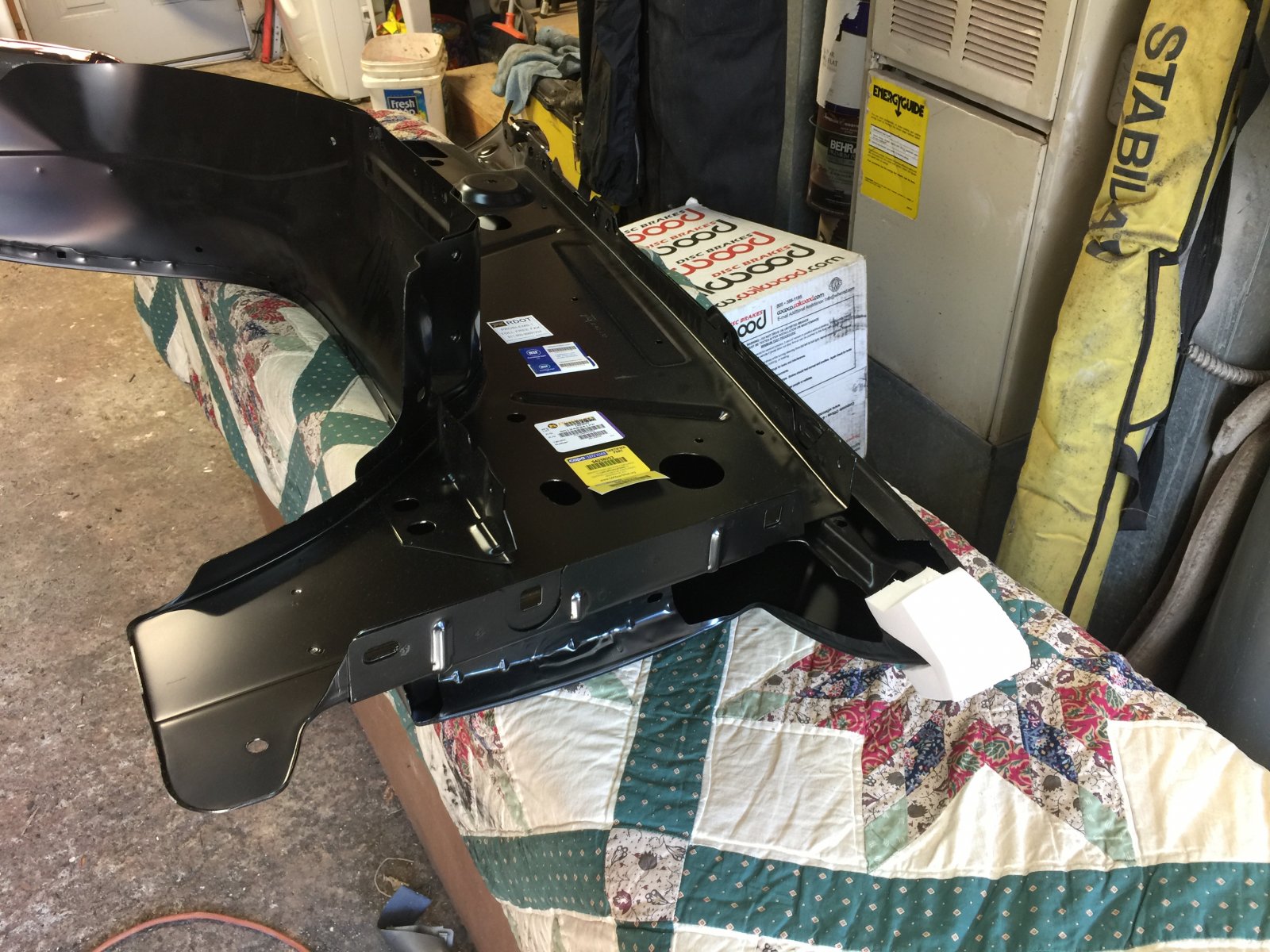

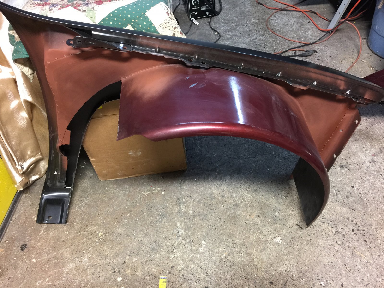

And after tub install.
Looks good, man :) 4 link and all that will be an awesome upgrade :)

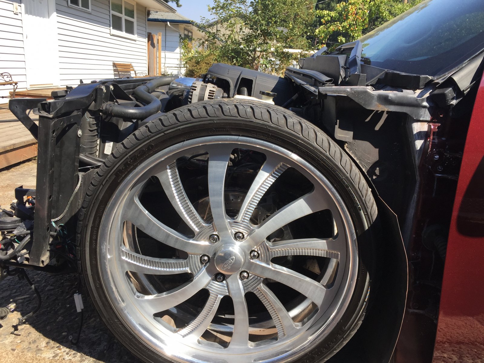

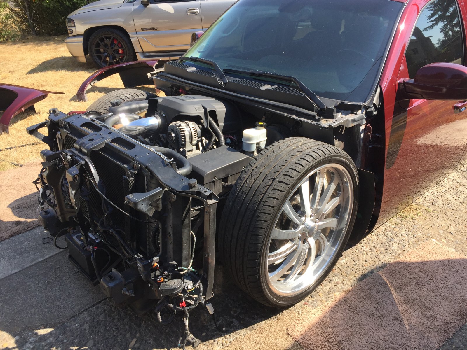

Mine are tubbed for 28’s so they come all the way up to the hood. You'll need different hinges without springs and have to use a prop rod, relocate your fuse box and overflow container, eliminate your washer fluid container because there's no place for it, tub your firewall and relocate your heater fan housing. Is that what you want? I'm thinking it might be a bit extreme for what you're trying to do....
edit: forgot about the battery. There will be no place for it either up there lmao.
