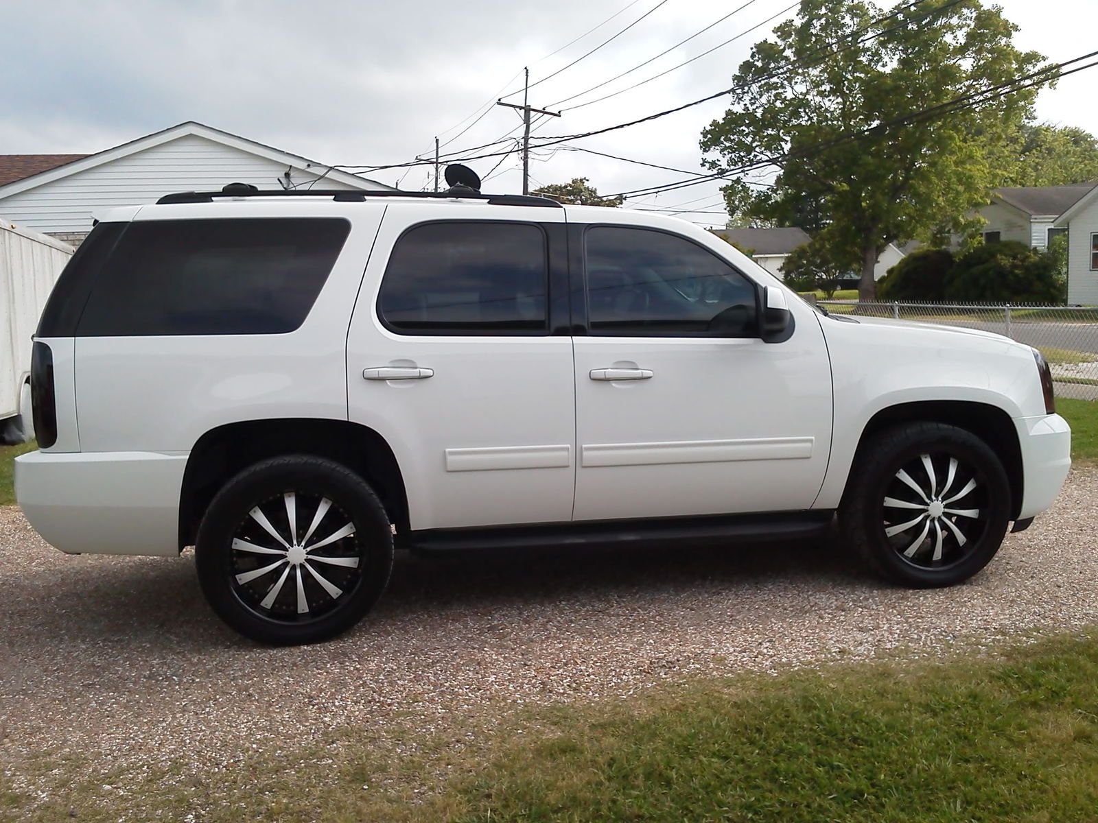

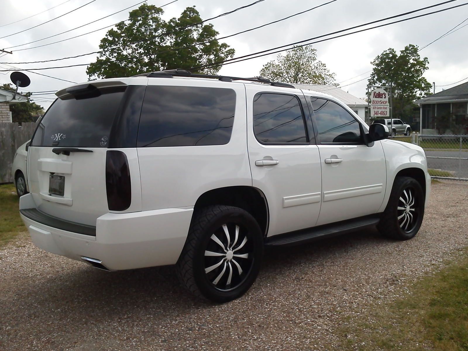

My Premium dual exhaust bumper install with the spare tire

Awesome job! The dual exhaust mod is one of my faves on the NNBS.......and especially since you kept the spare tire functional.

I think it came out the best I have seen so far. Nice work. I know u said you want to wrap the door pillars. I really think if you paint your appliqués your tail light paint will pop. I have seen the pillars painted black on a white truck and for whatever reason it reminds me of a limmo.
Sweet ride. Look forward to seeing more.

Thats an Esky Platinum bumper right?
^this. only way i'd do it too. Job well done OP!

Thank y'all
I ordered the vinyl for the door post! I'll post some pics once I wrap them

really great work, excited to see it with the b-pillars wrapped, and the esky rack up top too. tail lights looks awesome also

thanks I try
should be getting the vinyl by the end of the week so ill post some pics when completed

I really think GM didn't run the spare tire with this bumper is because the escalade with a 6.2L would have been too loud without the rear resonator
there isn't enough room for a resonator and the spare

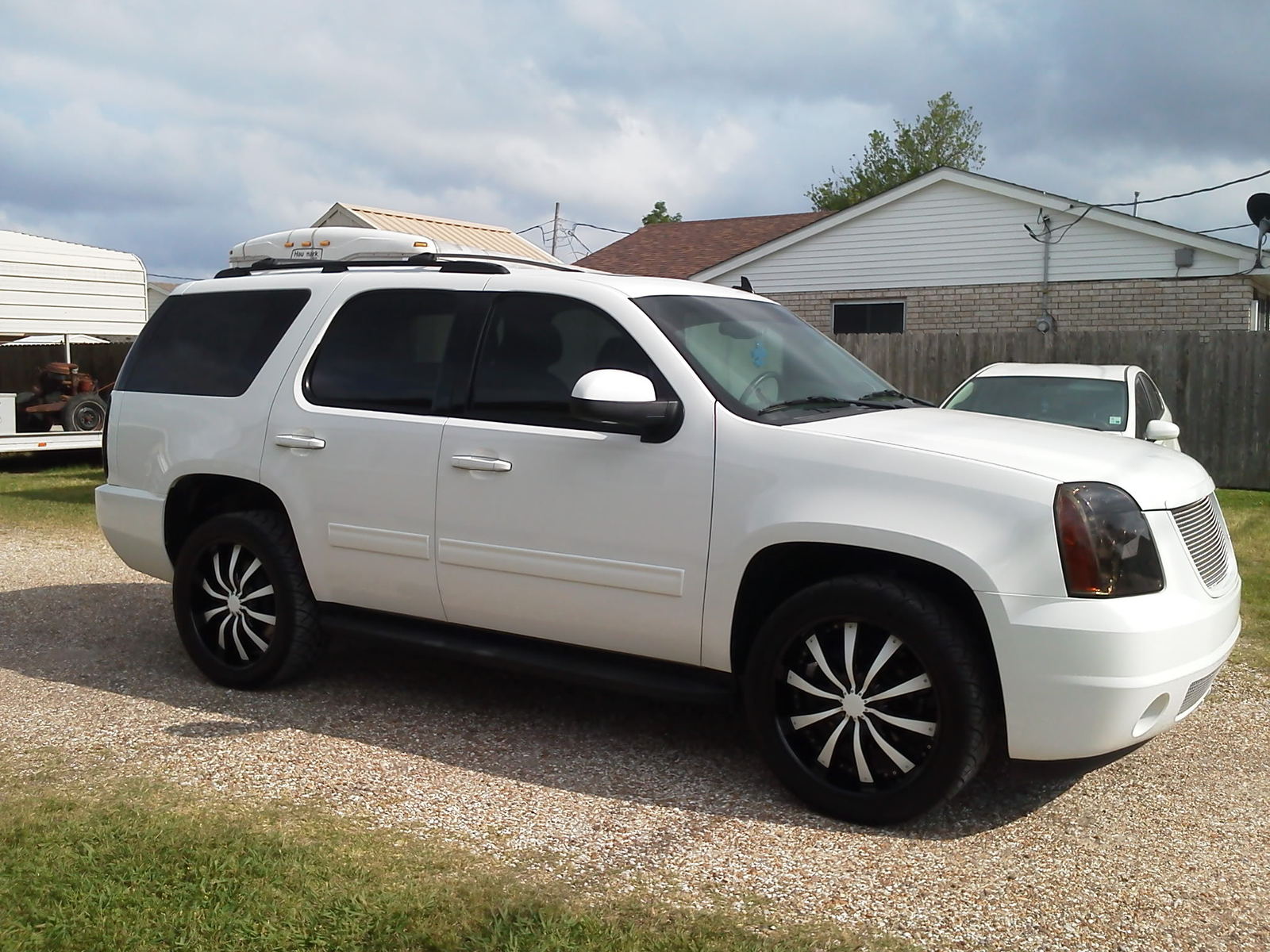

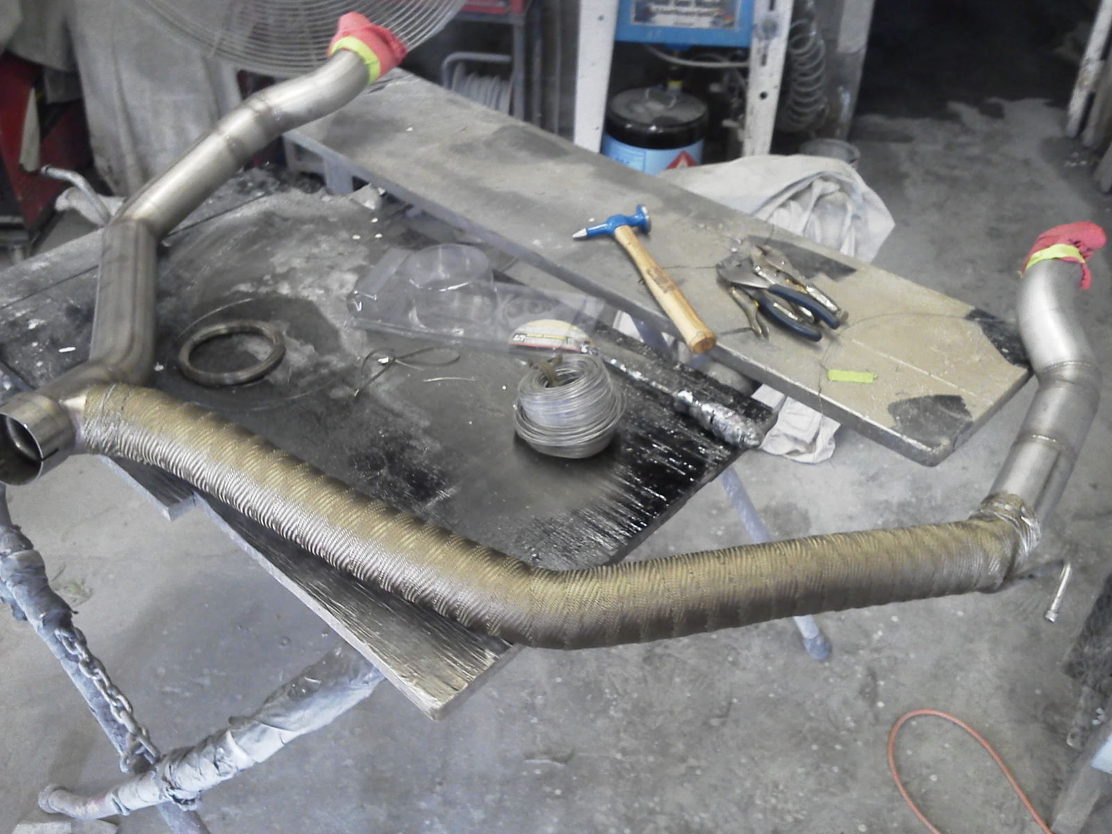

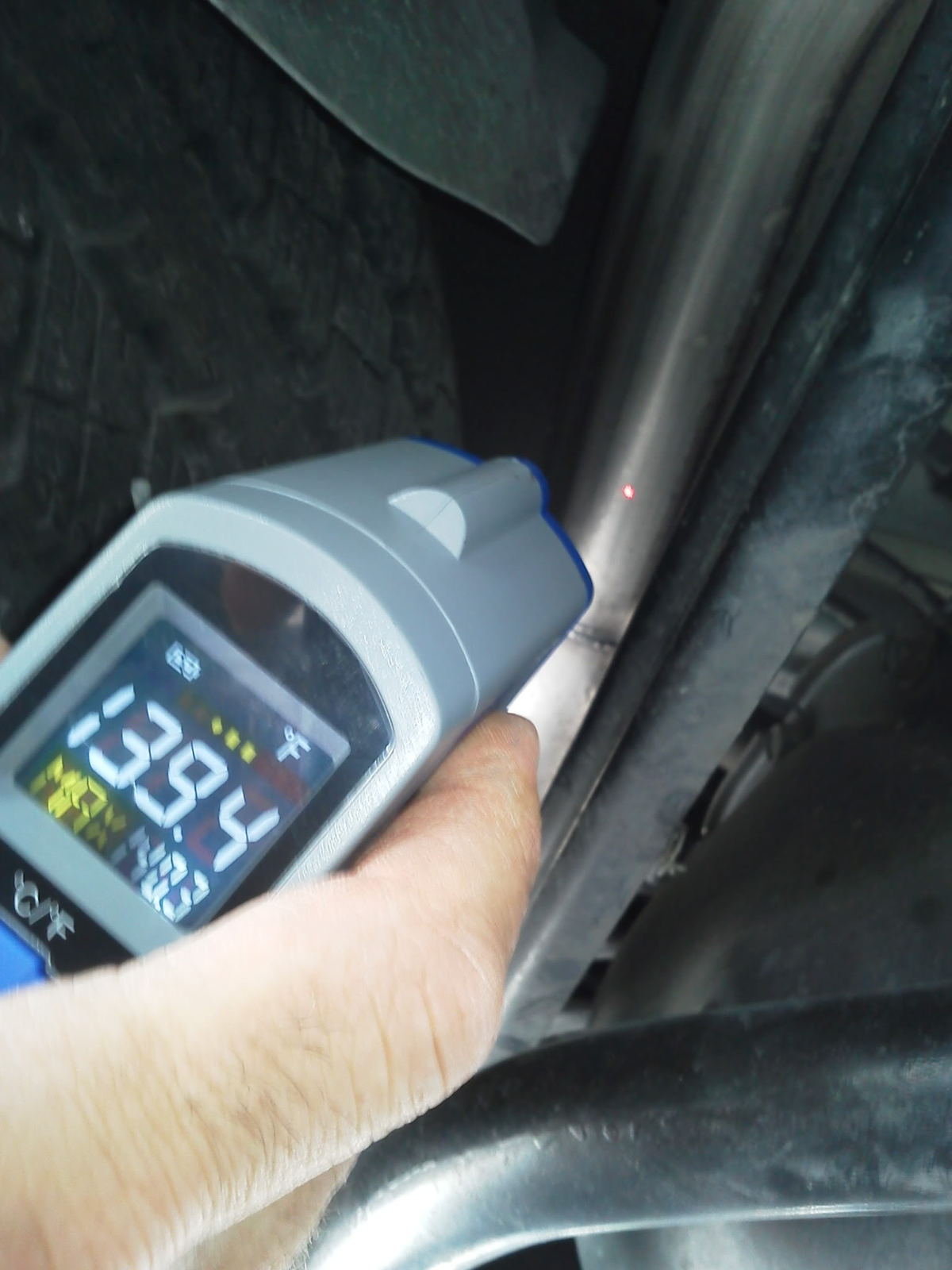

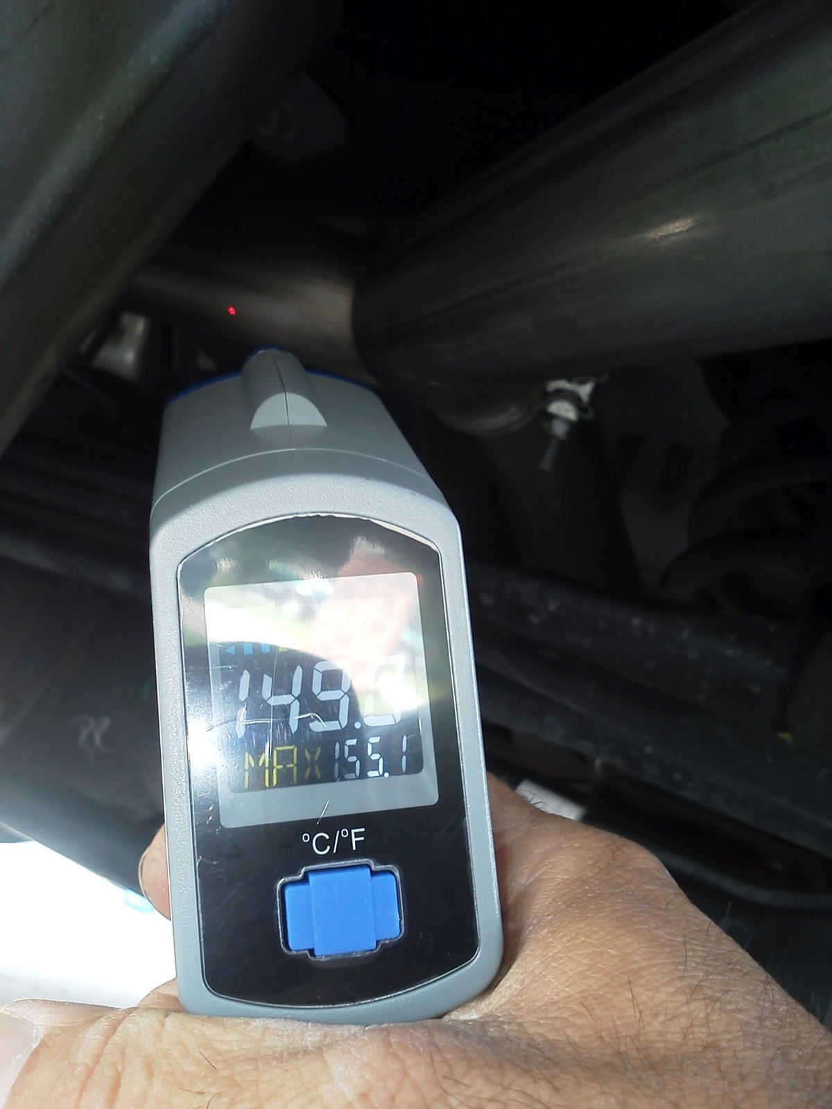

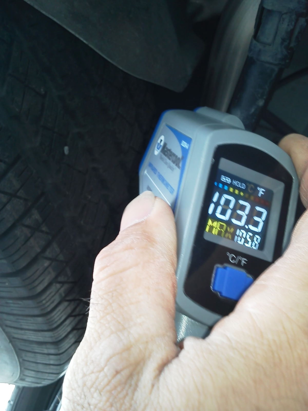

After drive it around some and checking the temps i decided just wrapping the crossover pipe with header/exhaust wrap should be good

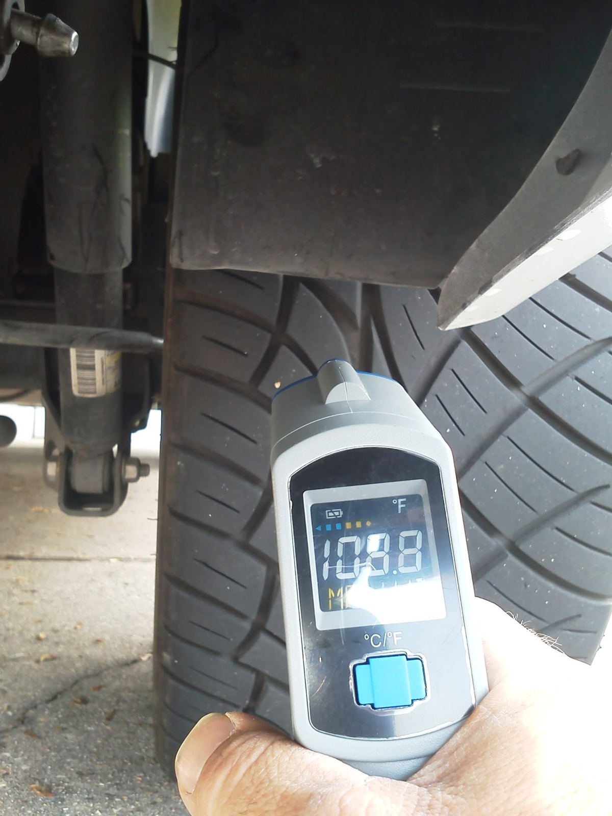

I checked the temp of the tires just from driving
Temp at the Y
Crossover pipe temp

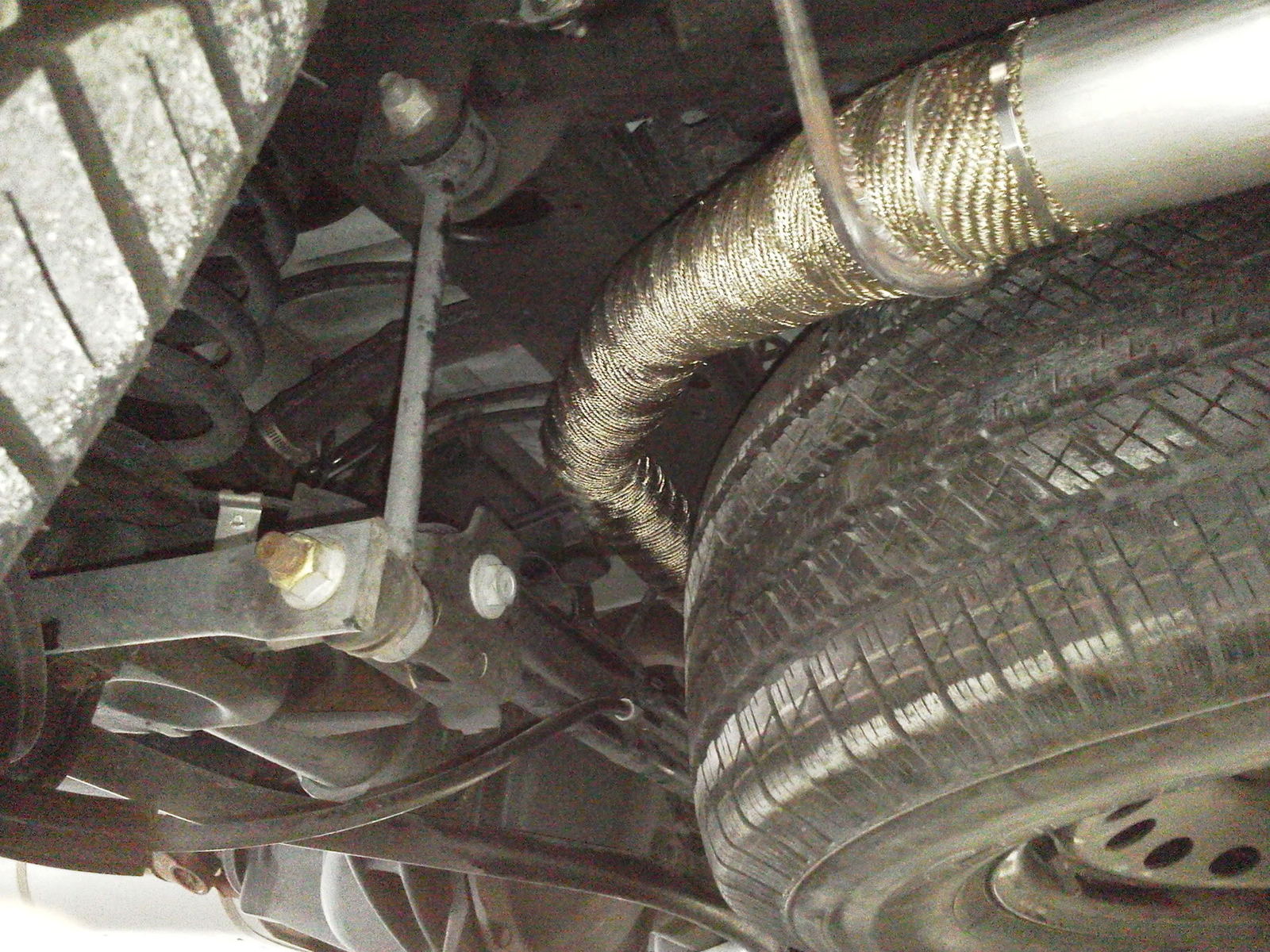

Temp on the spare by the crossover pipe

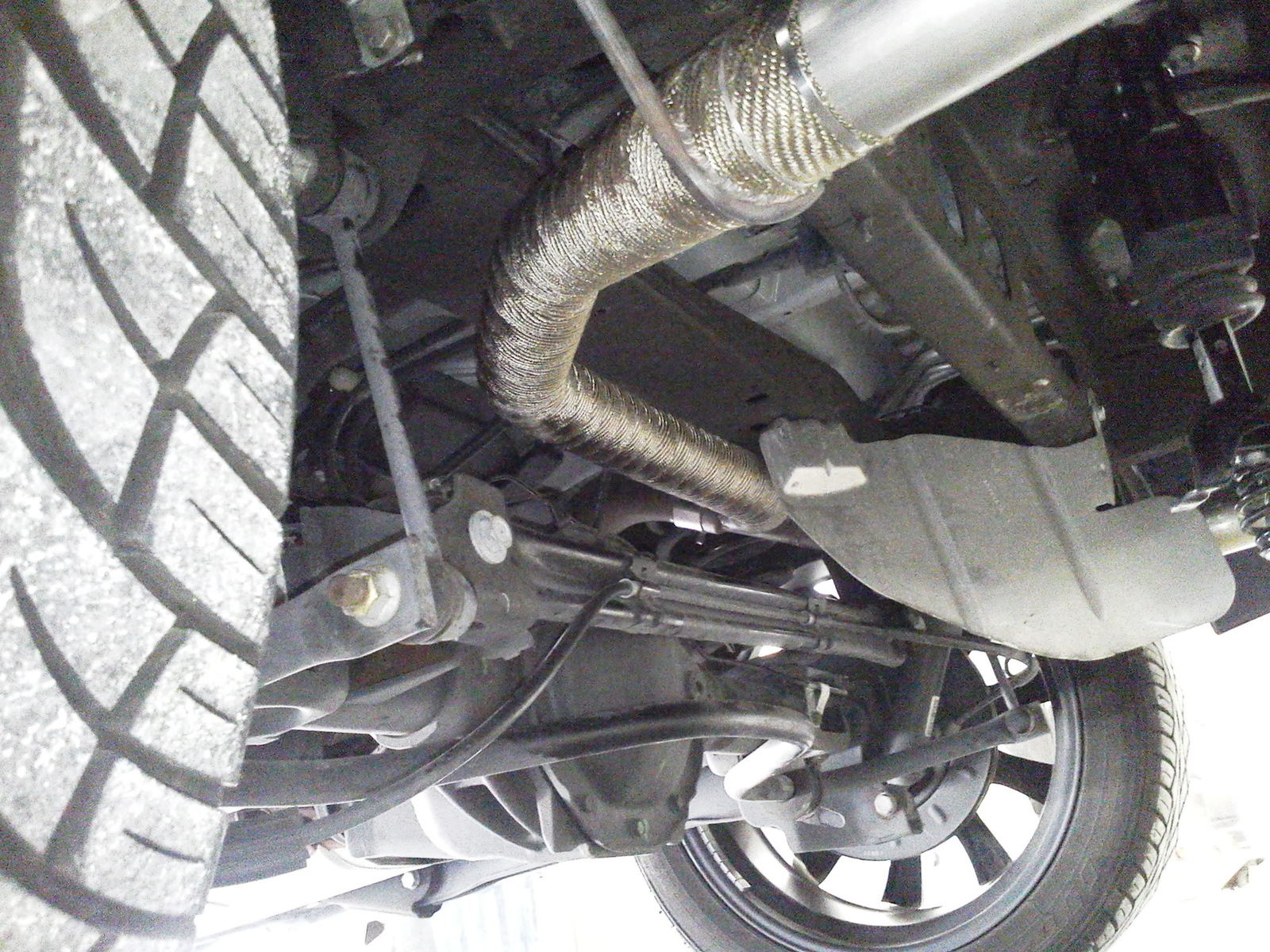

After installing the wrap on the crossover section

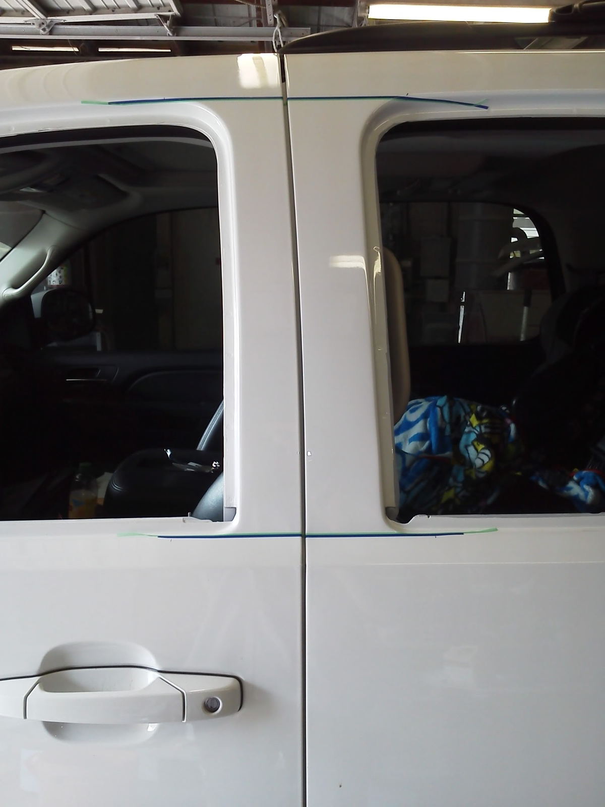

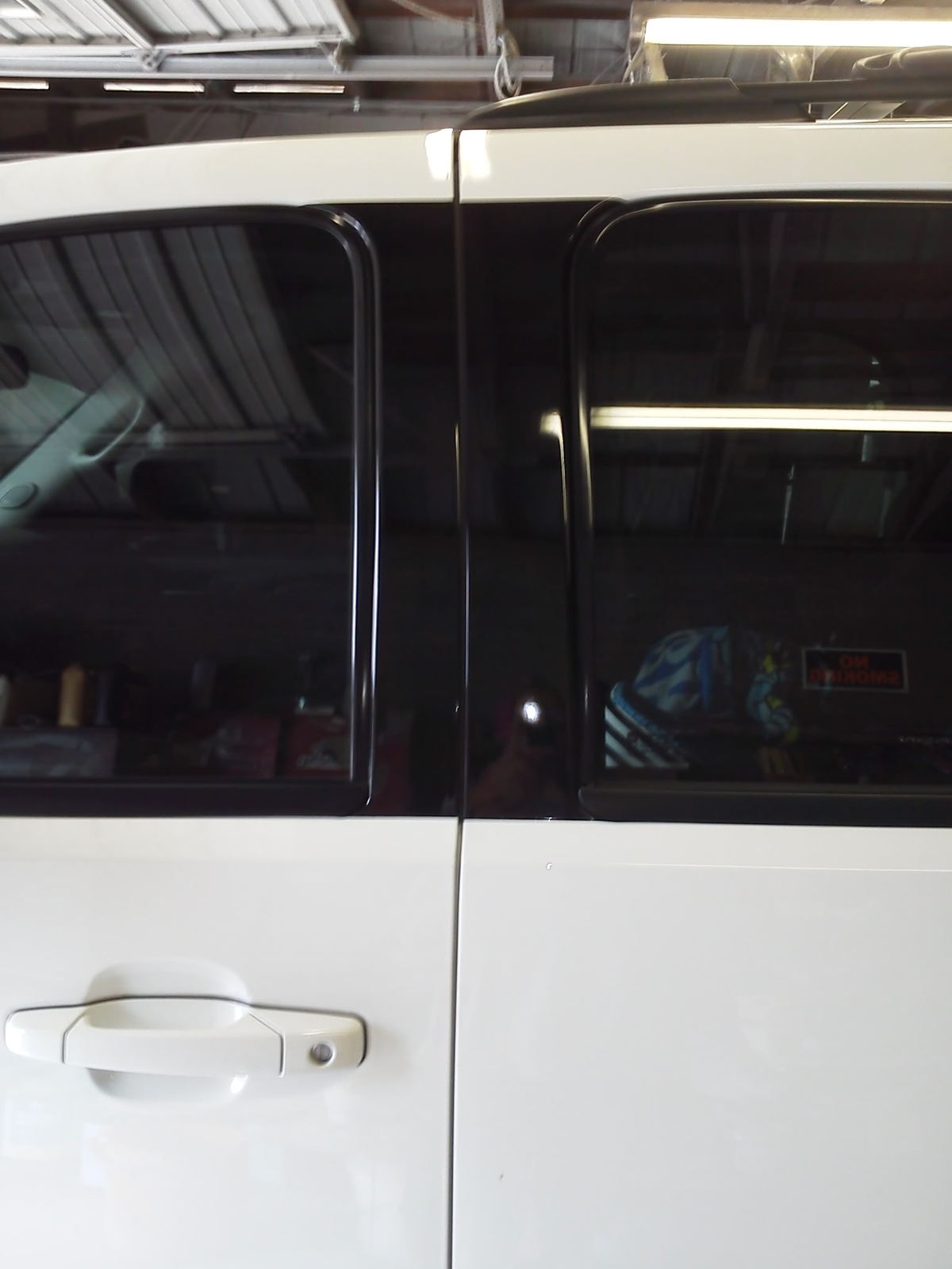

Got my vinyl and knifeless tape in for the door post
It was a little tricky getting it lined up with the window runs at the top because they are not square they have a radius

very nice info man!! Love the temp readouts :)

Great info thanks. Are you going to wrap the back pillars as well?
Did Gibson sell a specific kit or did you marry up a bunch of different pipe?

I built my own tailpipes with various bends
But Gibson does have a dual exhaust specifically for the tahoe and maybe just the ends can be modified so it could work with the premuim bumper tips
And no I'm not going to wrap the back
---------- Post added at 09:25 PM ---------- Previous post was at 09:06 PM ----------
Woah where you get the door pillar tape
Post a link please
I ordered a 1'x5' piece of vehicle wrap
It was not specifically for the door post
But I got it from Ikonwraps
