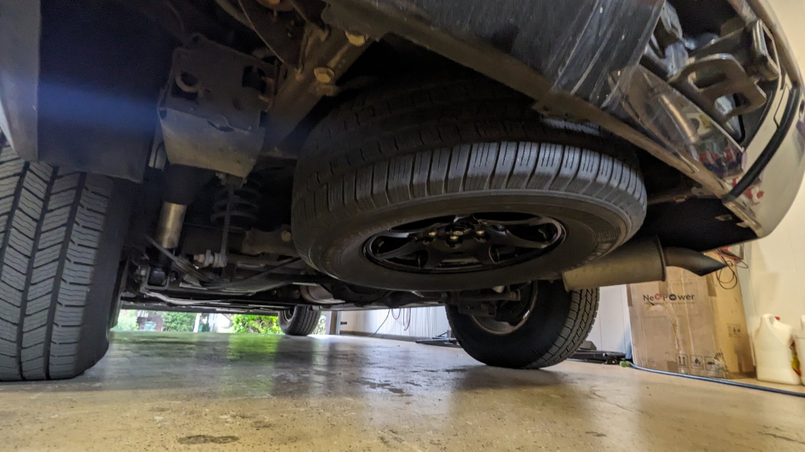

so I there's not a lot of these trucks left, and even less of the spare tire kits. but I wanted to post a few pics, since when I was looking there's almost nothing online about it.

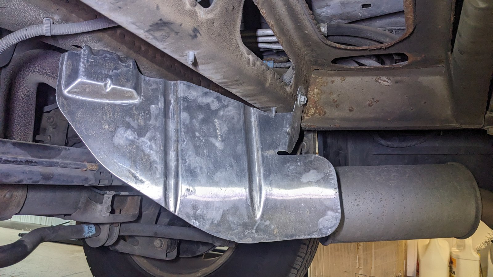

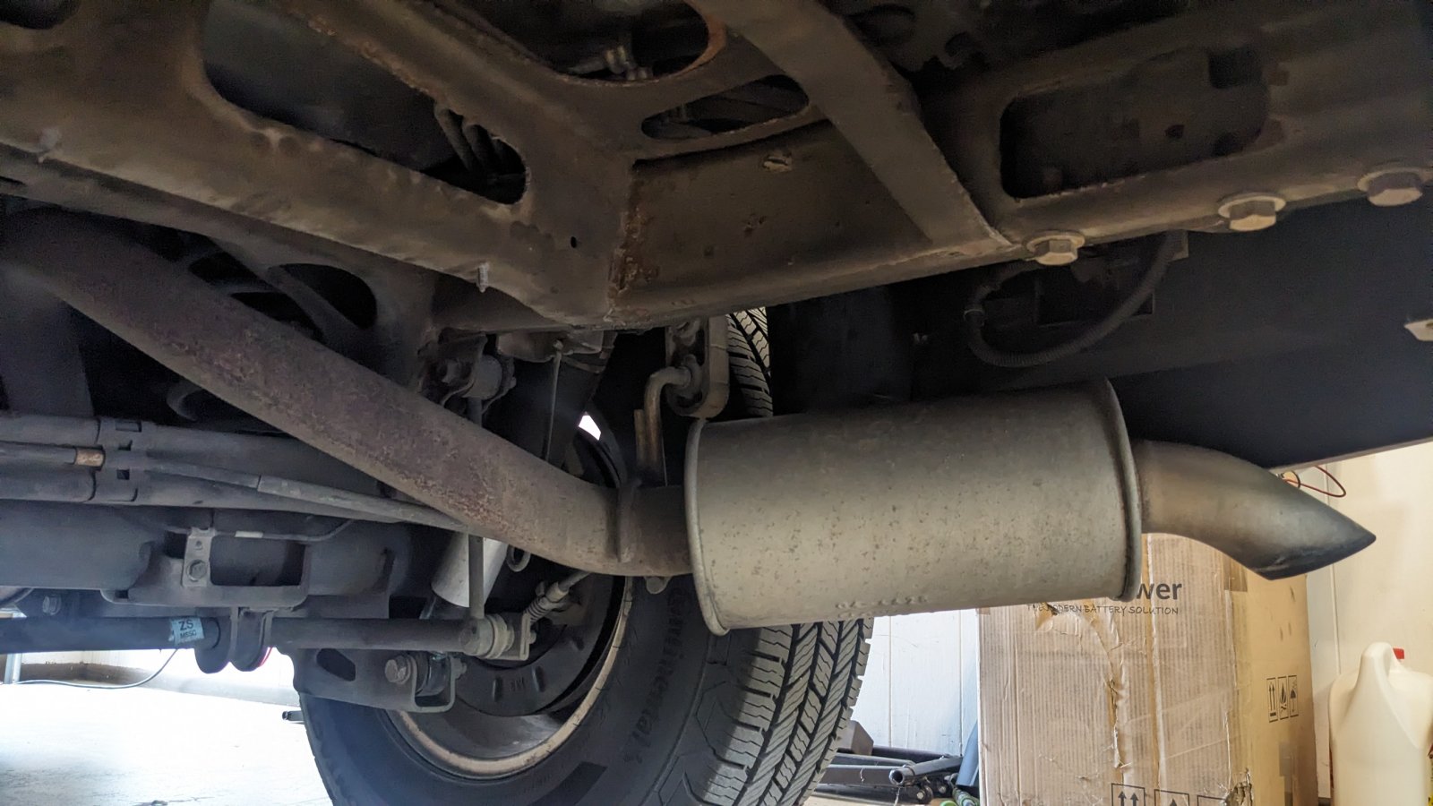

so the hybrids didn't come with a spare, just a inflator with some fix a flat in it. so they sold an add on kit at the dealer. it seems it's designed the older 08 tahoe. in the instructions show they have a cross mount muffler. so the kit comes with a muffler to cut that off and replace it. my 2011 yukon already had a muffler before the axle and resonator after the axle in line, so I didn't need any exhaust mods. I did use the heat shield included. the bolt holes are already in the frame, so that's nice.

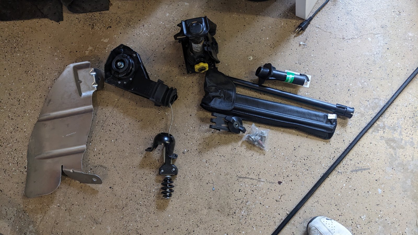

if you have a newer truck, or probably a yukon or caddy, you can easily do this without a kit. Just need the spare rim, the pulley lift part and the long that runs to it. should be easy at a junk yard or ebay. if you have an older one that needs the muffler. I have one, it will be tossed up top of my shed somewhere.
all the part numbers are in the instructions zips.

my style muffler

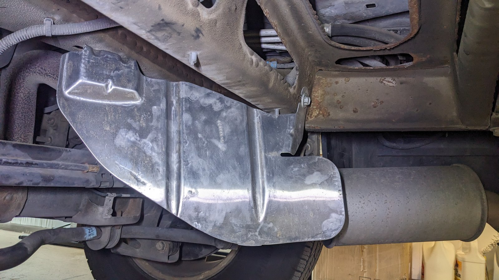

the shield in place
all the small parts of the kit
and up in there.
