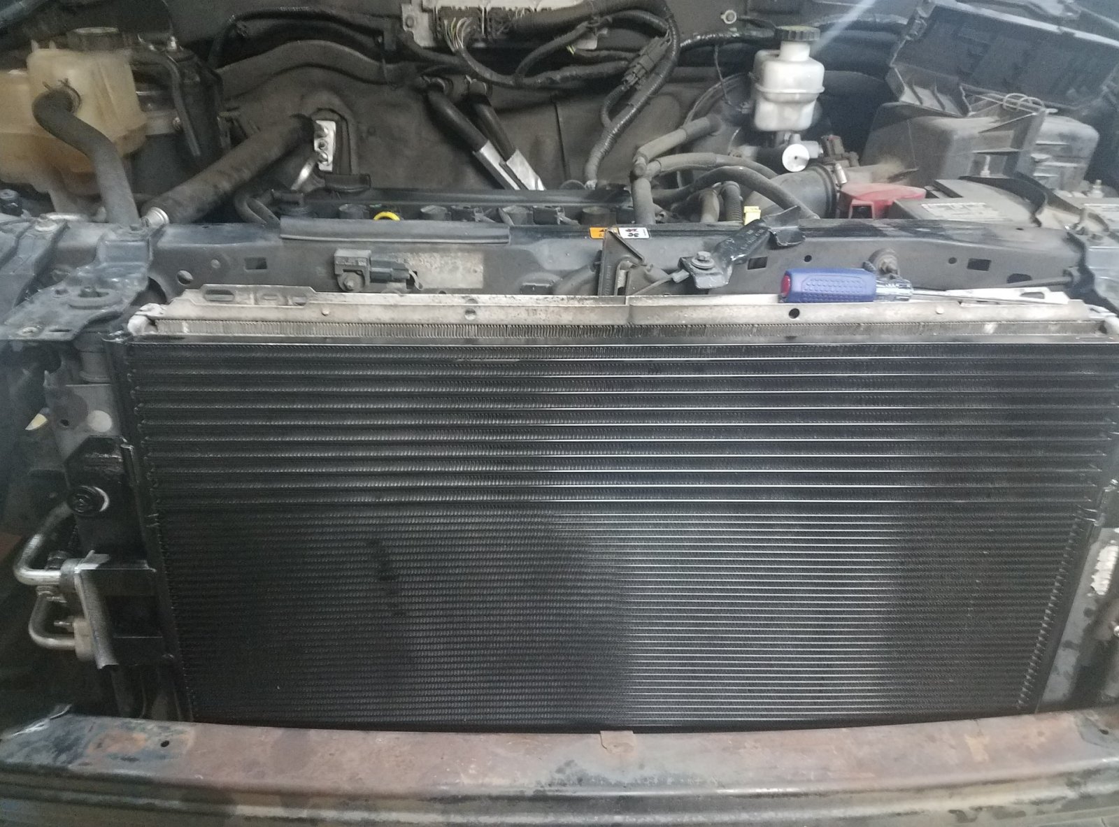

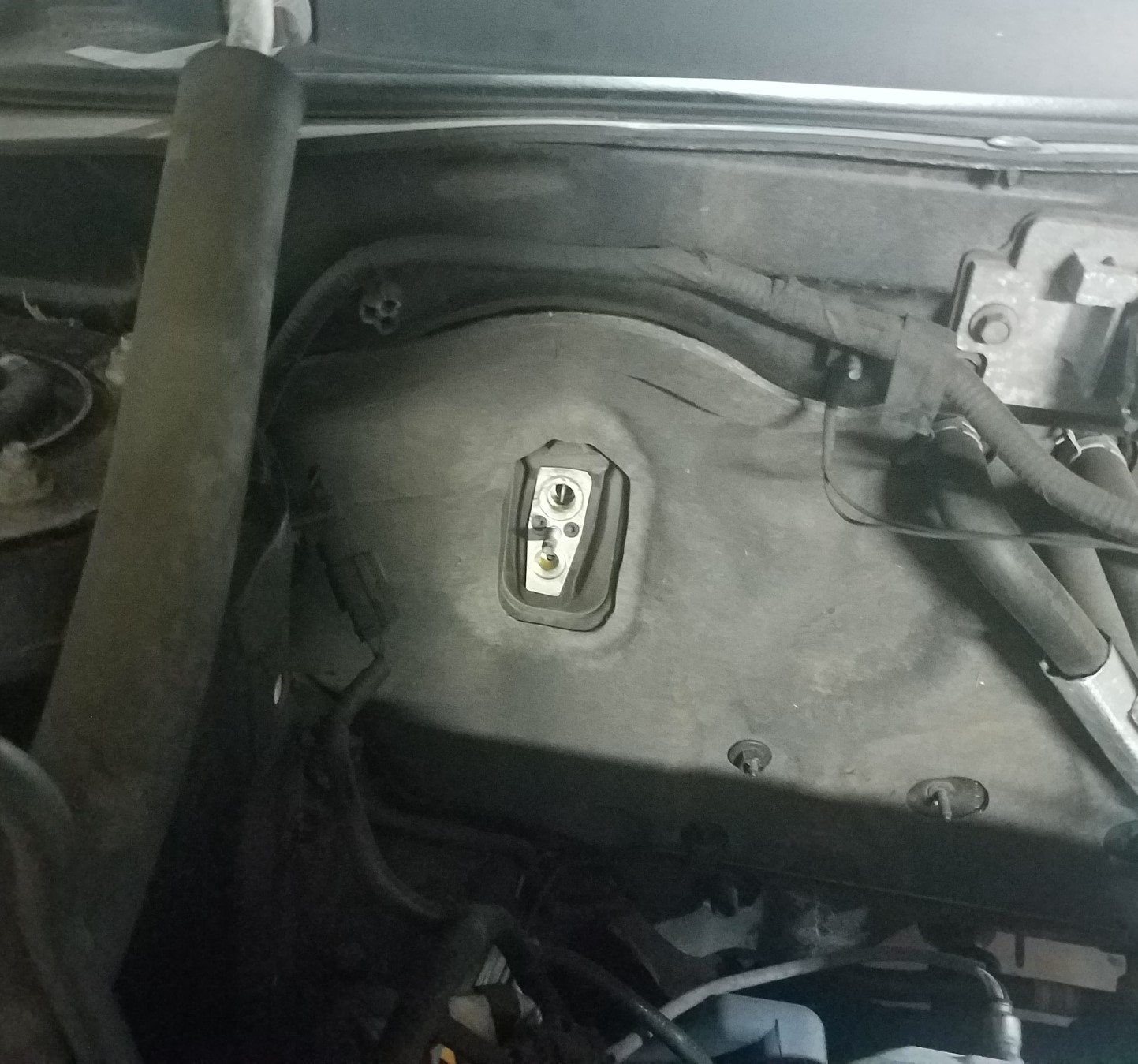

A long day but my daughter has A/C again after almost 3 years - which I found out yesterday that is how long she was without. A bit longer job, that bumper cover was a bit stubborn plus we got a later start. So happy they all stayed over for the night so I was able to spend time with all the grand daughters and of course my daughter and son in law. Not a lot of pictures because it was mostly a training event for my son in law. After getting the bumper cover off, we started by adding some freon and dye. However, there was no pressure so we needed to jumper the ac relay to get the compressor to kick on. As we were adding freon, it didn't take long to find the leak in the condenser. It was leaking so badly that we found it in less than 2 minutes. Continued to run it while adding freon to check out the rest of the system. No other leaks detected and the compressor appears to be sound. Then we dismantled the system - first starting with the removal of the old condenser. then we replaced the expansion valve. Then the accumulator/dryer and finally installing the new condenser.
The old condenser - this thing was in bad shape, especially near the bottom.

The new expansion valve in place.

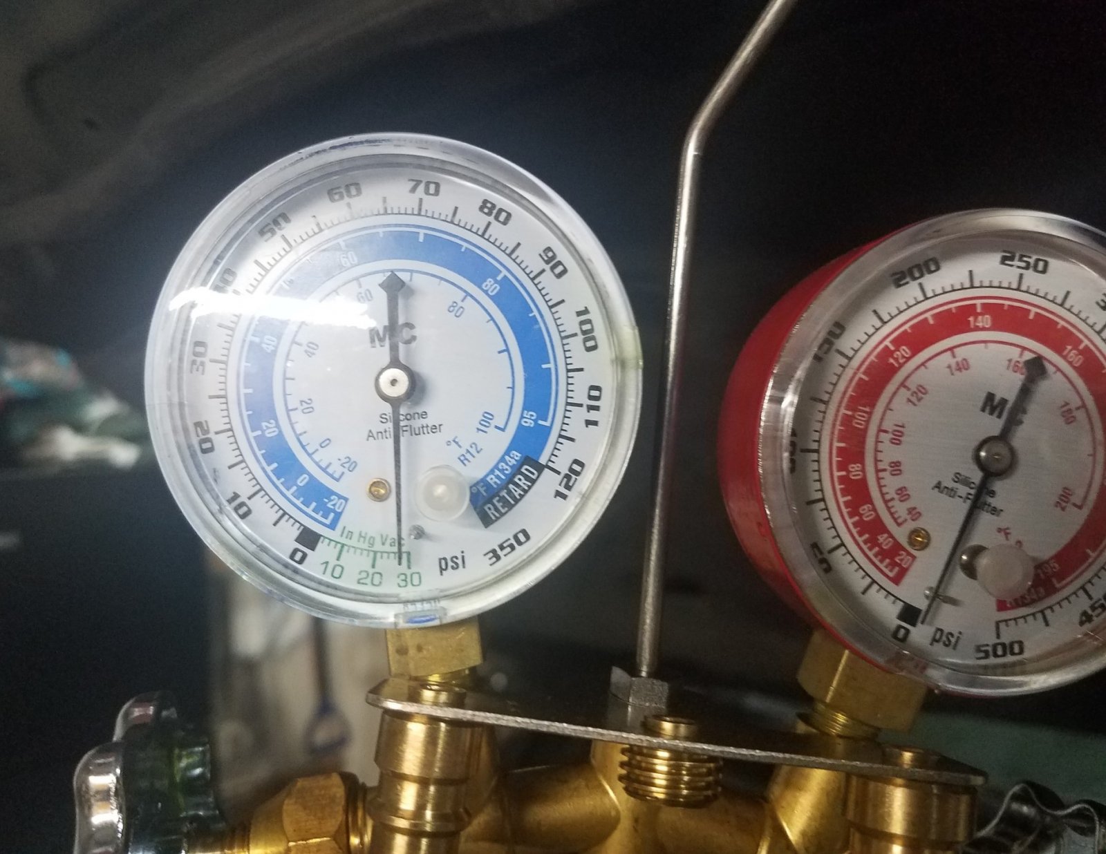

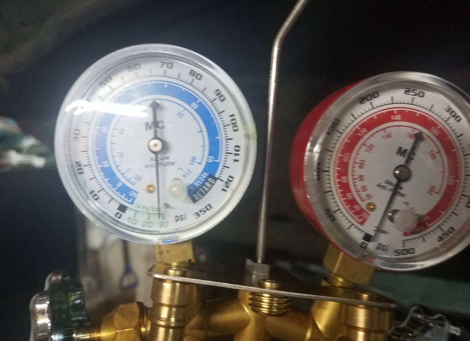

After sealing everything up with new gaskets and o-rings we pulled a hard vacuum. Let it run for 45 minutes while we ate lunch. During lunch we talked about the theory of the a/c system and what we were doing from a step by step process. Prior to lunch:
After lunch we closed off the valves and shutoff/disconnected the vacuum pump. After 60 minutes there was no change to the vacuum pressure:
Prior to adding freon we disconnected the negative battery terminal for about 3 minutes (I wanted to ensure that everything was reset and the compressor would kick on as required). Then we hooked up a can of freon. Purged the lines and then added the can to the system, the engine was not running at this point. The vacuum pulled the freon in, once that stabilized we started the engine (max cool, max fan), the compressor kicked on and we added the required 1.56 lbs of freon while watching our low/high pressures. My son in law was so pleased to be part of this effort and I could tell he learned a lot through this process. My daughter was so happy and my grand daughters gave me big hugs and kisses. Today was 89 with a real feel of 98. It would have been miserable driving home. Not anymore.

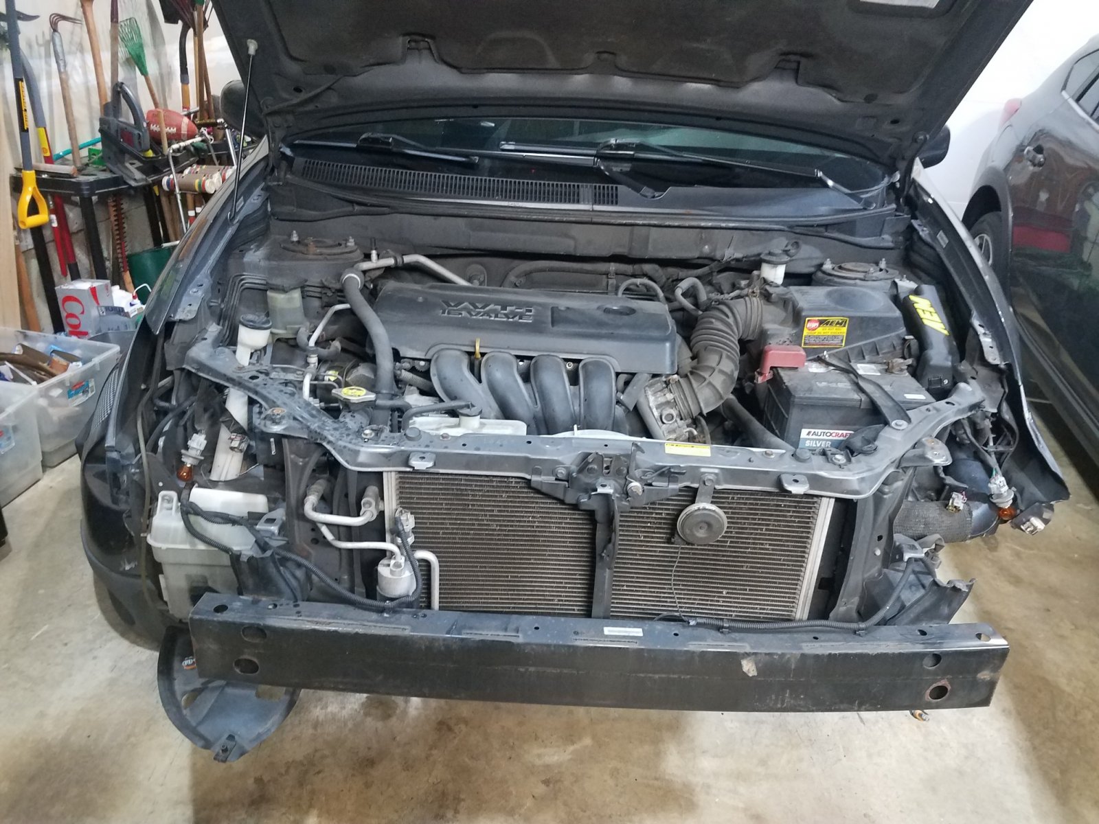

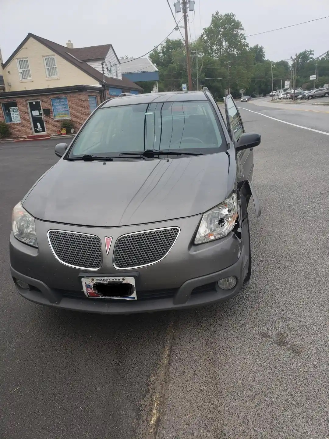

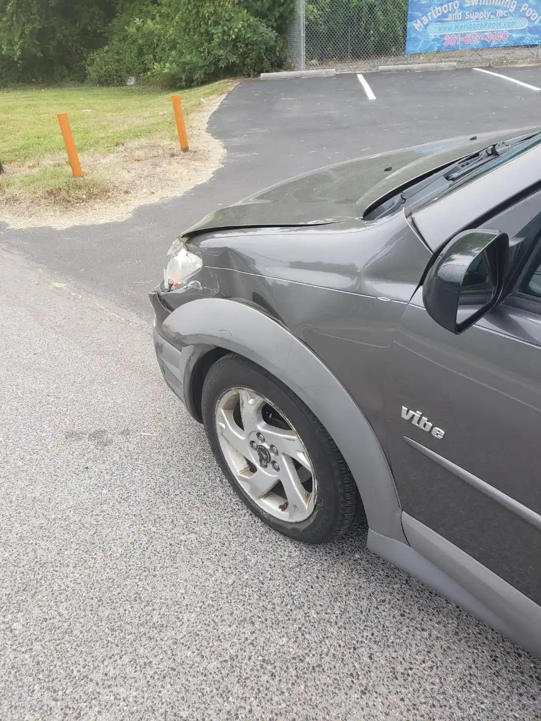

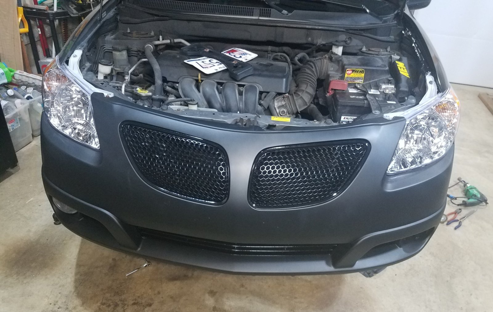

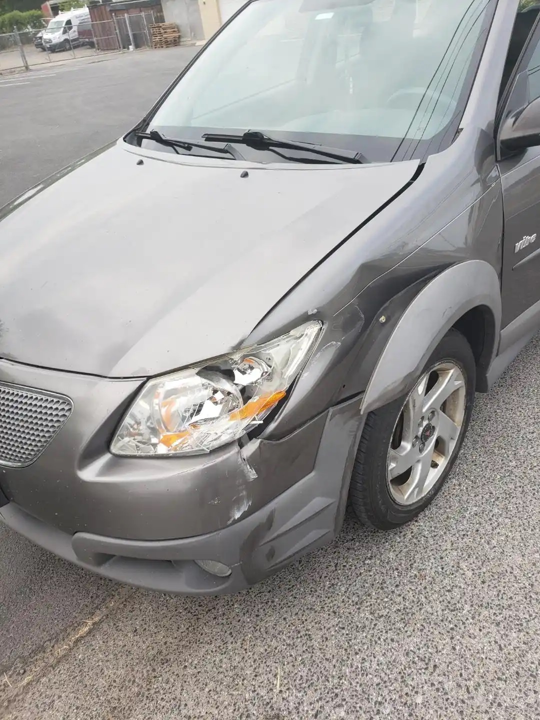

Shaping up to be a long summer, with little work being done on my build. Two days after I finished my oldest daughter's AC, I received a phone call from my youngest daughter that her 2008 Pontiac Vibe (225K miles) was hit in the driver's side front fender. She was ok and the car was drivable. Not her fault.
However, two days later the insurance company was going to total the vehicle. This thing runs like a top (I take care of it for her), looks great and she really could not afford another vehicle - the used car market is crazy. So, I told her I would repair it. So, it sits in my garage, right where my oldest daughter's car last sat.

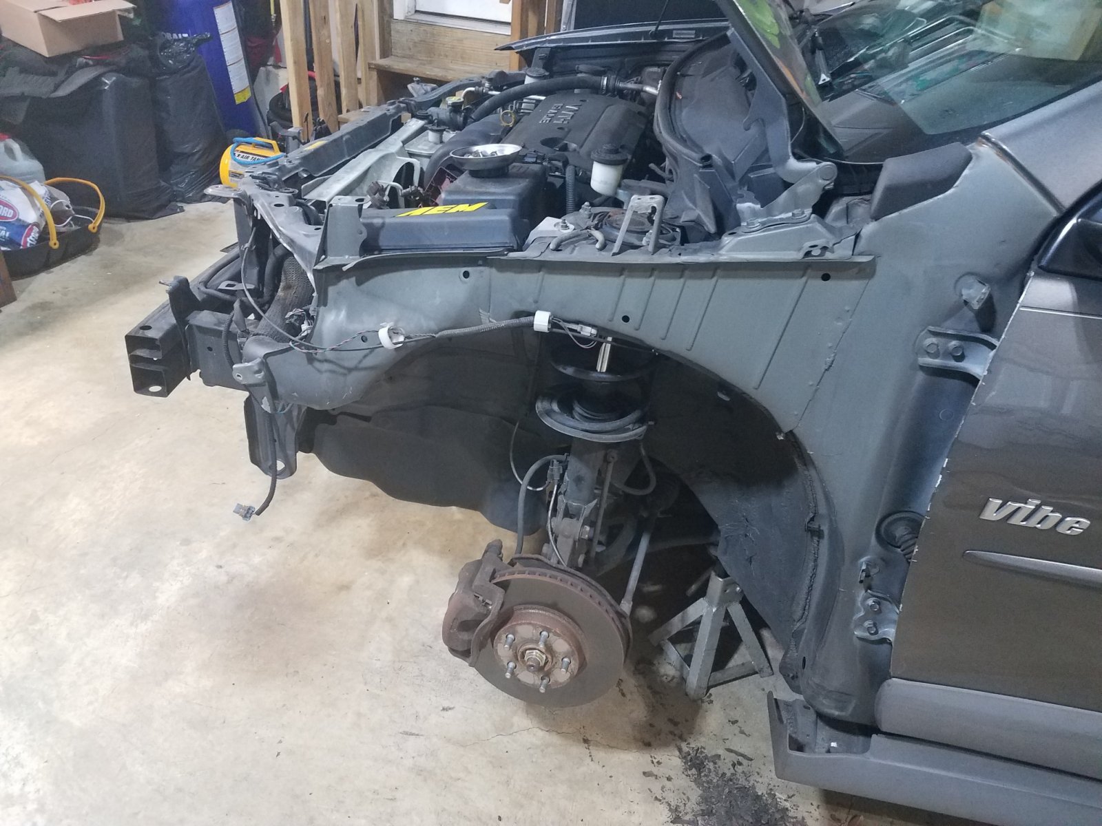

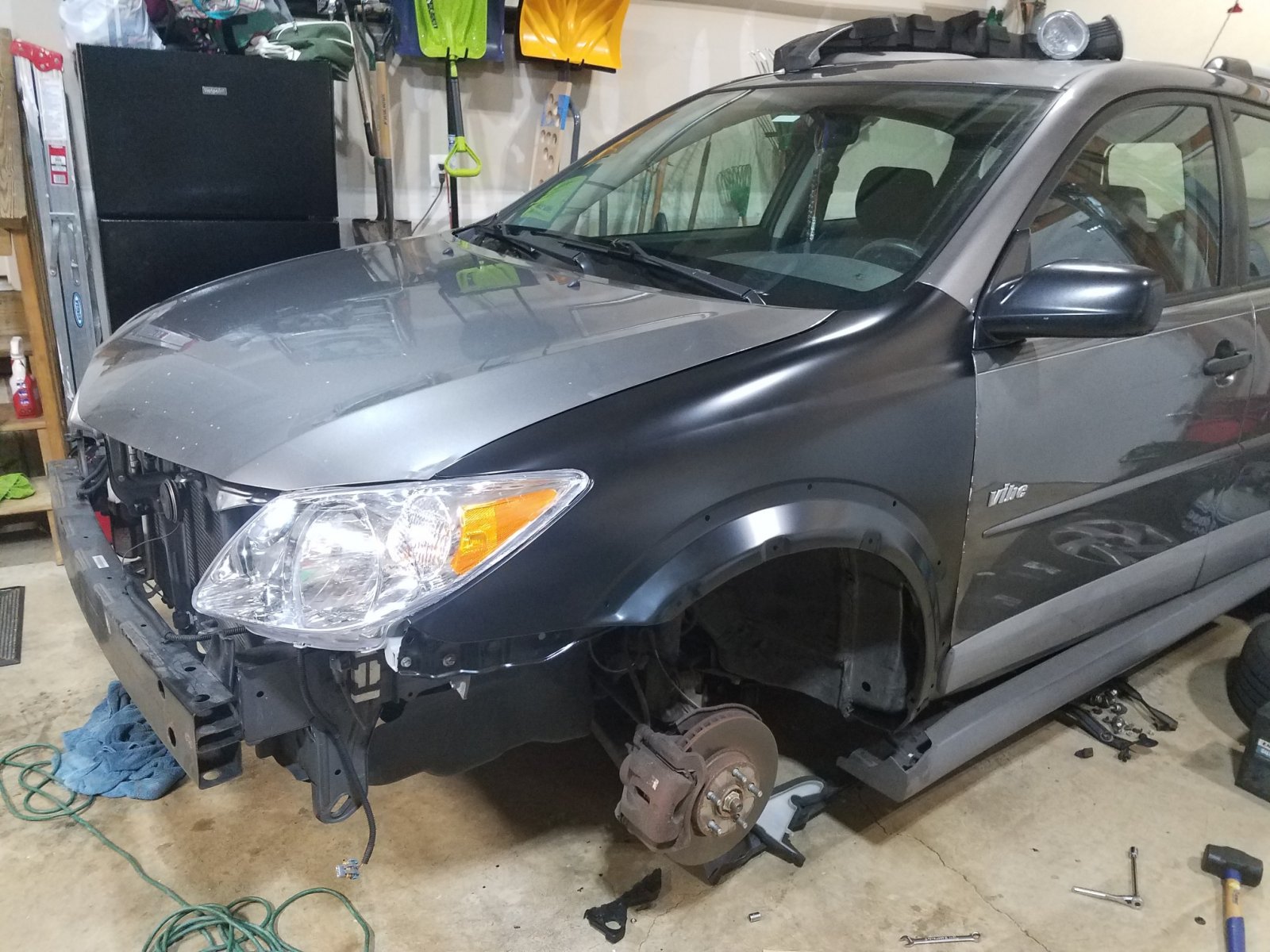

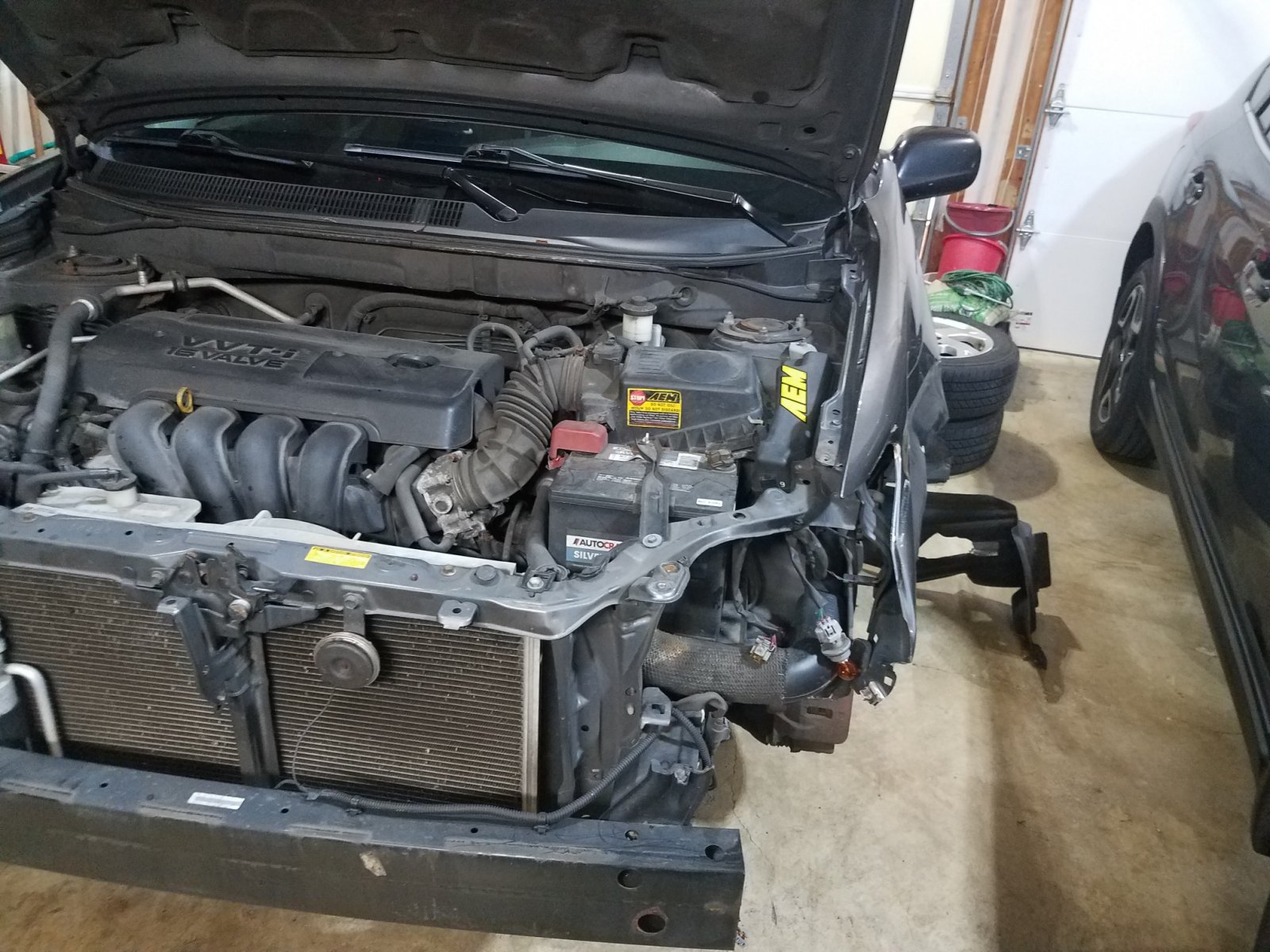

During the long Holiday weekend (happy belated 4th everyone), I removed the bumper cover, fender, splash shield, headlights and a variety of other components.
Spent the entire day on Monday straightening the radiator support and various other components so I could get the new fender aligned and mounted correctly. Then yesterday evening I finally got the fender installed. Is it perfect - no, but oh so close. It will work.
This weekend I will get the bumper cover back on. Painting will happen once the paint gets delivered.

Mark, you are so right. So basically total repairs would need to be less than 50% of the current value of the car. The estimate for repair was just under $4.5K. That was of course before they tore into it. Labor/paint was a good chunk of that cost. I have spent just about $500 in parts - maybe a tad more. Another $100 or so in paint. Of course she get's the family discount for labor - no charge.
$4.5K?! Looks like nothing structural or even suspension was affected. No bags were deployed.
Those are great cars, being Toyotas. Good save!
RAMurphy
RAMurphy
Bob
Military
Oct 5, 2011
1,450
4,649
S. Maryland
I was shocked at the estimate, but even if it was lower it would had to of been a lot lower. The year and mileage drive down the value of this car drastically. But, she is a great car and my daughter loves it, it's worth the effort to get her back on the road.
