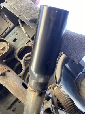

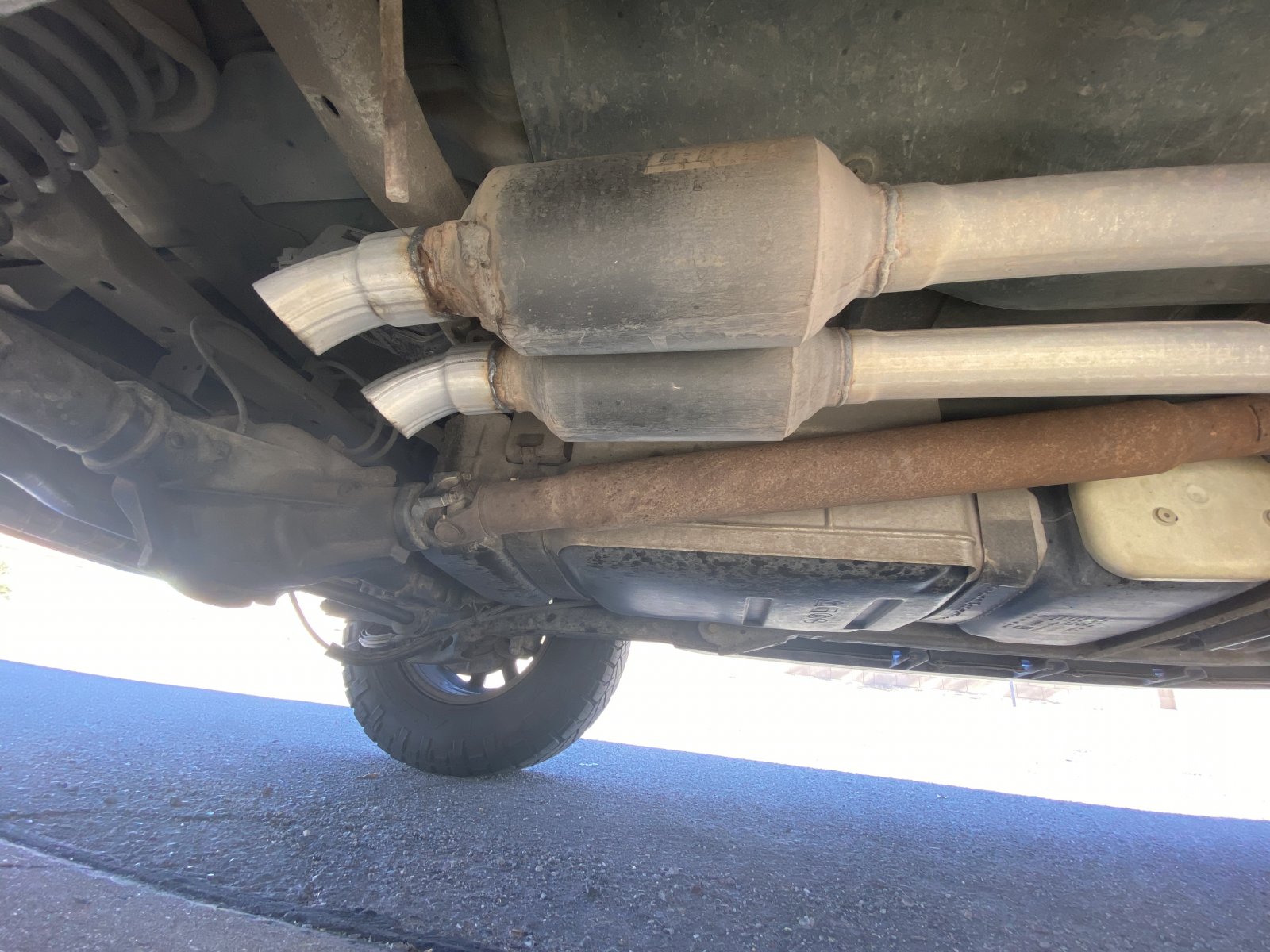

I’ve been MIA for awhile but life gets busy sometimes. I was finally able to get my exhaust fixed. I originally had true duals out the back but they broke off because there’s really not enough room for the driver side exhaust. Had a temporary fix of turn downs but I didn’t like the sound. Finally got the exhaust setup that sounds great and looks good. Still 2 mufflers into a Ypipe then out the stock exhaust spot. The Carven RPTs are still the best
