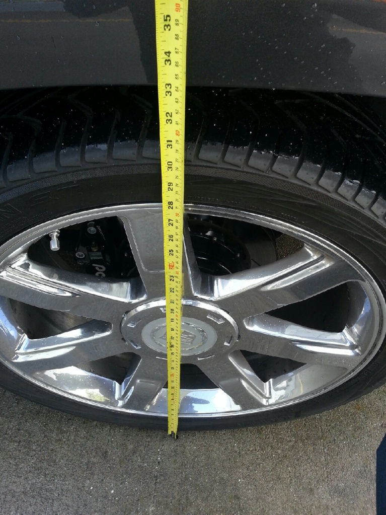

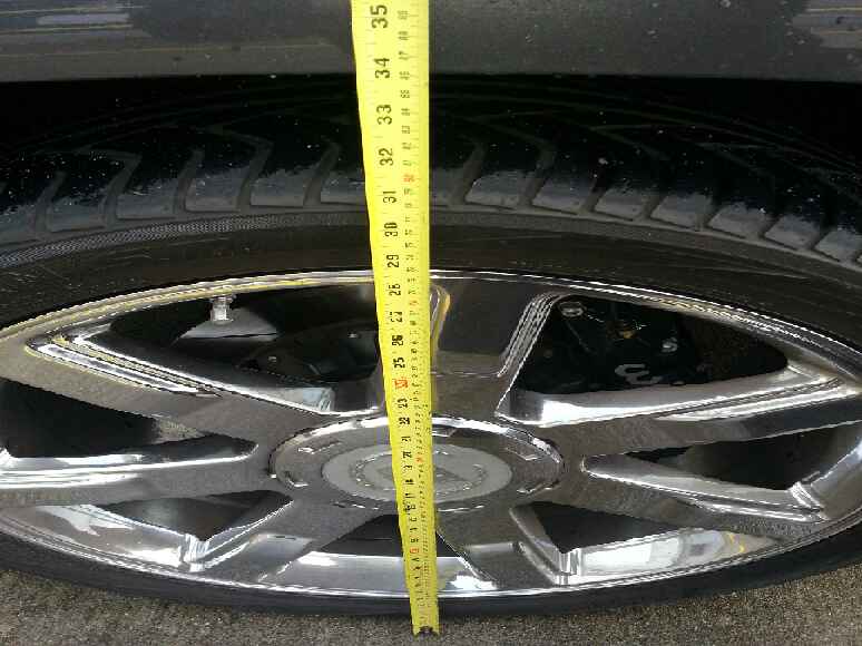

4230 SPRINGS installed for picture taking..
33 1/8 from ground to fenderlip in rear
33 7/8 front
Cali LEAN lol

No the 5305 are back in at 34.5 again in rear. I just wanted to show the tb coils on my truck and what it sat at since the heights were brought into question recently. The 5305 on autoride tows great with 5 people in the truck and the ctsv in the rear plus dont want to go lower in front since I did about 3/4 of a inch with my strut mod. I don't like going more than one inch on stock autoride shocks or oem regular shocks doing my strut mod.

So you're at 34 in the front with spindles and 3/4 strut mod?

33 7/8 my truck sits higher in the front since it was 2wd (awd escalade sits a little lower due to tc weight) Was about 3/4 of a inch higher before my strut mod. I posted pics of the original drop and you can see front was higher which is why I did the strut mod. Post #157 shows this.
