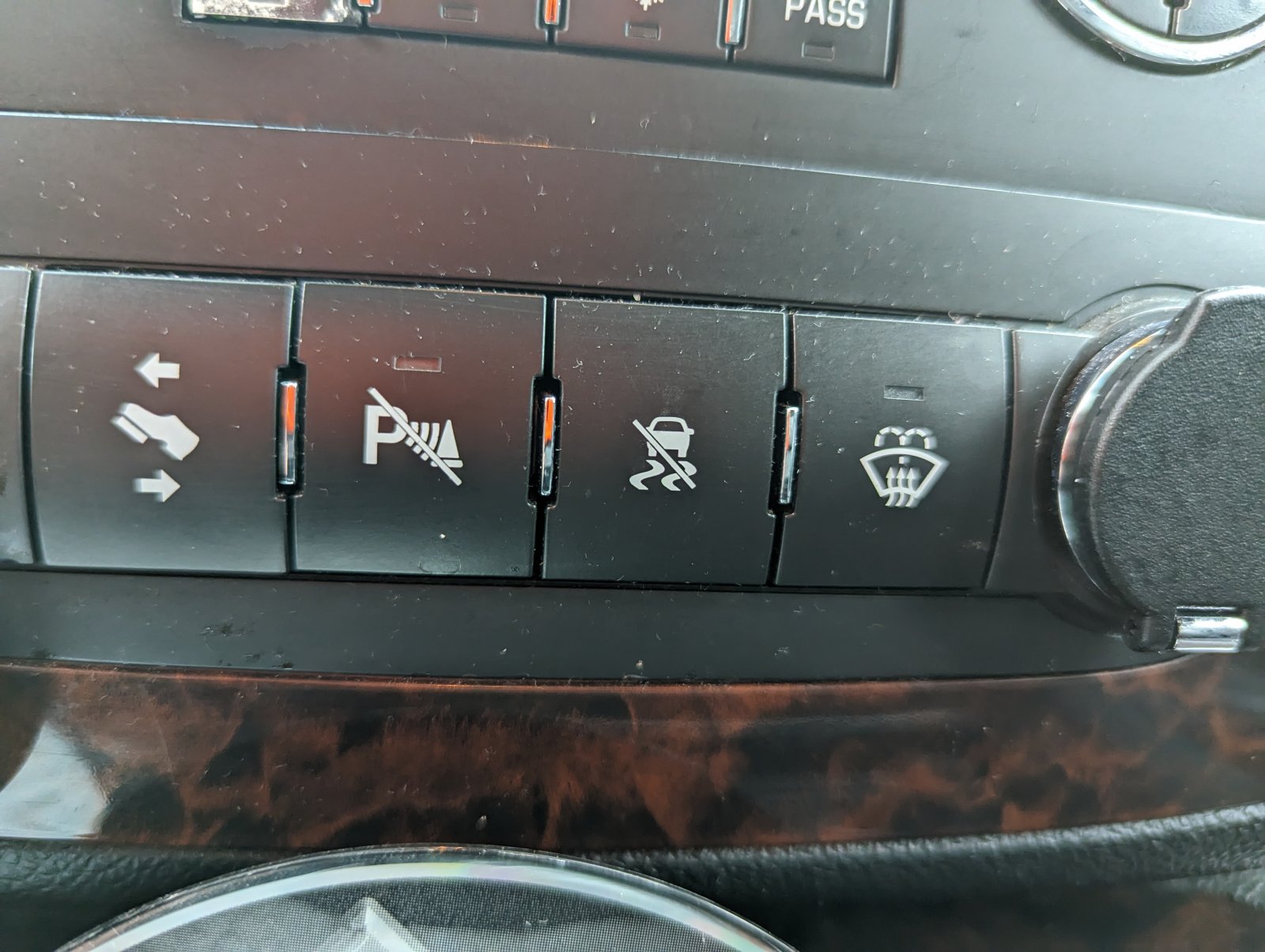

Pretty sure that is for the heated washer fluid that was recalled. Do you have that button between your power outlets under the HVAC controls? You may have 3 to 5 buttons on those early cars.
Use GM OE parts whenever possible. Drill out those busted swaybar bolts and if you get lucky can save the threads, if not, helicoil or put in a bigger thread. There's a nut welded to the top of the bracket. They get really corroded up north and snap off easily since the heads are only 10mm, BTDT!
You're going to want a Tech-2 or similar to get this thing in top form again.
Photo of the buttons. I believe your are correct. Button doesn't do anything. That's what the disconnected wires under-hood go to?

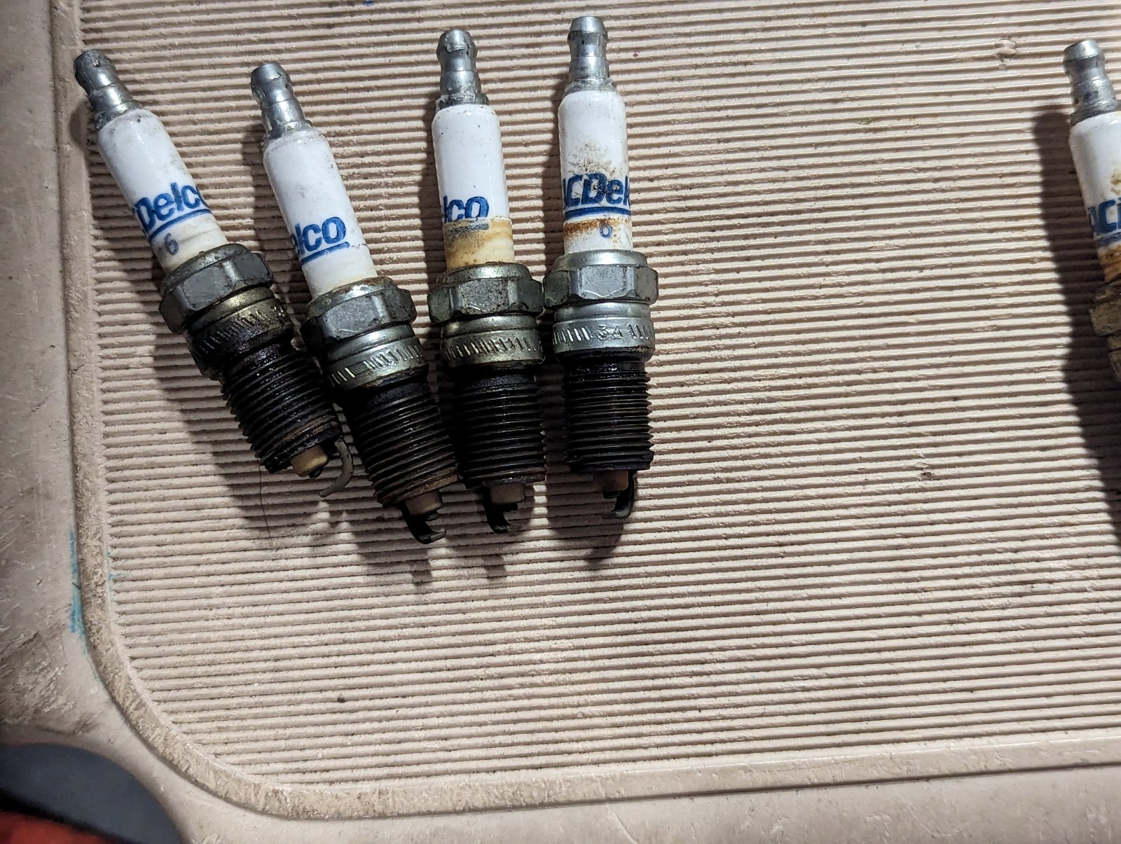

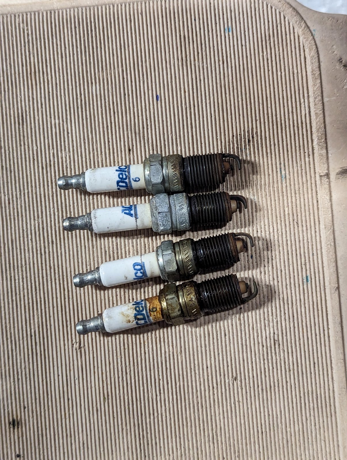

Put new plugs in today. It was wayyyy over sure. Average gap on them was .080"! Pass rear plug was a little difficult to get at, but removing the wheel well liner made it pretty easy.
Found it has a broken exh manifold stud (front one) on driver's side.... Bummer!
Next up is driver side abs wheel sensor. Then im going to fix or replace the front seat, neither one works lol.

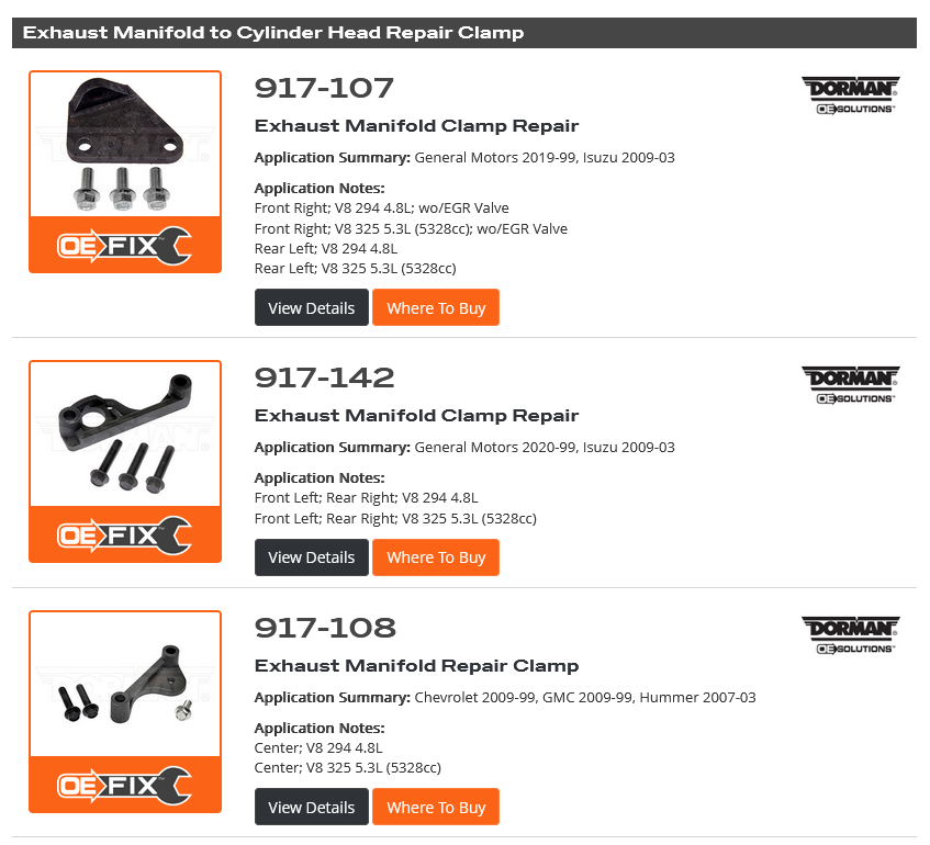

front driver side, at least on my truck would be the easiest to get to. mine broke the rear drivers side. little worse but the clamp thing seems to be sealing it well. worth 20$ not to have to pull the manifold for a while.
the tend to suck air and mess with the o2 readings, might be worth moving that up the list.

clamp thing?
