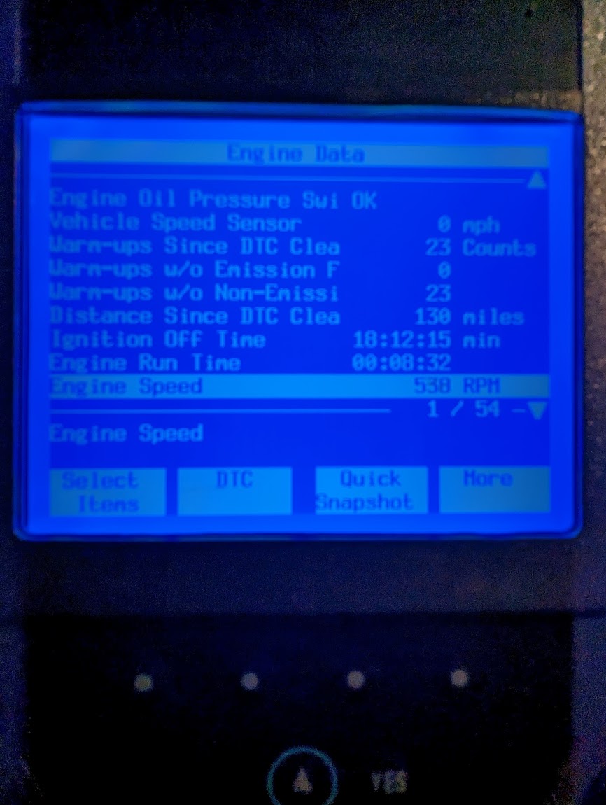

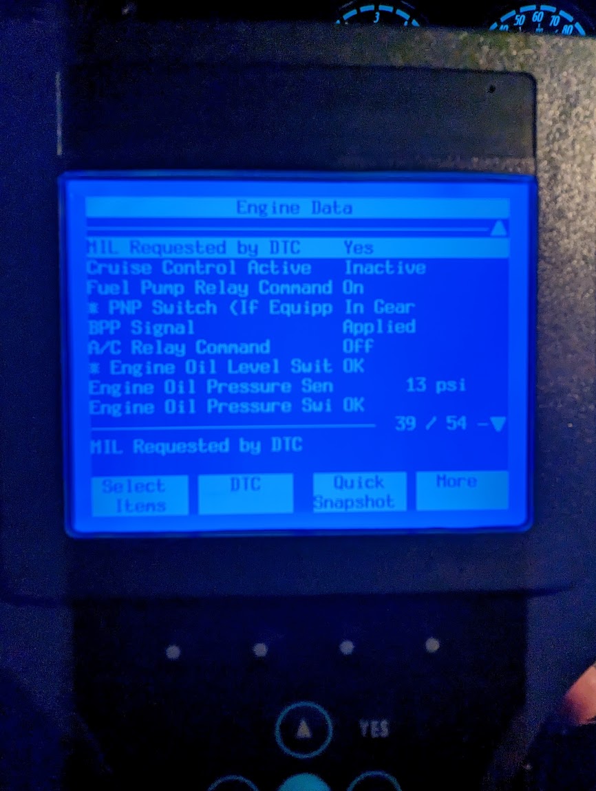

The only 'major' concern initially for me is that after driving for a while (I'd say about 20-30 mins), it will stumble and die coming to a stop at a traffic light (dies at the light or just before at like 2 mph). It is then hard as hell to get started. it has done it 3 times(oil was near the lowest dot on dipstick, I've added about a 1/2 quart of lucas), the last time I got it started fast by holding pedal to floor then playing with throttle to keep it running. When its been running for 15 or so mins oil pressure gets down to the 10-psi range especially when idling at a light though press light doesn't illuminate.

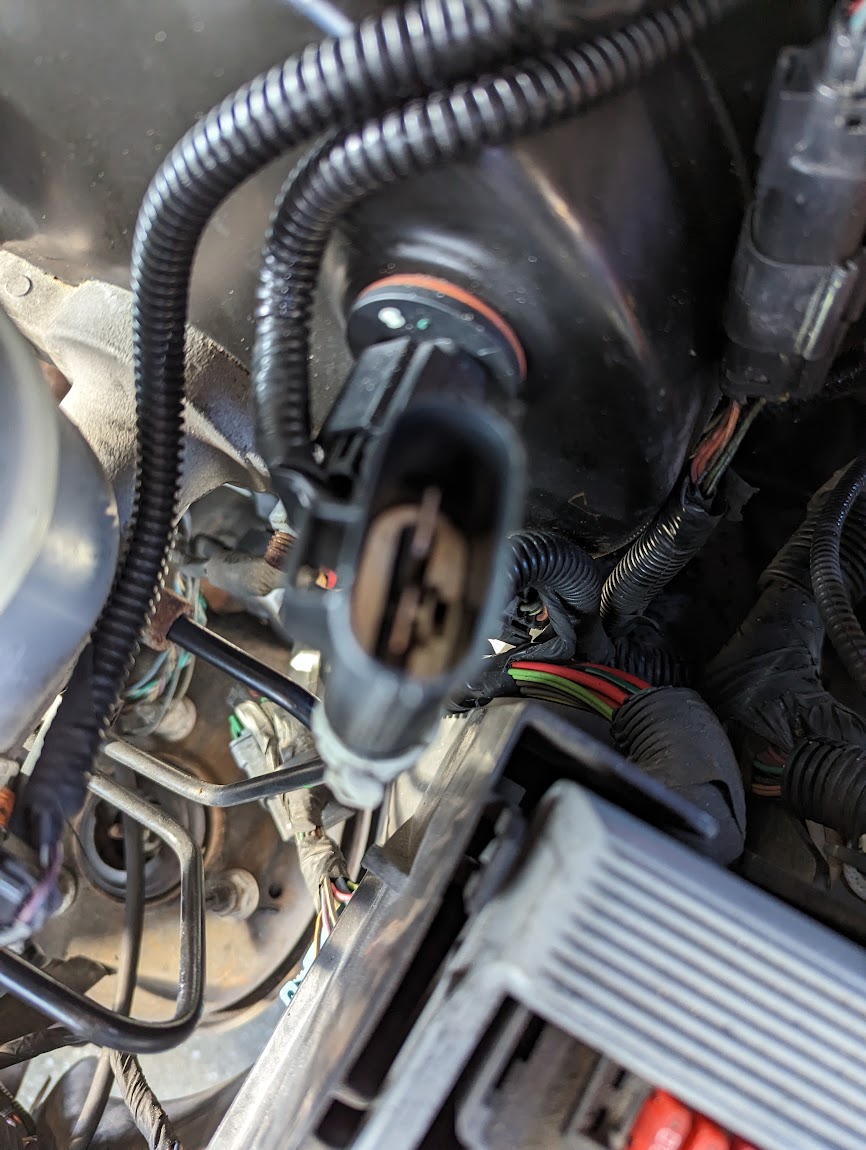

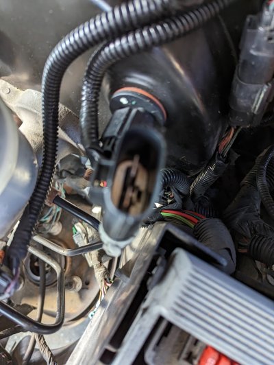

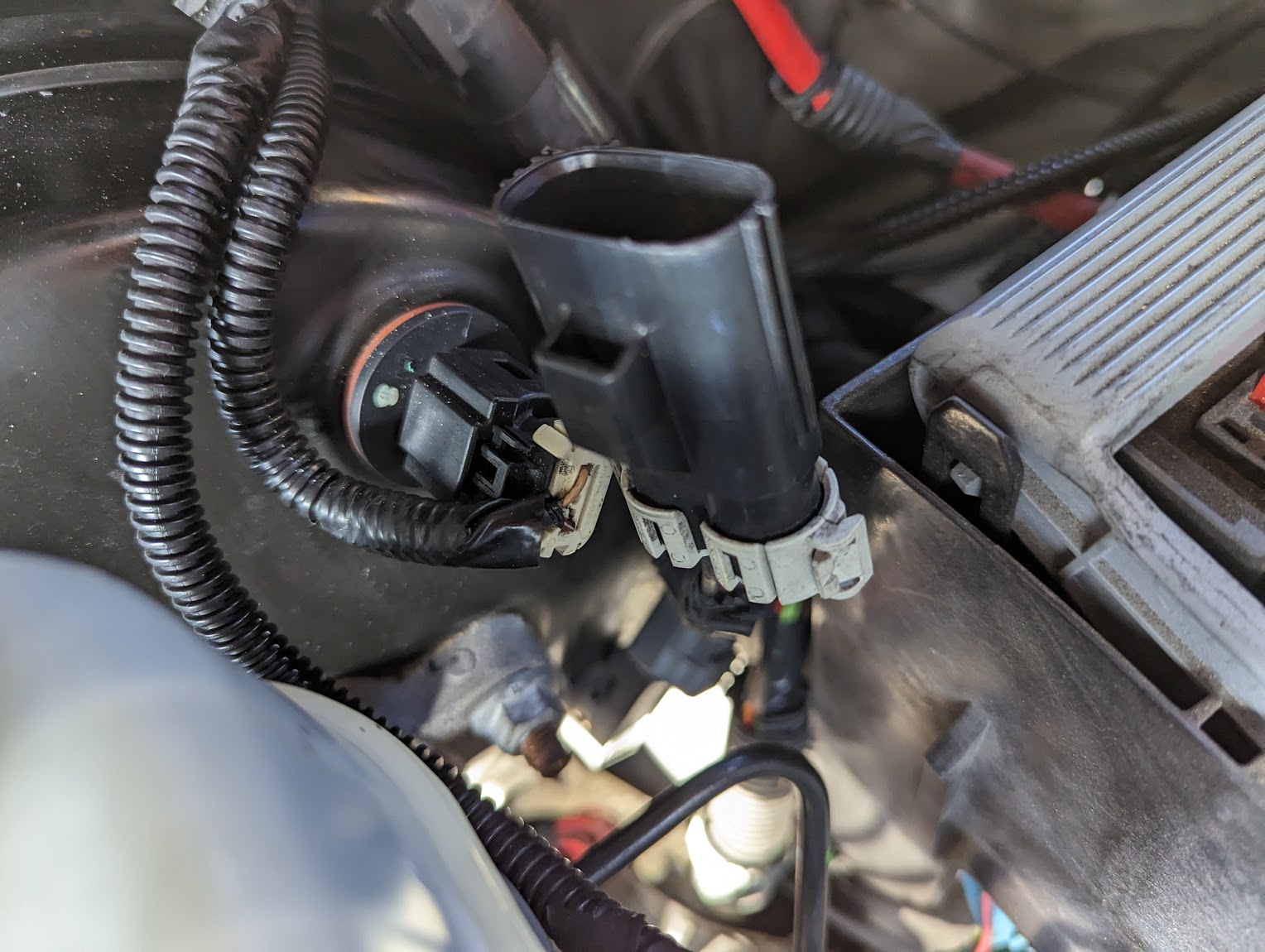

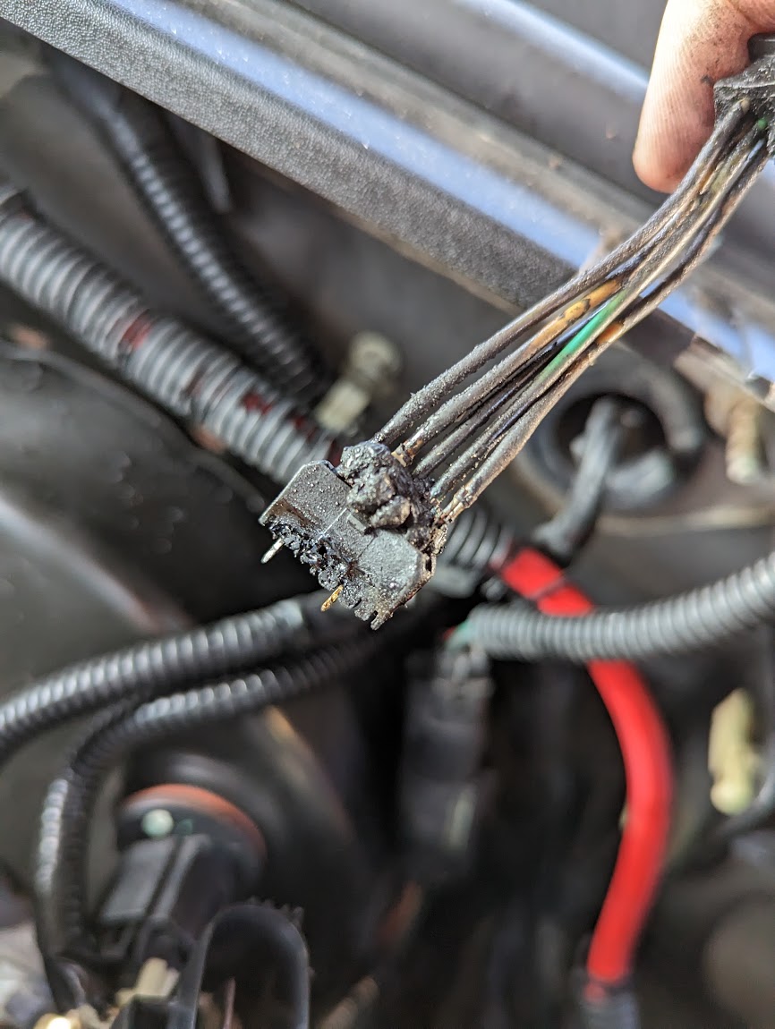

Heated seats (front seats) dont work (light turns on then off after apprx 30 secs), power seats dont work (drivers side clicks doesnt move, pass side doesnt do anything). Pedal adjust button clicks but doesnt move. Pass side window front/rear dont work (both just click). I found a disconnected wire I cant find the connection for by the battery (large 2 prong plug), and a melted wire that was tucked underneath the battery, and I will try and post a picture of).

It has 34 DTCs in total. I have experience as a mechanic, but not as a professional. What does symptom mean to the right of the code #? Anything else I should grab? I was told to grab history as well, I need to do that.
