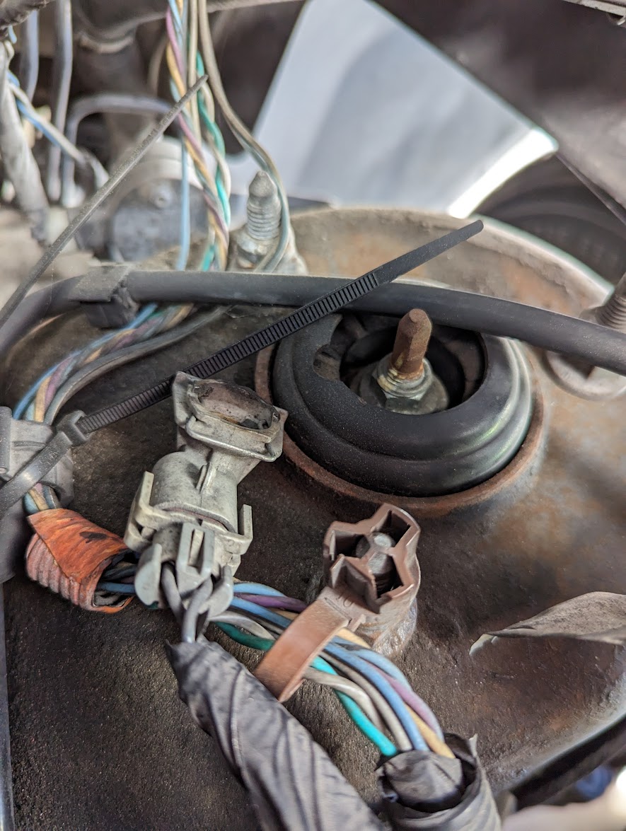

I found that my rear shocks are blown(air shocks), and while I've been exploring in the engine bay found that the front shock electrical? connectors are no longer connected to the front shocks (up at the top I'm assuming), and the front shocks have coil springs on them. I'm assuming the front shocks do Not come with coils so someone already converted the front to non air suspension?
Also found it doesn't have a front sway bar, and someone snapped the mount bolts off on the passenger side for the sways, so thats going to be a very fun fix!
The front suspension is always coil spring on these trucks, even when you have air suspension in the rear. It’s possible that the previous owner replaced the front shocks with passive shocks and installed resistors to avoid the service suspension warning message. If you can snap a picture of the front strut cartridges, we can help you identify them perhaps.
I can’t imagine driving one of these without a front sway bar. That’s a big deal. Those bolts use the friction nut plate, so you may end up having to drill it out and change the threads with a tap. Sucks man, I’m sorry.

that makes sense, I've seen conversion kits so assumed the springs were due to no ride control. I def have the light for service suspension(dont see any resistors in that harness at least). I've attached pictures to this post that you wanted to see. It seems to have had front/rear air suspension(I can see components indicating it did at least), especially since its a Denali.
I will be fixing the sway bar for sure. I assumed it needed front shocks and That was why it was so 'floaty' up front lol.
Any idea what is supposed to be behind the fuse box in the last picture? Seems something was hooked up there, havent found any good pictures that identify it.

anyone have any input on those front shocks, or what goes behind the fuse box in the engine bay? @Geotrash
