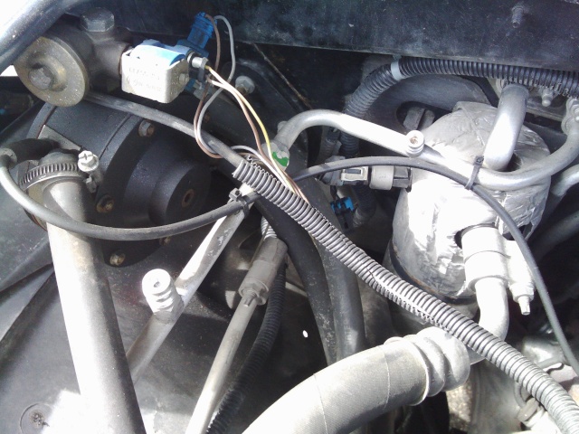

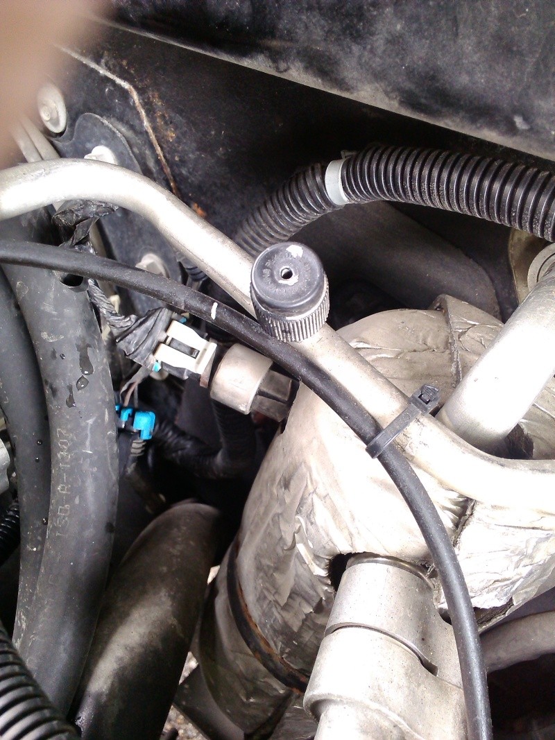

The liquid gas arrive there, on the passenger side of the engine bay:
This stuff transform liquid ga to vapor gas.
Then it's managed by those injectors:
(driver side shown - passenger side identical lol).
Who are plugged to the intake manifold:
(image show one of the rubber hose going to the manifold)
A view from my engine bay:
The FlashLube is meant to be lower than the vapor-making item so the mechanic fixed it on the driver side. there was no more room on the passenger side. But there is a rubber hose that goes from the oil reservoir to the intake something juste under the plastic cover:
I don't know where it goes but it works.

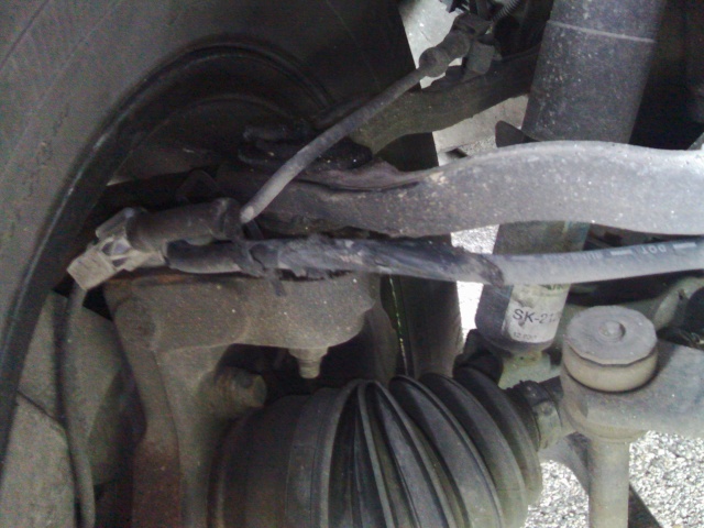

First bolt to undo :
There is a bold retainer. Only one bracket is necessary to release the screw there.
Loosen the bold. It's metric. 15mm.

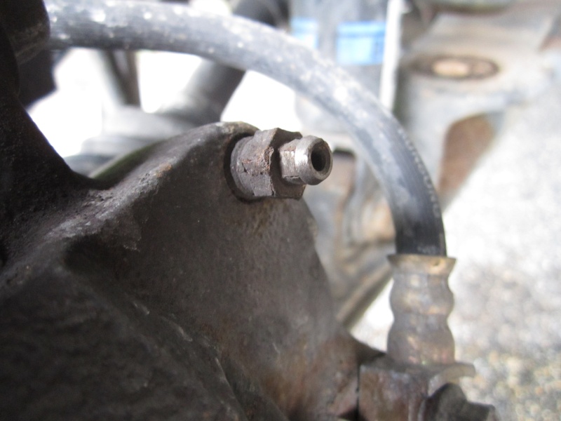

I decided to change my brake pads.
Don't know how often I'm supposed to change them. Thei were changed last year. ONe year and 6k miles after I've got to change them again.
Jack, jackstands and wrench everything is ready. Remove the wheel.
The state of the pads:
Two screws are holding the pads bracket:
It's Torx T55.
Open up the bracket:
It was about time!
Brakes are important. I took a well-known brand at RockAuto:
Break cleaner to remove dust:
Antirattle parts are included:
Thickness:
Open the reservoir before pushing the piston back. It'll make the piston push easier.
If the level has been made after betwwen pads change, then it will overflow when pushing the pistons back. Take a seringe and remove some of the liquid before pushing the pistons back.
That' how I did pushing the pistons back:
My C-clamp wasn't wide enough to to it the official way.
trying this way is useless. The free piston will pop out each time you'll push the otherone.
Pads are not identical!
The one with only one metal part goes on the inside.The pair of pads shown here are goint to the driver side.
Get rid of the old pads:
How does it looks from the inside :
Tom Joad
Tom Joad
French V8 lover.
Apr 27, 2011
393
69
Chamonix-Mont Blanc ski resort,. France
Remove the old anti-rattle clips :
Warning; both side are not identical!
Install the metal clips:
then the pads
Put hte bracket back down, tighten the bol to the specified torque.
Check : that's bettter indeed !
Pump on the brake pedal in odrer to get the pads the closest to the disk before starting your vehicle.

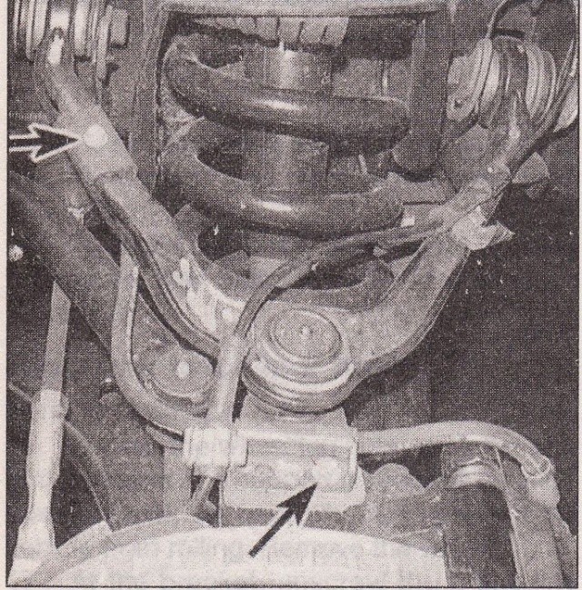

Then I tried to change them on the driver side. Sadly The torx screw is really tightened and I stop before I destroyed the head.
jdpber
GOLD MEMBER
Oct 18, 2010
27,278
29,481
The America
the bolts i was mentioning earlier are the main bracket bolts to the left next to the CV axel you can take those free and the entire caliper off if that torkes will not budge and do ad i described earlier

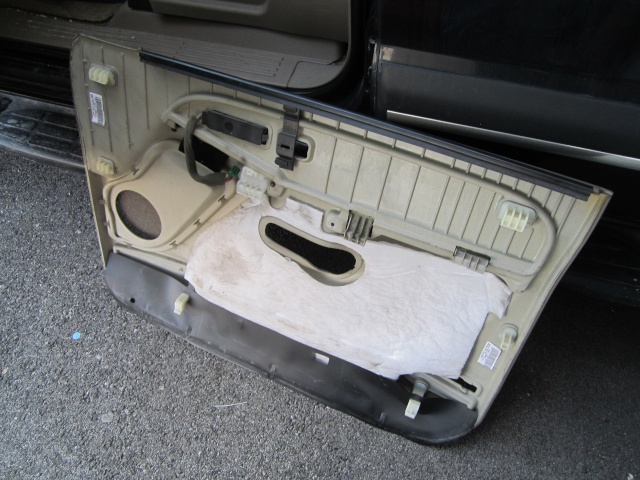

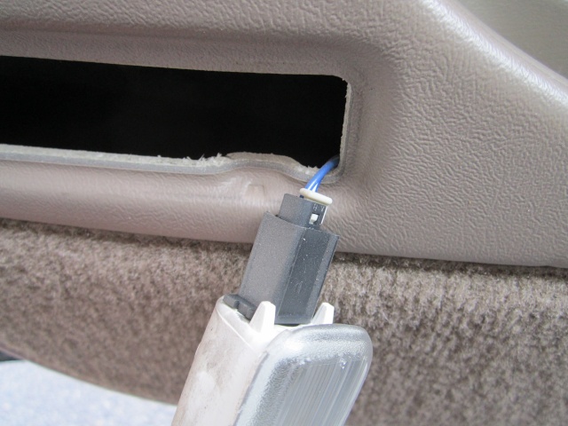

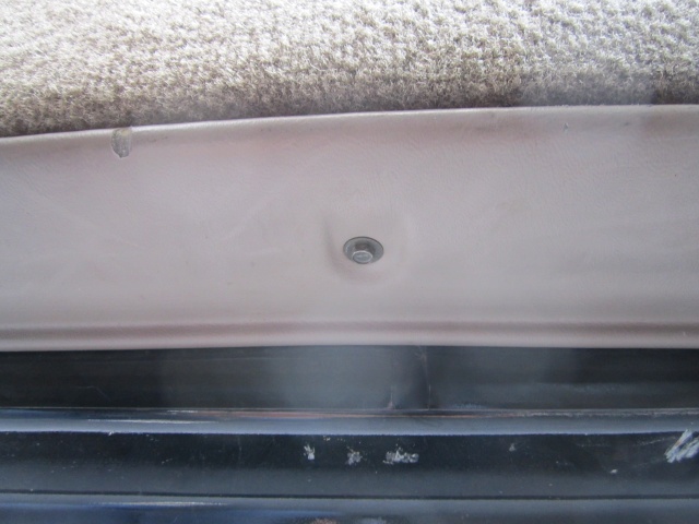

I will document the way to remove the inside trim door of the Tahoe.

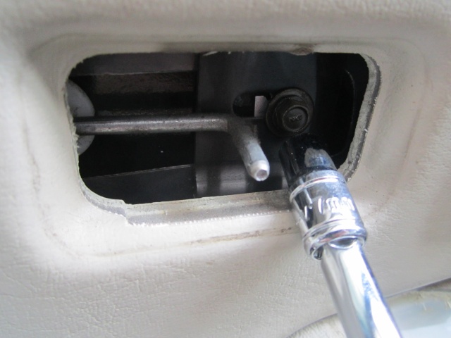

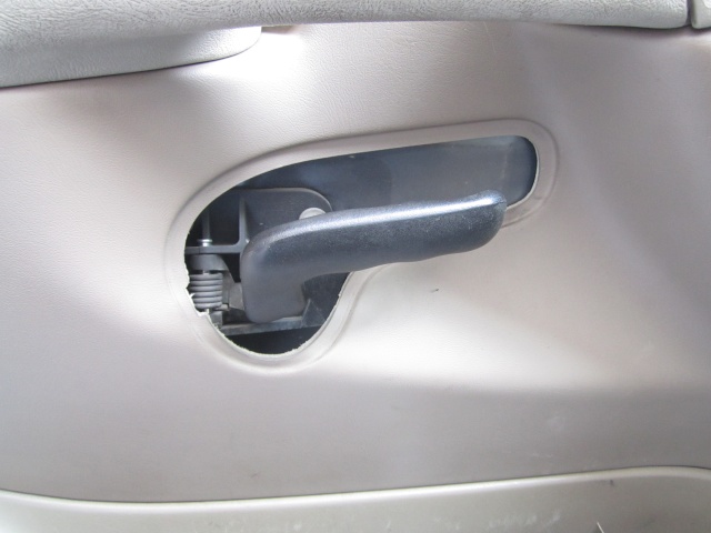

remove the door handle trim :

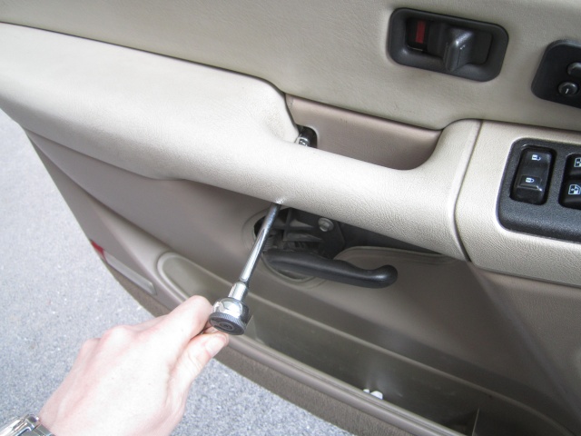

Remove the screw (7 mm) :

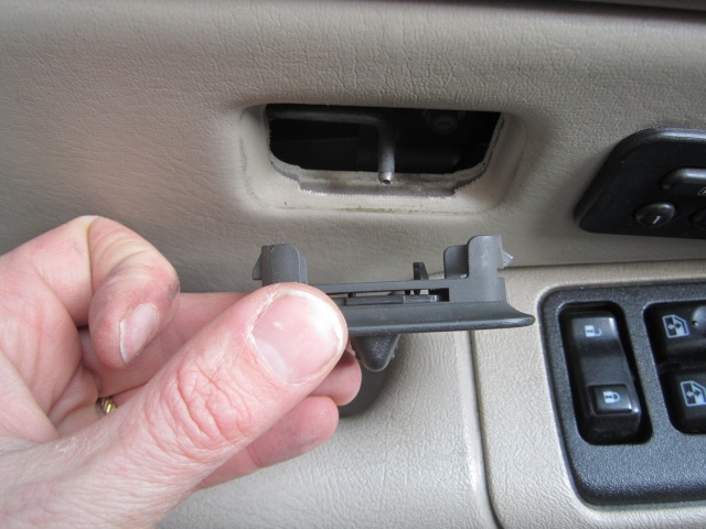

Remove the lock/unlock trim switch :
Remove the screw which is laying under the door panel :
Unplug the courtesy light :
Pull upward and toward you to remove the door trim.

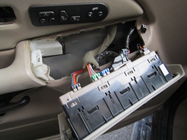

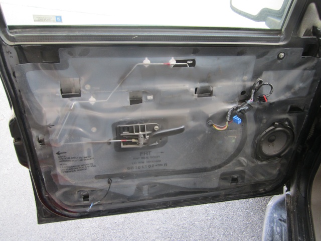

Be carefull the PW/PM switches are still connected.

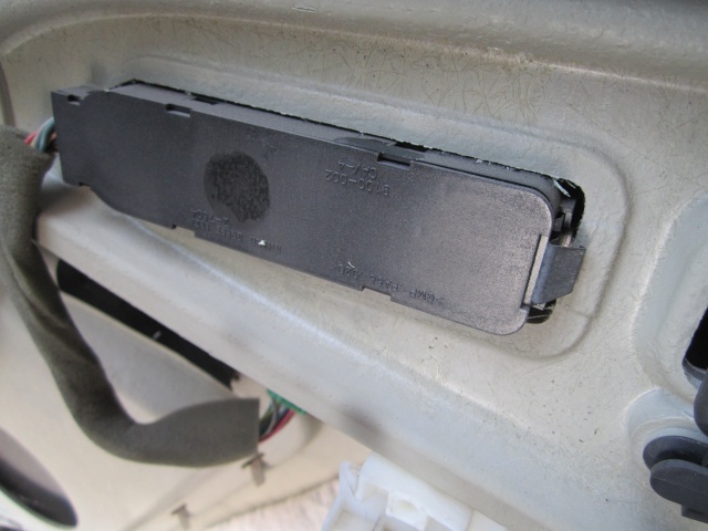

To remove the switches pad, you'll need to remove a screw from the inside of the door panel.
Mine is broken because of a bad explaination found on the internet. So I can remove the switch pad without removing the door panel.
Don't try this at home, kids ! :Nonono:
Colors of plugs are written. No way to make a mistake but if you're drunk.
Once removed :
The green plug is ofr the heating seats. You cna leave it plugged.
To remove the switches, just push them from the inside.

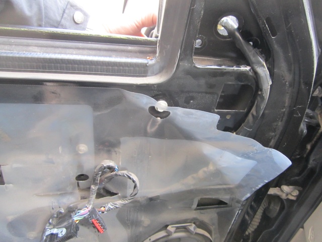

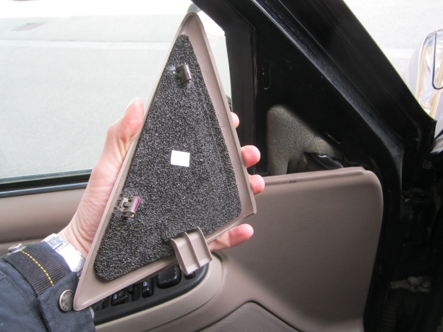

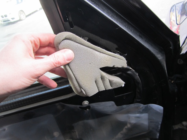

remove the inside mirror trim :
New from the factory plant.
remove :
You can't just unplug the mirror, you'll have to remove the whole harness. It's taped to the body twice :
photo 14
Remove the bold to remove the mirror. It's 10mm socket.
I had to do this bevcause my mirrors doesn't fold anymore. They unfold but won't fold.
I've unpluggeed the driver mirror and then the passenger mirror start to fold and unfold on command. Once the driver mirror is connected, it won't fold again.
PLus the driver mirror makes a sound when unfoldin, like if it was running free, then makes a snap noise.
I'll put a video on YT soon.
I feels like I'll have to buy a new driver mirror.

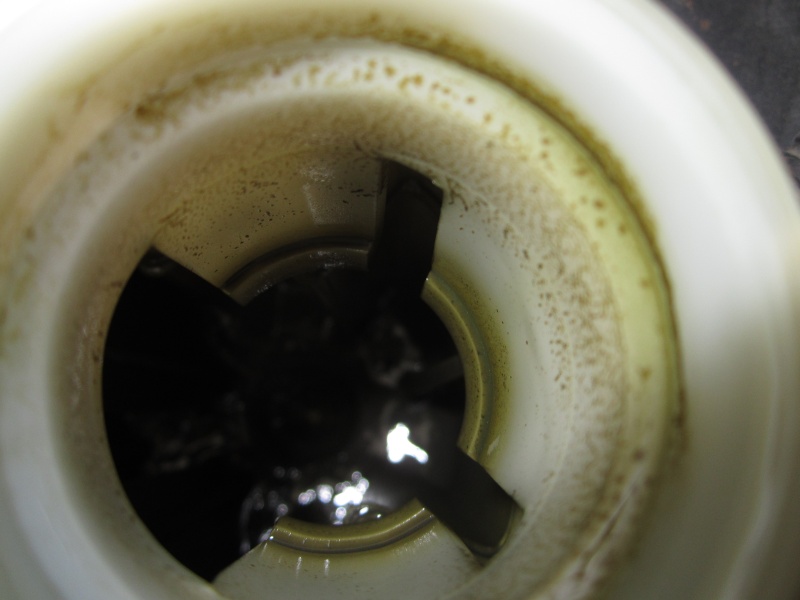

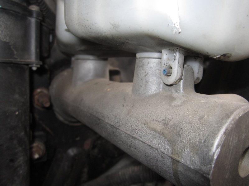

This morning though I was going to do a 4 hours trip to the French Riviera, my cluster asked me to check the brake system.
Indeed When i pushed the pedal to the metal a cloud of Dot liquid spread from the wheel.
The bottle is empty with some dirt at the bottom :
It seems its holding with thoses little brackets :
Is it hard to swap? Is it wirth to remplace it with a clean new one?
Won't it be harder to refill it?
Once the wheel removed :
Close-up :
Did it touched the wheel ? the inside tire is clean. There's paint missing onto the wheel but it's not clear who made it....
Questions :
Should I change this screw when I'll swap the flexibles hoses?
the same question for this one.
NOw I'll replace every part which failled with an upgraded one.
For those flexibles hoses, i'll buy Russel :
For exemple ici.
I hope the picture is not the real product since it has neither bracket I have on the actual hose.
I've looked at Rockauto and noticed that regular OEM hoses had brackeds on them.

One gave me yesterday night a picture of an original brake flexible hose installation.
Compare with mine and you'll find out what was my issue :
and
My mechanic did change the wheel bearing few months ago and I guess he add this little black cable tie thinking well. But that's what made the hose having rubbed against the wheel.

When I got the A/C circuit refilled, the muy showed me that a plug had some wire loose.
Here is a picture of the plug(s):
From the big black wiring cover get out two plugs. The blue one with a black and a brown wire is loose. The other one is plugged to the A/C stuff on the right.
But those last days this is not the most important as we have a f... weather with cloudy sky and rain an hour out of two.

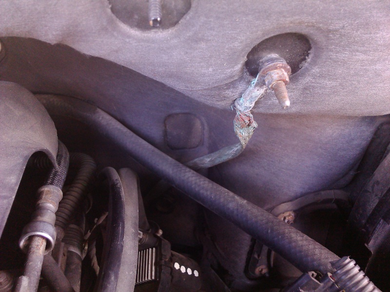

I can't start my tahoe anymore. Everything seems ok the courtesy lights and the dashboard light up as usual but when i turn the key once more everything shut down.
I though the battery could be the reason of all the issues but it was ok (at least before several tries). I thing the ground strap could be the cause :
I lie down on the engine earlier but even with a flashlight a couldn't fint the other end of the strip. Where it is tightened and how to access it ?
Tom Joad
Tom Joad
French V8 lover.
Apr 27, 2011
393
69
Some news...
I've changed the ground strap and found out it wasn't the source of the electrical failure i had.
The starter engine was faulty.
I replaced it and it started immediatly.
