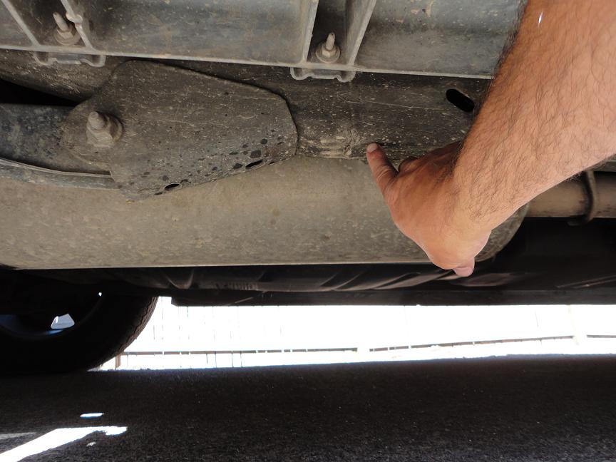

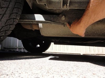

Well, what I did last night when changing out the rear one that died on me, I just used a jack on the area I'm pointing to on either pic (be sure to chock the front wheels though) and just jacked up the body of the truck until the back tire was just about to be off of the ground!!
If you don't feel comfortable with that, then jack the truck up and use a jackstand on the area of the frame I'm pointing to in the second pic with the tire off of the ground a bit, and then use the jack under the rear axle to raise or lower it to take the pressure off of the shock bolts!! Either way will work, only took 10 minutes last night to swap the shock and I was taking my time!!
Too bad you don't live my me, we'd have your shocks swapped fast with ample time to drink a few beers!!:hands:

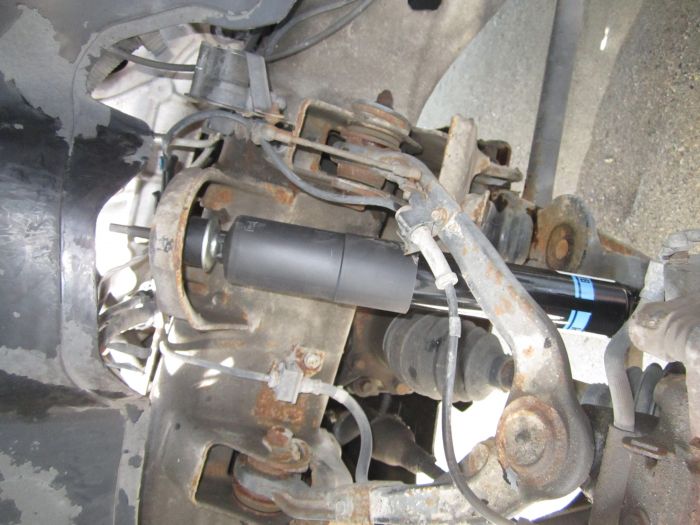

Here is the Bilstein shock (made in Germany (I wish I knew that before...-sigh-)
Lower nuts and bolt are to be kept and reused.
The now one where it belongs
The wrench is used to avoid the upper part of the shock turning on itself :
Voilà :
Lower bolt :
the one I cut :

This is a picture of my rear bilstein :
The blue arrow shows the plug that come from the air compressor. It's plugged.
The red arrows shows the plug that is supposed to tell you when your shocks are dead. Since it's not plugged anymore I've got a message displayed asking me to repair my shocks/struts.
The most ennoying part is shown by the two whites arrows.
The lower metallic part is the top of the rubber blader that is supposed to be air-filled when the Tahoe is fully loaded or trailling. Since I'm not, it's not air filled and each time the shocks is comrpessed, the two parts shown bu the white arrows strike together. It doesn't sound trusty.
On this picture you can see the bladder is not air filled, I can move it with a finger.
