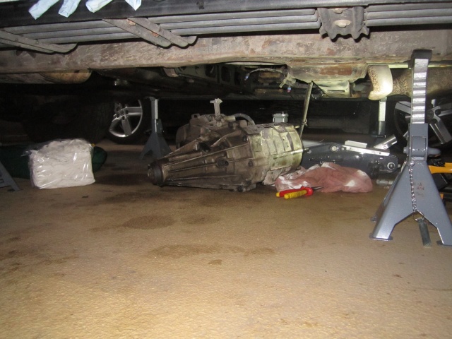

The transfer case is finally down !
My workspace :

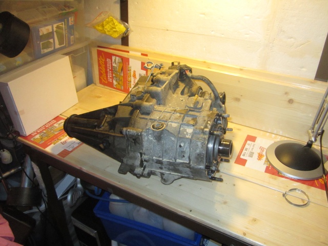

and the TC on my home-made workbench :
[/IMG]
