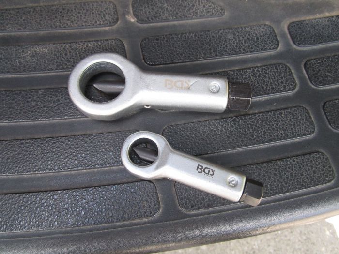

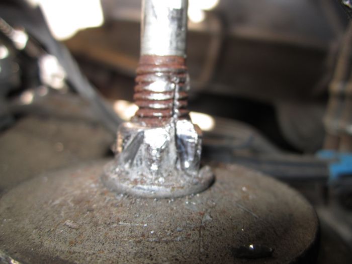

If I could "easily" change the passenger front shock, The upper bolt of the driver shock was too rusty to move.
My idear was to break it with this kind of tool :
I am so naive !
I tried three times befoe giving up.
If I find a good job in september I'll see that then.
A picture of the upper bolt now:

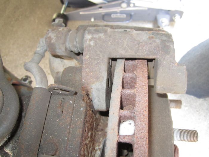

Break pads are also near end of life:

I'd get yourself a grinder with a cut off wheel and just cut that nut and stud off at the base since you are replacing the shock anyways!! Might have to do that to the other front one as well if that one is that bad anyways!!
