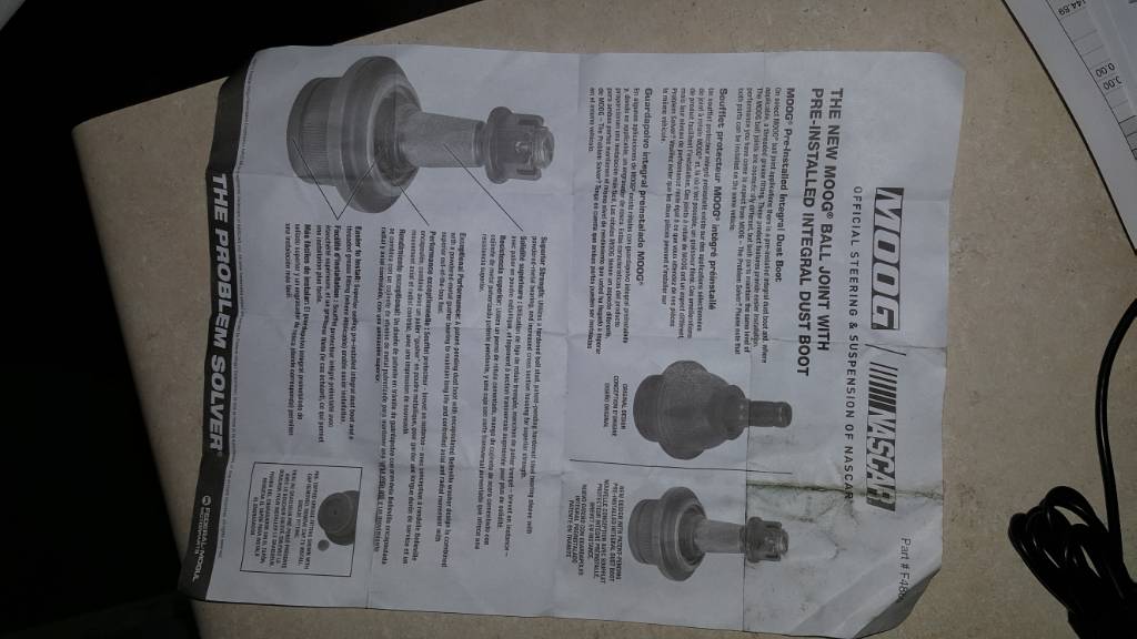

Next time around I ordered the correct, Moog upper ball joint for front control arm. Then the nightmare begins. First, I ordered the Moog because is a beefier ball joint, and appears to be a better dust boot design. The dust boot is fastened to the joint itself as apposed to the generic design where the boot was a separate part sandwiched between control arm and steering knuckle.

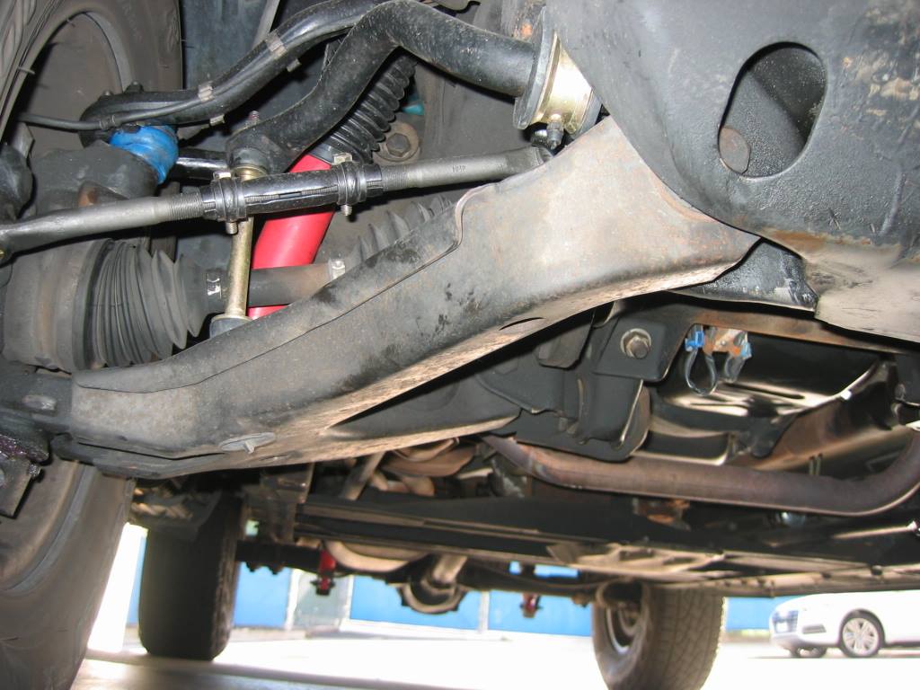

If memory serves you can do so without d/cing the torsion bars, but it's a fair bit easier to do so and well worth your time. Just grab one of the torsion key tools. The things won't take you but a few minutes to get to where you can work with them. Take the preload off, pop the height adjusters out, and just let the keys hang. Turn the bushings loose a turn or 2 and you'll have all the movement you need.
I'd replace the control arm at this point. The lower ball joint is load bearing. Not worth the risk to reuse in it's current state IMO
And TBH I wouldn't use moog stuff. I'm fairly disenchanted by them. Used their tie rods on my rig and I was wholly unimpressed with the build quality and results.
Auto parts store should be able to rent you both a ball joint press and torsion key tool

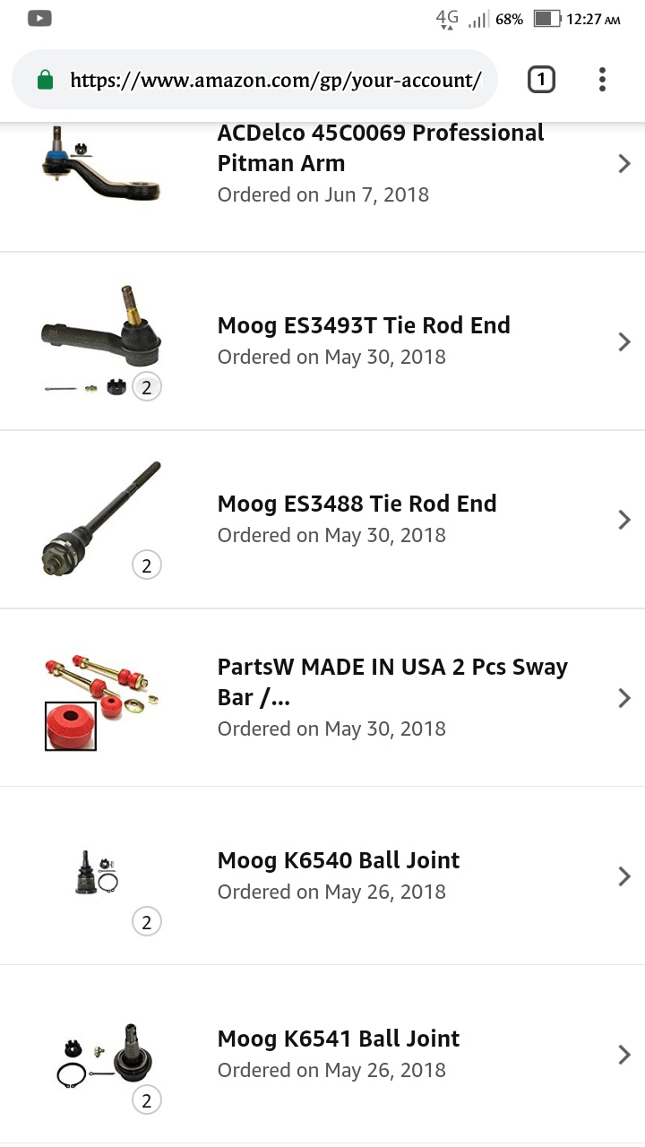

I think Chris, @iamdub recently bought some Chicom front suspension parts to try out. I don't know that I could trust your Moog fiasco by leaving it, might go OE.
Don't discredit them! They are AC DELCO Chicom parts! :bleh:
Best I can put together from the parts I got and after some reading, is that the AC Delco Professional series stuff is the reboxed Moog/Chicom/whatever parts. I don't know who makes the "regular" AC Delco parts. I don't know if the greasable joints will be a blessing or a curse. It hardly matters as I expect the parts to last a long time since I put less than 7K miles on it in a year.
I was woundering if ac delco pro was the same. Sure looks really similar.
